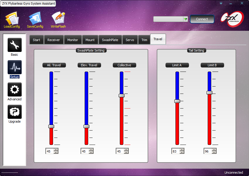

          I also have a another question - What blade pitches are people using for collective and cyclic? No negative collective pitch required for scale, right? Thanks

            ... - What blade pitches are people using for collective and cyclic? No negative collective pitch required for scale, right? Thanks
            I setup +/-12° collective and +/- 10° cyclic on my AS-350 - but I'm flying more than just scale. Note that I use a spring-centered throttle/CP gimbal and always setup 0° at center stick.
            But this is a pilot preference kind of thing, no?
            I've found that a largish collective range is particularly handy when flying at low headspeed, where the blade needs more AOA to generate sufficient lift. Note that the airframe on these Rotorscale helis, (a Trex Sport V1 clone with a Tarot FBL head), allows for a rather large collective range (i.e. +/- 16°). Here are the ZYX-S2 travel limits I am currently using to achieve +/-12 on collective and +/- 10° cyclic:
            Click image for larger version  Name:	ZYX-S2_SETUP_TRAVEL_Settings.png Views:	0 Size:	285.8 KB ID:	193828
            Note that the rudder limits are for a non-stock KST DS215 servo with the servo linkage ball mounted at an 8mm radius from the center of the servo arm. These ZYX-S2 tail setup values will vary with other tail servo configurations. (The Tail LimitA and LimitB travel values are set as high as possible - just up to the point of almost binding.)
