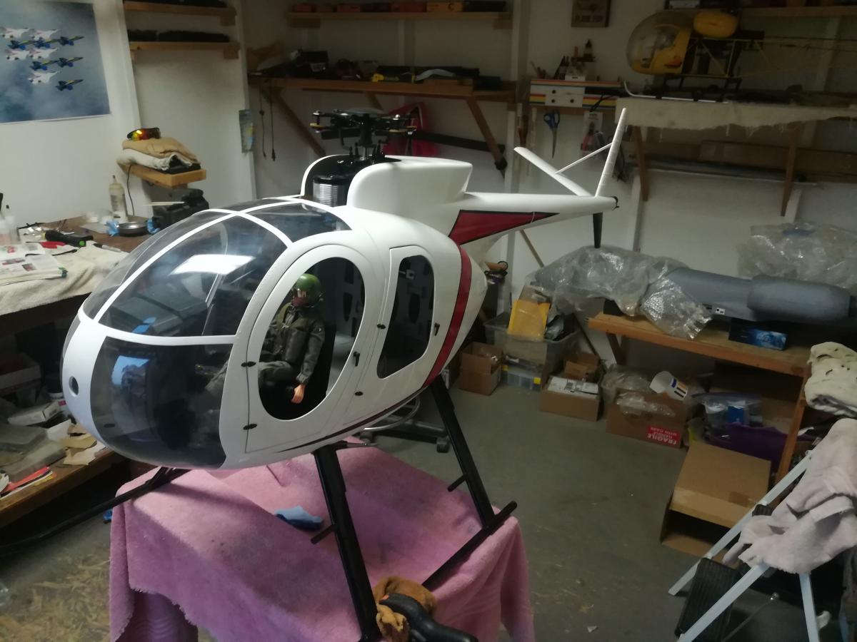

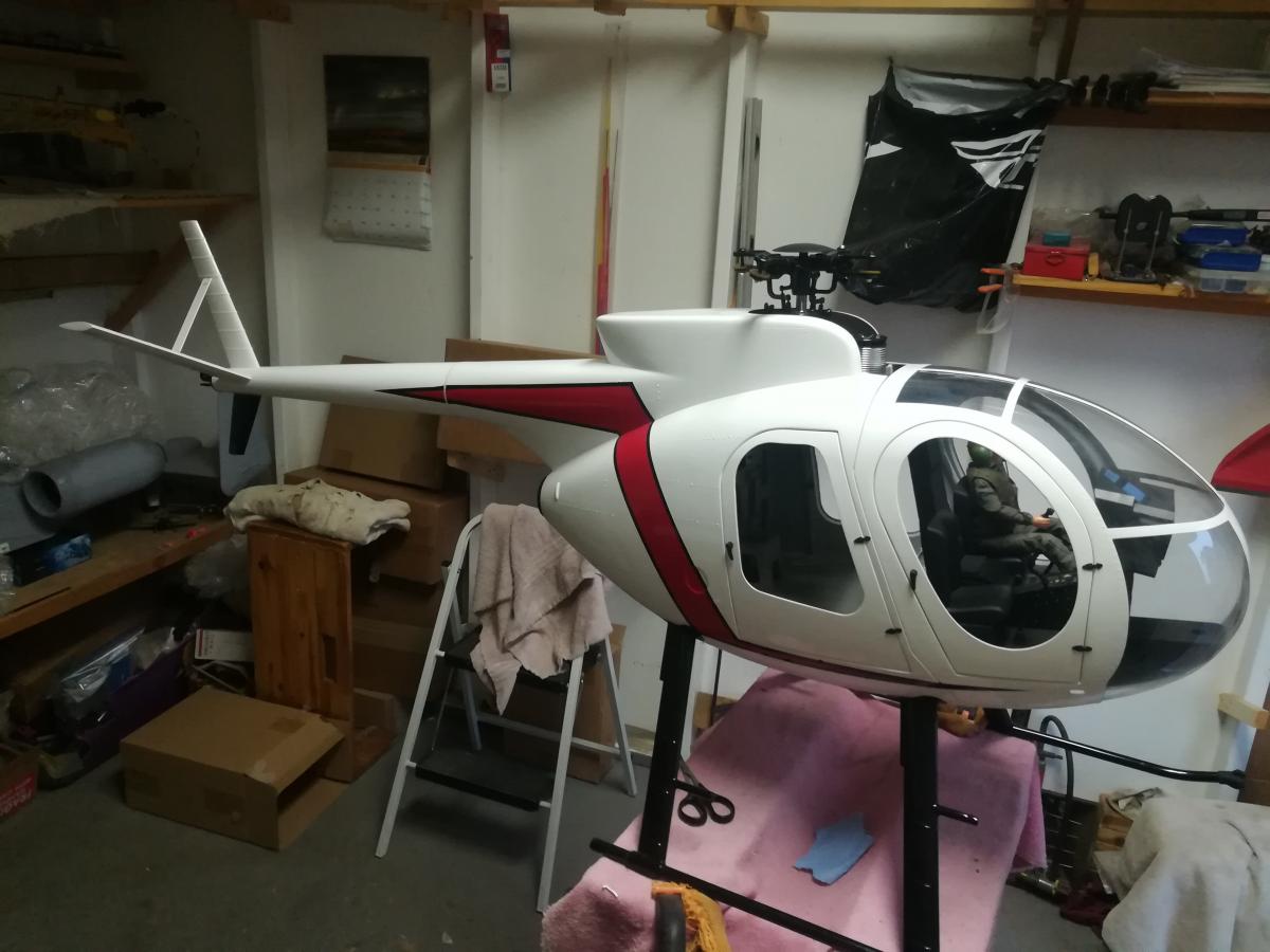

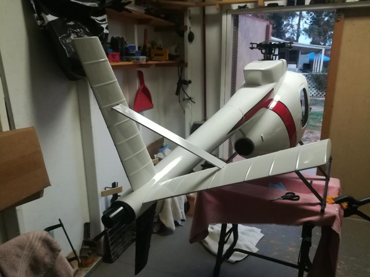

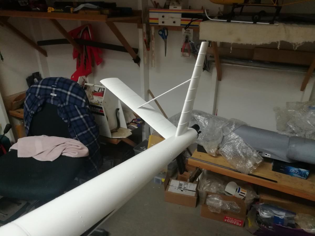

      Got a little more done yesterday, mounted the tail boom and tail section, got it all glued on, had to do a little grinding here and there to get it all straight, turned out good.
      • #23
        Now it needs an ESC, servos, wiring, fbl unit and my Rx and she is ready, only another $1000..

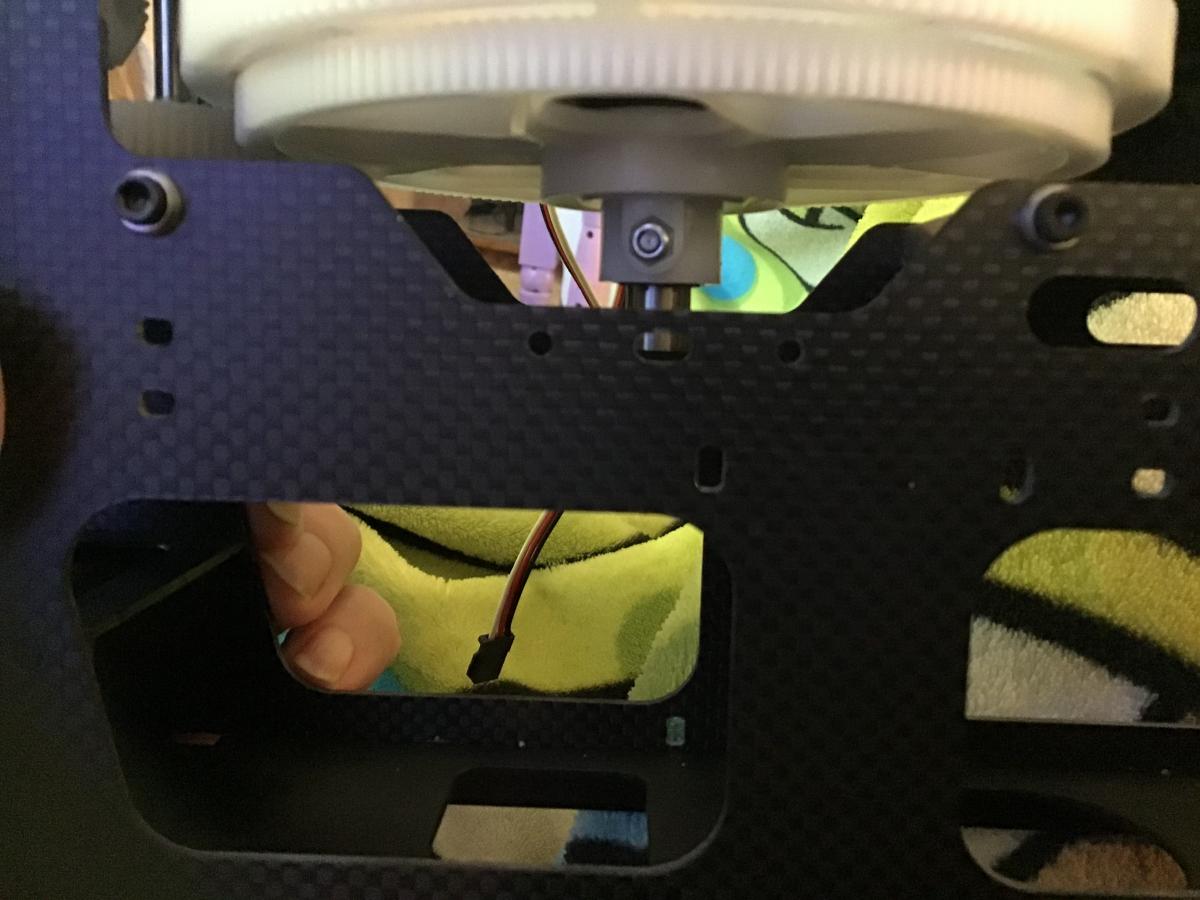

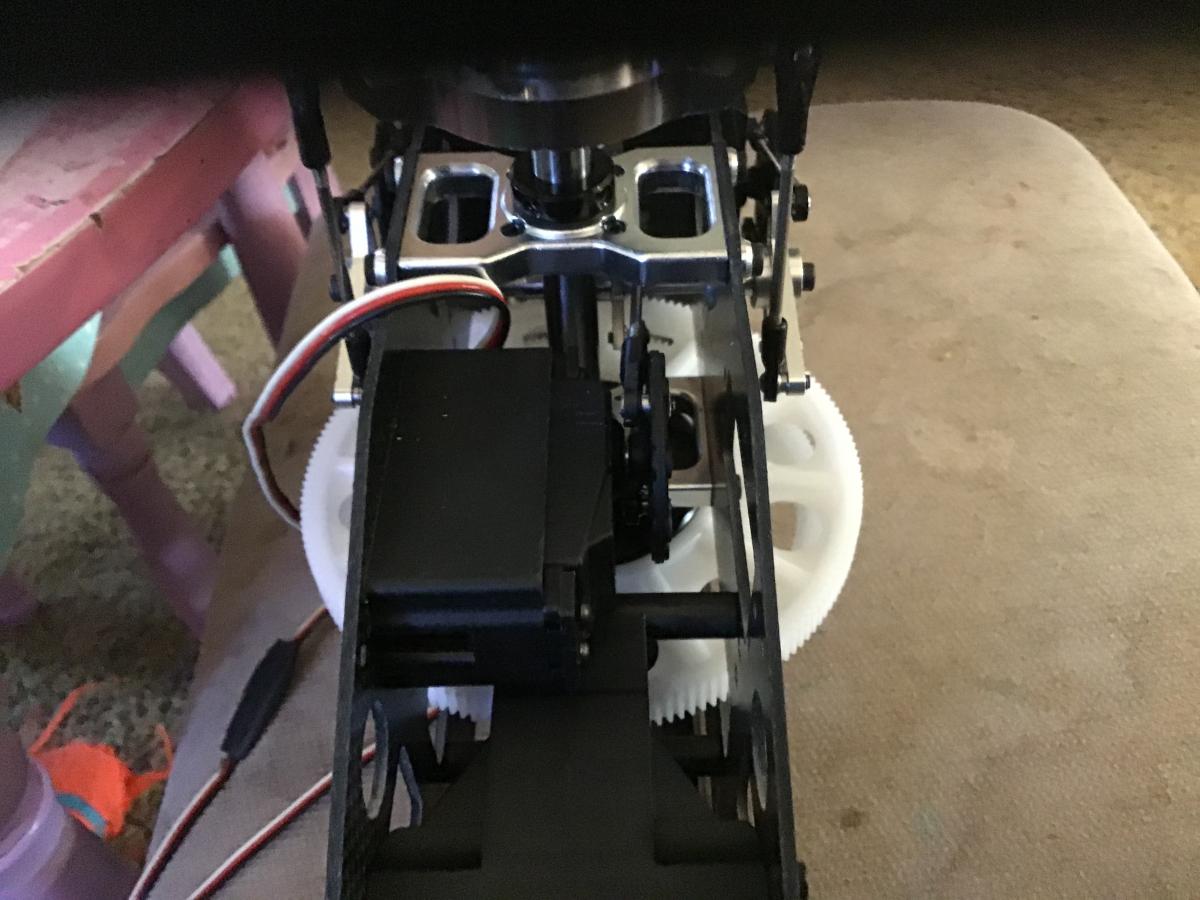

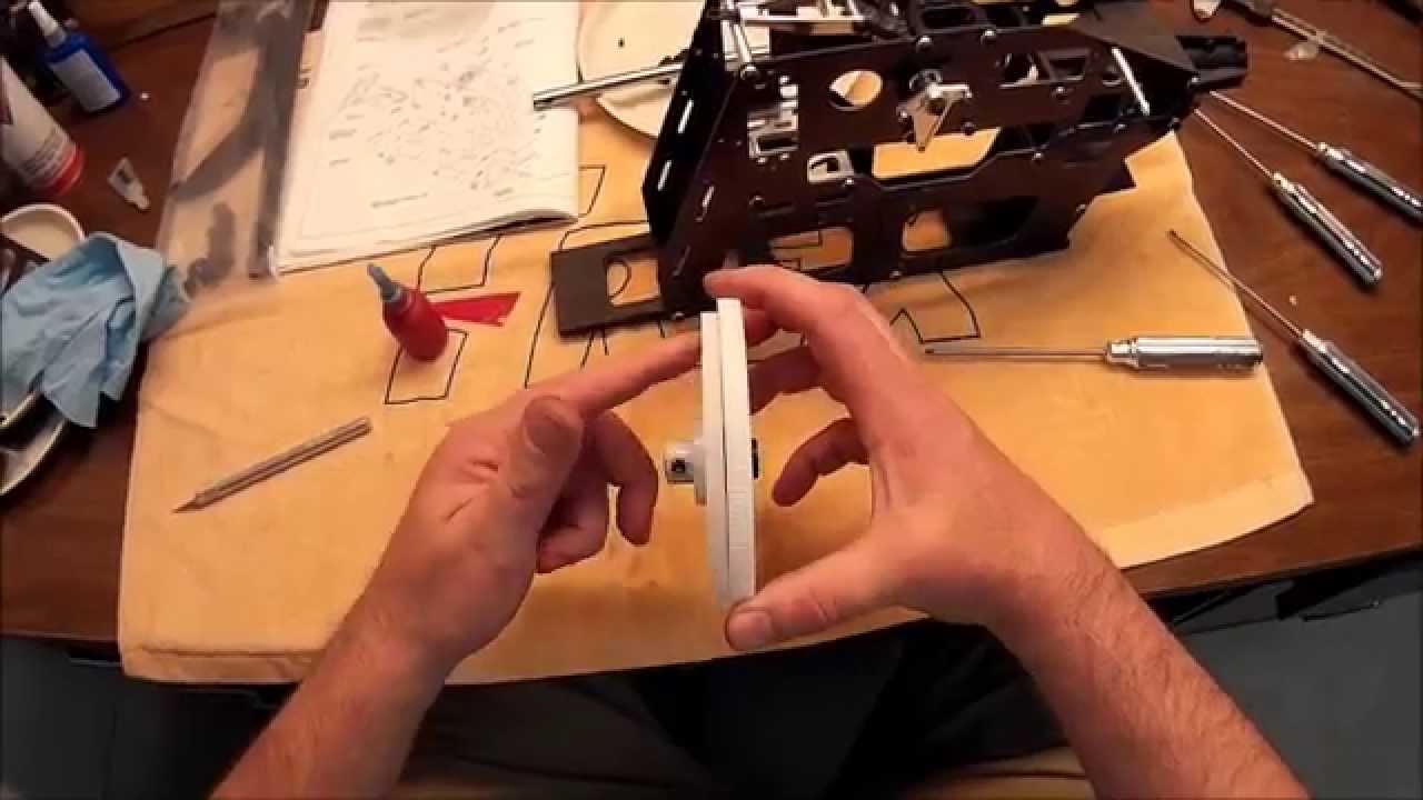

                              Yes sir, I got the Phoenixtech 600 ESP mechs MRC now offers. So far I’m impressed with the quality of components. My 450 Huey mechs came assembled so this my first actual “scratch” direct drive mechanics assembly effort. There is no included manual so found a Trek ESP manual online to follow. Everything fits as it should, but did need to slightly enlarge the elevator servo spacer box screw holes for the self tapping screws. The frame has predrilled mounting holes for an optional 3rd main shaft bearing block but I’ve only been able to find one in Germany. Mechs will be fine as-is for scale flying, but I’d certainly add it for 3D. I want it “just because”. I emailed MRC about future availability of the bearing but haven’t heard back yet. Also, this frame is set up for standard size servos & includes 3 Futaba (25t) round horns which suit my needs perfectly. I’ll also add that the assembly notes available at MRC’s support tab for the Phoenixtech 600 ESP show the elevator servo mounted outside the frame & mention that it can’t be installed as designed. That ain’t true! Click image for larger version

                              • #35
                                Hey, here's John Salt has a build series for this set specifically....
                                • #36
                                  I did see his video was available, but the Trex 600 ESP online manual is so detailed & complete I didn’t watch it. Probably should have....I didn’t initially notice the longer balls on the swash plate were smaller diameter than the short ones, so broke both radius arms when I squeezed them on the wrong (short) balls.
                                  • #37
                                    Ok, good news then about the quality of the mechanics, also I never installed the 3rd bearing block on any of my helis, never had any issues for scale flying.
