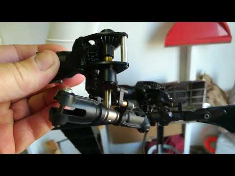

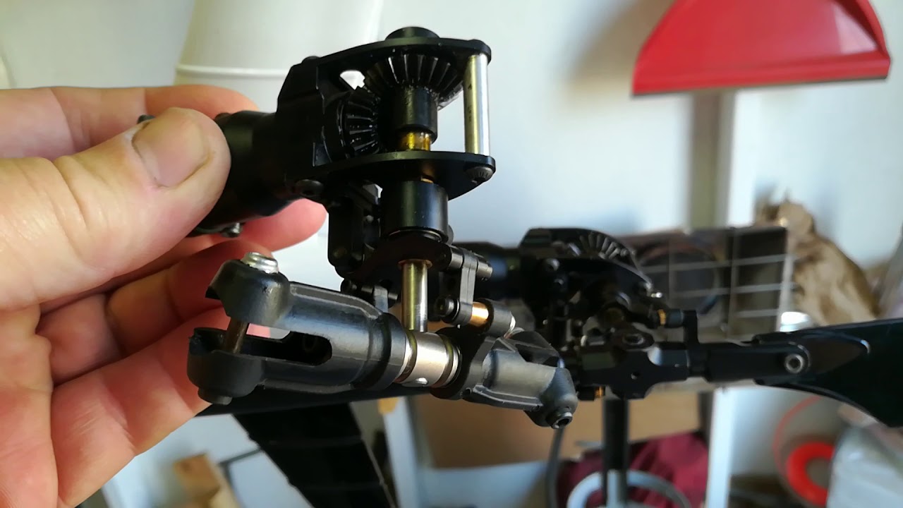

            Here is the tail rotor mod I did recently on my OH -6, flies perfect now, no tail wag at all, hope I explain it well.

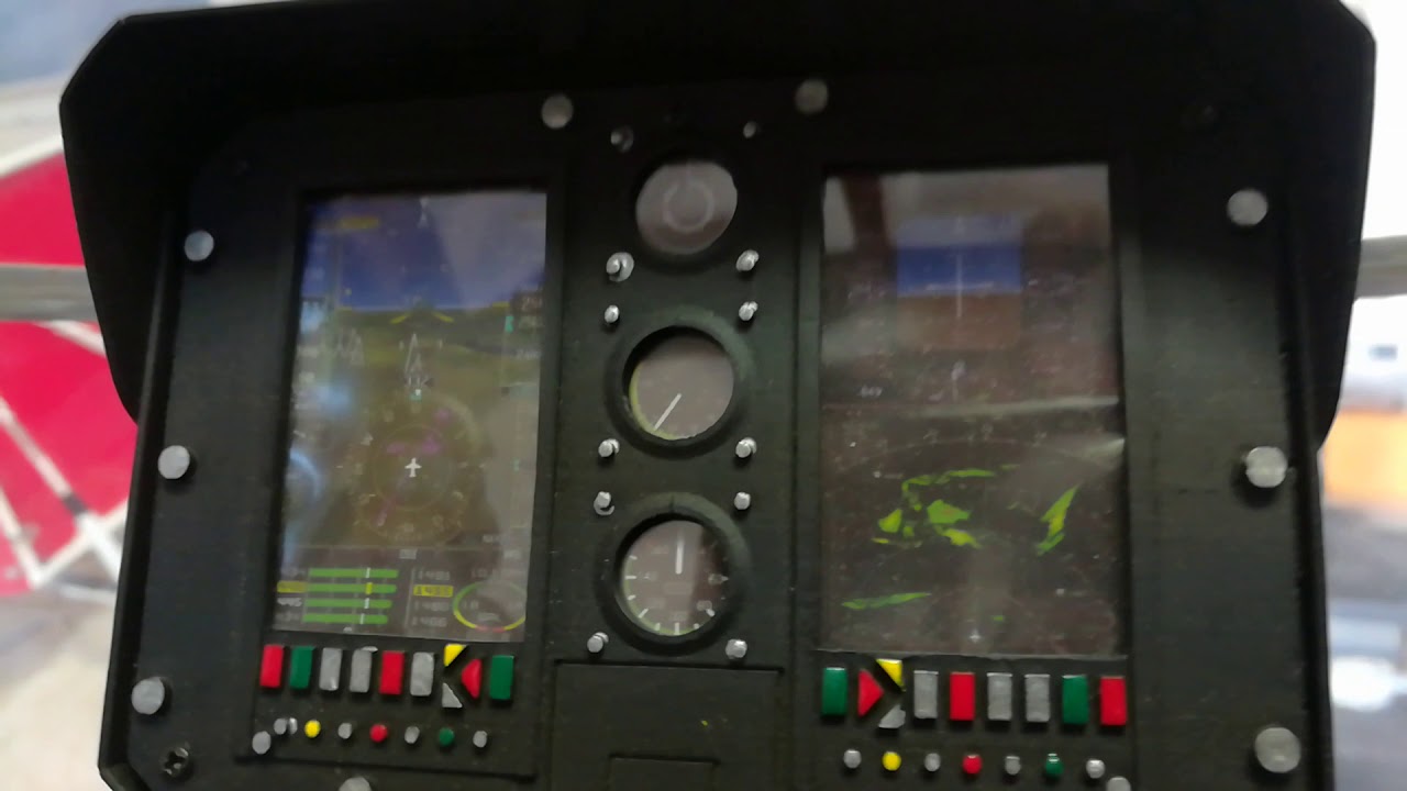

              Here is another mod I did on the front landing light and cockpit instrument lights so I don't have to plug and unplug wires everytime I take the front cabin off.

                #87
                Nice job on both mods. Thinking the heavier 4 blade hub vs the plastic 2 blade hub is what made the difference? Glad it worked!

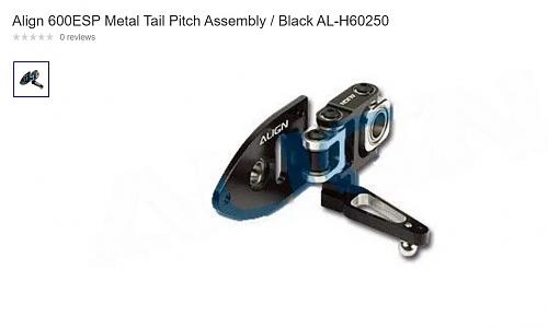

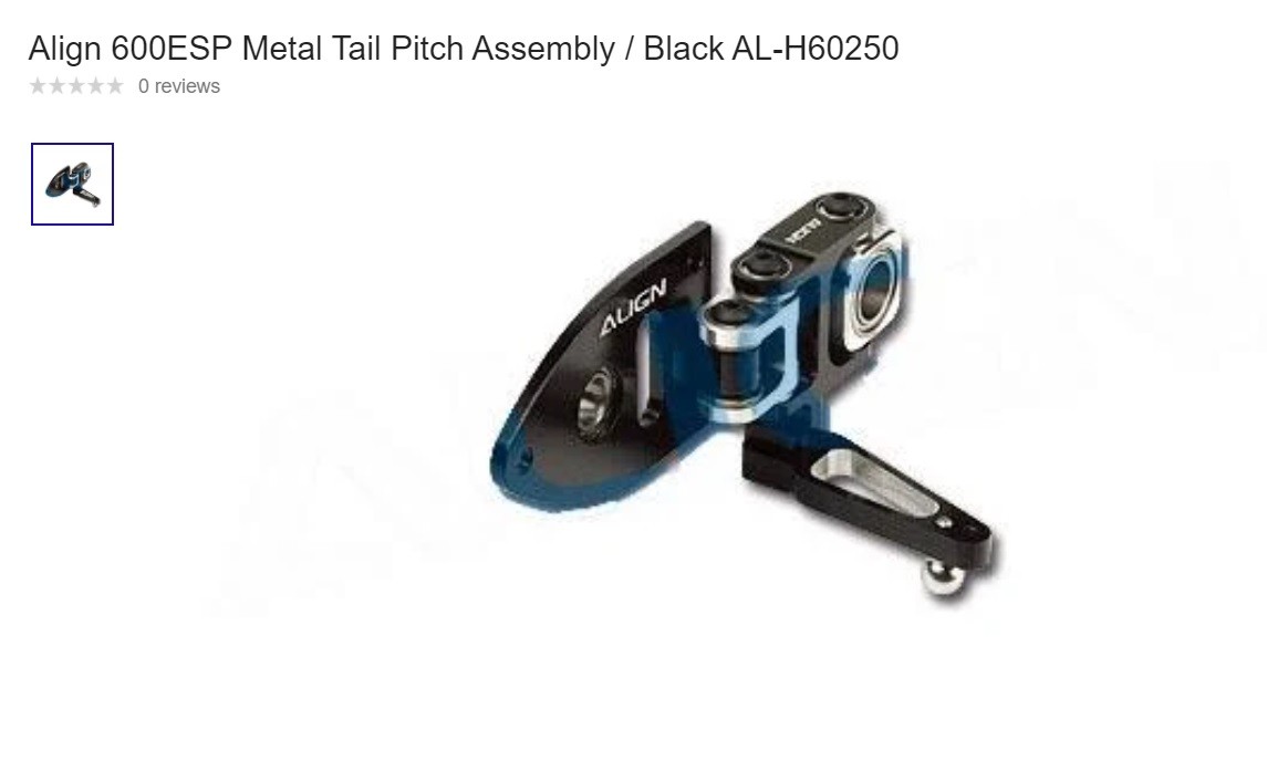

                              I can confirm everything about the tail is 600 sized- at least on the 700 size cobra. I've went down several rabbit holes chasing down issues on my tail on my cobra... and from looking at the manual on the 800 sized MD500/OH6 the tail rotor looks the same. If I could recommend a part so that you don't have to buy a whole tail assembly, or individual parts would be this guy: Align 600ESP Metal Tail Pitch Assembly/Black H60250T. It was a complete bolt on replacement.

                                *And I'm using the V2 metal blade holder that you guys posted as well... I put the V2 blade holder and that 60250T pitch assembly on my 600 sized OH6... and feel like the tail is dialed in from jumped street. I put that combo on my Cobra too.. and with the new gear box installed I finally feel like the tail is set on it.... for now.
