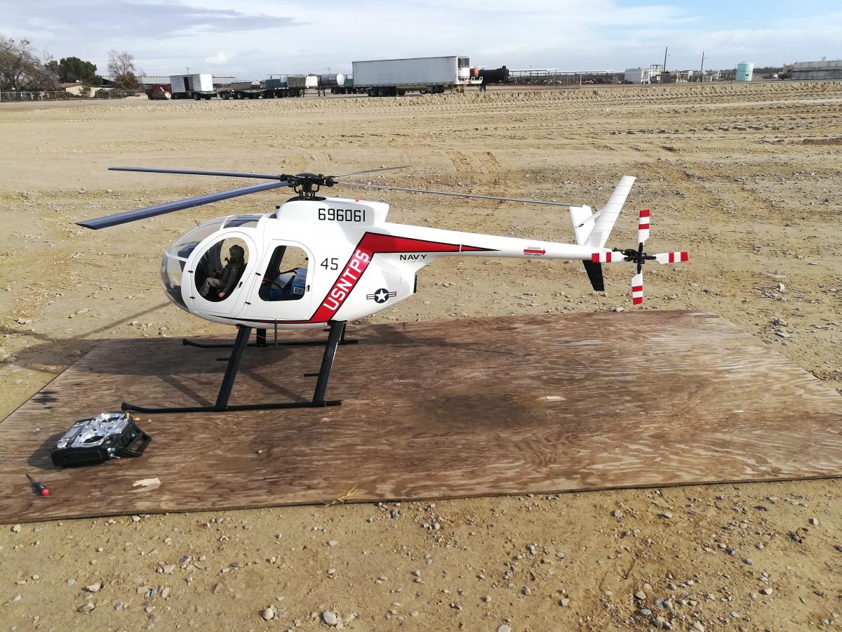

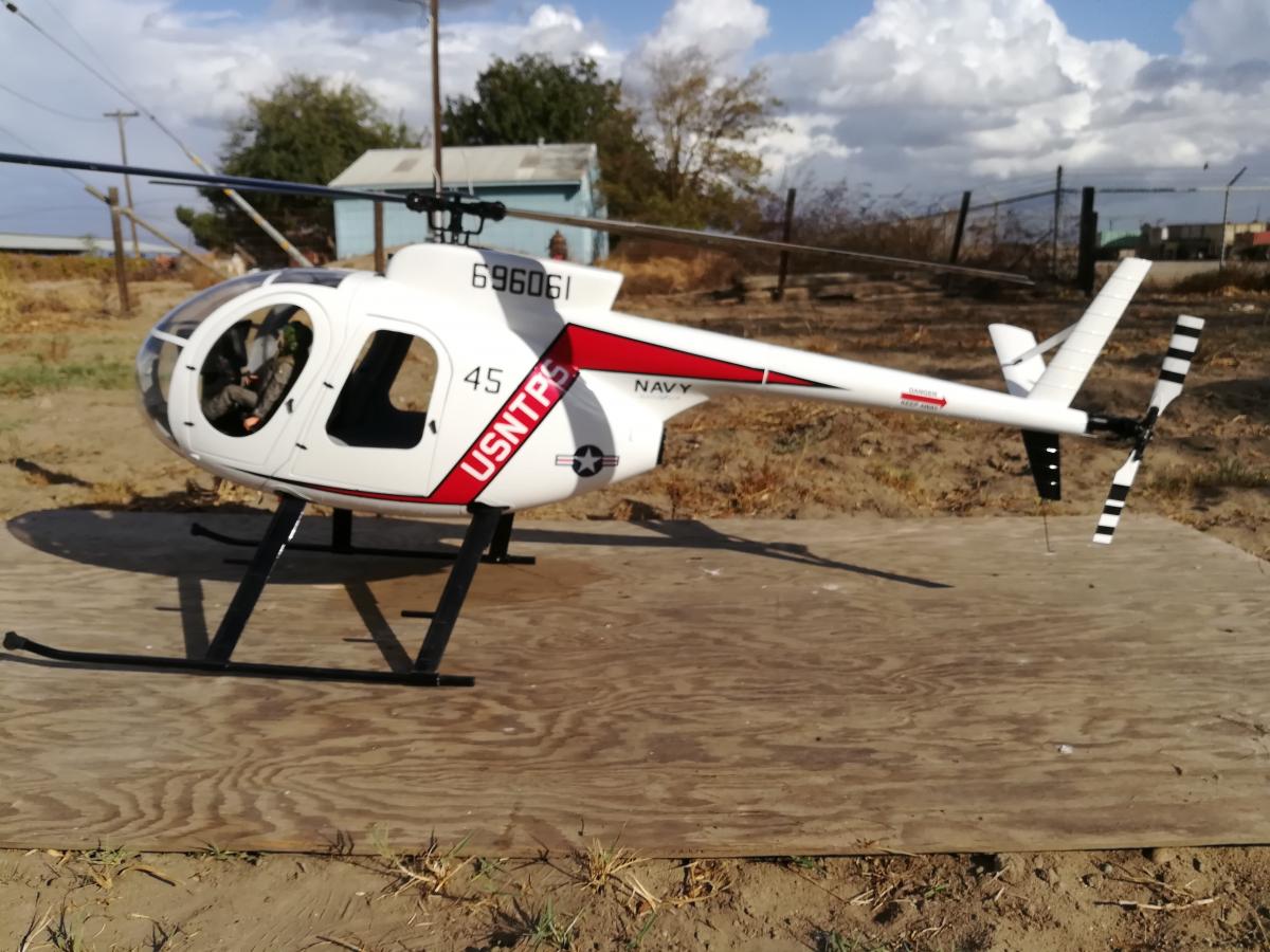

                      3 more flights today, I had a tail wag with the 2 blade tail so I put my 4 blade tail on and it's smooth, no wag at all, so I needed your guys opinion, how does it look with the 4 blade versus the 2 blade??

                        Like crap. Send it to me and end your pain.

                              My vote is keep the 4 blades.

                                Well I think the two blades looks better... especially considering that actually has the V Cayuse tail.... and from the looks... the two blades look a lil longer. Perhaps you can bump up your headspeed a bit? Worse case if you could always look at one of these:
