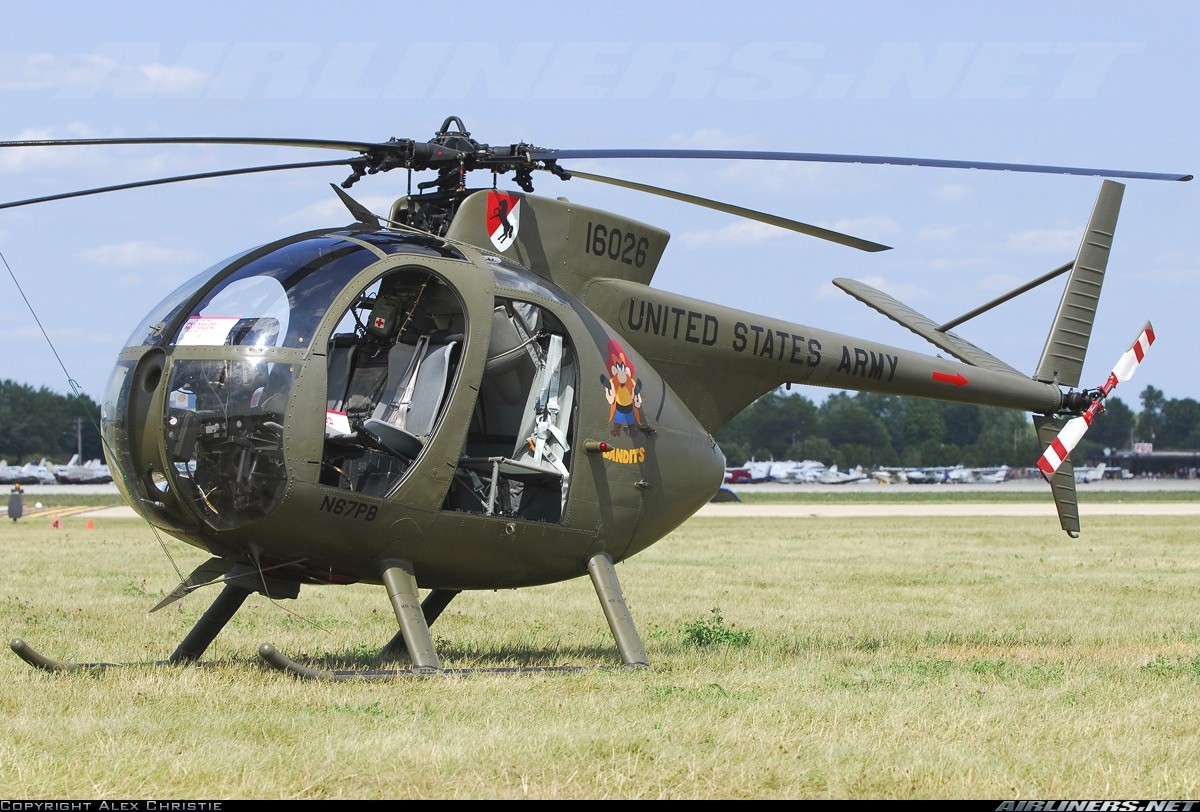

                    • Really thinking about bashing my white Roban Cayuse into the Army green version like this one, I think it would look better than the white version, and I have an extra set of skids I could cut down to make it shorter............

                      • You watched “Apocalypse Now” again yesterday, didn’t you?
                        • Originally posted by PawPaw View Post
                          Too funny...........don't know what happen to the picture when I posted, now its back....

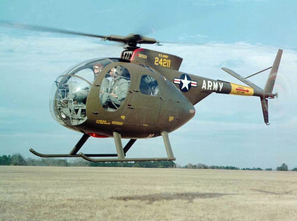

                          • Or maybe this one...........
Name:	Army hughes 500.jpeg
                            • Both look good...hard to decide. Looking forward to watching your progress if you decide to go that route.

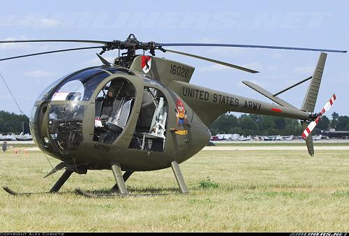

                                    I also vote for Sam, I’ve seen that bird at Oshkosh for the last few years, and it’s a fantastic restoration. If I dig through my archive I may be able to dig up some reference photos if needed.

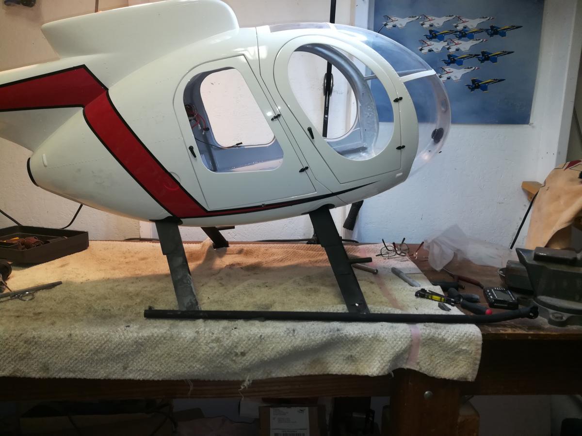

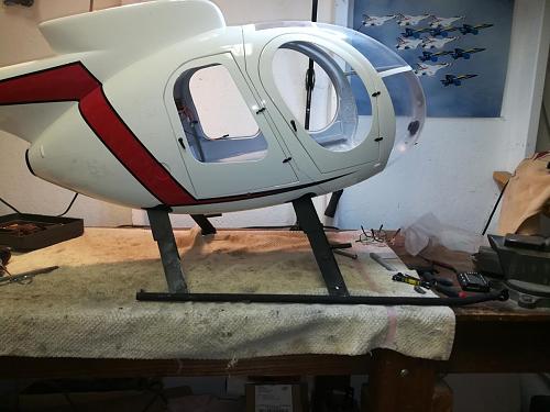

                                    • Thanks guys, I truly enjoyed flying my giant scale F4U Corsair back in my warbird days and it was done up in the Skyboss scheme, so with Gravy bringing back those memories, I will go with that for now, I'm not a big time close to scale as possible guy anyway but with Gravy doing my painting for me as he volunteered lol, and a few decals, I think it will look much better than the white Navy scheme, so here it is now getting it ready, first chop of the skids already but need to go lower, getting it right is not going to be easy and still clear the tail blades.
                                      • The 2nd chop of the rear struts, 3 -1/2 inches off so far.Click image for larger version  Name:	IMG_20210411_201133.jpg Views:	0 Size:	111.7 KB ID:	308324 ......
                                        • Lower. Lower. Lol
                                          looks good so far.
                                          Gravy
