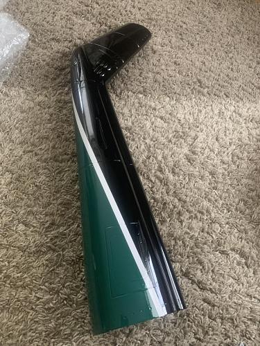

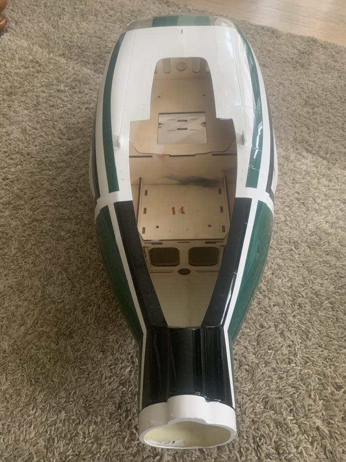

    ​ ​ Recently purchased a Roban B212 600 size heli from Motion RC website. Really looking forward to building this kit. Shipping was pretty quick and in about 4 days I had the heli at my door. Packaging was really nice and no damages to the heli or any contents. For electronics I have planned 6s power. Probably a CNHL 65c 5000mah 6S battery. Motor is a Scorpion 4025-1100KV. ​ ​ ESC is going to be Hobbywing Platinum Pro 120 ESC. Servos are 3x KST BLS 815 V.2 on the Cyclic and a KST BLS 805X for tail servo. RX/FBL controller is a Spirit RS linked to my Jeti DS-12 Carbon TX.

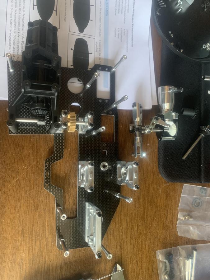

      For the donor mechanics for the 600 size B212, I chose to try the Phoenixtech 600 ESP which is a clone of the Align 600 ESP. There are a few differences I will explain later on as the assembly goes on which will help anyone who is planning to use the Phoenixtech mechanics for their 600 size roban fuse.

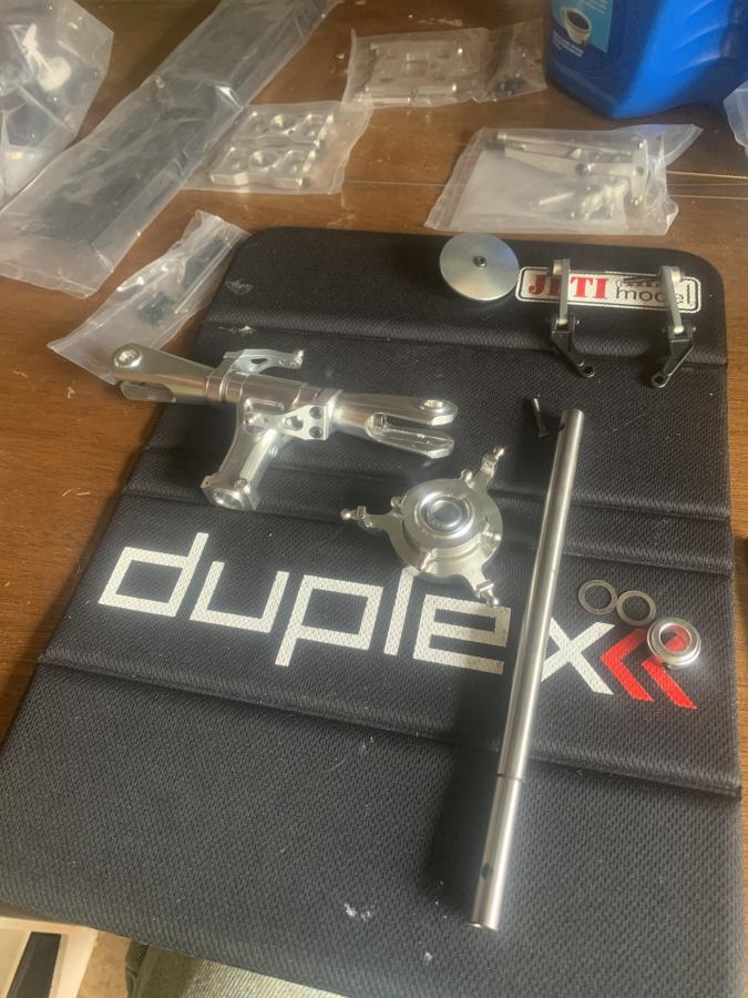

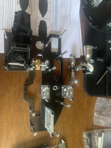

ID:	321660Click image for larger version
ID:	321659Click image for larger version

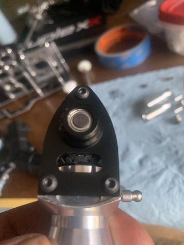

ID:	321658 Here are a few pictures of the Phoenixtech 600 esp clone mechanics. Something to note, the Phoenixtech comes with plastic umbrella gears in the tail rotor gear box as well as the torque tube gears box. The Roban B212 kit includes all new metal umbrella gears as well as a stack of shims so you can adjust the gear mesh appropriately. The gears seem of very nice quality. The main rotor head and components seem to be of nice quality and machining. Many of the parts in the kit are preassembled, however you need to go through everything and disassemble and add lubricant or thread locker as needed.

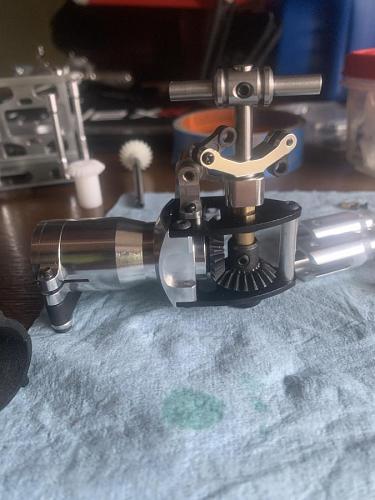

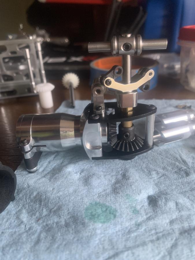

                      Here’s a question. I have looked but can’t seem to find them. Where can I purchase more of the bevel gear shims for this 600 size roban? Any ideas? I shimmed the tail gear mesh nice but only have one spacer/shim left for the tail shaft bearing block gear mesh. And I can tell it’s probably going to need a few more. Thanks!

                        Good question, I'm not sure where we are going to get those shims other than Scaleflying.de in Germany, wonder if the 600/700 use the same shims, that I don't know. You don't want the gears to tight, little backlash is better really, the gears will wear quickly if too tight, but too loose and they will strip the tips off the teeth.

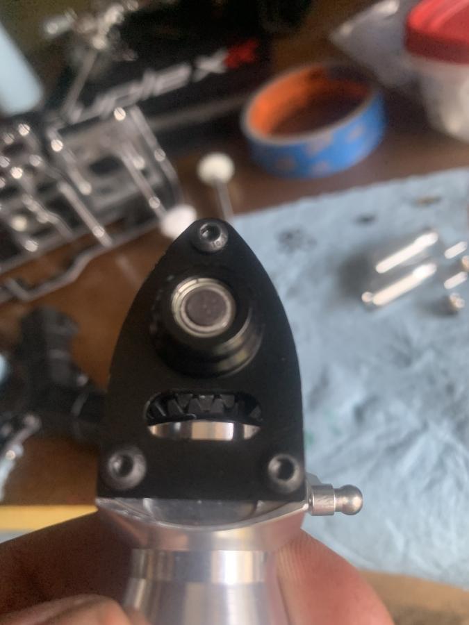

                          Good to know I will check it out. I set the tail up nice Click image for larger version
                          • DCORSAIR
                            • 1918
                            • Selma, Ca.
                            Looks good, that's how I do mine, the outside edges lined up evenly, seems to work for me, out of my 4 Roban helis, I haven't stripped any yet, of course I do lube them every couple of flights so maybe that helps, do not let them run dry of grease, I use VRP Honey grease from Amain hobbies and it works great, very sticky and when it slings off it don't go far and make a big mess, kind of expensive for that little container and its out of stock at most places.

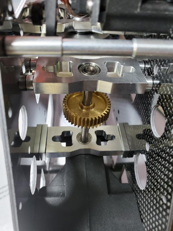

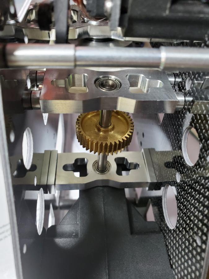

                                    Please look at the front tail bearing blocks where I have mounted all the spacers, that is in case you have a problem. This is a UH600 frame but your Bell 212 had the same front gear box setup. Follow my photo.

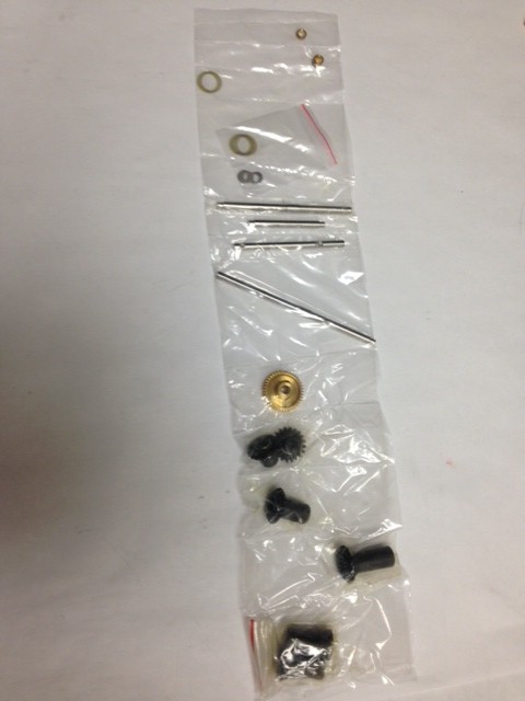

                                      Your fuselage hardware came with a bag full of shims.
                                      • eawings
                                        MotionRC CS Team / Pro Scale Builder
                                        • 113
                                        #20
                                        Metal Gears for UH1N, UH60 & Tiger Fuselages (600 size)
