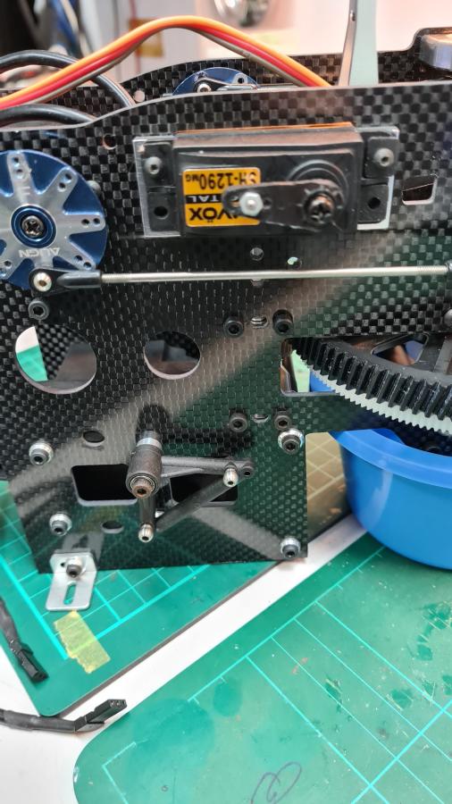

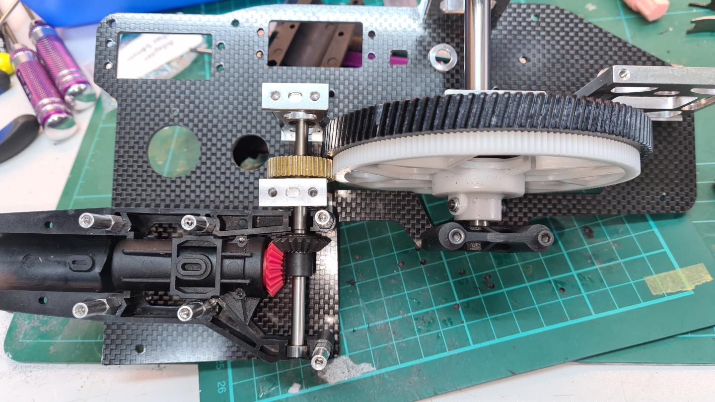

              What makes the metal tail gears better than the much to heavy pvc gears delivered in the kit ? , the pvc gears are made for heavy duty 3D flying and must be strong enough to last on a lower rpm scale helicopter ,and it makes the tail so heavy.
              I also like to know if anyone have used 700 blades on this model and if it wil flying as nice as I hope, I wil try asymmetrical Spinblades on it .
              also I wil move the tail to the mechanics frame to reduce weight of the tail and wil use ball bearing levers on it, see pictures

                  I used the stock plastic gears on my tail. As you said, they are designed for 3D flying, so they are more than adequate for our purposes. I like your idea of bring the tail servo forward. I would closely monitor the tail gear arrangement in your 2nd picture, where you used a stock metal gear meshing with an Align plastic gear for the torque tube drive. I'm worried that the metal gear will wear through the plastic gear at an accelerated rate. It might be ok, but check on it when you are test flying the mechanics and please report your findings. If it does work well, it might help extend the life of the Roban metal gears and eliminate the need for lubrication at these points.

                    I made again some modifications ( see pics) , tailservo in frame an added new linkage . I want to use 700 blades on it and the flasher blade grips are with 12mm to small , i wil now use a
                    Mikado head with the 14mm blade grips , Also i ordered a Spirit GTR Fbl system + Geo link for this 212
