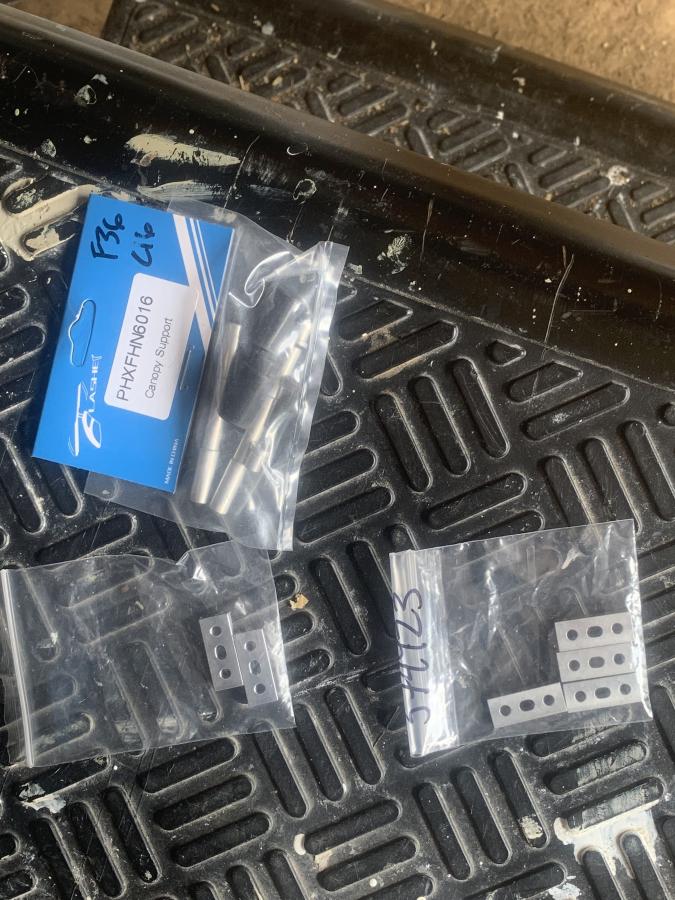

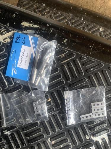

            Look what came in today! Thanks for being responsive Ed from Motion RC! Click image for larger version

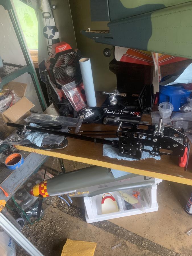

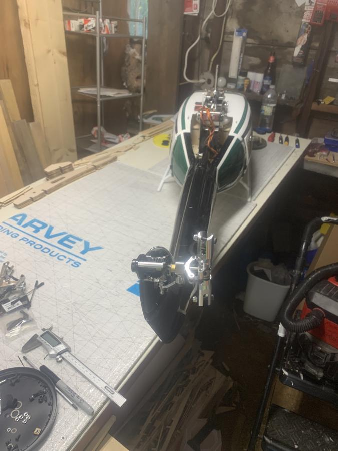

                  Just returned from vacation and have some parts that I ordered to continue build come in. Today I have mounted the landing skid on the fuse. Also received the optional 3rd main mast bearing block. I ordered this part through RCAerodyne and shipping was quick and was at my door in 3 days! I am using the Phoenixtech 600 ESP mechanics so I ordered a few more spacers I needed for the frame. 3.5mm on each side of a roban part such as tail gear bearing blocks to make up the 7mm larger width the Phoenixtech mechanics are. The wider frame which is 54mm as opposed to 47mm stock Align 600 ESP is nice because it gives you more options for newer wider motors such as the Scorpion 4025-1100kv I went with. Today I also received a scale cockpit I ordered through motion Rc. Shipping was quick as usual and amazed at quality of this roban cockpit.

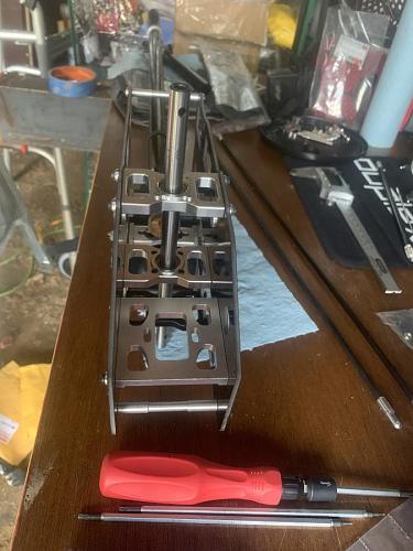

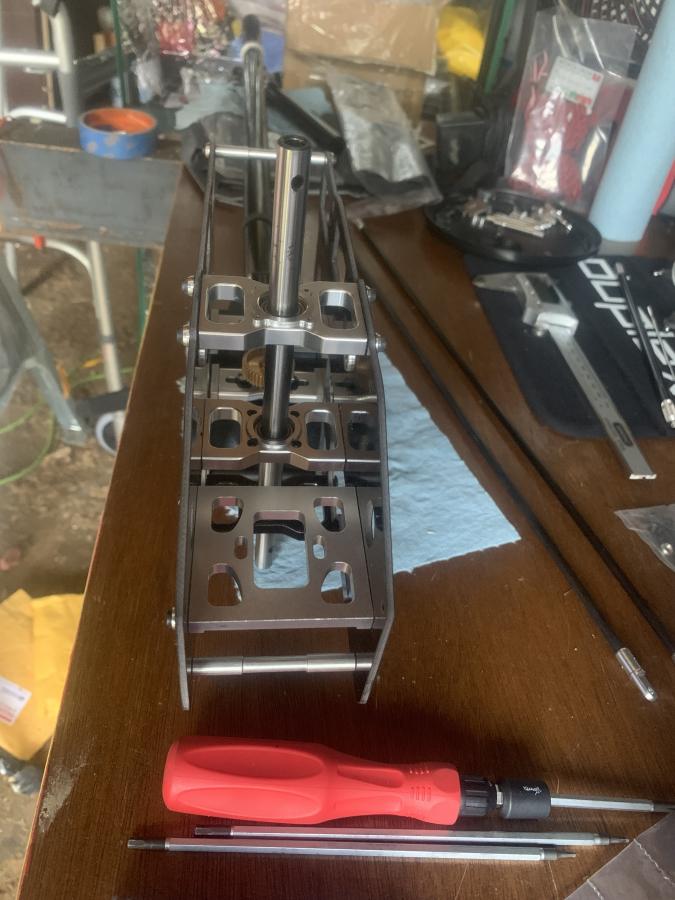

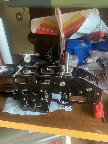

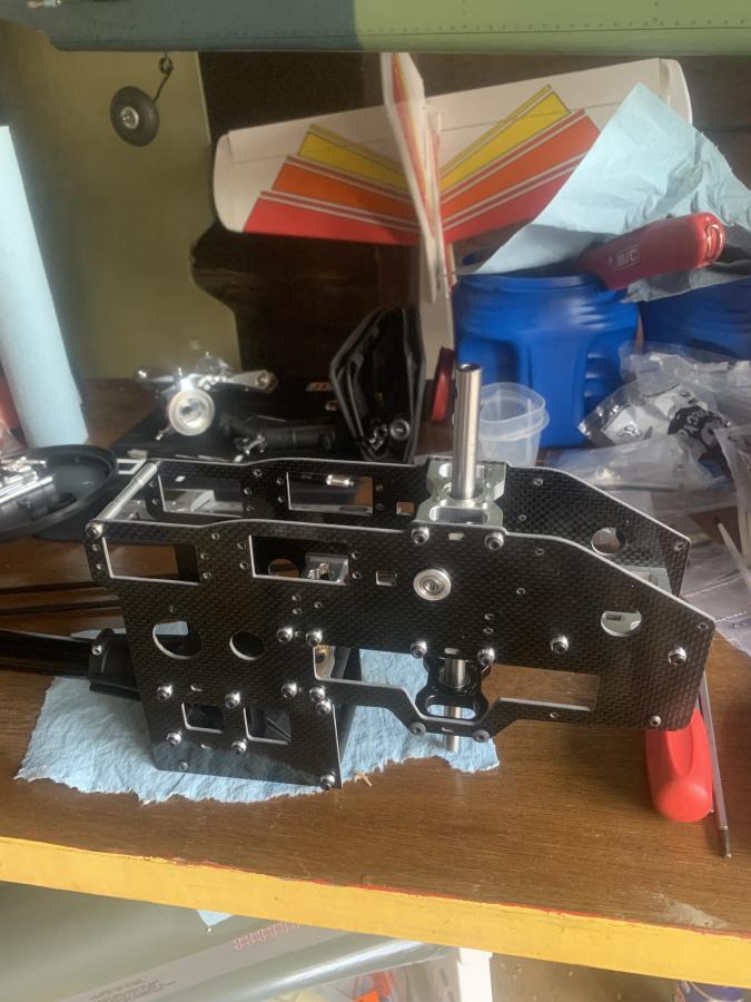

ID:	322663 Installed 3rd bearing block, fitted torque tube bearing and shaft into main torque tube. Installed into frame and fastened second half of frame together.

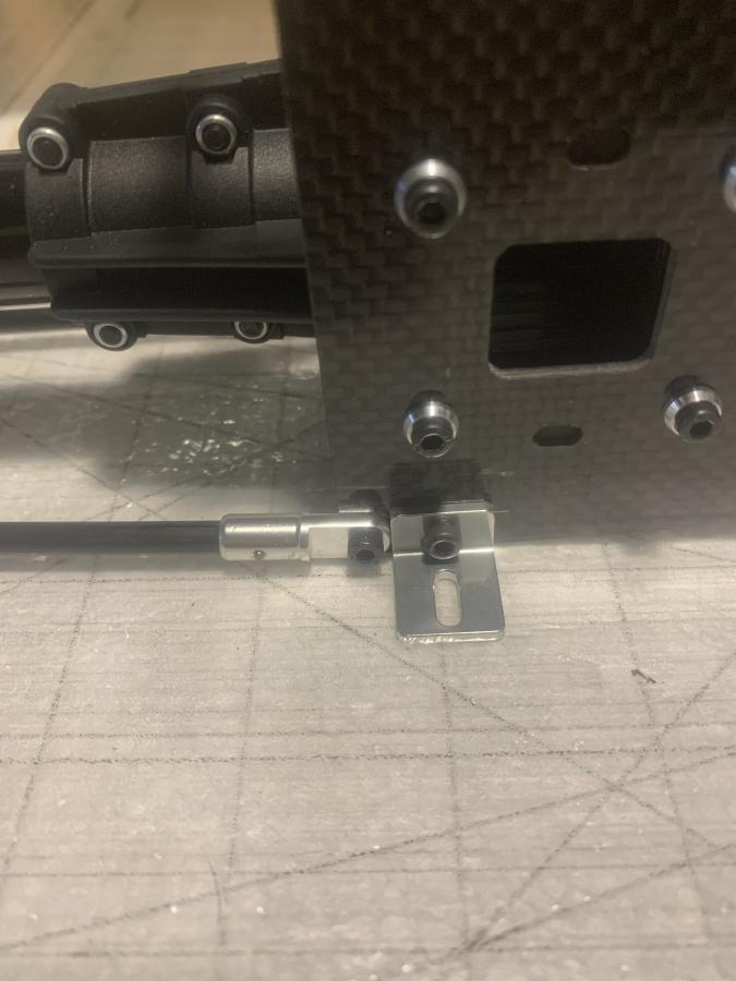

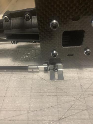

ID:	323136 Drilled and epoxied the blind nuts in the fuse to connect the tail portion of the fuse. Using the 54mm wider Phoenixtech frame I noticed that that way the show you in the Roban directions to attach the boom support with the same screw holding the rear frame mount, it does not allow you room to fasten down the screw to attach mechanics to fuse via the blind nut. I drilled two new holes aft of the mechanics to fuse rear mount and added a new frame spacer between.

                            Great idea, and looking good, I always reposition them boom supports to another spot, they always seem to be in my way for some reason. I have been looking at those mechanics, thinking about ordering a set to have and maybe get that red Swiss Medic EC 145 now that I'm following your build.

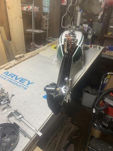

                                        • United States
                                        #39

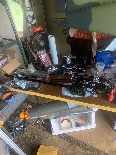

                                        So much to catch up on soon about the build! I will go into lengthy detail but I will say that I am into the mechanics testing phase now so I am seeing the light at the end of the tunnel. Click image for larger version
