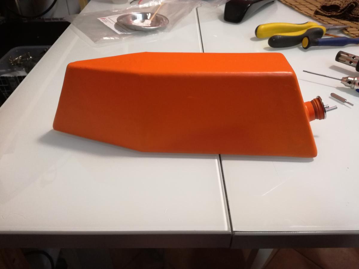

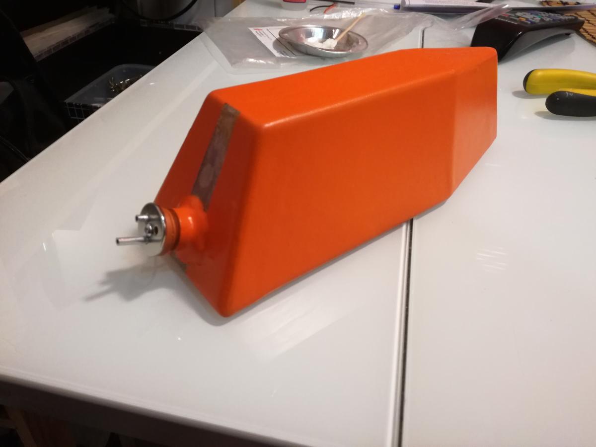

      My custom made tank for the FW L-39, one day I will be converting it..fits right over the CG.Click image for larger version

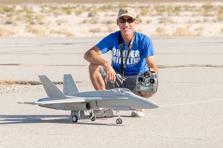

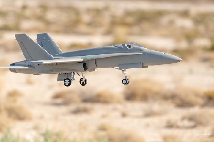

ID:	211320 Maiden F-18 K30 power 6 flights all code 1

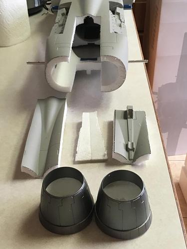

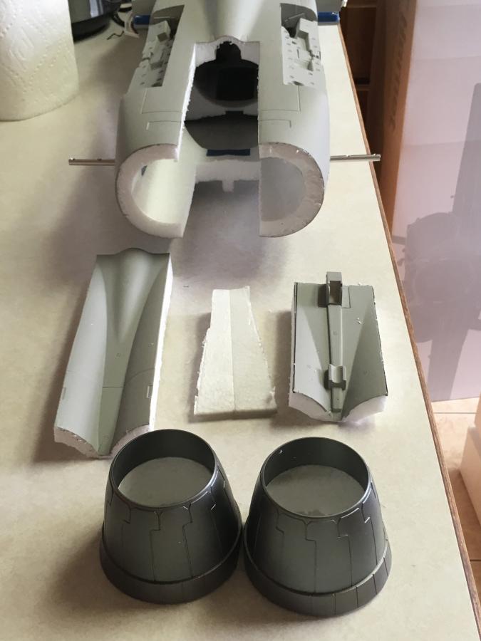

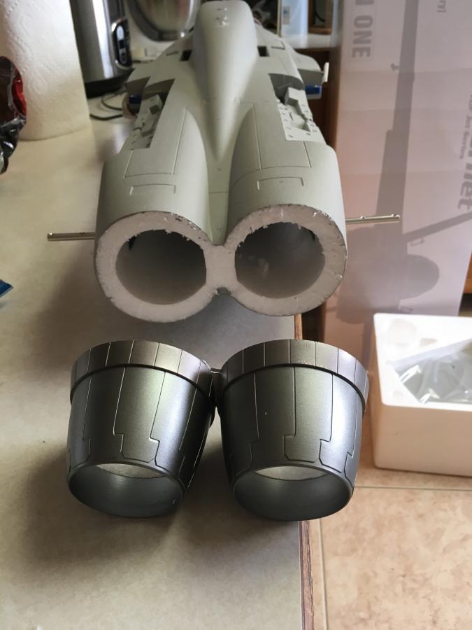

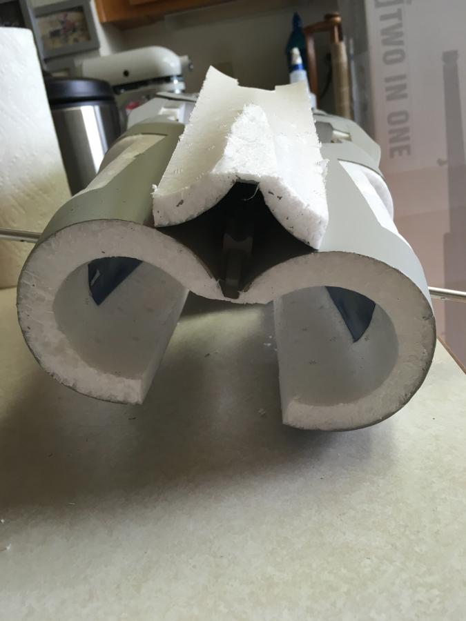

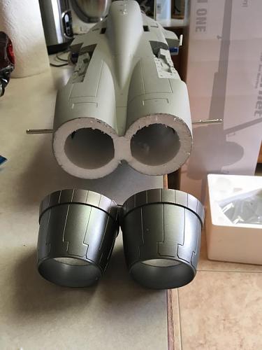

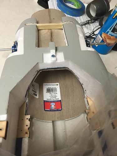

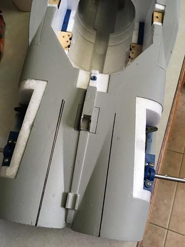

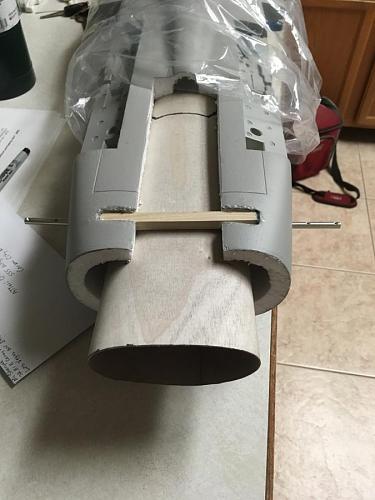

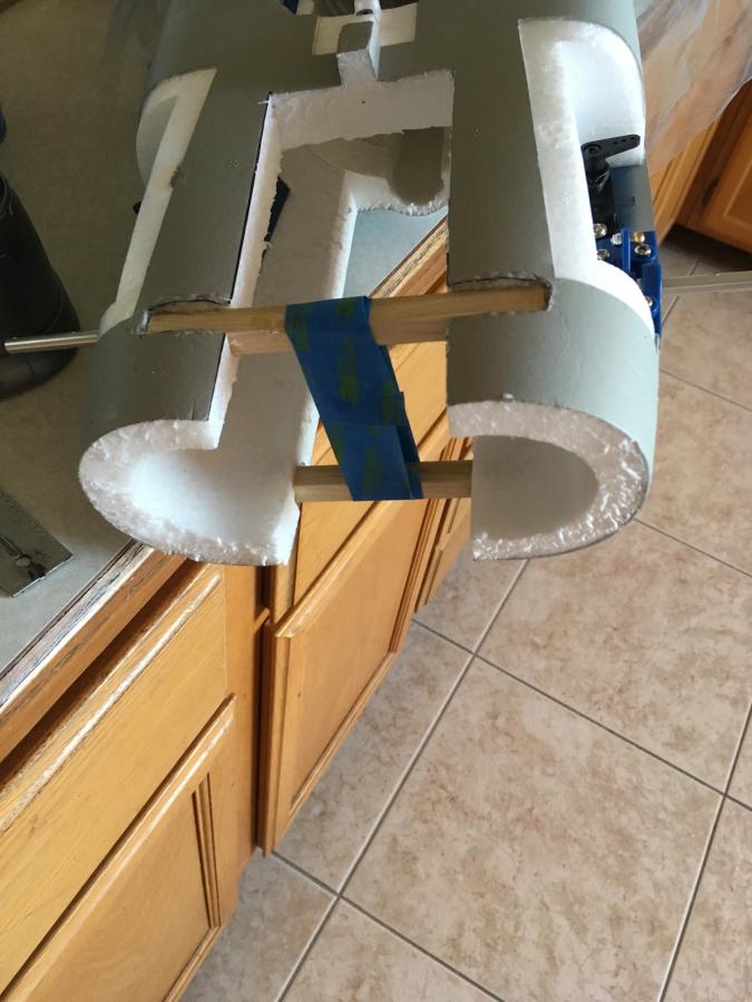

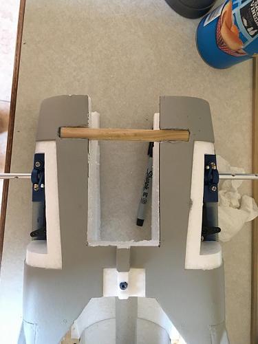

                            ok let's see if i can load pics Click image for larger version  Name:	IMG_4471.jpg Views:	0 Size:	53.3 KB ID:	211446Click image for larger version  Name:	IMG_4469.jpg Views:	0 Size:	47.4 KB ID:	211447Click image for larger version  Name:	IMG_4468.jpg Views:	0 Size:	54.2 KB ID:	211448Click image for larger version  Name:	IMG_4470.jpg Views:	0 Size:	55.2 KB ID:	211449they are a little out of order but you'll get the idea. I cut the nozzles off, and then the speed brake and then used that as a template for the bottom cut.
                            • #34

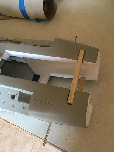

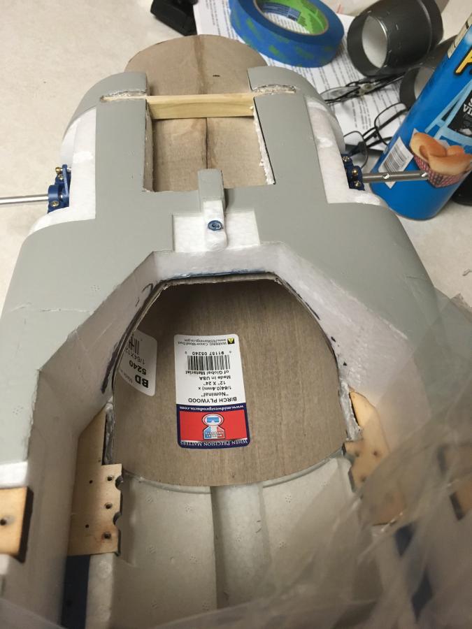

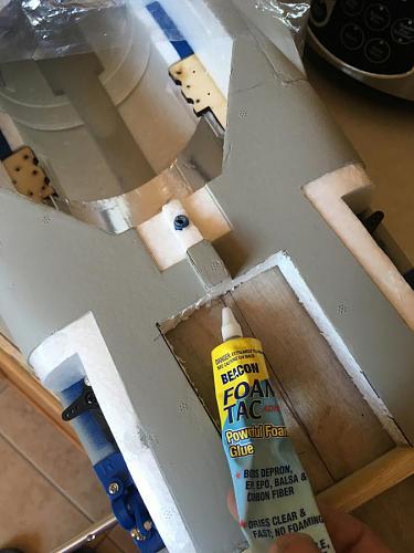

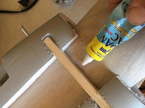

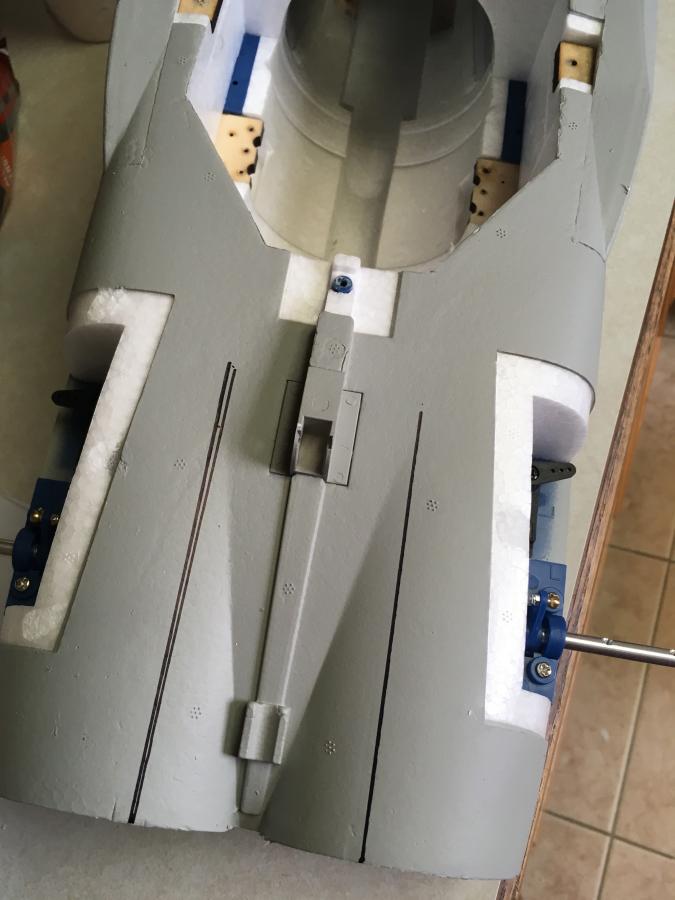

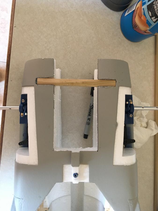

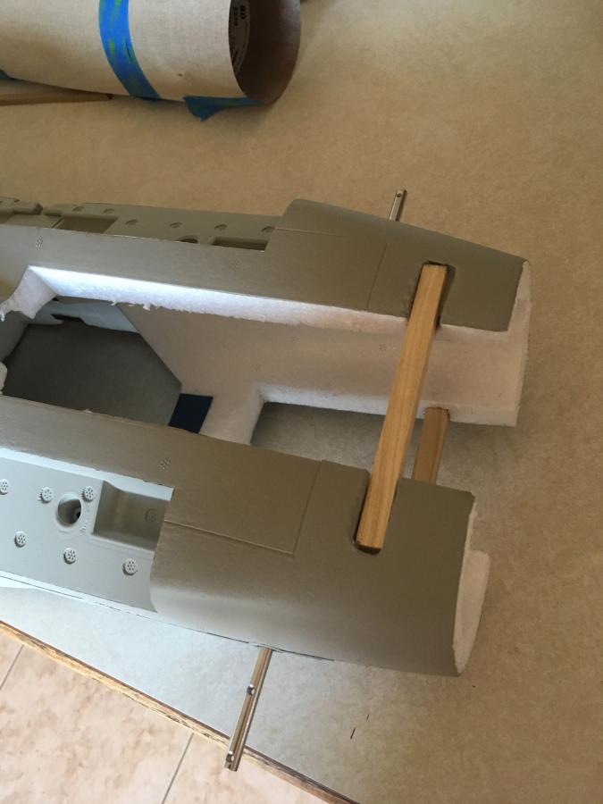

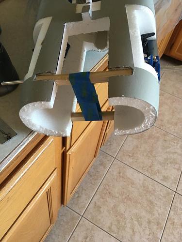

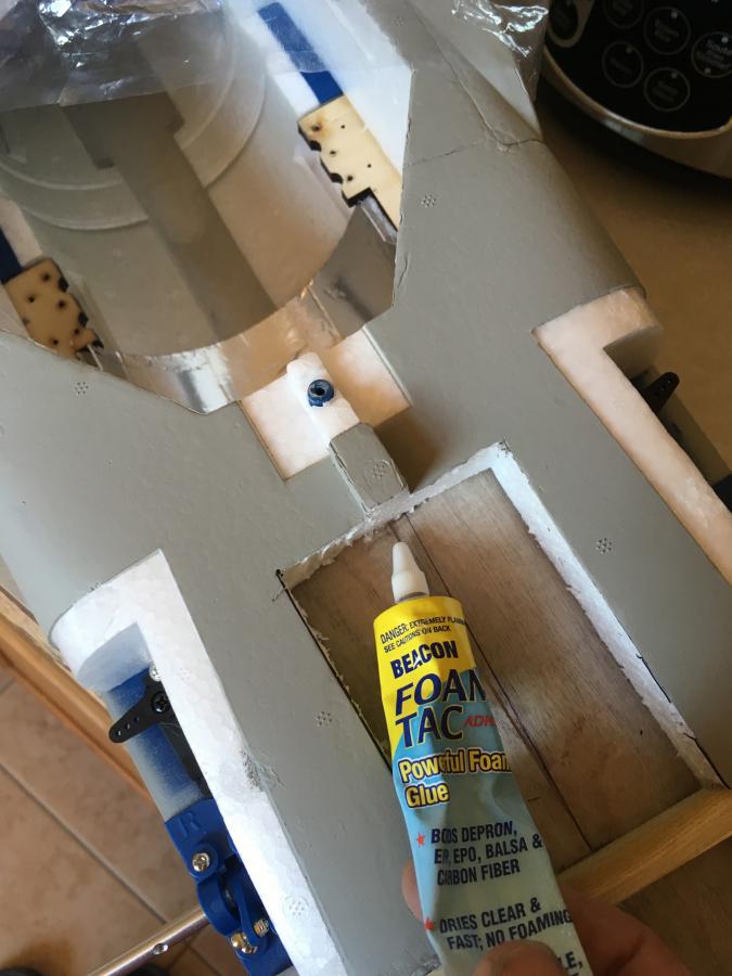

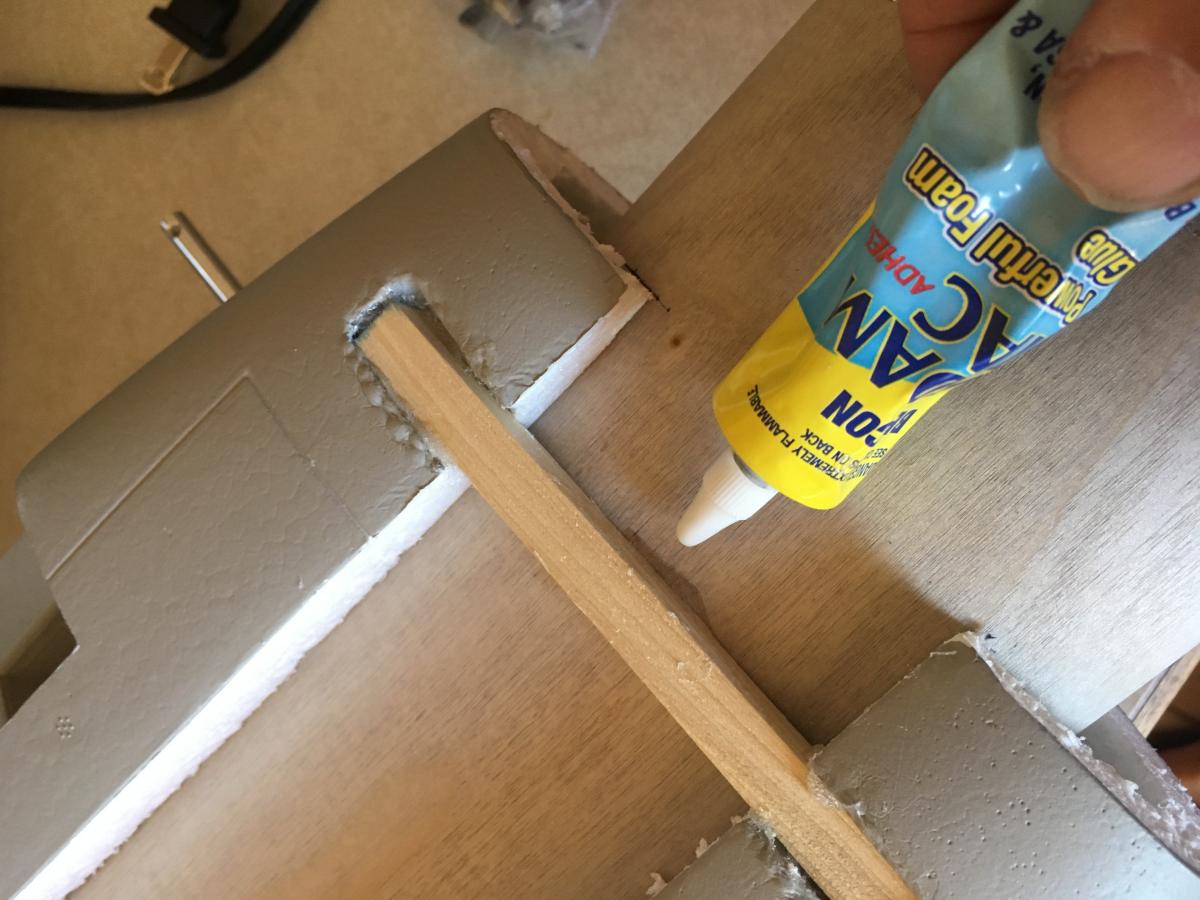

                              Click image for larger version  Name:	IMG_4476.jpg Views:	0 Size:	56.3 KB ID:	211451Click image for larger version  Name:	IMG_4478.jpg Views:	0 Size:	71.7 KB ID:	211452Click image for larger version  Name:	IMG_4477.jpg Views:	0 Size:	50.5 KB ID:	211453 on the top of the fuse i dug out some foam by the 2 boxes an foam tac glued the 3/8 square stock from the hardware store.
                              • #35

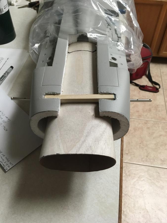

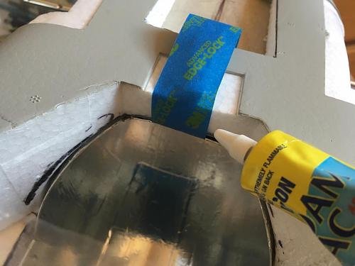

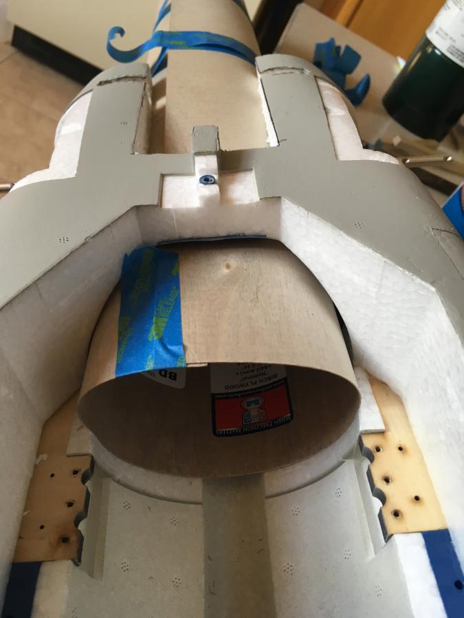

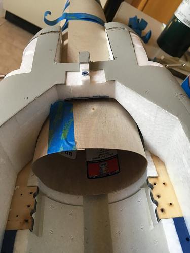

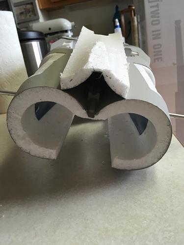

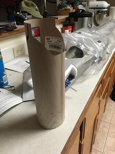

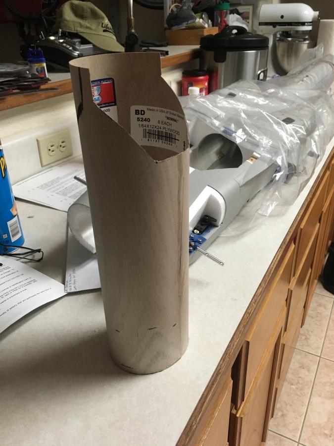

                                Click image for larger version  Name:	image_44527.jpg Views:	4 Size:	54.0 KB ID:	211455Click image for larger version  Name:	image_44525.jpg Views:	3 Size:	74.1 KB ID:	211456Click image for larger version  Name:	image_44528.jpg Views:	3 Size:	62.6 KB ID:	211457Click image for larger version  Name:	image_44529.jpg Views:	3 Size:	61.7 KB ID:	211458 I rolled up and CA glued the 1/64 ply to fit the fan tunnel, it is straight no taper and ovals out at back of the plane. I then used a sharpie to mark where to cut and trimmed it as pictured i also trimmed the rear to be the same length of nozzles when reinstalled.

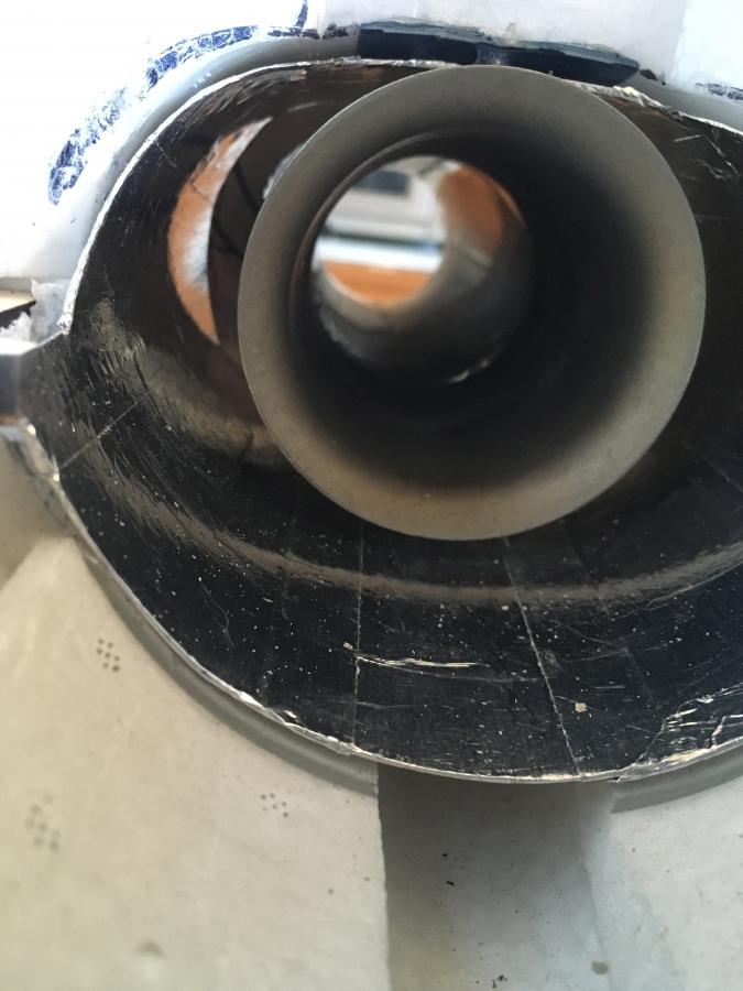

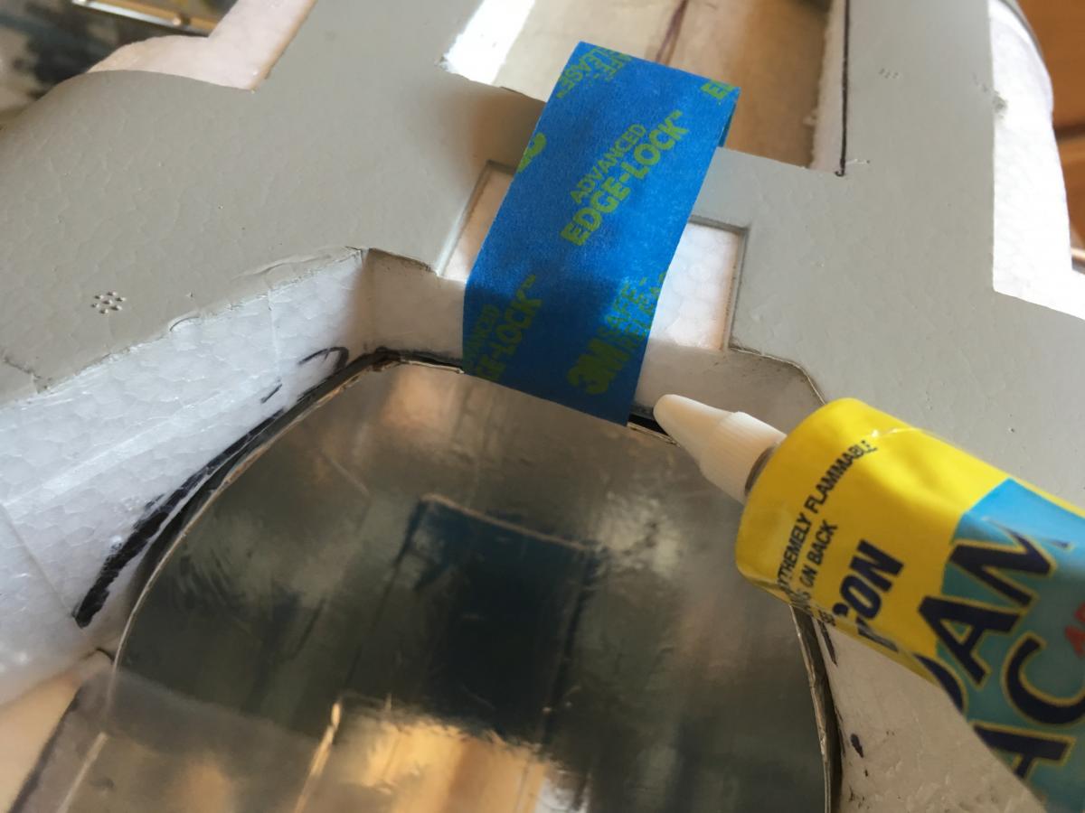

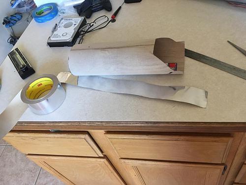

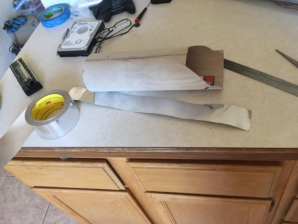

ID:	211461 Next I used foil tape from hardware store to line inside of ply wood tube

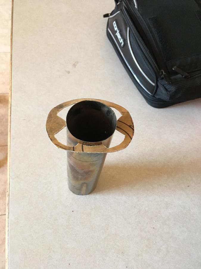

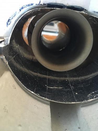

                                        • #40

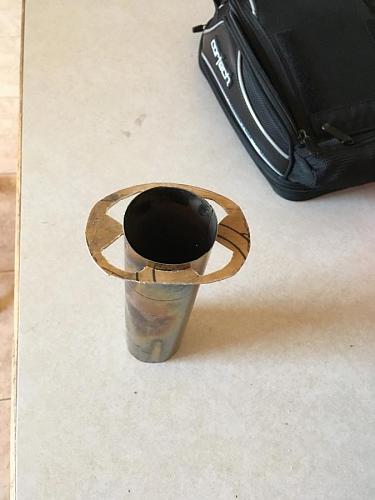

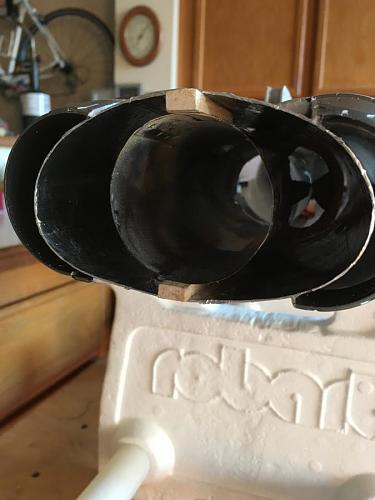

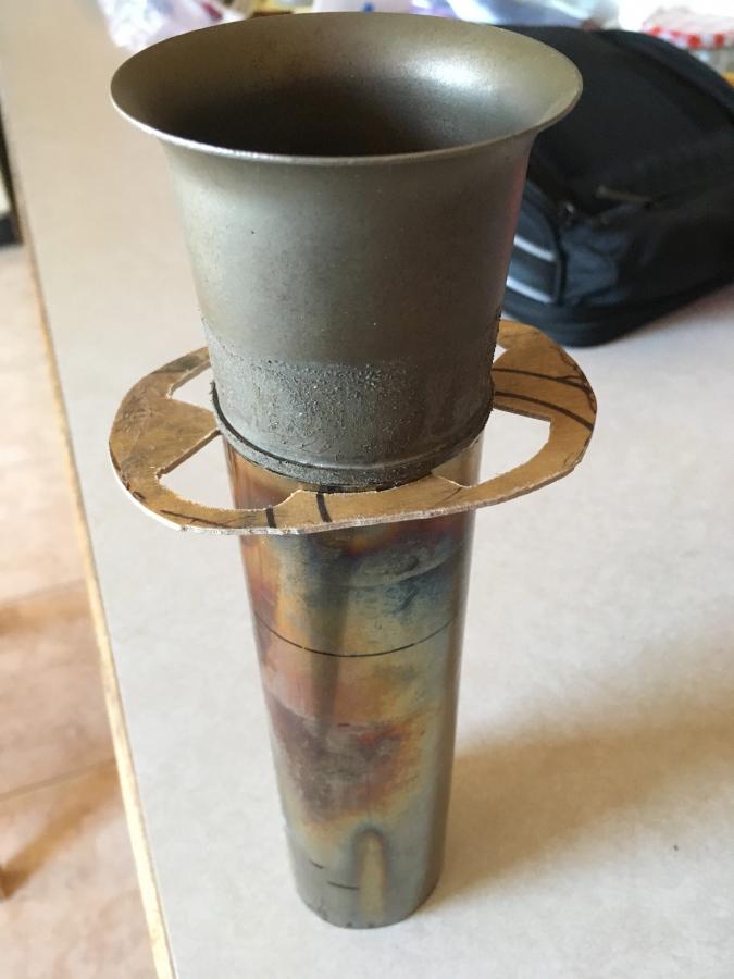

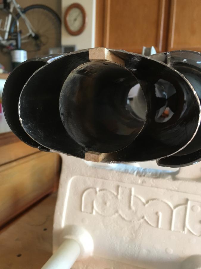

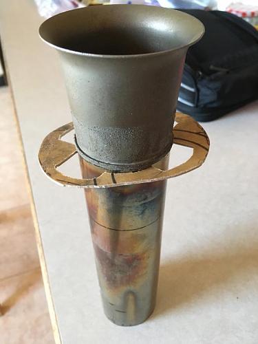

                                          Click image for larger version  Name:	IMG_4516.jpg Views:	0 Size:	61.2 KB ID:	211472Click image for larger version  Name:	IMG_4519.jpg Views:	0 Size:	51.4 KB ID:	211473Click image for larger version  Name:	IMG_4517.jpg Views:	0 Size:	52.6 KB ID:	211470Click image for larger version  Name:	IMG_4518.jpg Views:	0 Size:	50.4 KB ID:	211471 I used 1/8th (i think) ply to make a collar that would support my pipe and allow air to pass thru. I used silicone to glue it to the inside of the wood tube, Make sure pipe is centered up down and side to side. As you can see my pipe is a single wall that I made out of 316 .008 stainless steel with a 48mm Weber carburetor velocity stack. The wood mount ring is ideal for my application. The back of the pipe is spaced with hard wood trimmed to fit gap and maintain center. Back of pipe has a servo size screw (not shown) to secure it to the top rear wood spacer block, easy breezy
