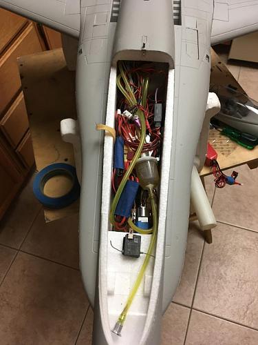

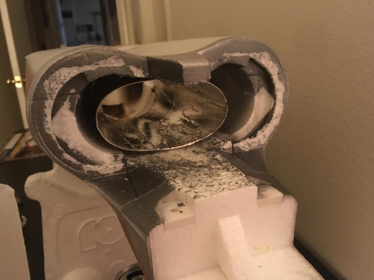

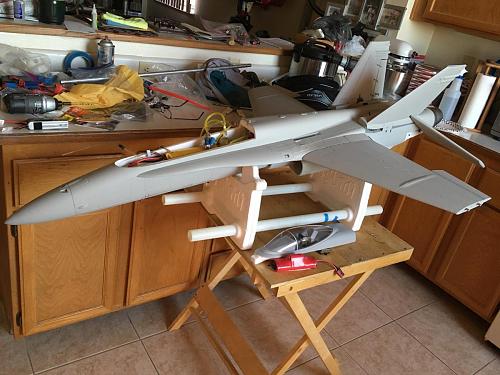

      Click image for larger version  Name:	IMG_4521.jpg Views:	0 Size:	45.3 KB ID:	211476Click image for larger version  Name:	IMG_4522.jpg Views:	0 Size:	56.7 KB ID:	211477Click image for larger version  Name:	IMG_4520.jpg Views:	0 Size:	70.5 KB ID:	211478 I removed the wood plate, then flattened out the floor in the back, an 8oz nail polish remover bottle is a nice fit in the well, on top of that is a 16oz tank, the top tank feeds the bottom. So far 4min mixed throttle only uses the 16oz, i like the extra reserve in case I have to loiter, out of fuel is no good.

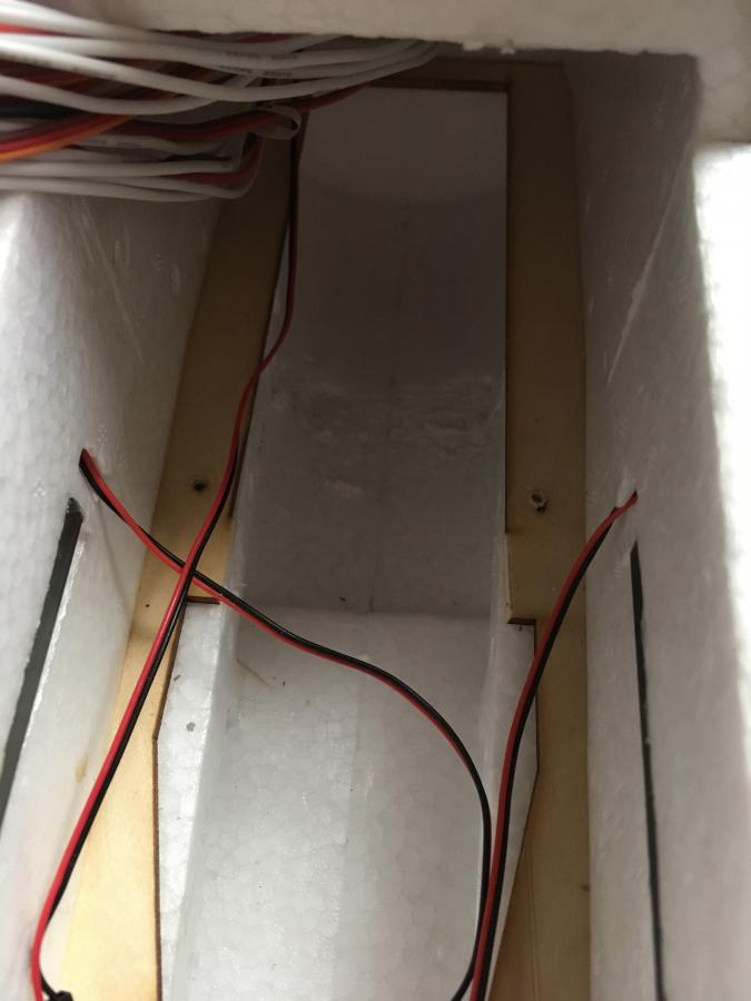

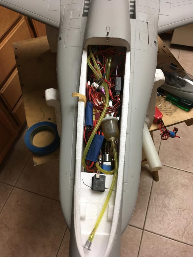

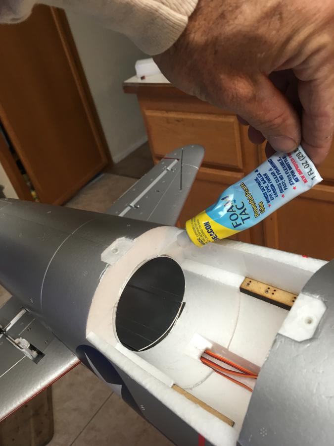

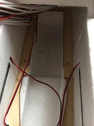

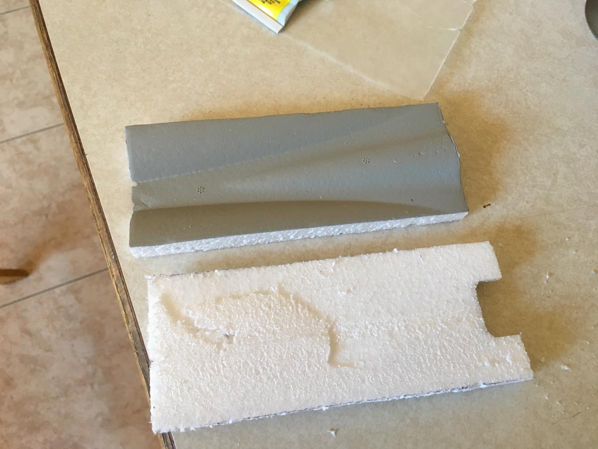

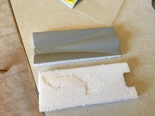

ID:	211484 Oops i missed these pics, using the cut out foam pieces i trimmed them to fit as best i could and foam tac'd them back in place Click image for larger version

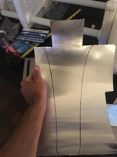

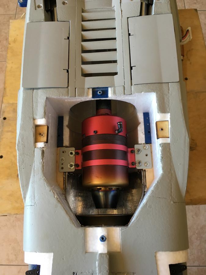

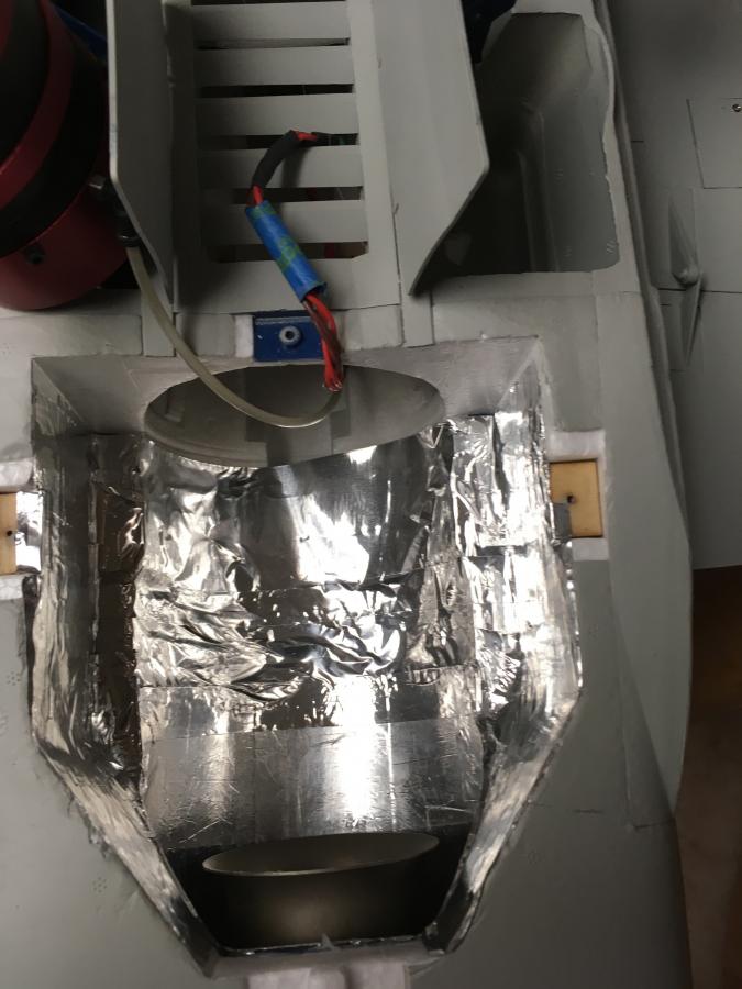

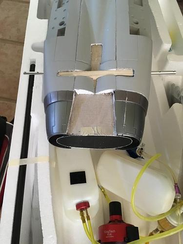

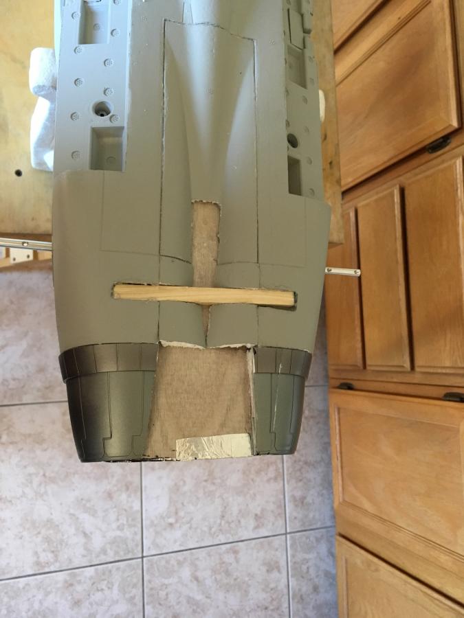

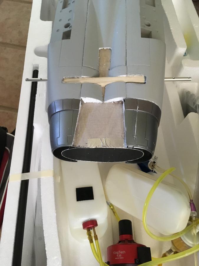

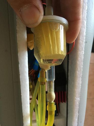

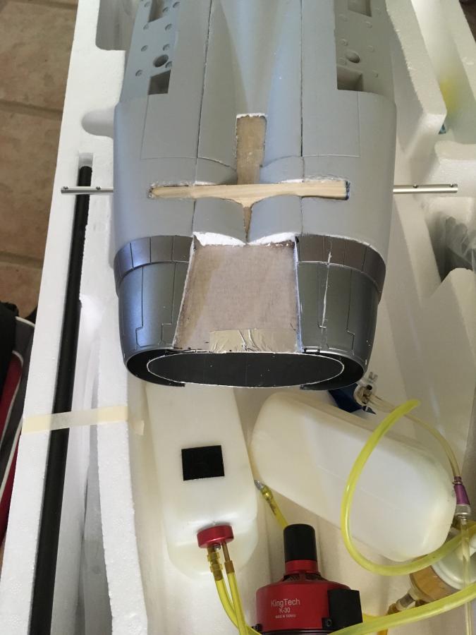

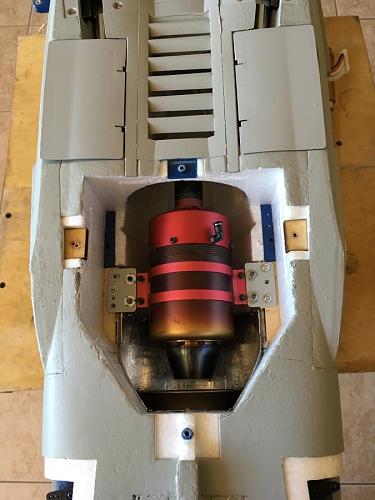

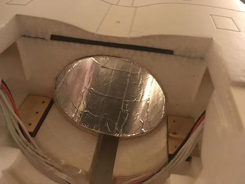

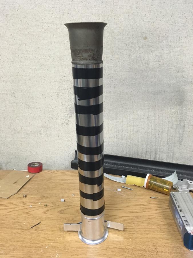

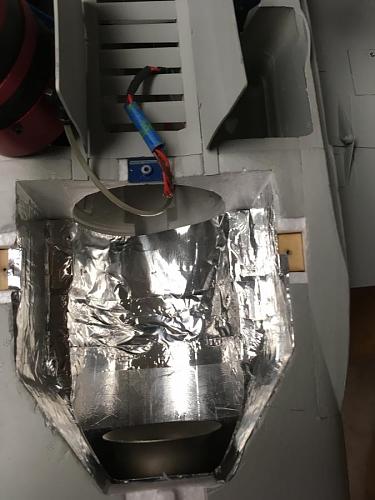

          Click image for larger version  Name:	image_44550.jpg Views:	3 Size:	50.7 KB ID:	211497 Getting close, I used the foil tape to line the engine compartment. Click image for larger version  Name:	IMG_4526.JPG Views:	0 Size:	144.6 KB ID:	211486Click image for larger version  Name:	IMG_4525.jpg Views:	0 Size:	65.8 KB ID:	211487Click image for larger version  Name:	IMG_4528.jpg Views:	0 Size:	71.3 KB ID:	211488Click image for larger version  Name:	IMG_4527.jpg Views:	0 Size:	67.8 KB ID:	211489 My UAT is a small gas filter that i Areopoxy (hysol) glued brass tube to reduce nipple size for fuel tubing, I also very carefully drilled and glued a brass fill tube into the filter body DON'T poke the filter Element, they work great just make sure ALL of the air is out of the down stream side.
          • ms200a
            • 25
            #45

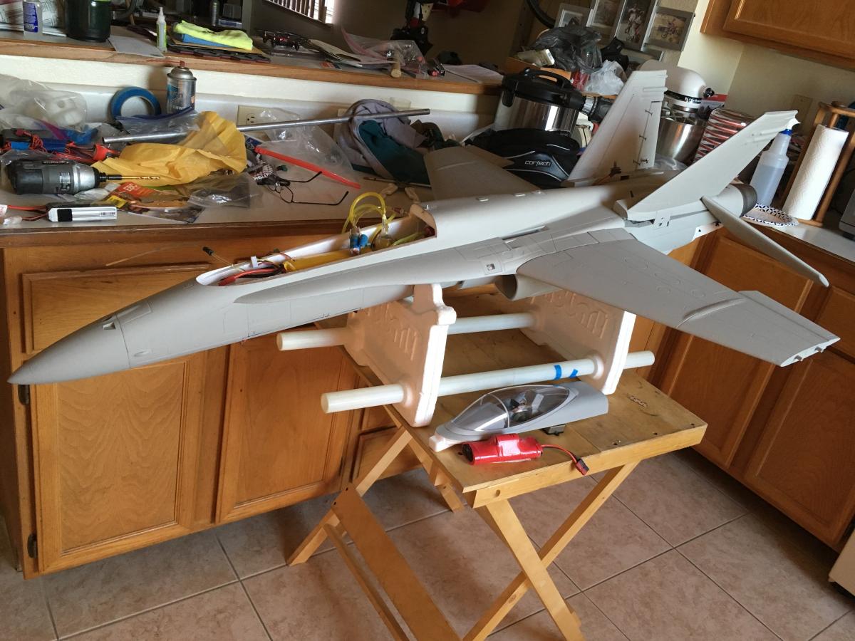

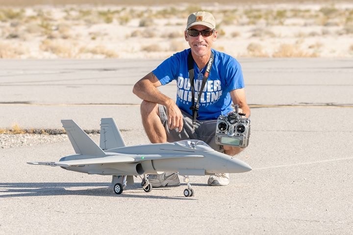

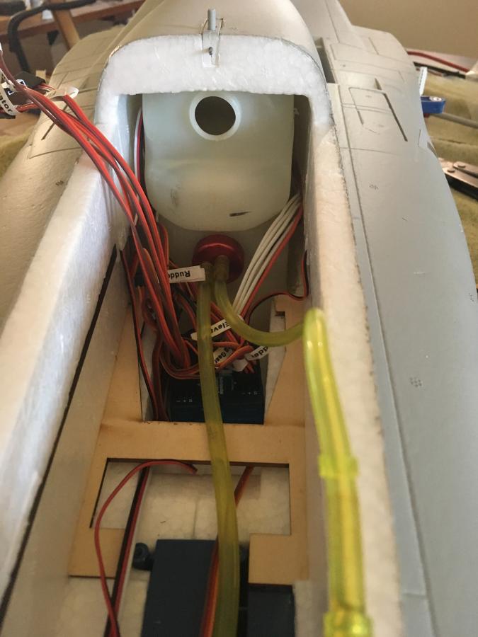

            So that's about it Flight performance is very good. C G of 88mm is a good start because everybody is different. I'm using a 3000 NiMH 7 cell truck pack for ECU and a voltage regulator for the receiver. I have 4 of these truck packs ($16.00) each (take that lipo/ life) and use them in my thurbinator as well. The 8.4v pack and 4 each lead .45cal slugs in the nose to balance mine at 88mm. The plane dry is 8.8 lbs add 20oz to that for ready to fly weight. No flaps on take off, and take off flap on landing, Pitch is easy 5% expo, the roll is sensitive 30%expo JR 10x radio. Will post more pics as i get the back of plane cleaned up,. Remember it's a toy not a scale master entry. Click image for larger version  Name:	IMG_4535.JPG Views:	0 Size:	80.4 KB ID:	211493

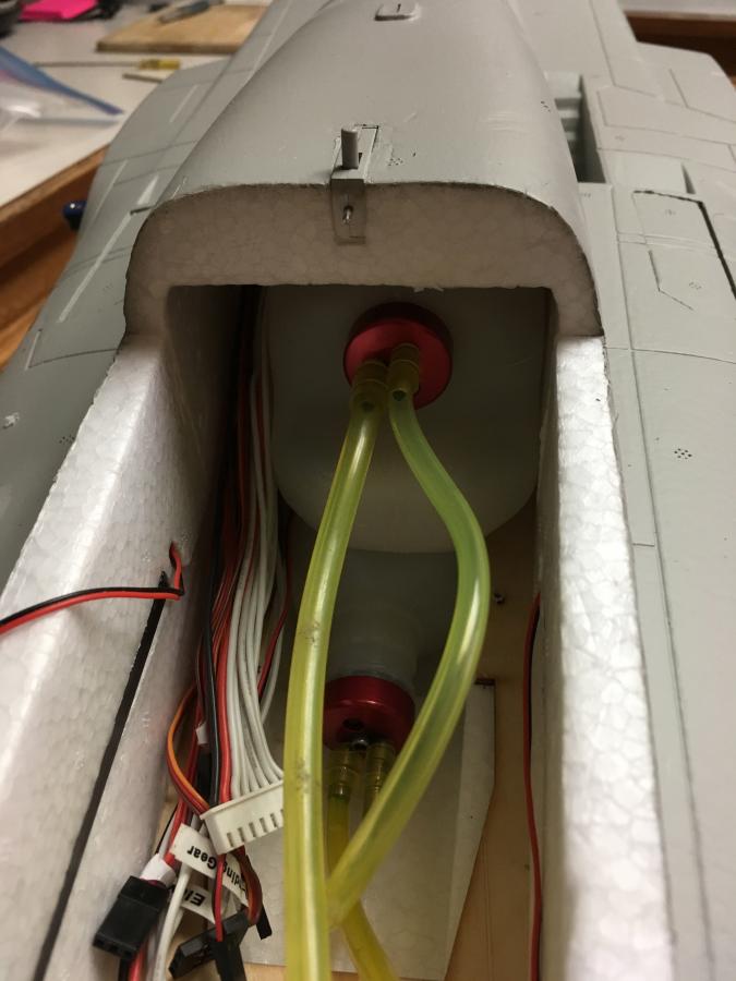

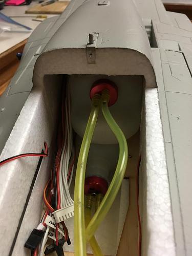

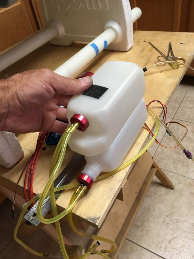

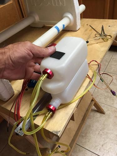

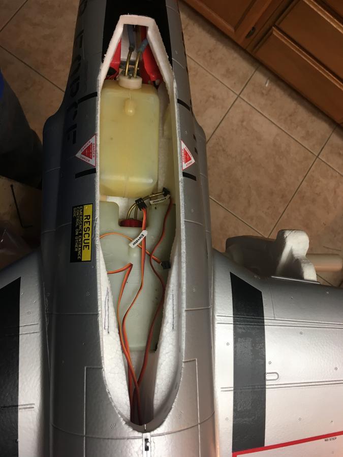

                                Updating F-18 fuel system from 24oz to 32oz . Stacking 2 16oz dubro tanks. should give solid 5min flights with 3min reserve. maybe more. Click image for larger version

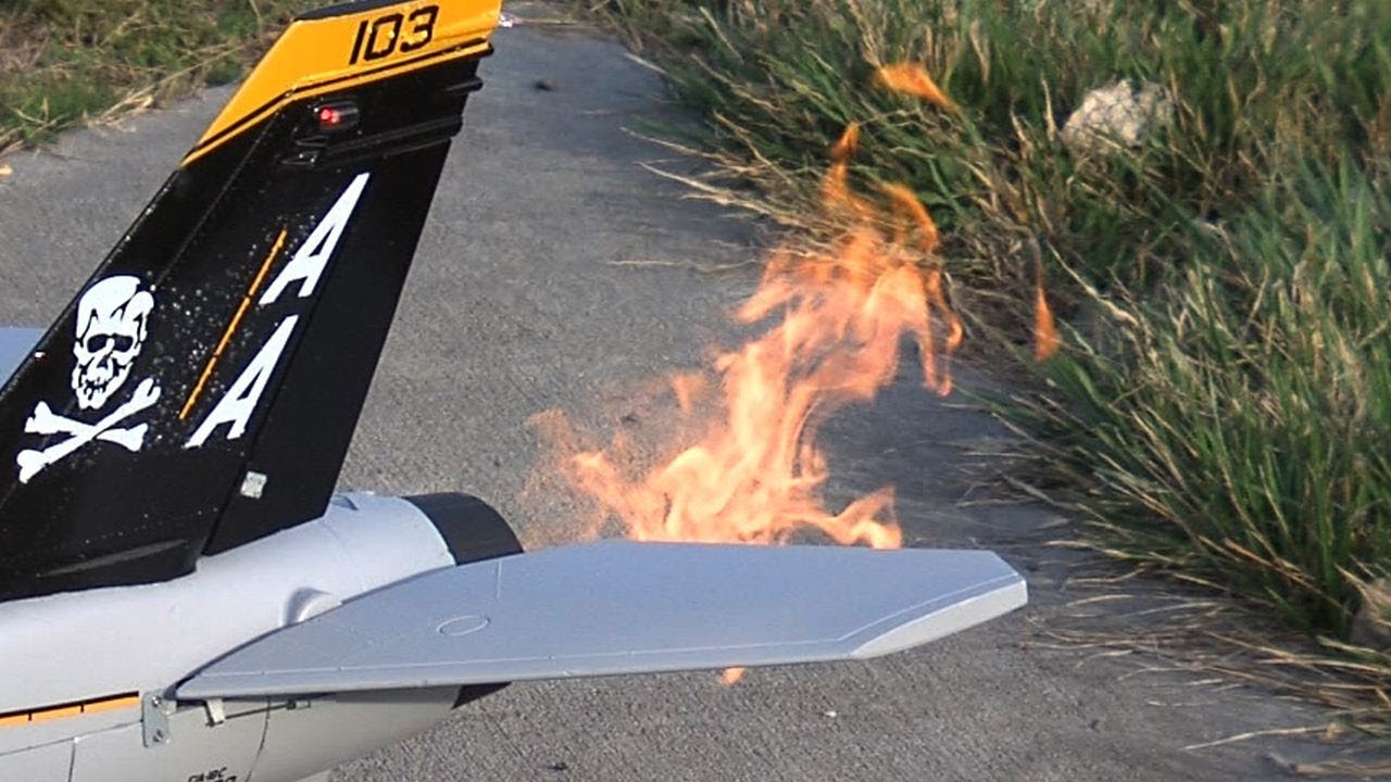

                                  • ms200a
                                    • 25
                                    #57
Name:	f-18 at lake bed.jpg
ID:	214477 F-18 last weekend video by Tony
                                    https://www.youtube.com/watch?v=cWn3...hOx4b78XX5-Igc

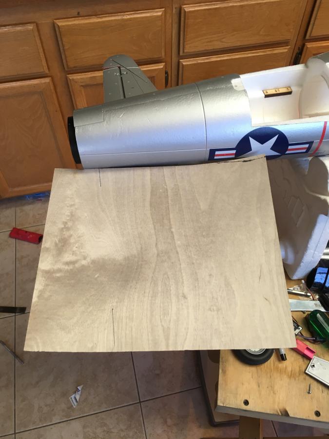

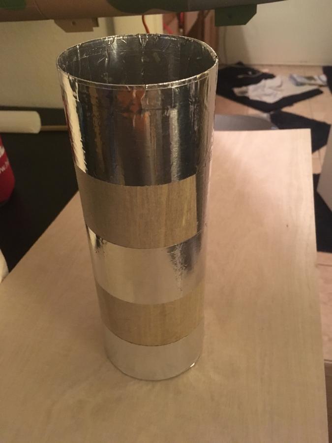

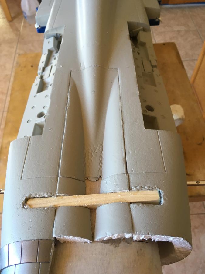

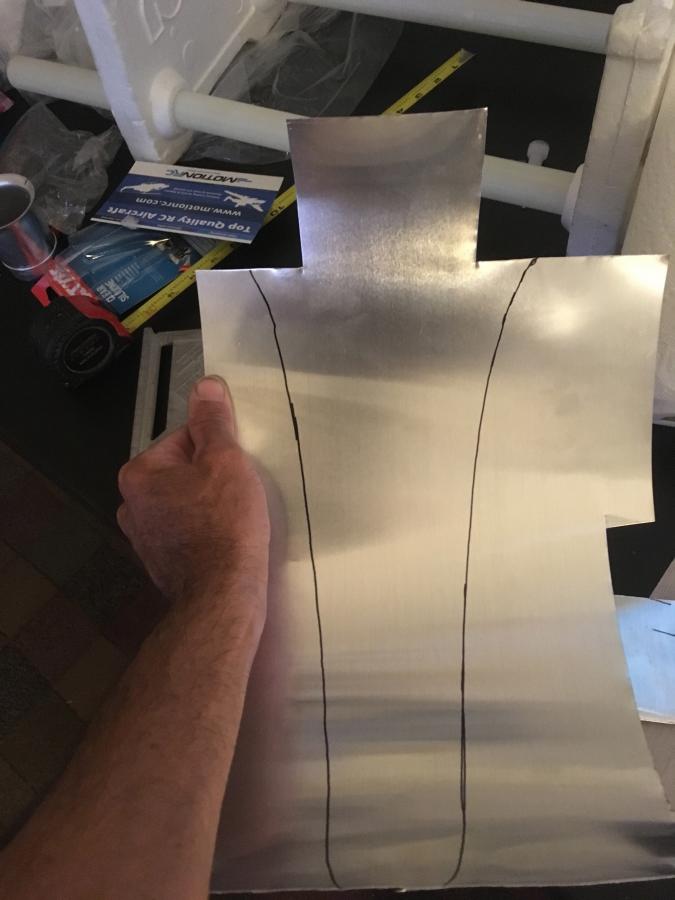

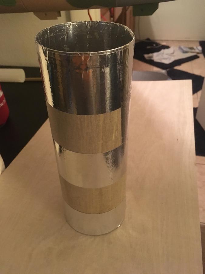

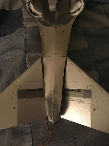

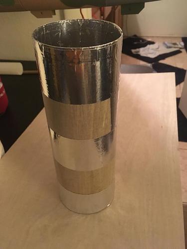

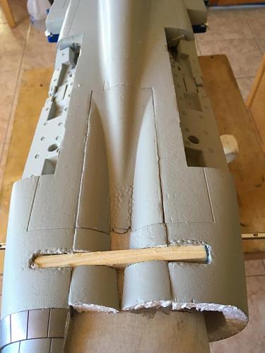

ID:	216460 So now that the F-18 is up and running it’s time to convert the F-4.
                                      Step 1 was to remove the turkey feathers and then hollow out the center of the fuse to allow for a heat shield and pipe.
                                      Using 1/64 ply to make the heat shield, I rolled up a 90mm tube, then used aluminum tape on the inside and outside seams. The tube will be glued with foam-tac in the front and back.
                                      Next will be installing turbine pipe anchor points, and fabrication of the heat shield for tail section.
                                      • ms200a

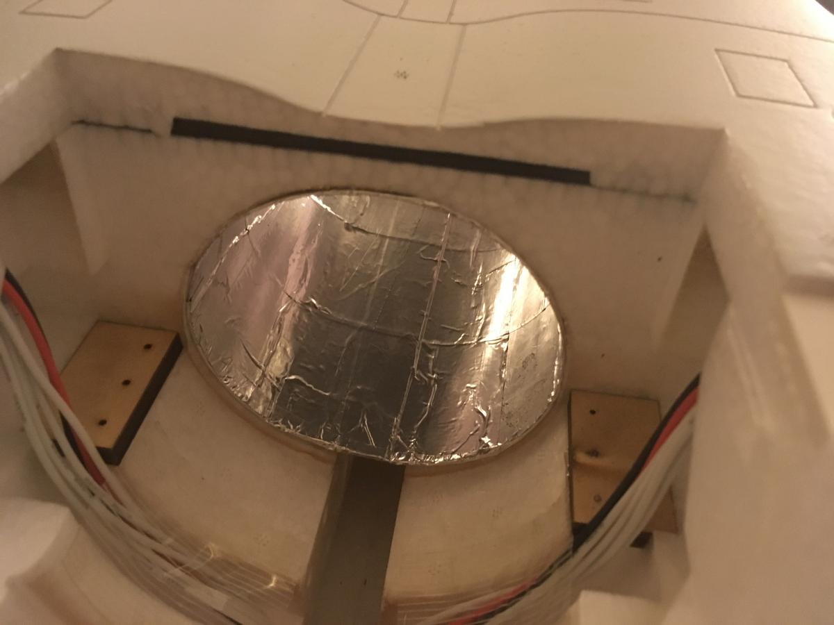

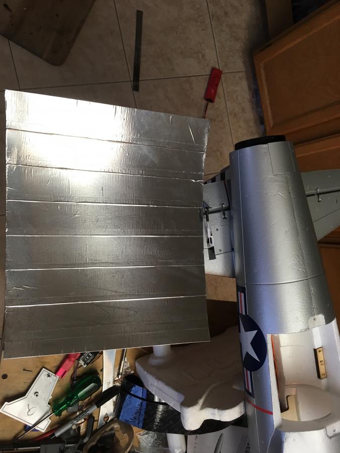

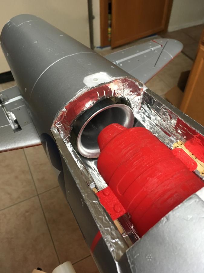

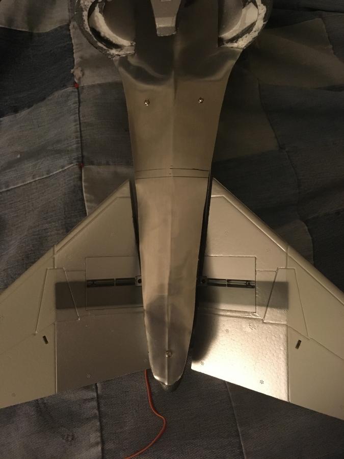

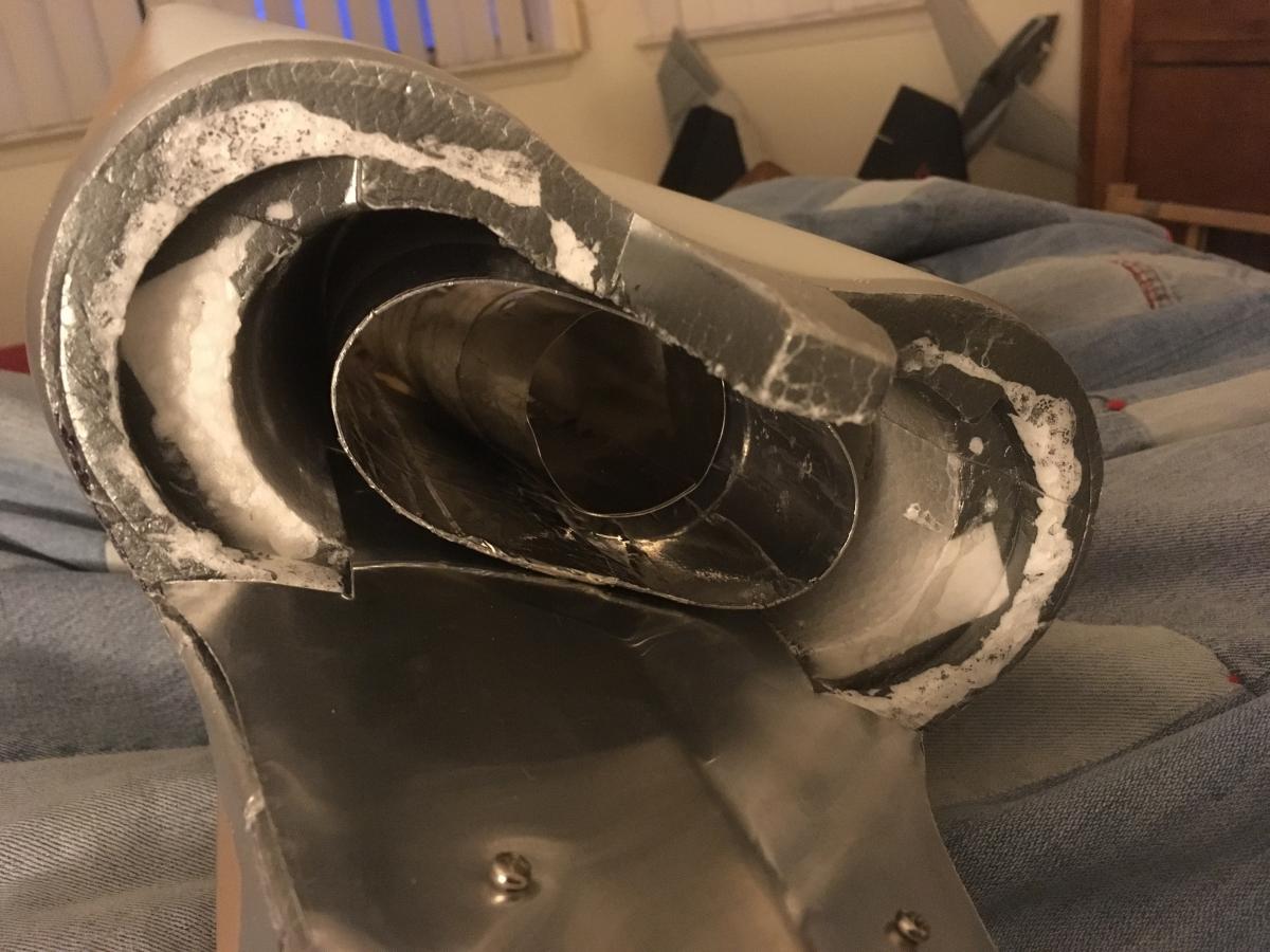

                                        Got a little more done on the F-4 heat sheil Click image for larger version
ID:	216630 d Click image for larger version
ID:	216628Click image for larger version
