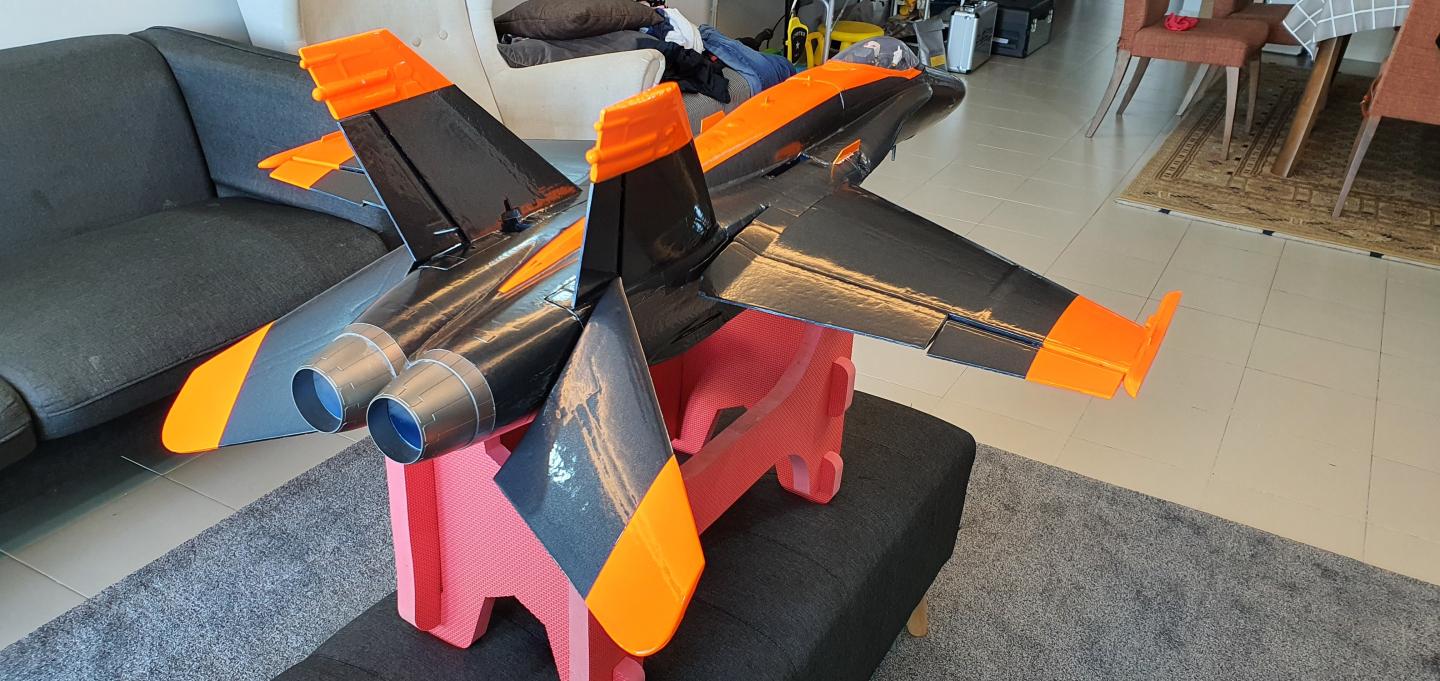

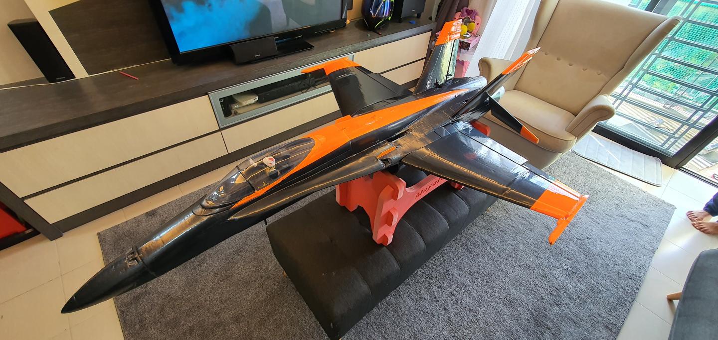

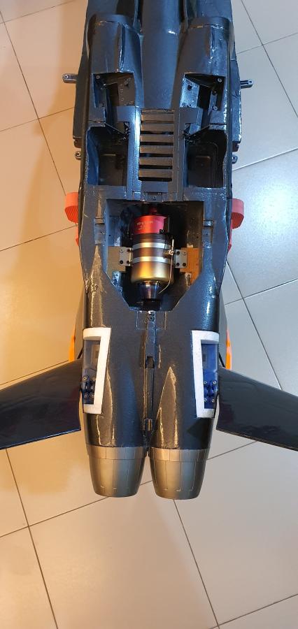

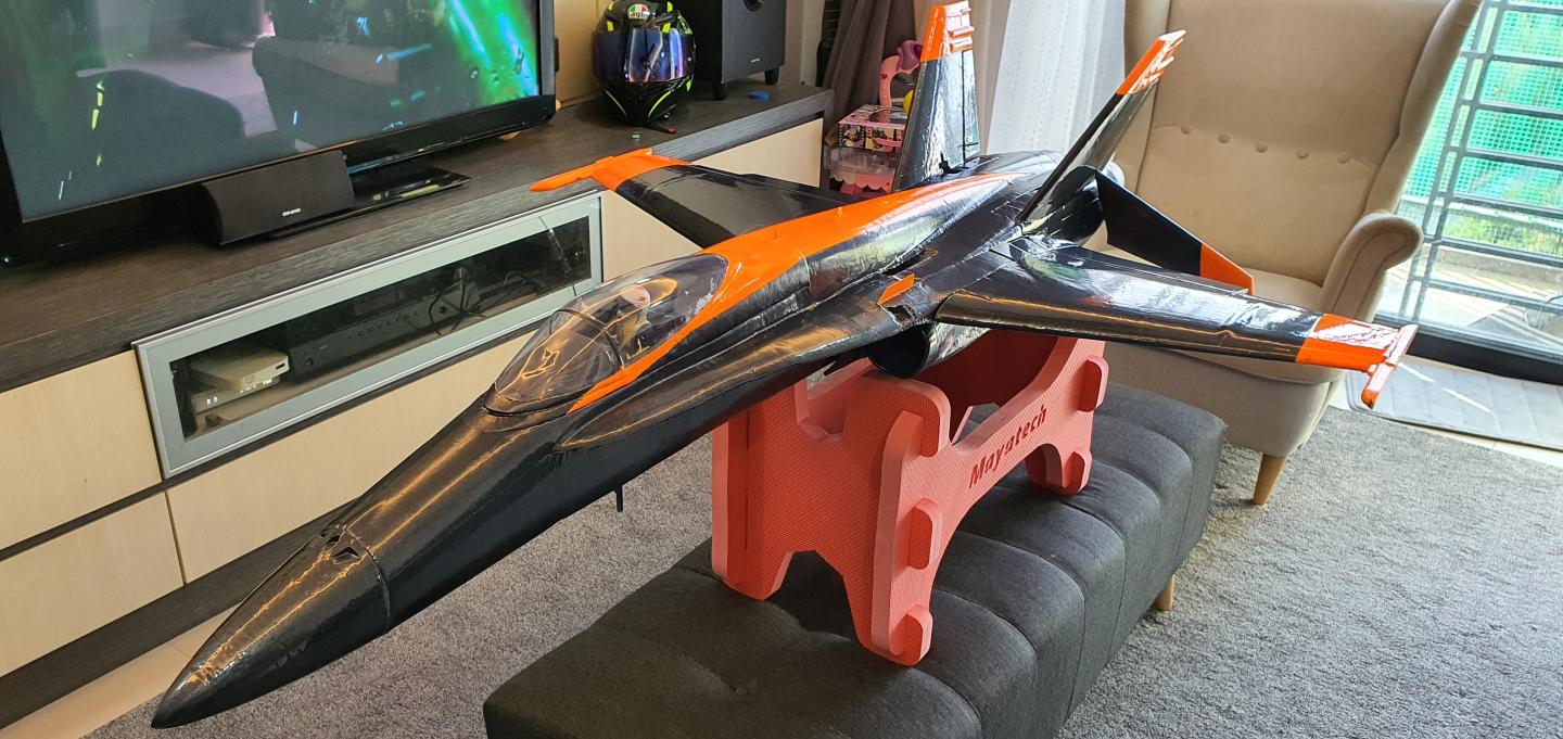

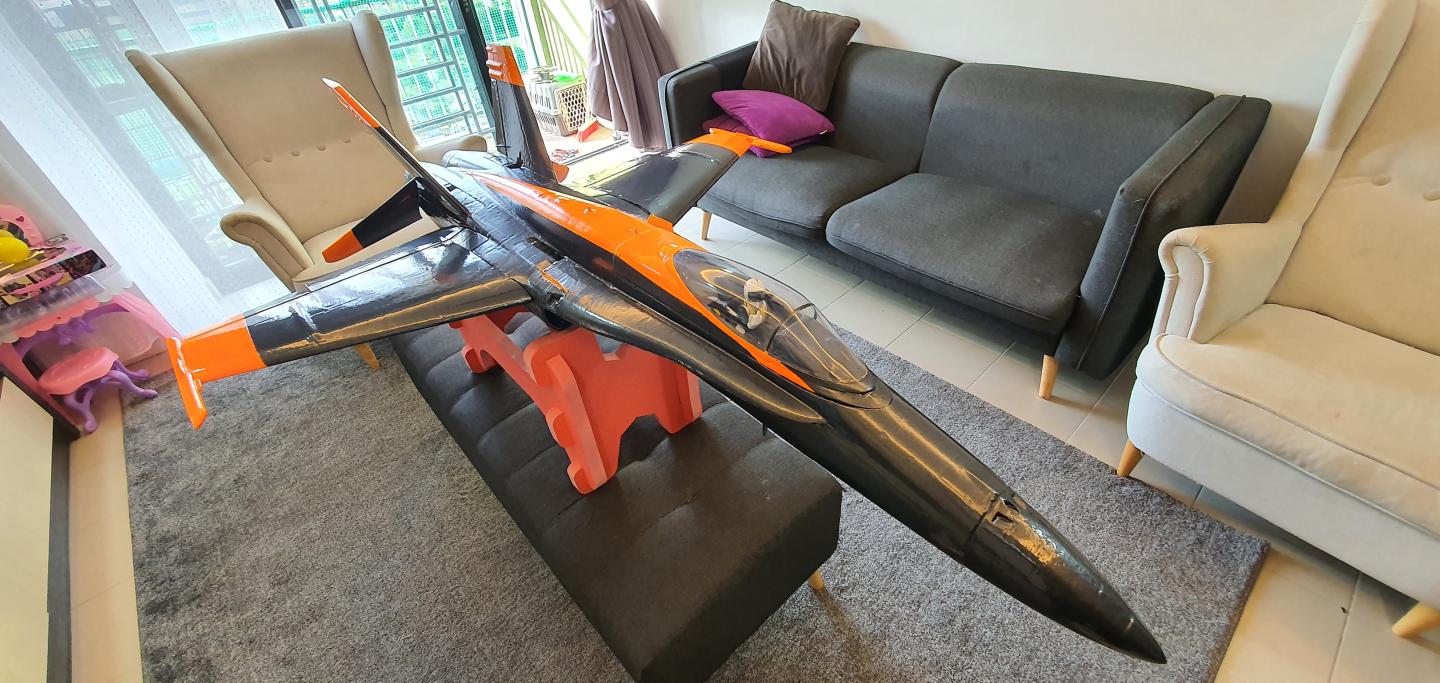

        Hi everyone. I've just complete restoring the F/A 18 Blue Angels. The jet was not mine but i pick it up (trash) after the pilot crashed it and broke into pieces. Took it home and start to restore everything. Decided to apply the fibre glass and repainted it. From Blue Angels, she is now Grey Ghost 🤣. I am now converting it to turbine. You may also check out the video on youtube https://youtu.be/L-c35Rzu4Vs

          What parts did you fiberglass??

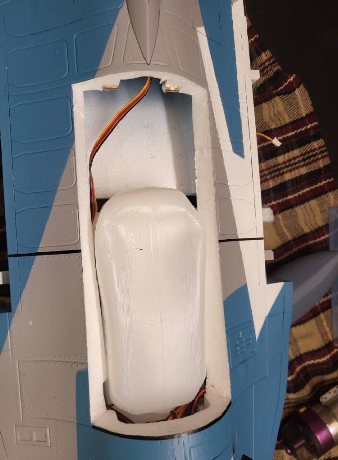

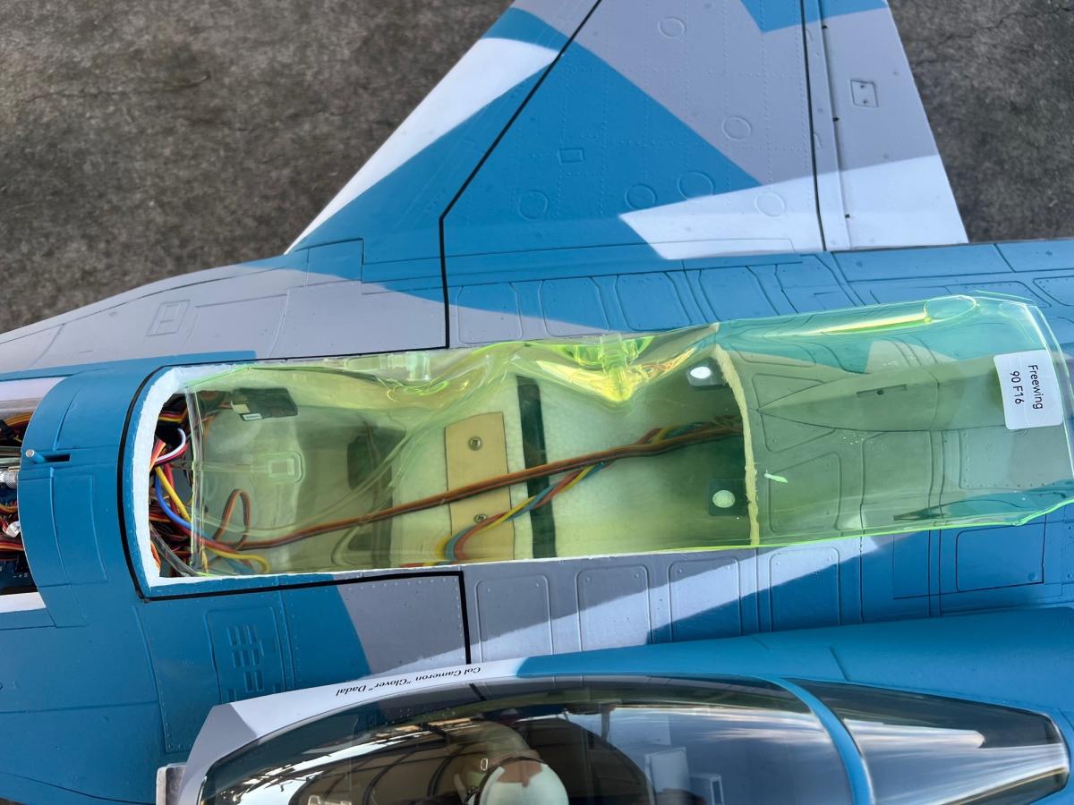

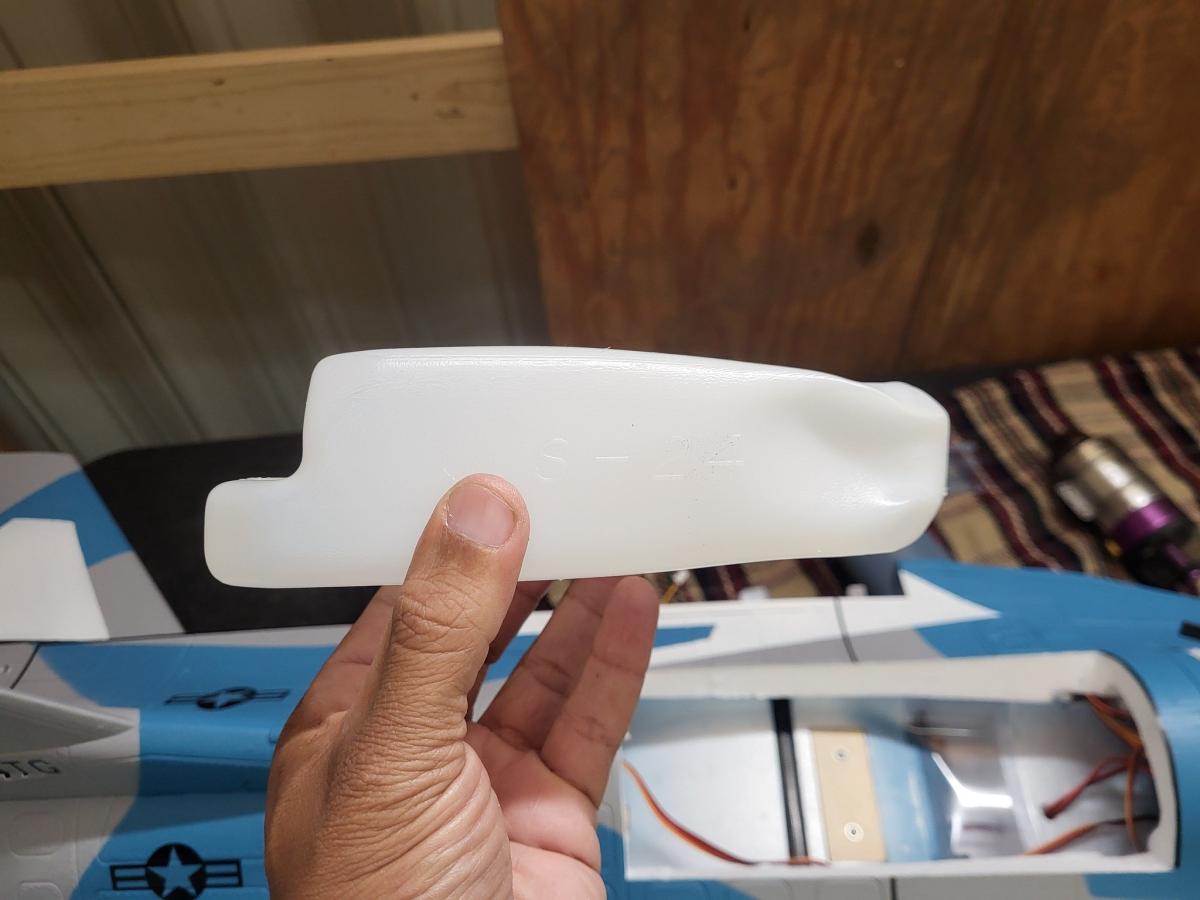

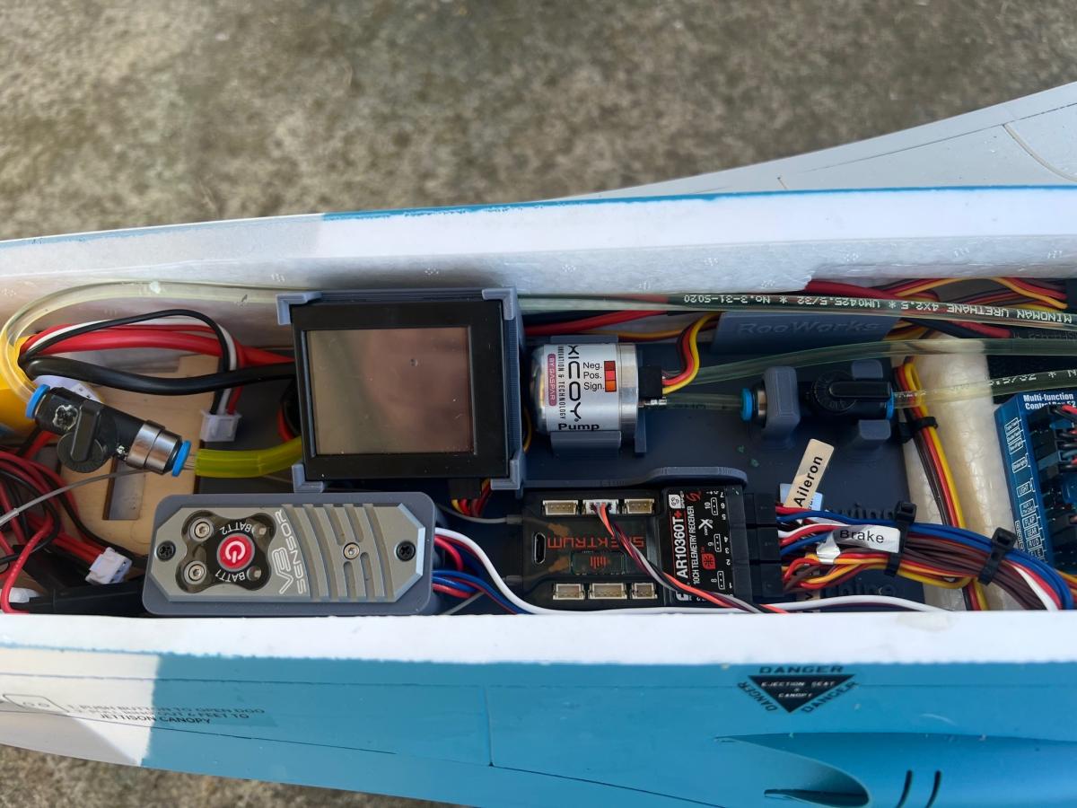

                  Yeah we have been flying a turbine converted F-16 V2 for about 6 months now. I made a custom equipment tray for up front,used a custom 1lt bladder tank in the hump because the shape makes standard fuel tanks a compromise, and I made a hatch for access to the tank. lower cheater delete panel and thrust tube support rings for the tail cone. It's a buddy's model but I have 3-4 flights on it now and LOVE it. great fun, It's still on my Tx so will get a few more flights on it soon enough.
