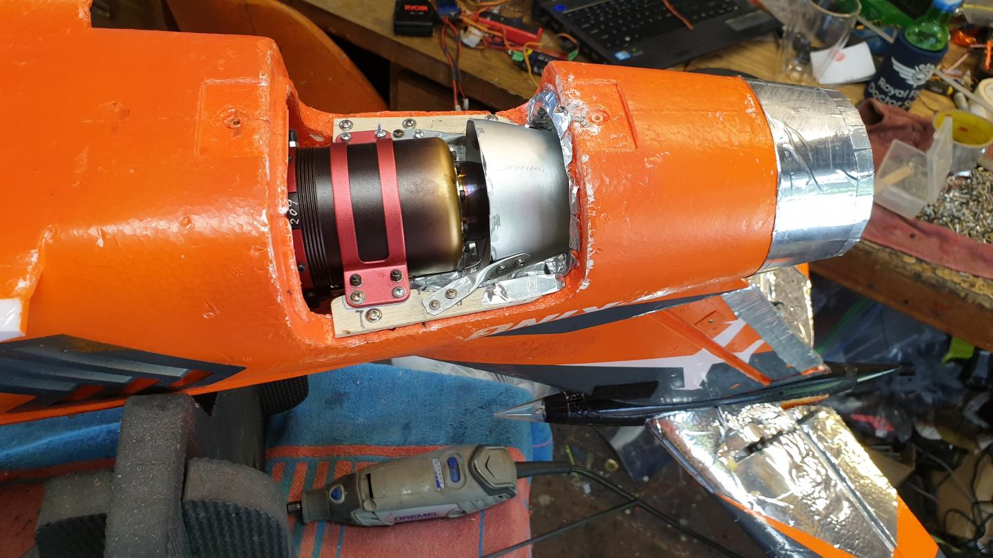

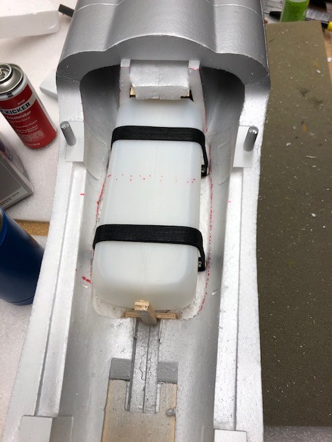

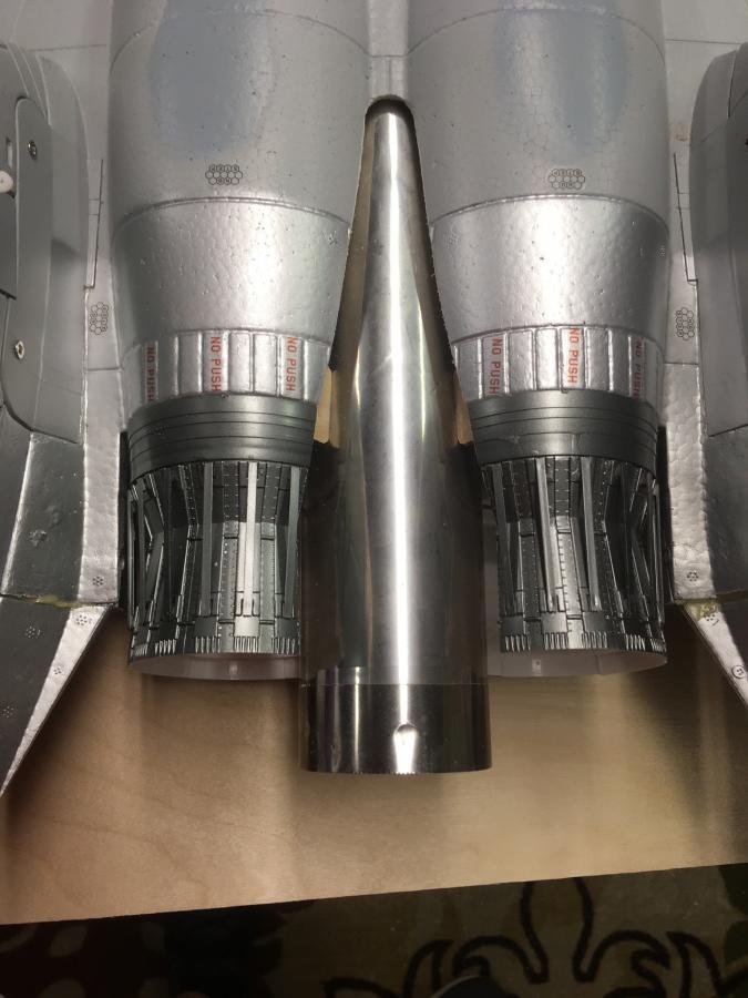

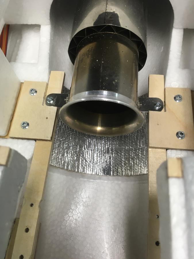

    Used 1/64 plywood with aluminum tape then rolled to line the tunnel. Made single wall pipe From 316 .008 stainless and using 48mm carburetor velocity stacks on both ends to keep pipe true while spot welding. Then trimmed to final length. After removing some foam a 16oz Sulivan v boat tank will be the main. A 12oz is placed in font of to and will feed into the 16oz. Will post more as project moves forward

      Nice to see some posts here. I am surprised that there are not more as the Freewing airframes lend themselves really well to conversions. I have done the Avanti 80mm, F22 and the L39 so far.
      I am not knocking your T33 conversion but those tanks are quite a bit forward of the CG. You will have your hands full with that set up. Here is a pic of a 24 oz Dubro right over the CG with just a little hollowing out of foam.

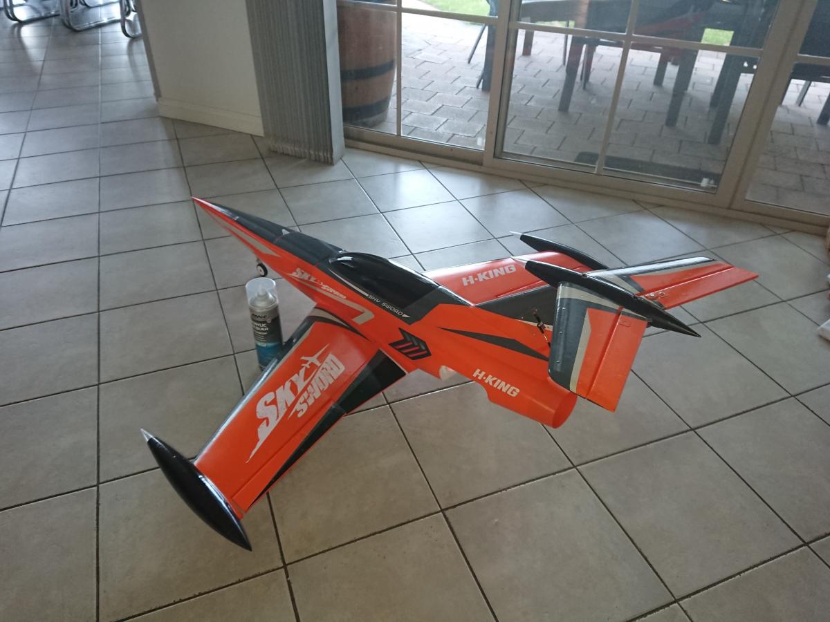

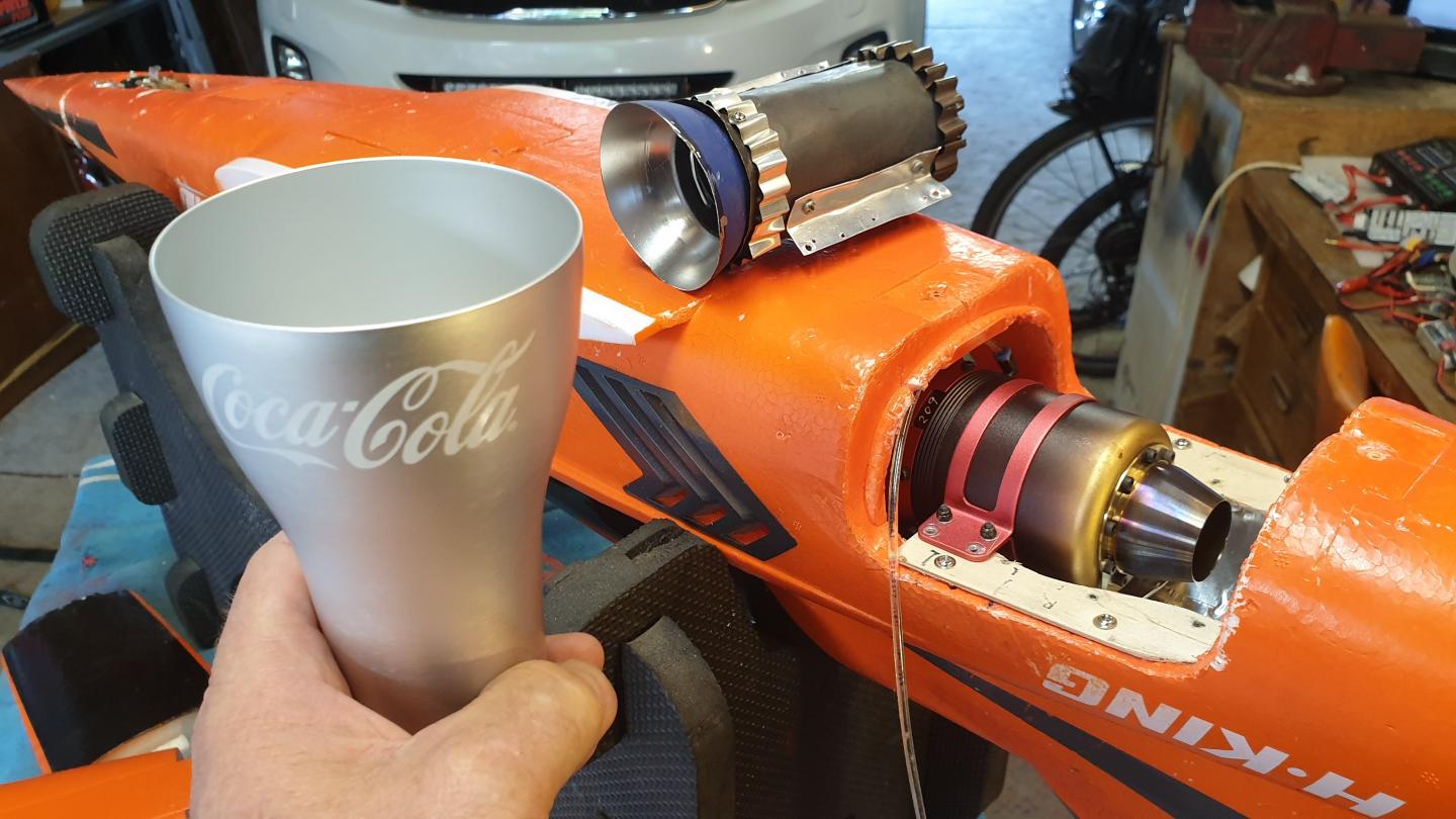

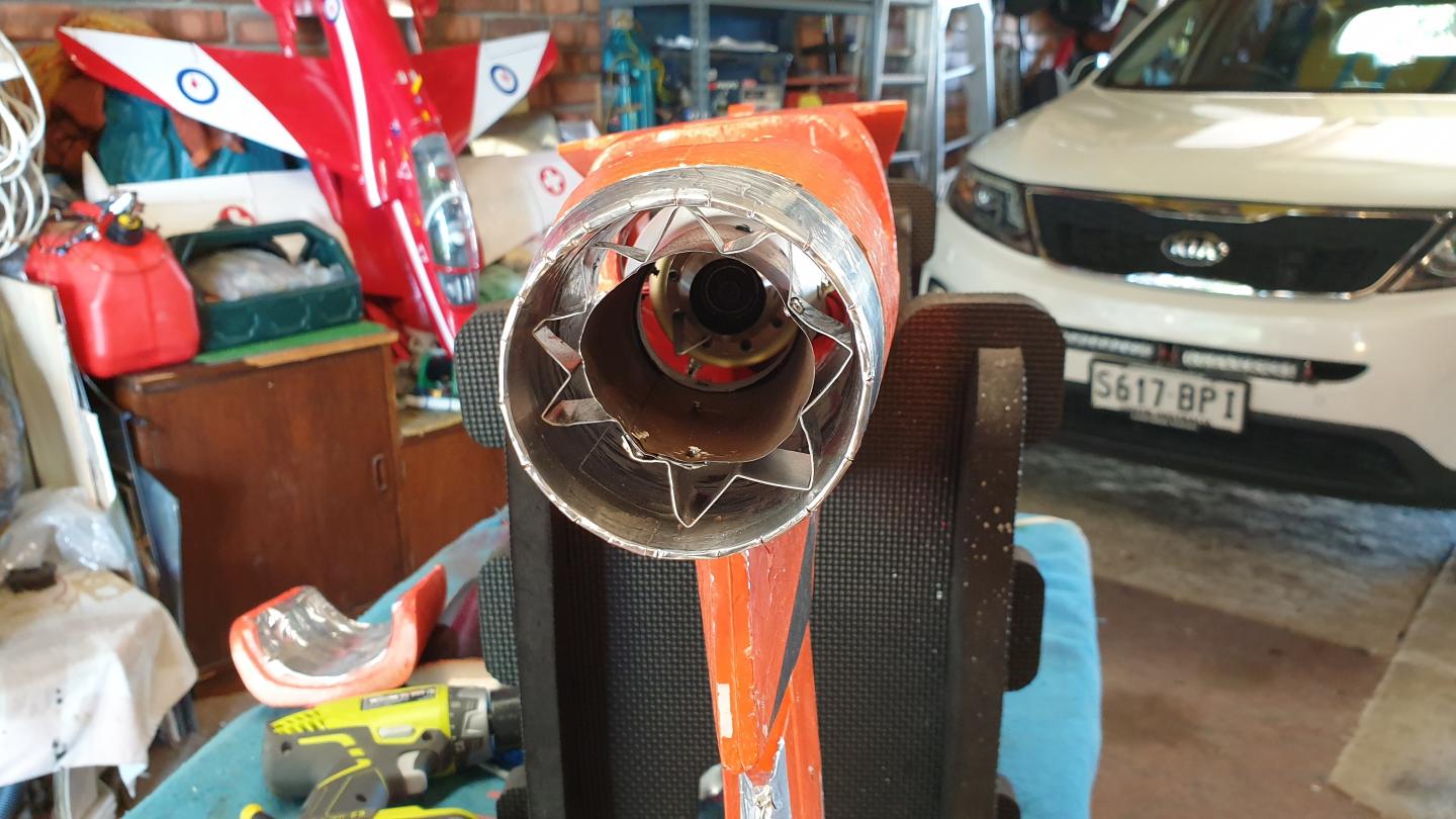

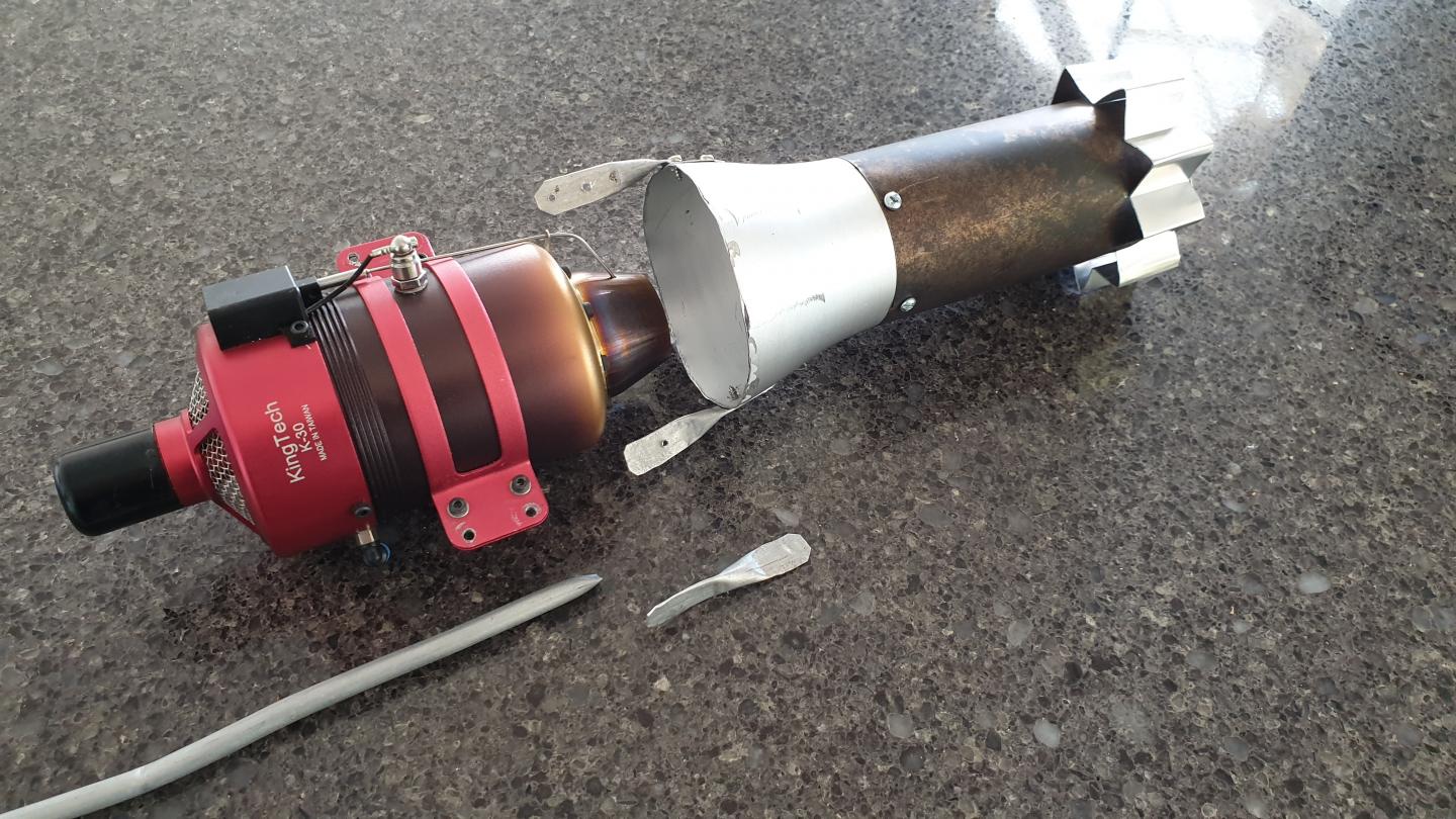

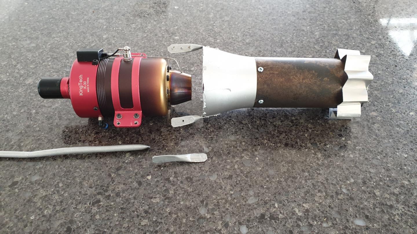

        Recently, I fitted my K30 to my very old Skysword, removing the P20 in the process. I wanted more power and needed the P20 for another project, but found that I needed a bigger diameter pipe for the 7lb thrust K30. Just by chance, McDonalds are selling a aluminium cup for $3 and it looked perfect for a bellmouth! I bought a couple, rolled up a single wall pipe and fitted everthing and had a chance to have a couple of flights. The result was spectacular, way more power, much quieter in the air and unlimited vertical. Also, if you want a simple front pipe mount, flatten a bit of aluminium or brass tube at 90 degrees to each other and you have a very strong metal mount.

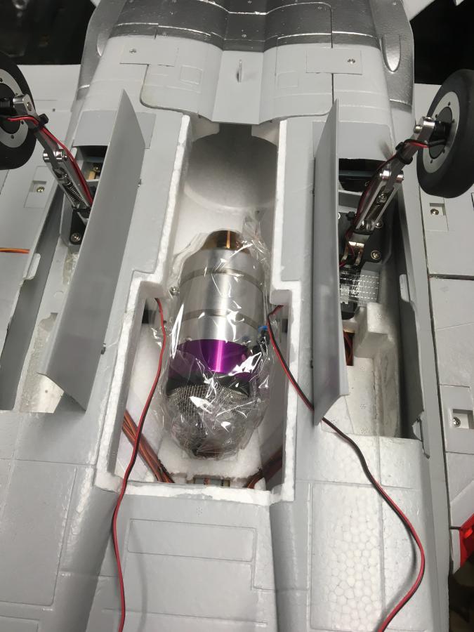

                            Got the x45 ordered and the Avanti ARF from motion is here., now to HAB and a way we go!

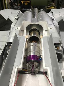

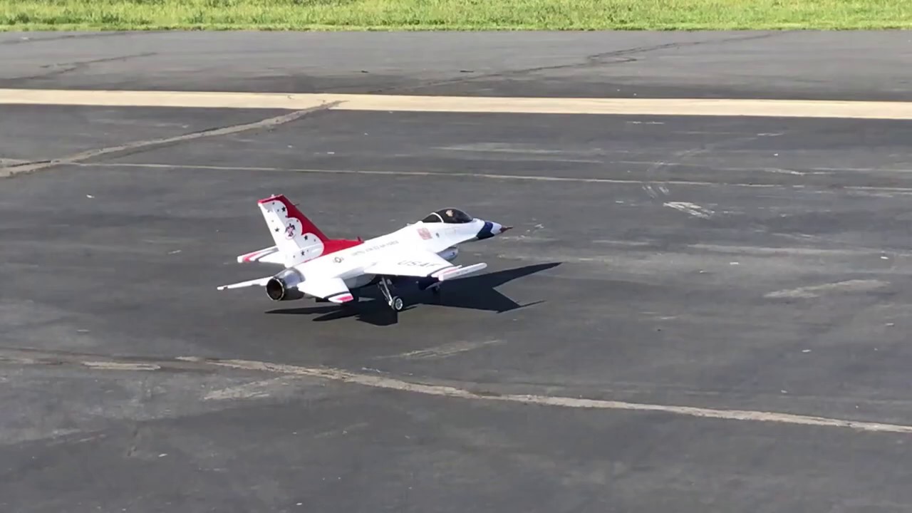

                                Boys I just had a a nice and aggressive "Air Show" type flight last week with my FW T-Bird F-16. Printed and and also modified with functioning speed brakes that worked perfectly in flight for landing. Also threw a centerline tank on her
                                • #76
                                  Here is the video of the Sortie! This jet is powered with the K-30g3. Jets burns more fuel, but is louder and faster than the X-45 version

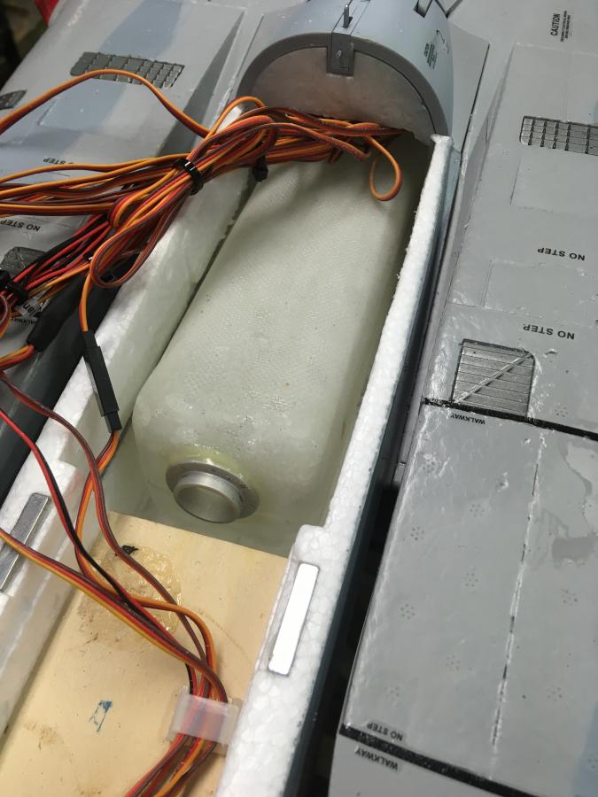

                                    Has anyone done a conversion of the FW 90mm F-15??
                                    A lot of room in there!

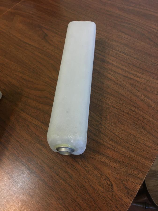

                                    Funny you should ask. I recently converted one for a friend. Made a custom frp tank that hold 30 oz. it flies great.

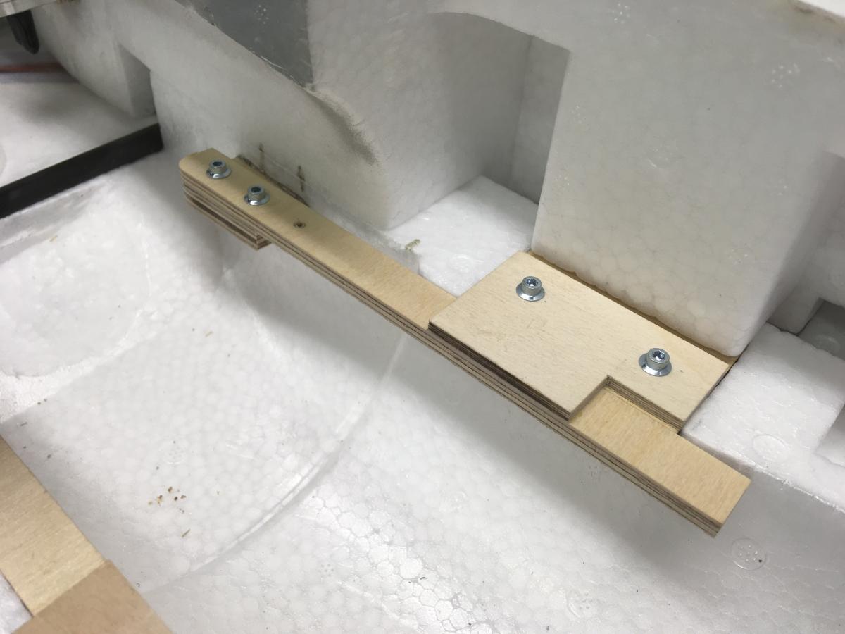

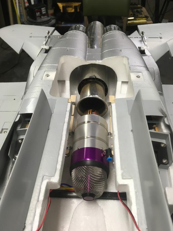

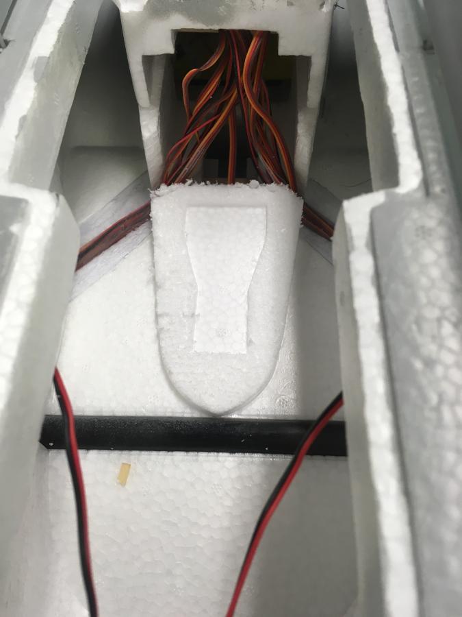

                                        • #80
