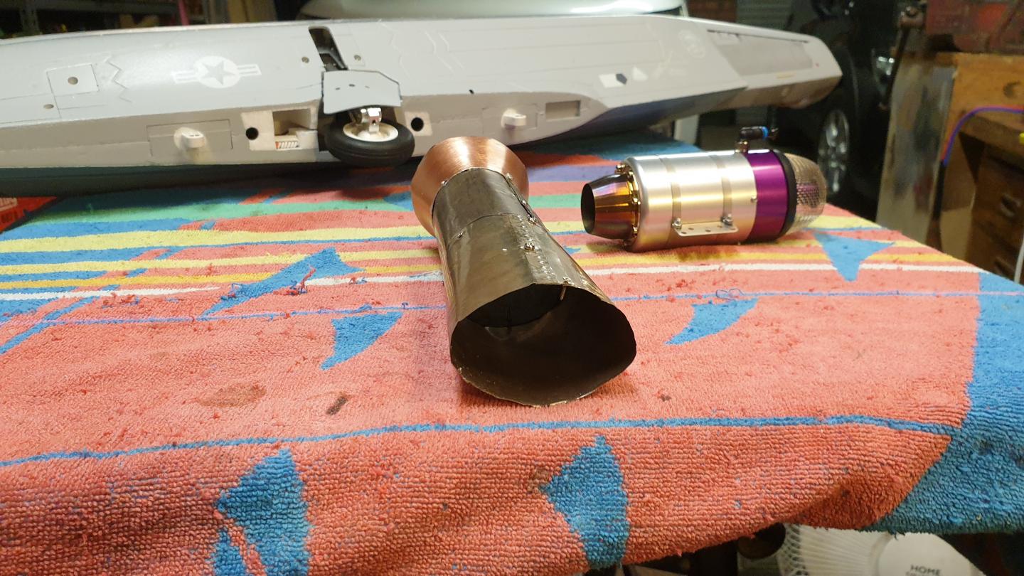

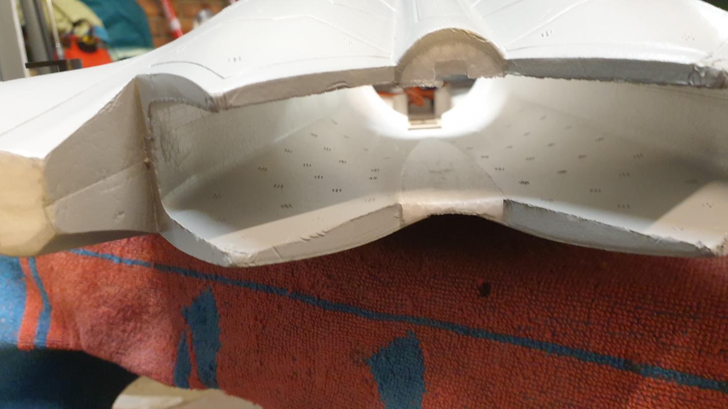

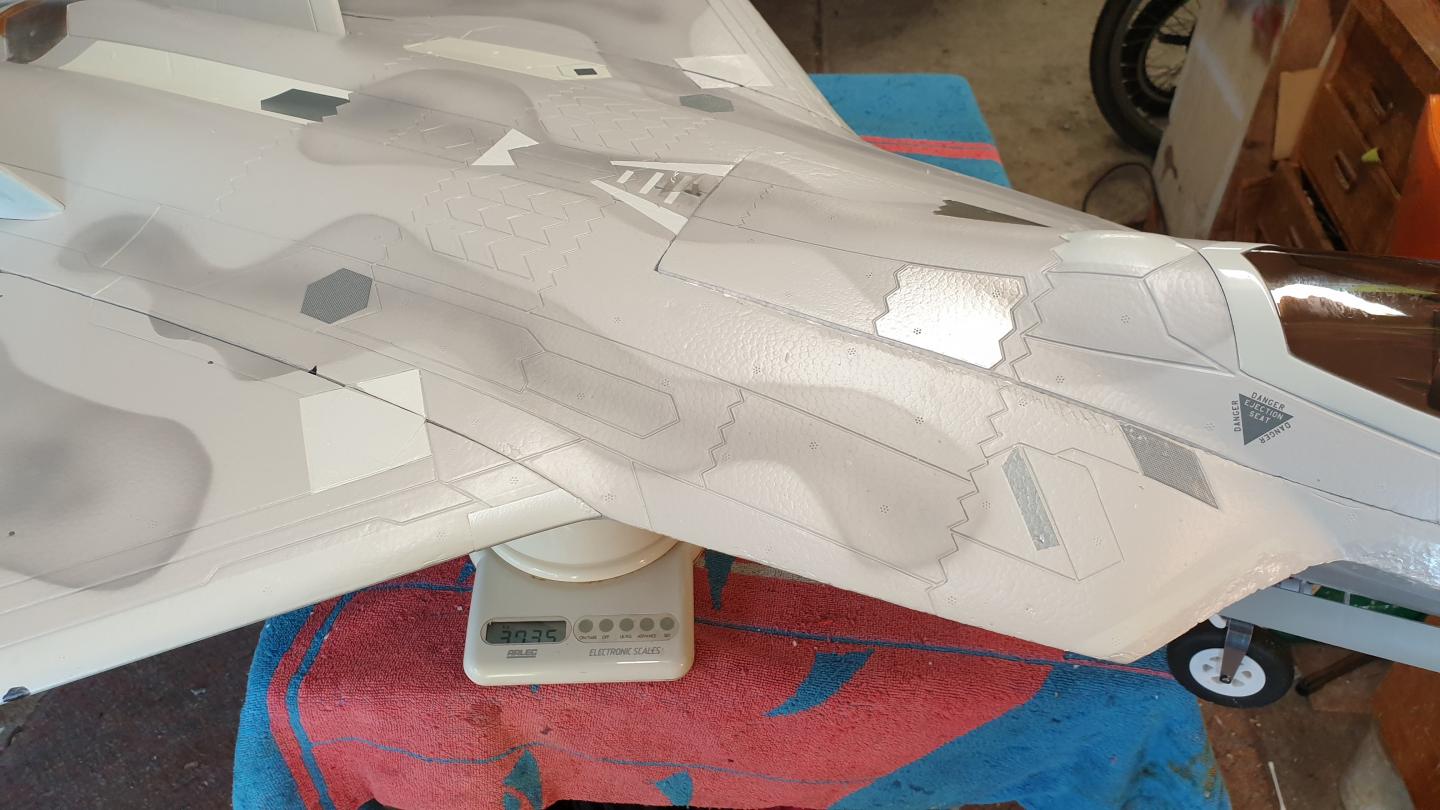

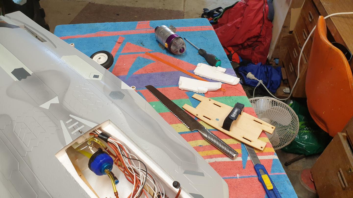

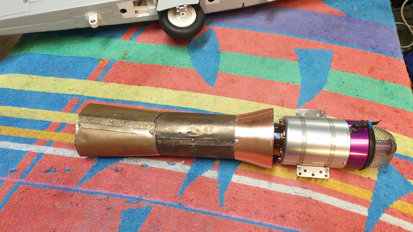

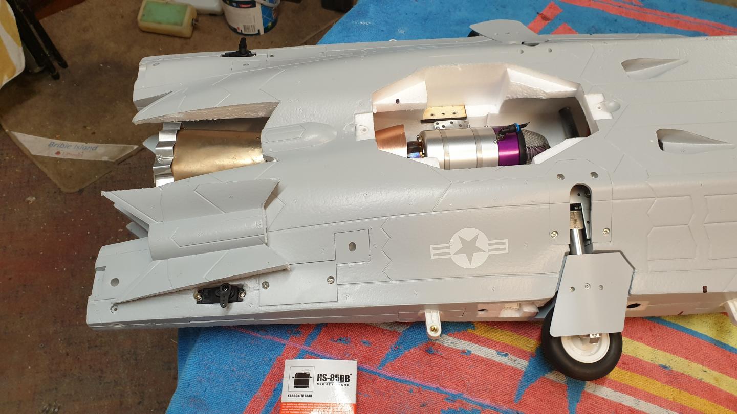

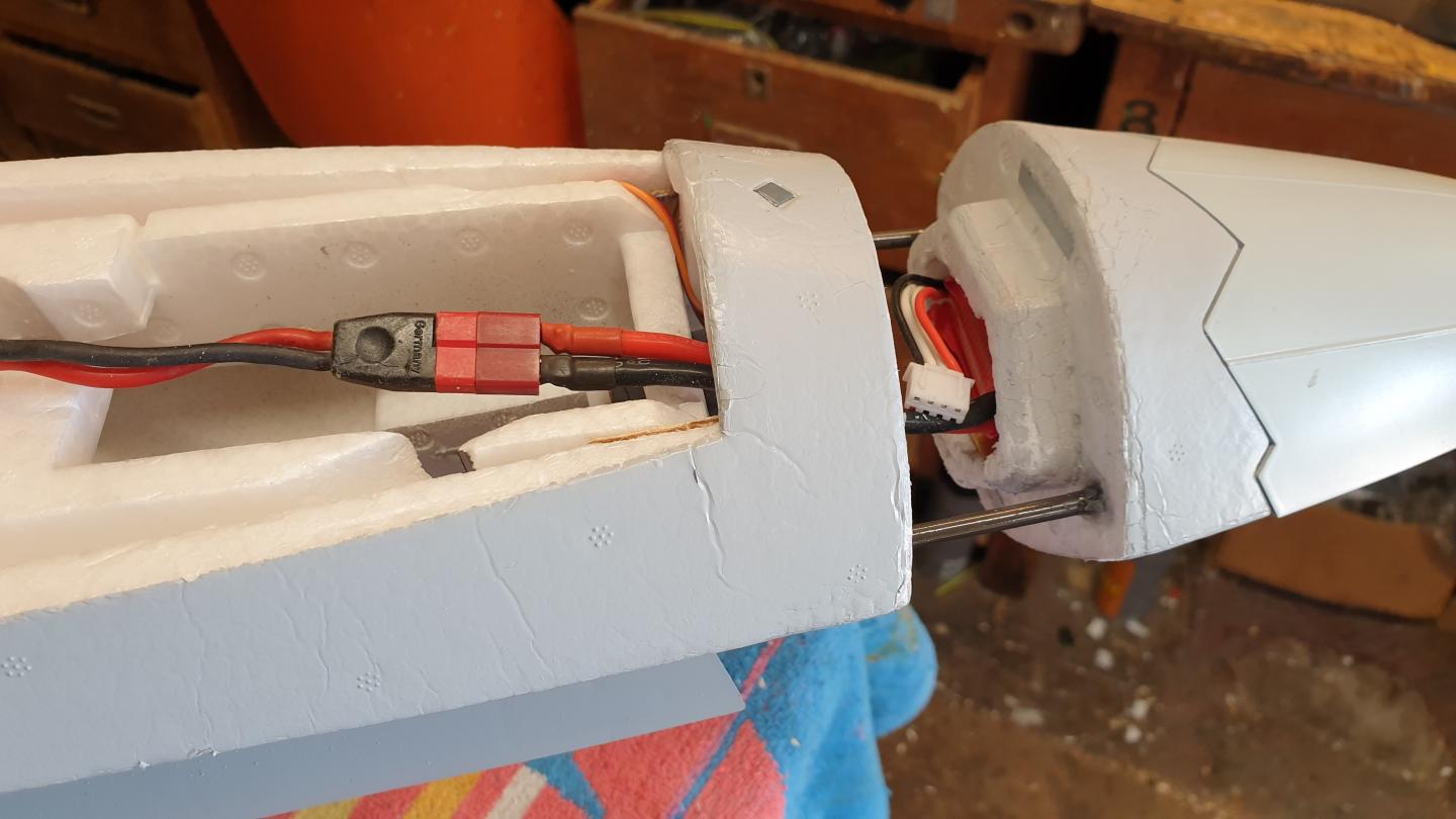

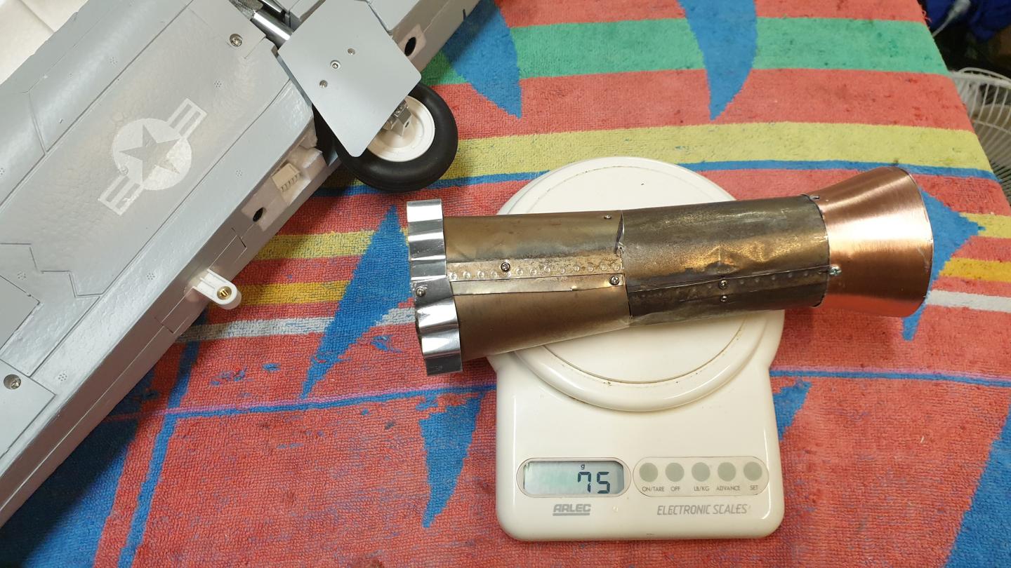

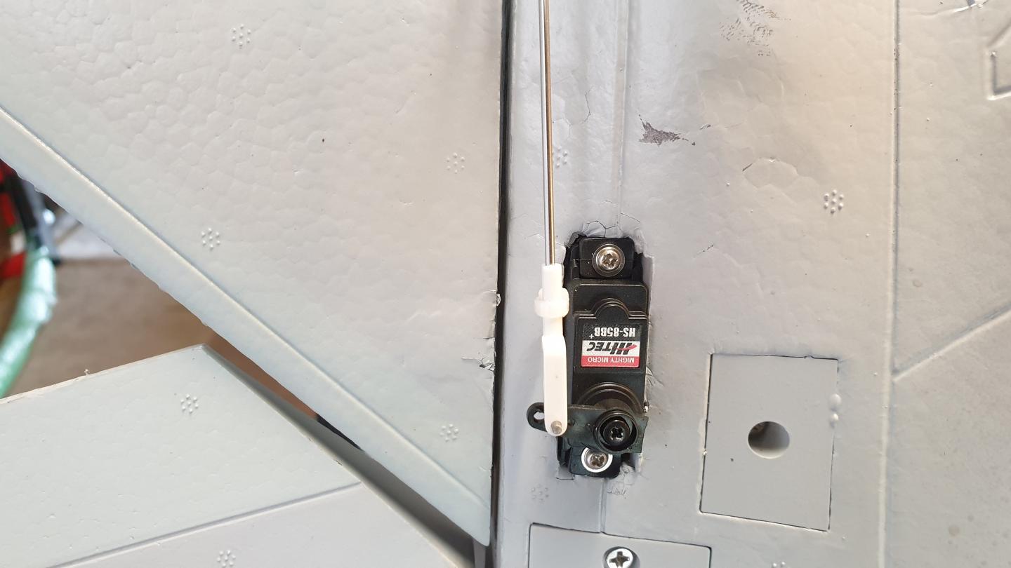

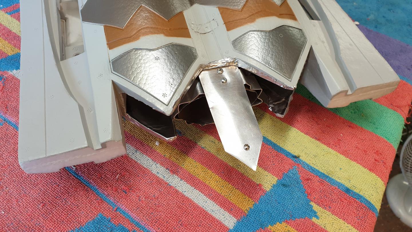

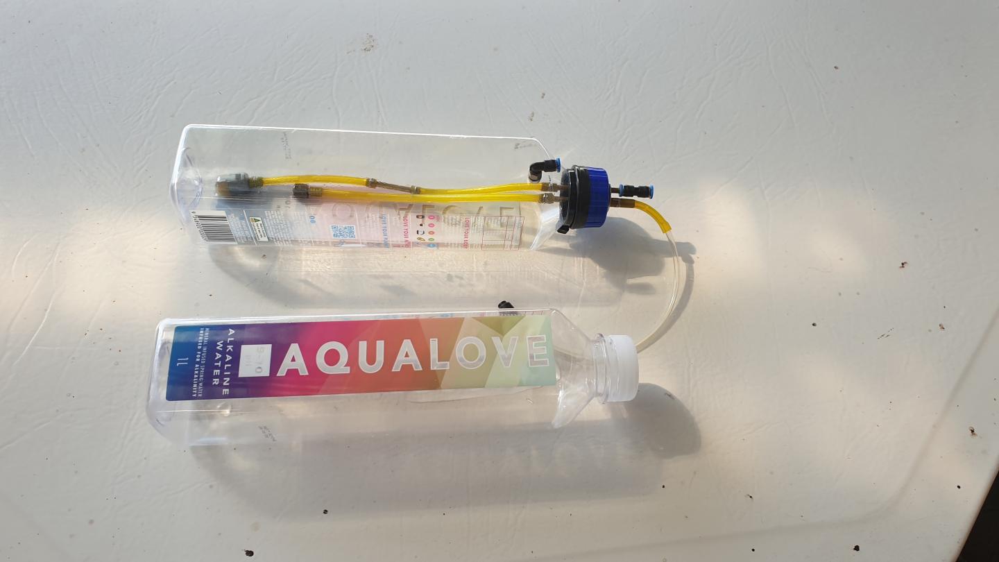

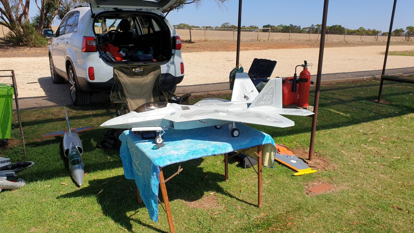

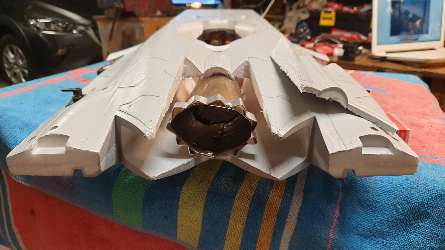

                                  I've just finished my conversion of my Freewing F22 Raptor using a X45 and I must say, it's my best flying small jet yet! Very quiet in the air and the flattened home made pipe fives a real throaty growl at military power!! It balances without lead by having a 2200 battery in the nose cone and my home made one litre tank fits right over the CG and take-off weight is about 4.3kgs, so a 7-10 minute flight is possible. Here are some pictures of the build and a hat-cam video of a flight. https://www.youtube.com/watch?v=uc1Vzg5KxRk
