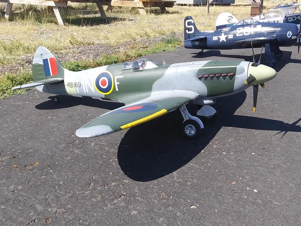

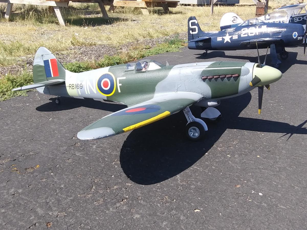

    [QUOTE=paulrkytek;n356554]Photos of my Spitfire in the air and my Bearcat at warbirds day/carrier deck landing at DDMAC./QUOTE]
    Paul, very realistic photos of your gorgeous Spitfire and Bearcat. Best, LB

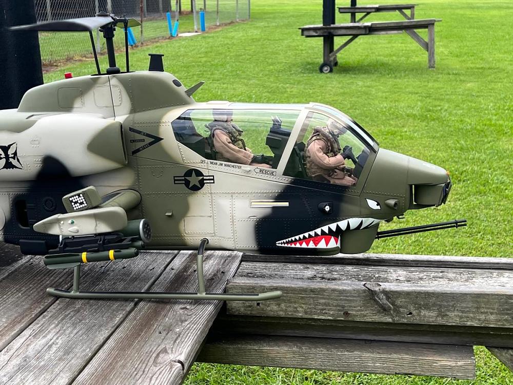

    This morning I finally had the chance to recreate the recovery of Alan Shepard's Freedom 7 Mercury Capsule with my RC UH-34 Choctaw over the water at the Southern Scale Helicopter Challenge. The helicopter was modeled and painted in the scheme of the real Mercury Redstone 3 recovery chopper, so it was tons of fun to actually sling load a capsule underneath it.

  • Coconut
    The prop on the Spitfire looks huge. And, I like the red accents on the Bearcat.

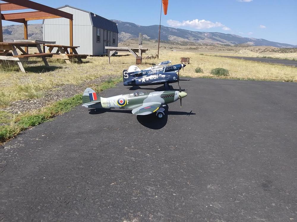

  • paulrkytek
    Photo of my Spitfire in the air and my Bearcat at warbirds day/carrier deck landing at DDMAC
    Click image for larger version  Name:	Spitfire at Warbirds.jpg Views:	0 Size:	67.5 KB ID:	356557

  • paulrkytek
    We are having a Warbirds event at the club field this Saturday so I have marked out a carrier deck landing area with the carrier based roughly on USS Franklin. I had my first attempts at landing today, first attempt landed on deck, hit tower !, second and third attempts landed on deck, overshot end of deck. Fourth attempt landed on deck, stopped before end of runway. I wonder what the percentage was in WW2 ?

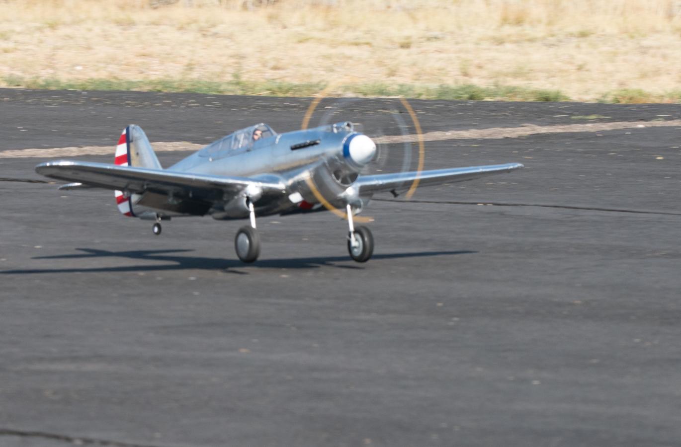

    Originally posted by davegee
    I took my FMS P-47D Hairless Joe out for a couple of flights today. Unfortunately, it turned out to be a nightmare, due to an intermittent problem with the electrical connectors on the left wing/fuselage. I thought I had this problem solved by putting a piece of wood behind the connector unit on the wing to push it closer to the one on the fuse, but today that didn't work out. Takeoff was normal, but then I noticed the plane wanted to make a sharp bank to the left on occasion. When I brought it around, the left gear had not retracted. Recycled the gear, and this time it went up ok. On landing, the plane wanted to sharply bank left with the flaps down, and I think the left flap unit and left aileron were not working properly. Got it on the ground, of course everything works fine, took it up for one quick circuit, and problems came back. Got it down using a flaps up landing, plane skipped after touchdown due to too much speed I guess, settled down but went off the side of the runway and flipped over.
    Fortunately, just a little damage to the top of the vertical stab when it flipped over.
    So, the plane is grounded until I can figure out a workaround with this wing connector. If anyone has any ideas, I'm all ears!
    Cheers
    Davegee
    Click image for larger version  Name:	IMG-0047.jpgadjusted.jpg Views:	80 Size:	206.5 KB ID:	356055
    Well, I took my Hairless Joe P-47D out for another test flight today, hoping that I wouldn't have the near-disastrous flights I had last week. Again, everything checked out beautifully on the ground, and I started by flying a circuit with the gear down before starting to test all the problem areas on that left wing. I then retracted the gear, but of course, the left gear stayed down and would not retract. This time, I had no issues with the other gear coming down, or the flap, aileron, or the red wing light on that left side. Eventually brought it down for a good landing, then tested it on the table next to the flight line. Worked perfectly! Took it out for another flight, same result, left gear would not retract. Eventually called it a day after trying to cycle the gear several times. On the ground this time the left gear would still not retract, so I had to haul it home in the truck with the left gear out.
    I'm thinking that something is still amiss with the metal connector male/female plugins that come with this plane. Very innovative, but not worth much if you have the problems I have been having,
    I don't think the problem lies with the gear sequencer, as all gear/gear door sequences work perfectly on the ground, and for that matter, in the air, with the exception of the left gear.
    I don't think the problem lies with the left gear retract unit, as it also works great on the ground, and when I isolate it and power it up with a different power source, it works perfectly.
    Right now, I'm thinking, since I rarely take the wings off because it fits in my truck ok to the field, that I'll bypass these metal connectors that come with the kit, removing them entirely on the left wing. I just ordered a bunch of male/male extension cables and will use those cables to connect the wires in the fuselage to the wing, sorta "old school" approach and then see if that solves the problem.
    Seems to me that when an aerodynamic load is placed on the airframe (flying it) that is when I have these problems, as it works fine on the ground. Will continue to try and suss this issue out.
    If anyone has any thoughts on this, I would very much appreciate hearing them.
    Cheers
    Davegee
    Thanks, DCorsair. Outside of the problems I have been having with this particular airplane, it is one Nice flying machine!! I have previously stated I have another plane, and it has always flown beautifully. Before that, years ago I had another one that eventually crashed, not sure if the wing connectors were part of the problem or not, but this is the first time I have had this wing connector issue that I know of, although I've been quite familiar with others complaining about it with their models over the years.
    As an update, I did the repair to the top of the vertical stab when it flipped over on rollout yesterday. That was my first flaps up landing, and I wanted to be sure I didn't get it too slow on landing, but when it skipped back up into the air a few feet, I didn't dare try a go around with all the problems I was having with that wing! It worked out ok, I guess. That was probably the most difficult flying I have done in RC flying, trying to keep control of a very troubled airplane! It almost went in several times as I tried to nurse it around to an emergency landing!
    I worked several hours yesterday taking the wing off, removing the two connectors and inspecting them and the wiring and trying to get a fix on why I had all these problems. It was vexing, sometimes a gear wouldn't work and then it would, etc. But after all this time, I think when I put it back together, it seems to be holding and everything is working. I will run more tests before I venture out with another test flight.
    I'll attach a pic of my other plane that I fly regularly, again, this one has never demonstrated any control issues like my new plane has. It is also based on a real paint scheme from one flown in the 56th Fighter Group during WWII out of England, 8th Air Force. It was named: I Wanted Wings/ Button Nose.
    Bottom line: if you get a hold of one of these airplanes, they are great, but BEWARE of these wing connectors. They can easily bring down your airplane!!
    Click image for larger version Name:	IMG-0868.jpg Views:	0 Size:	144.7 KB ID:	356079
