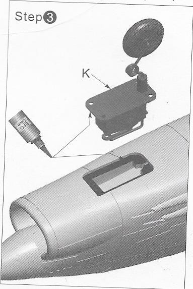

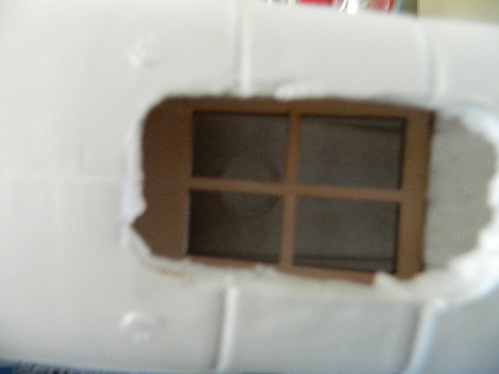

                                  • Still waiting for a reply from Freewing regarding the missing parts (undercarriage mounting plate) from our F-8 Crusader kit
                                    attached pictures show how it should be and how it actually is
