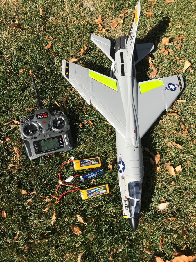

    Click image for larger version  Name:	 Views:	1 Size:	219.6 KB ID:	103947
    Put three batteries through mine this morning. One Admiral 1800 and two Zippy Compact 1500's.
    All three flew exactly the same. I can see no difference in speed, climb, stall, trim, etc. between the batteries. Launch at WOT and keep it there until I gather steam, and the back off 3-4 clicks for cruise. Couple of WOT passes, no real aerobatics. My timer was set at 3:30. Admiral came home at 11.3v and 3.77 per cell. Zippy's were 11.1/3.68 and 10.9/3.62 so I need to back my timer down to 3:00 or get out of the throttle more often. I'm storage balancing the batteries now.
    My nose skid mod is working perfectly. One landing was particularly hot (bad) and I actually bounced it on the grass, went airborne again at about a foot off the deck, and came back down. Absolutely zero damage. I really like this plane, and have the hand toss down now. That gray camo works a bit too well with an overcast sky, but my yellow aileron and scoop mod do help with orientation. It's different than a prop planer sure (louder and shorter flights) but it looks killer streaking by!

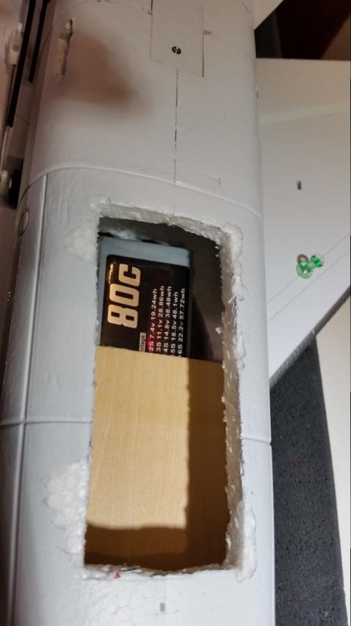

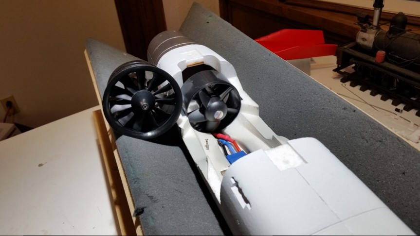

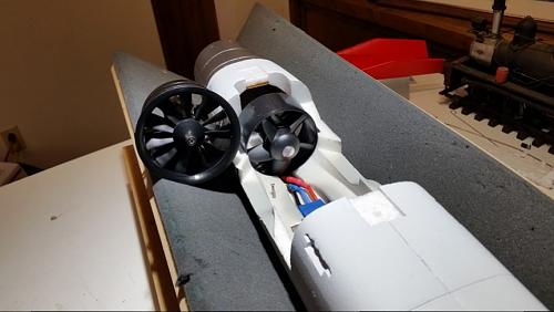

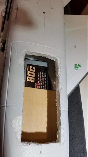

      I flew the stock F-8 and it was very good. However, I decided to upgrade the EDF to an FMS 12B, 64mm, outrunner motor. I also added landing gear, rudder and a cheater screen. I'm using a Roaringtop 2600mah, 80C battery moved aft to stay within CG (had to cut some foam - see picture Click image for larger version
Name:	FMS 12B 64MM Inrunner EDF.jpg
ID:	104609Click image for larger version
Name:	80C Battery Moved Back.jpg
ID:	104610Click image for larger version
Name:	Cheater Screen.jpg
ID:	104611Click image for larger version
ID:	104612Click image for larger version
Name:	Stock F8 Low Pass.jpg
ID:	104613Click image for larger version
ID:	104614 ). I added a .5 ounce weight to the lower tail. The power output is amazing and I'll fly it soon.

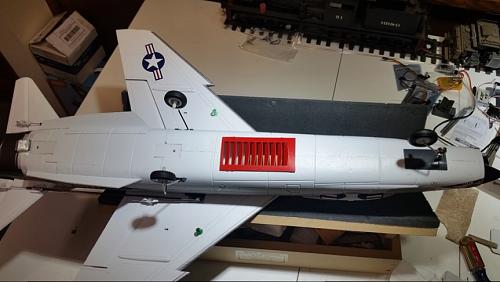

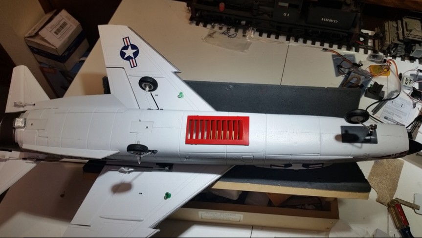

            Finally, maidened my F-8 early this morning. I went with a 4s 2200mah battery, 2836-3300kv out runner with 12 bladed fan from the 4s Stinger parts bin. It has retracts, and I separated the ailerons from the elevator. Flies well, but it's sure hard for me to see!

                The landing gear are shortened 70mm F-104 items. I'm almost embarrassed to share a close up photo of it on here! There are some amazing modelers on this site. I'm just a hack!
                  #128
                  A smart hack!!! LOL Show it Bro! We are all in this together......

                    LOLI will. I'll take a photo or two in the morning. Needless to say, the fan isn't starving for air, as I cut plenty of cheater holes!

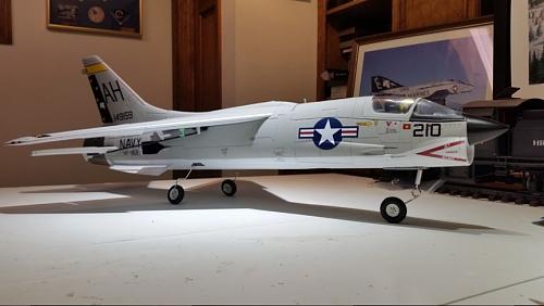

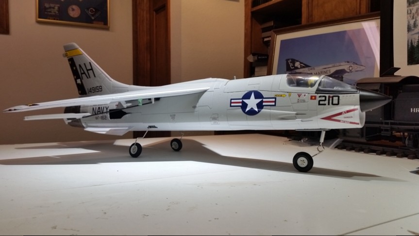

                      Here's my landing gear installation in the F-8. I used the landing gear mounts and retracts available for the FW 70mm F-104. The nose gear mount is glued directly to the bottom of the plywood battery tray. For the main gear I hogged out holes in the appropriate places, and epoxied the gear mounts in place. It's not a pretty setup, but it seems to work well. I shortened all three landing gear considerably.
                      • Felixs10
                        Felix S.
                        • 113
                        • Bergen county, NJ
                        #131
                        You may call yourself a hack , but gave us (or at least me an idea or two . Did you fly it prior to adding the landing gear? How did handle the extra weight?
                        Great job by the way.

                          #132
                          Did not fly it before doing all the mods. Weighs 2.0 pounds ready to fly. It seems to fly fine with no bad habits, but it's not a white knuckle performer by any means. I have the ailerons set up as flaperons for landing, slows down okay. It's just so small and gray, hard for me to see!
