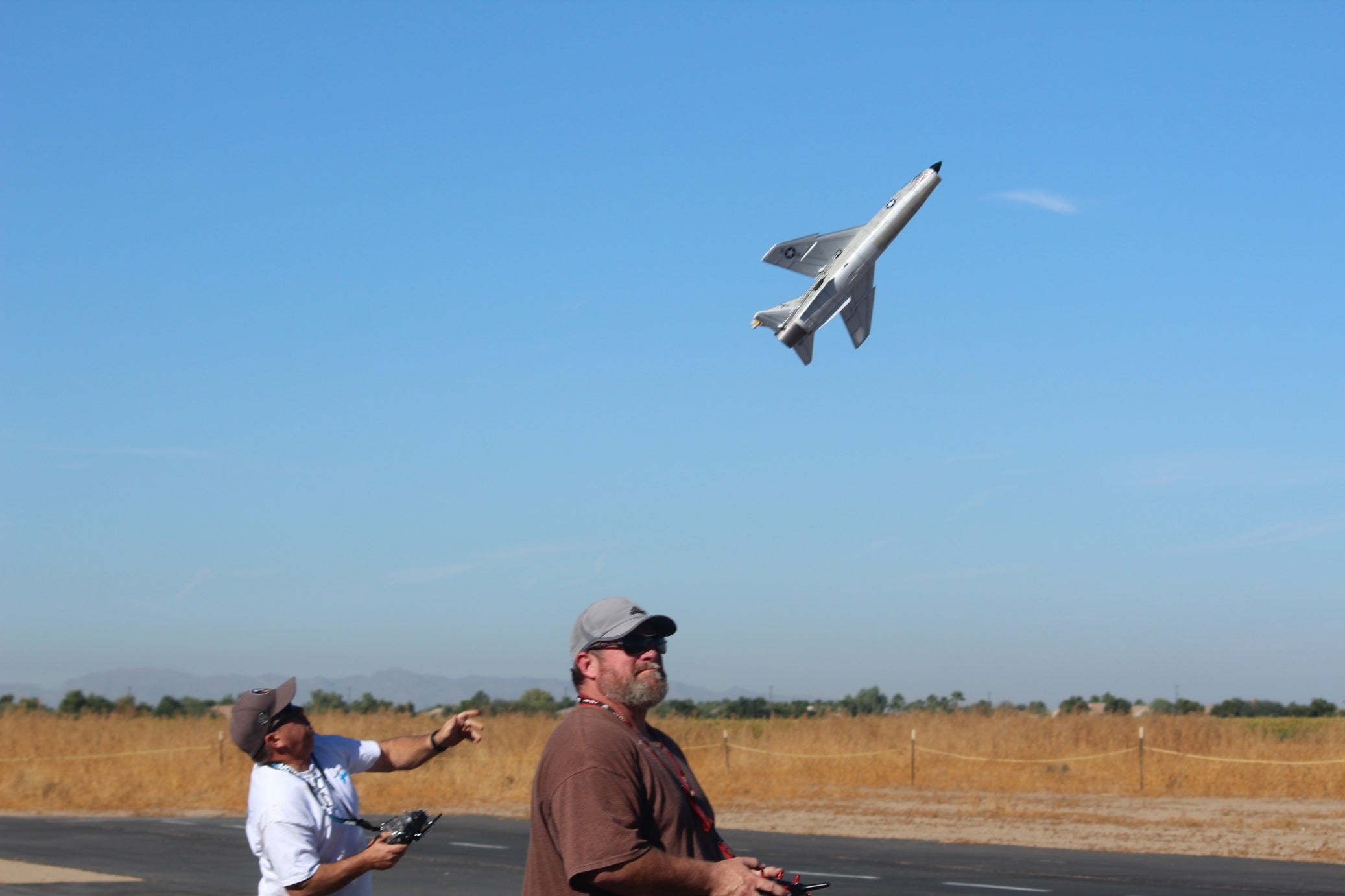

Some pics from today:
This is NOT my typical hand launch! A little too much angle on the throw, but it flattened right out.

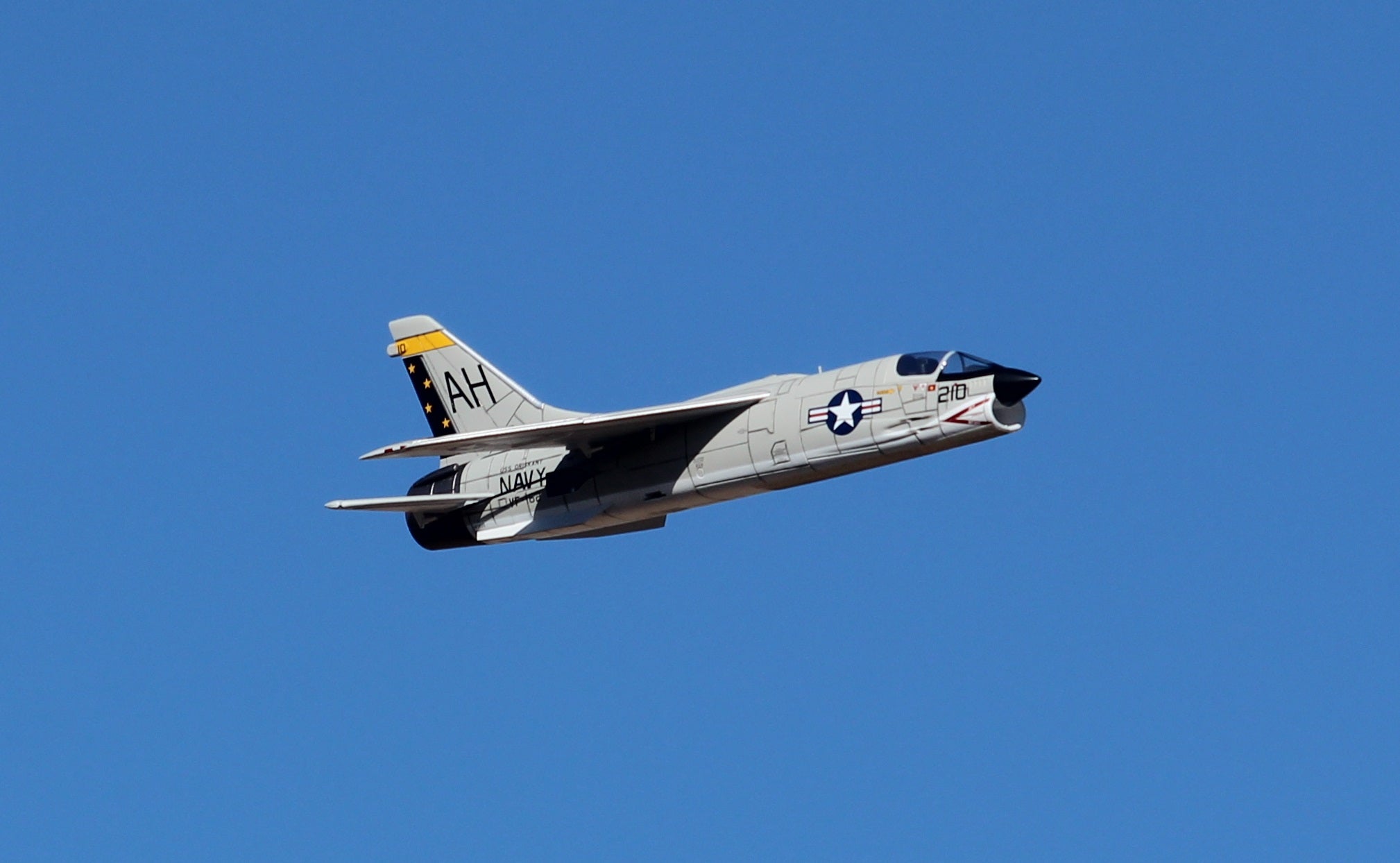

The panel lines really stand out in flight!

The panel lines look great!
