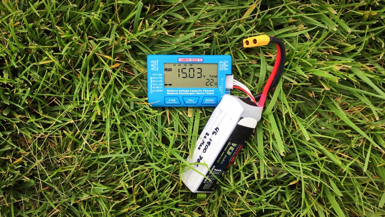

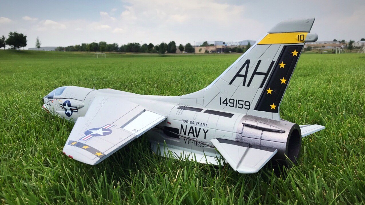

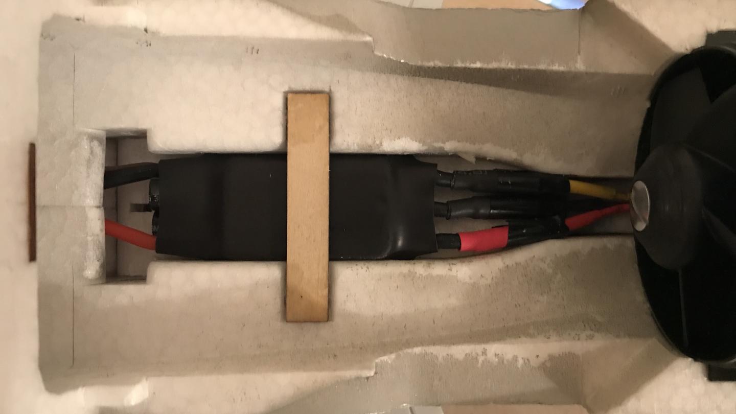

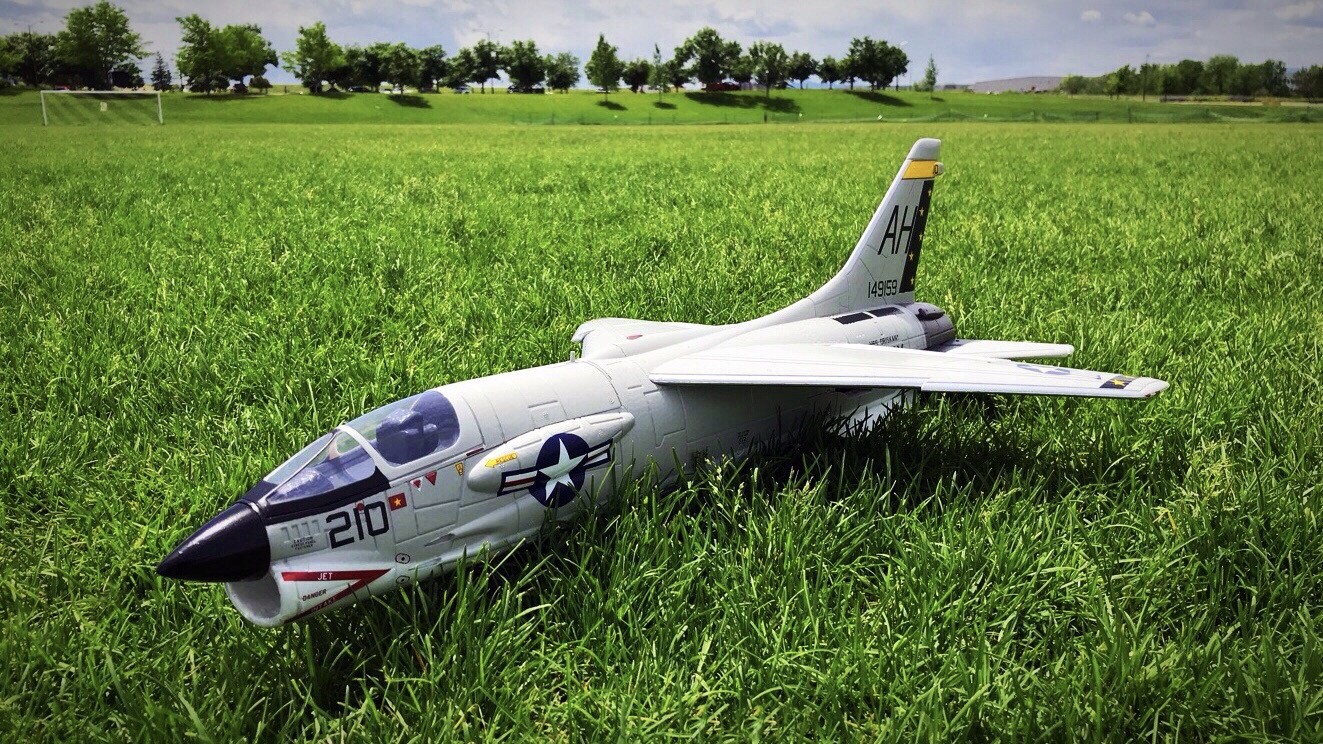

                            This is a 4S flight video of my Freewing F-8 Crusader EDF Park Jet, modified from 3S.
                            I upgraded the stock 30-Amp ESC to a Predator 40-Amp with 3-Amp SBEC and also shortened the ESC wires to scoot the ESC as aft as possible to balance the Crusader to the factory recommended CG. The battery used for the flight is a Roaring Top 4S 1800mAh 70C Lipo which is positioned as far back as possible, butted up against the rear foam compartment wall. The 5-blade EDF fan unit and 2627-4500kv brushless outrunner motor are both stock.
                            Checking in with Motion RC, I was advised that the stock motor and fan are both 4S-capable, but I would need to upgrade the ESC. I’ve been flying my F-8 Crusader on 4S with no issues for a while now after I found the 3S performance to be lacking in power, especially at altitude. I thought I would share my results.
                            Hope you enjoy the video and flight footage!
                            MODIFICATIONS:
                            1) Predator 40-Amp ESC with 3-Amp SBEC
                            2) Minwax Satin Finish Polycrylic Triple Coated Airframe: Maximum paint and finish protection.
                            3) JB Weld 5-Minute Clear Epoxy Coated Air Intake: For belly landing abrasion protection.
                            TRANSMITTER, RECEIVER, & SETUP:
                            Transmitter: Spektrum DX8 G2
                            Receiver: Lemon RX DSMX 7-Channel Diversity Stabilizer / Receiver
                            Rates Used: 85% Aileron / 32% Expo, 100% Elevator / 16% Expo
                            Battery: Roaring Top 4S 1800mAh 70C
                            Throttle Timer: 3:10 Minutes
                            Total Flight Time: 2 Minute(s), 48 Second(s)
                            Lipo Final Voltage: 15.03 Volts out of 16.80 Volts (~3.76 Volts / Cell) at 22%
                            ADDITIONAL INFO:
                            Camera: iPhone 7 at 1080P / 60 FPS shot on an Action Mount Head Cam
                            Thanks for watching!

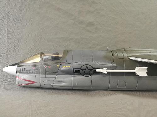

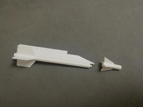

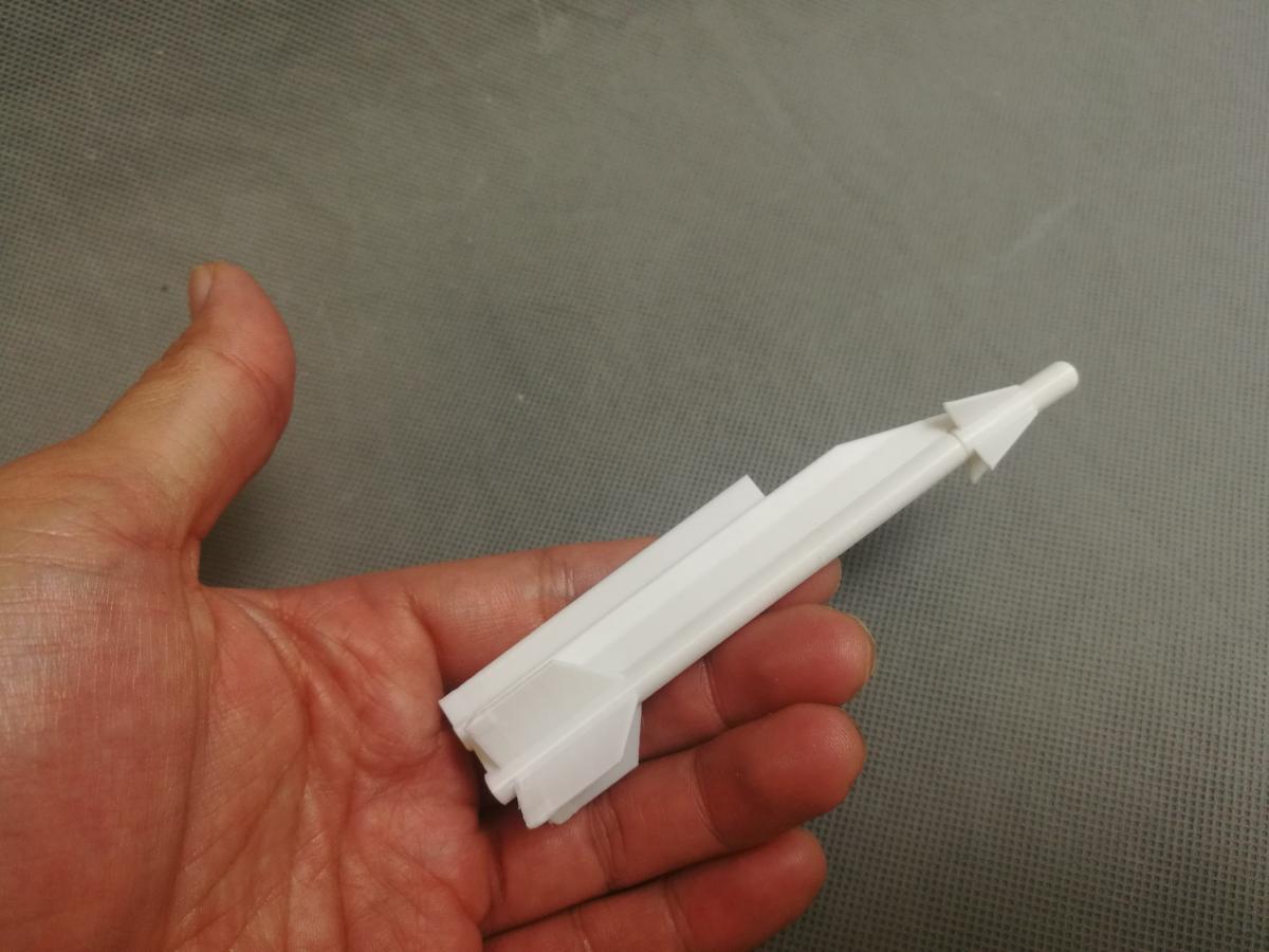

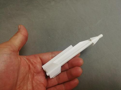

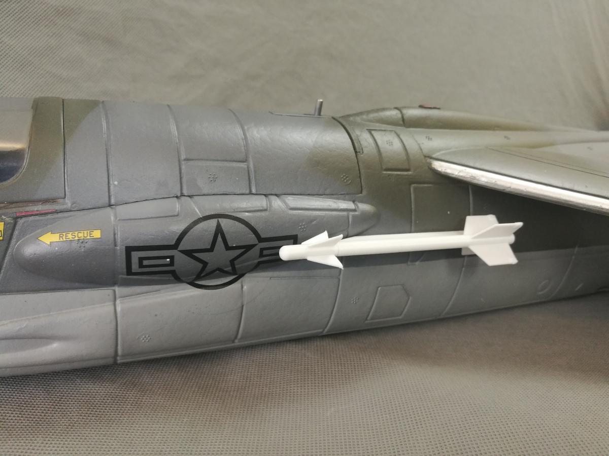

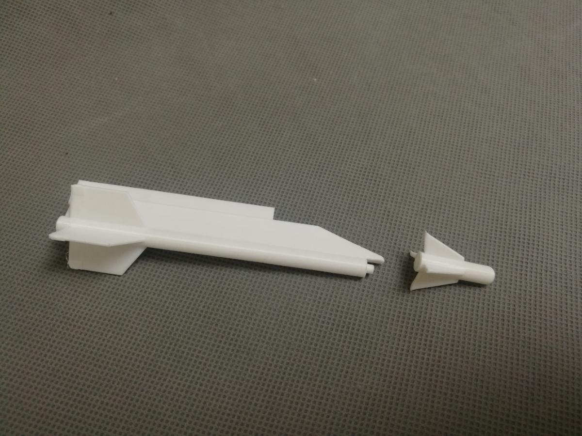

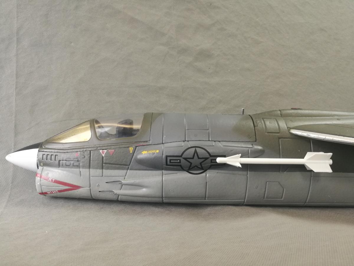

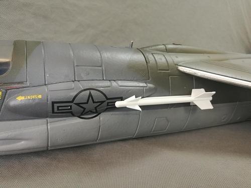

                                I drew up a simple AIM-9B that prints in less than 90 minutes total. A little bit of paint and they'll look great. I also liked the real F-8's quirky fuselage mounted Sidewinders, reminding me of the English Electric Lightning.
                                Flight handling isn't noticeably affected, and the missile easily clears both my hands during launch and the grass during landing. Download the STLs, attached. Print upright, glue or pressure fit the Tip to the Body, trim, paint, install. I used a 6mm Brim, 0.2mm layer height, 10% infill, with Support.

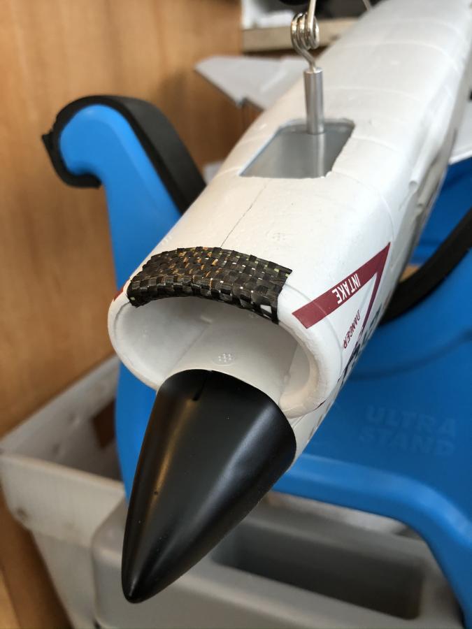

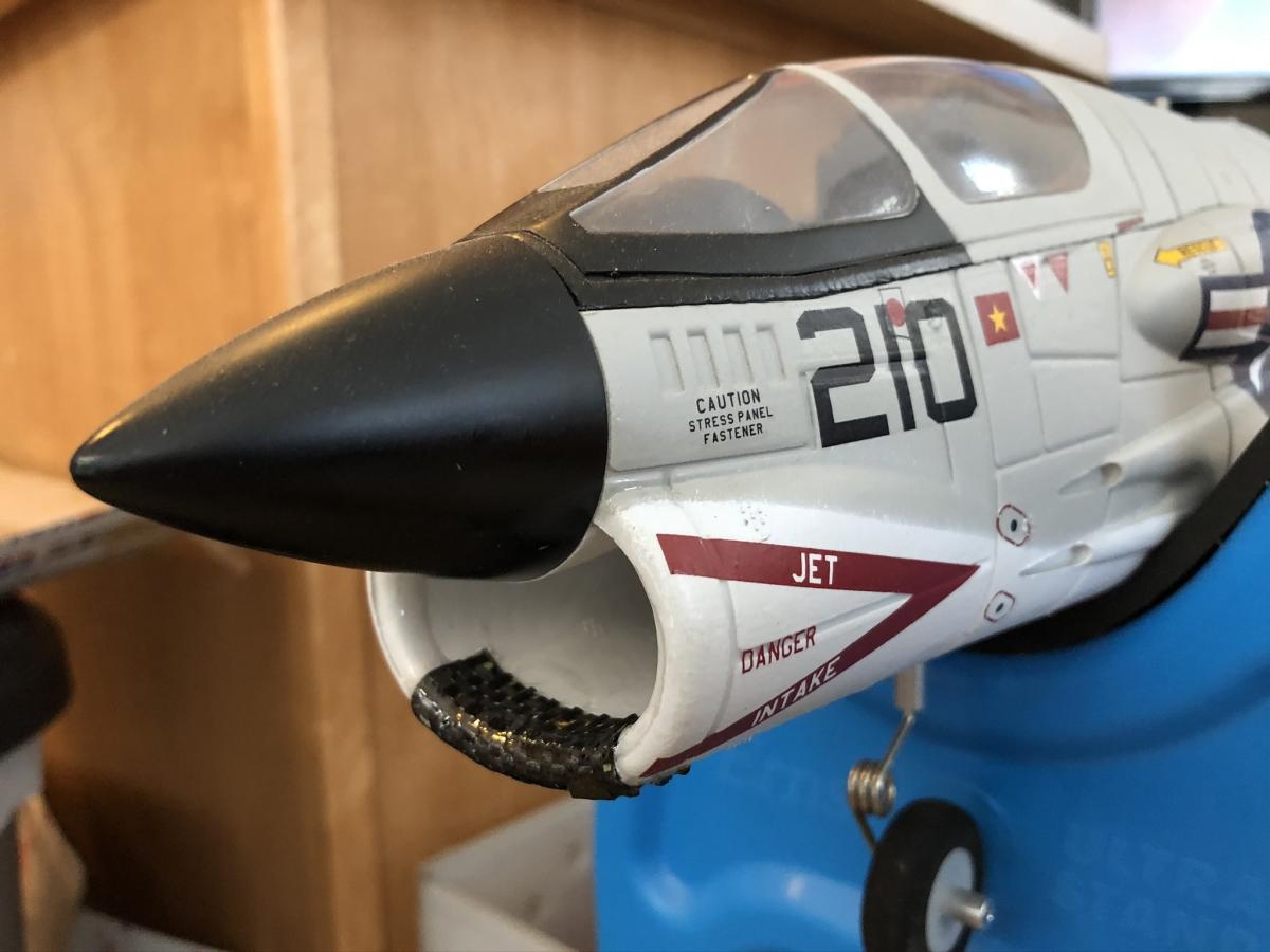

                                  I wanted to share a little carbon fiber mod I did to my F-8. I was reinforcing an RC boat with carbon fiber cloth and cut a small piece to resin in place for protection on the F-8 Crusader.
                                  Click image for larger version  Name:	IMG_0786.JPEG Views:	97 Size:	81.1 KB ID:	222581
                                  Click image for larger version  Name:	IMG_0782.JPEG Views:	58 Size:	47.6 KB ID:	222582
