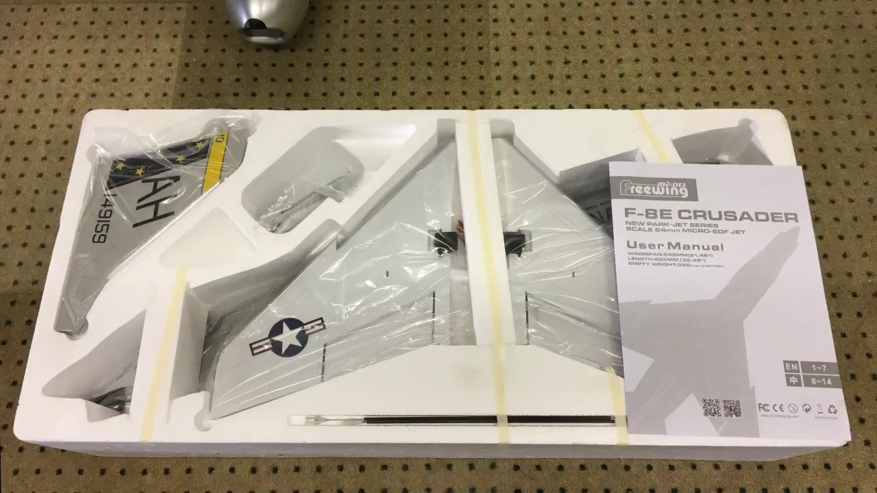

        I put together a little unboxing video.

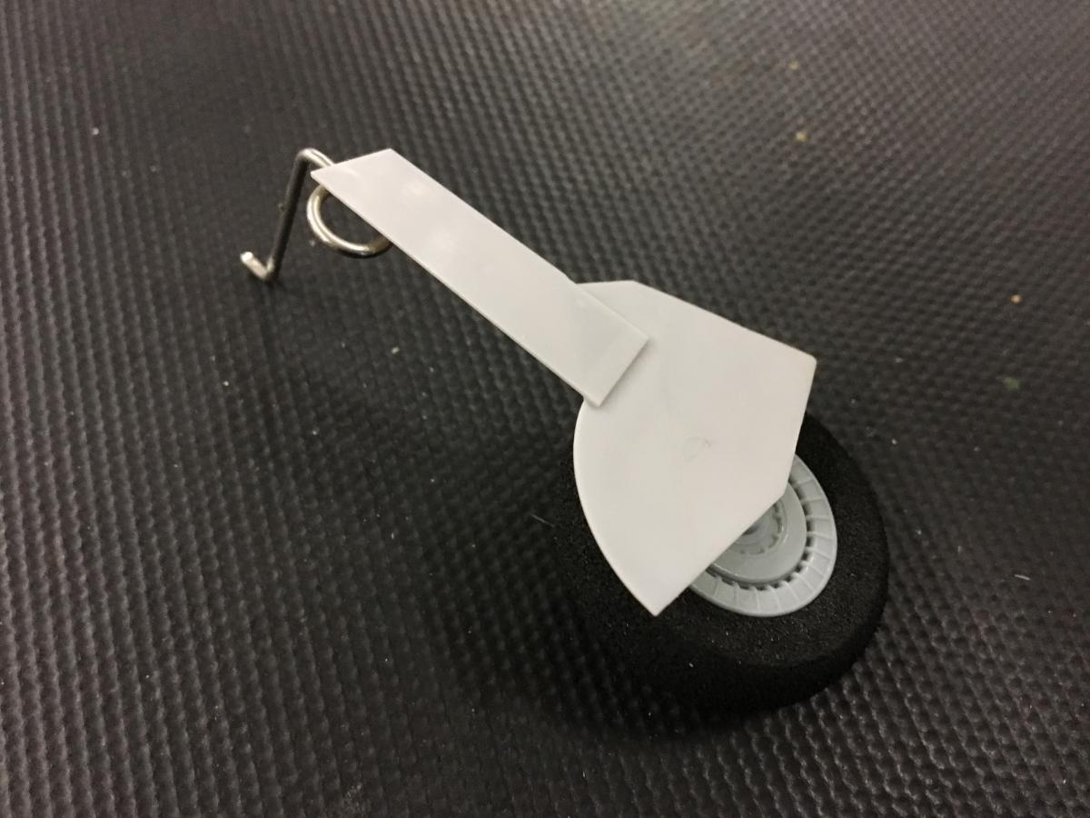

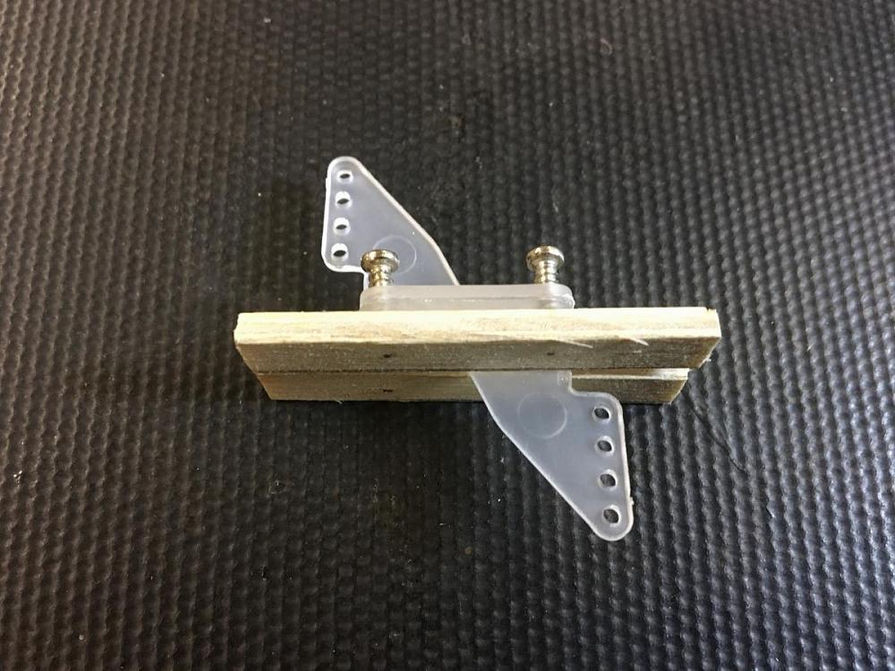

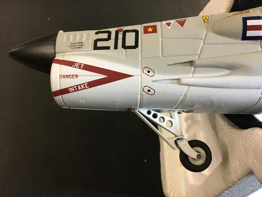

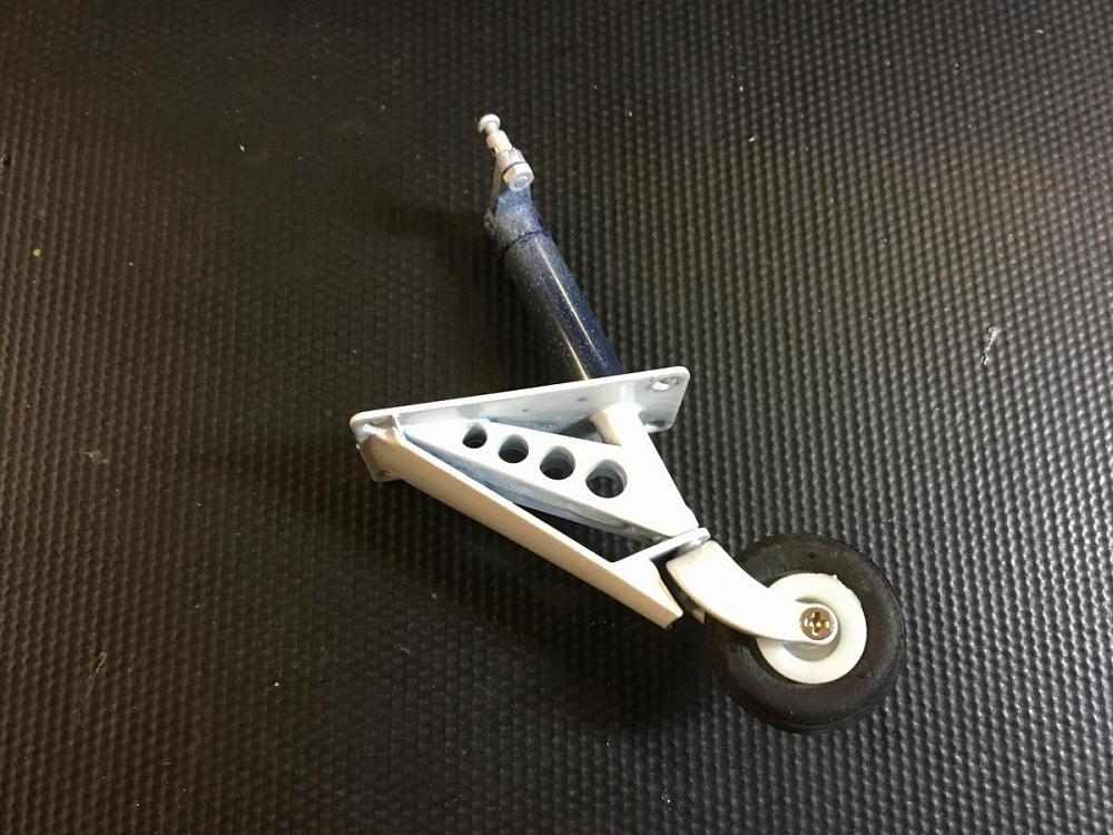

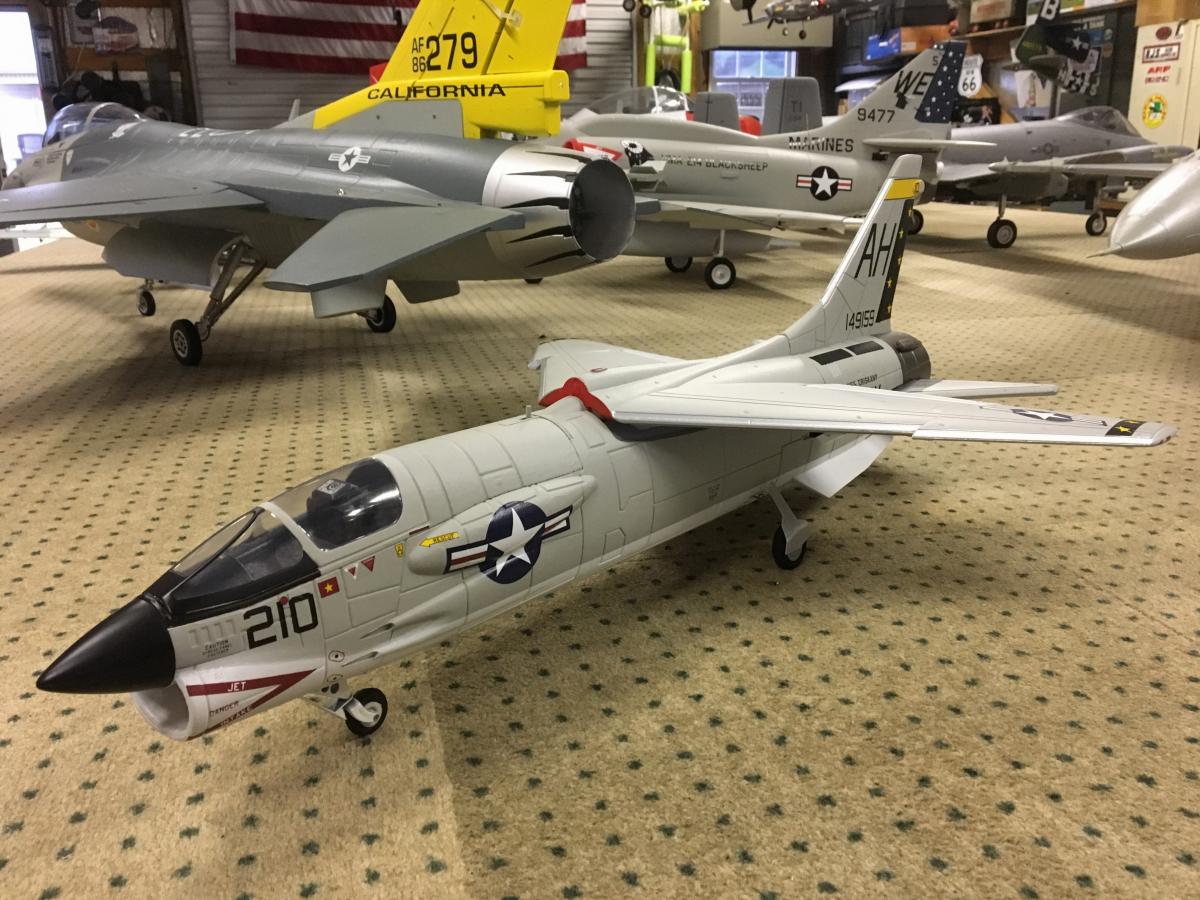

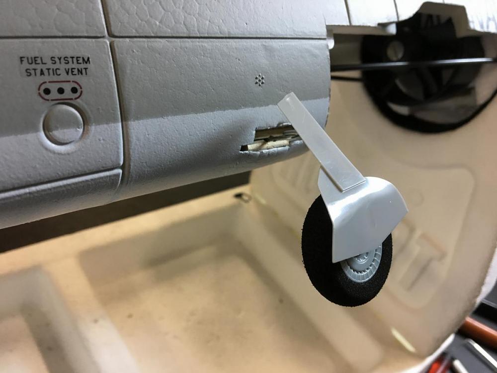

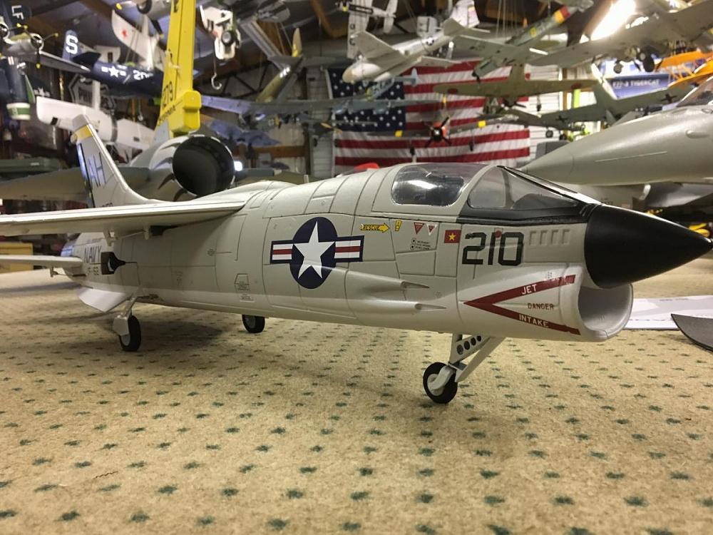

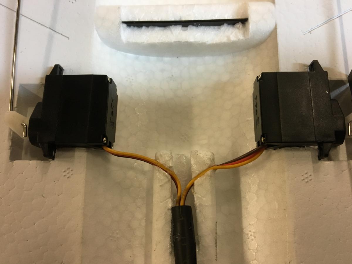

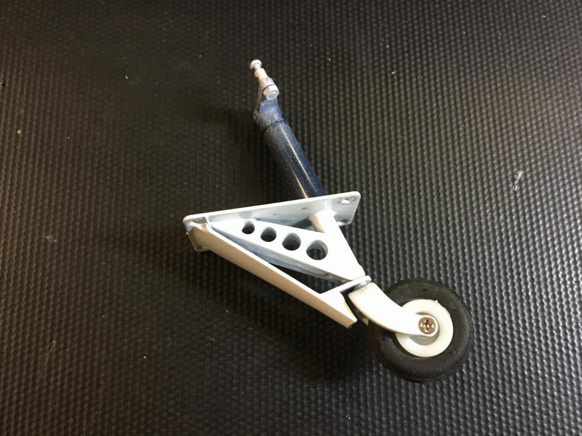

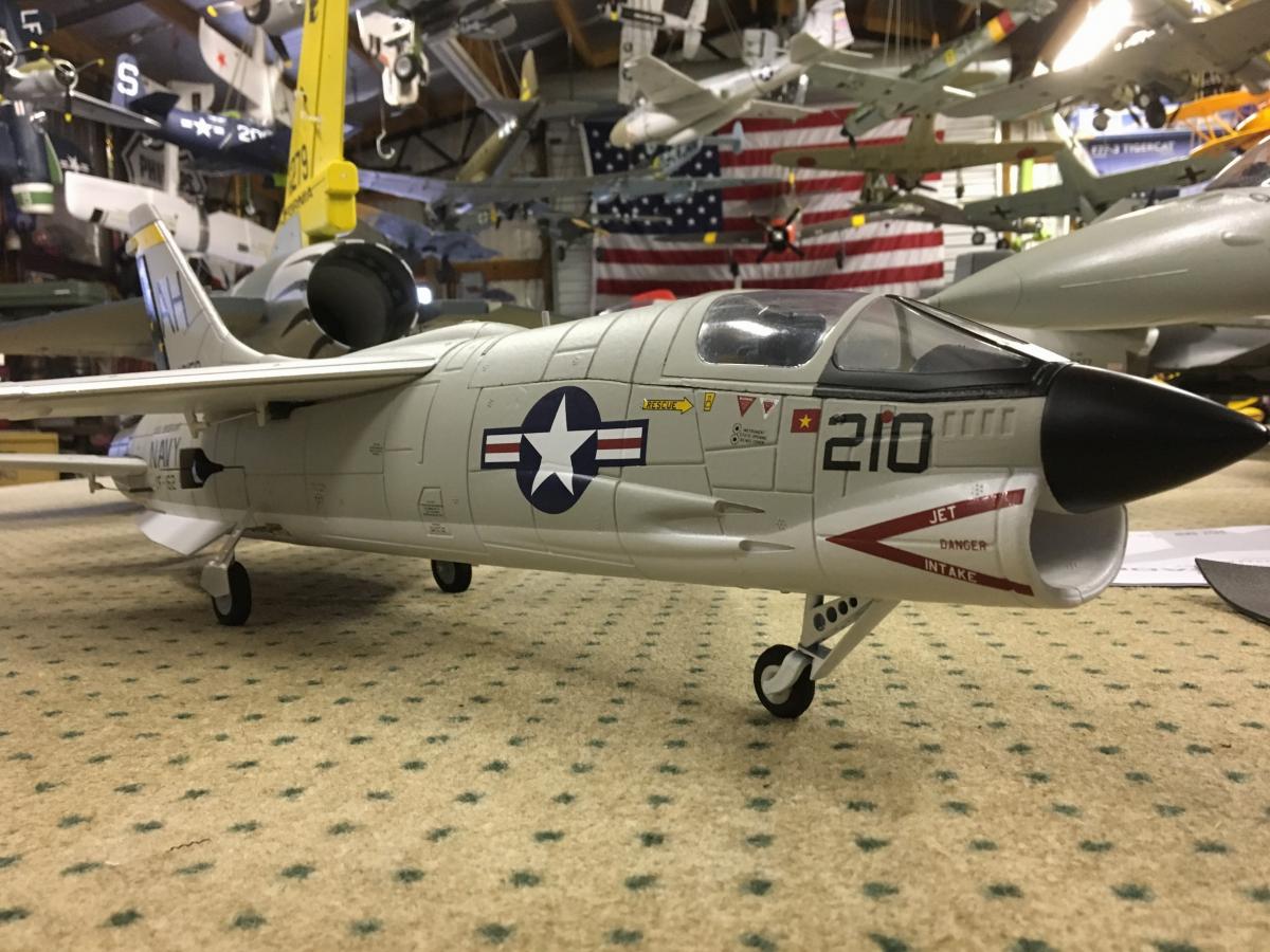

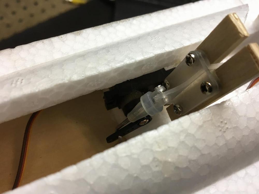

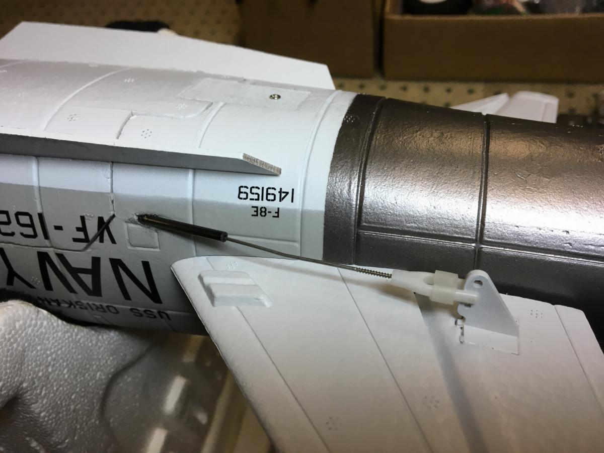

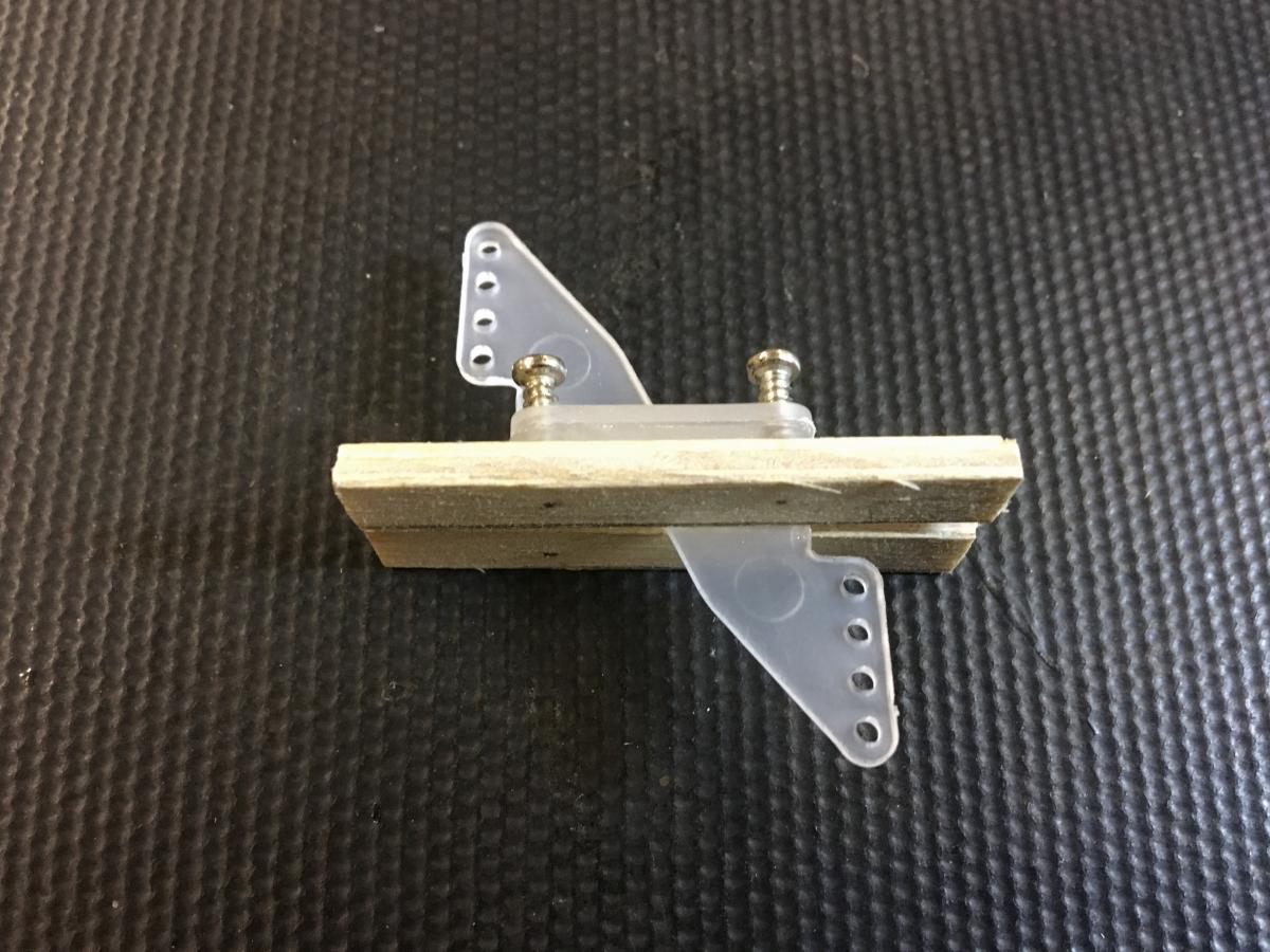

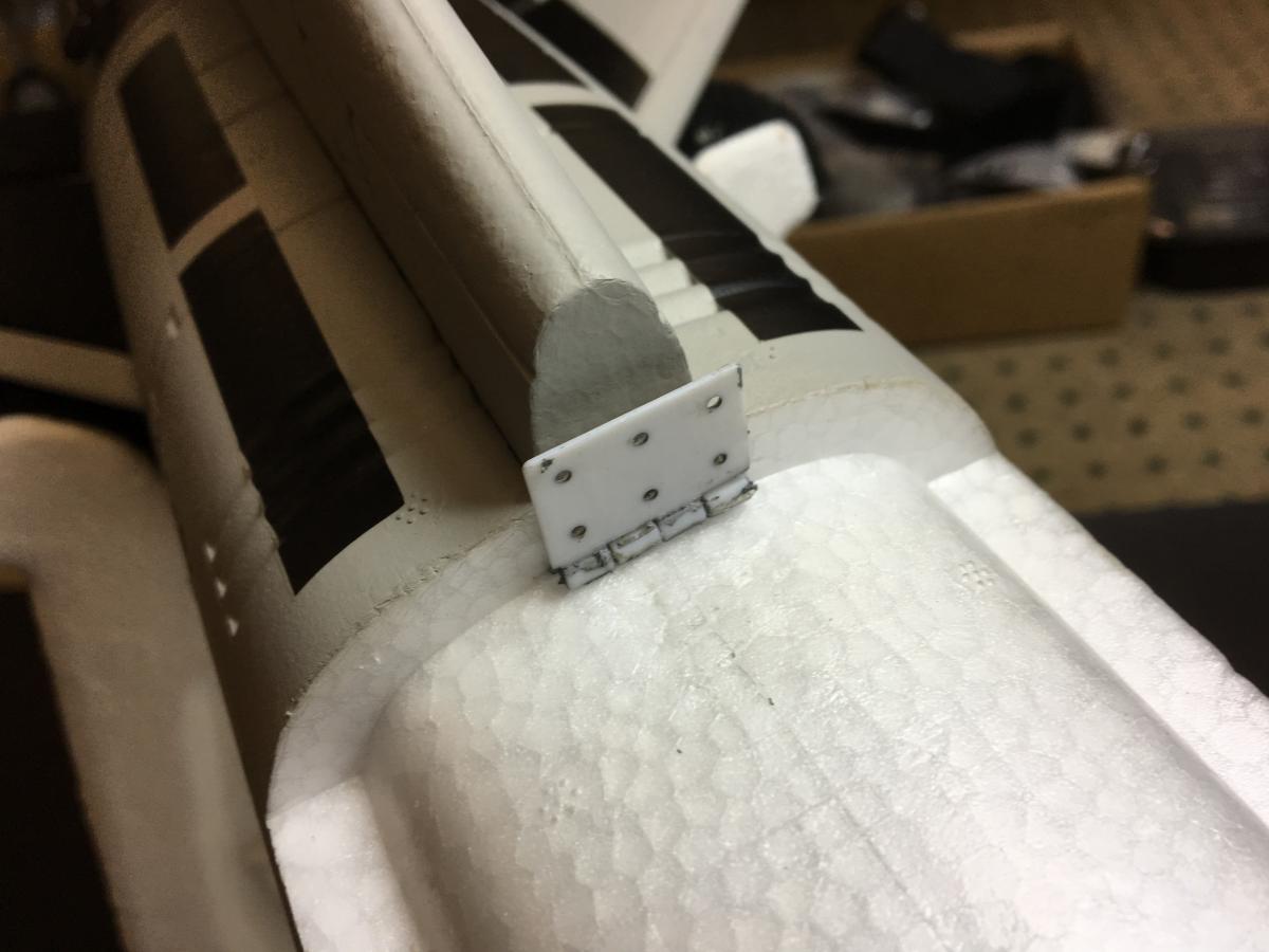

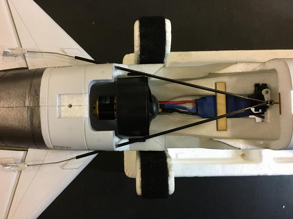

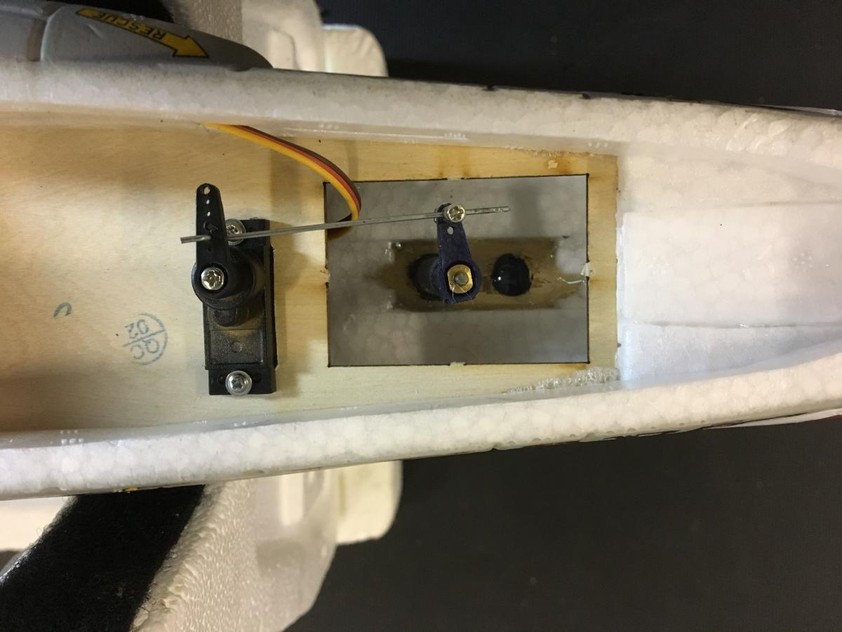

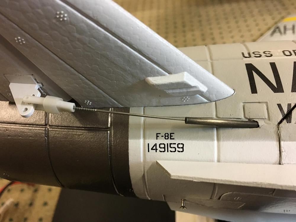

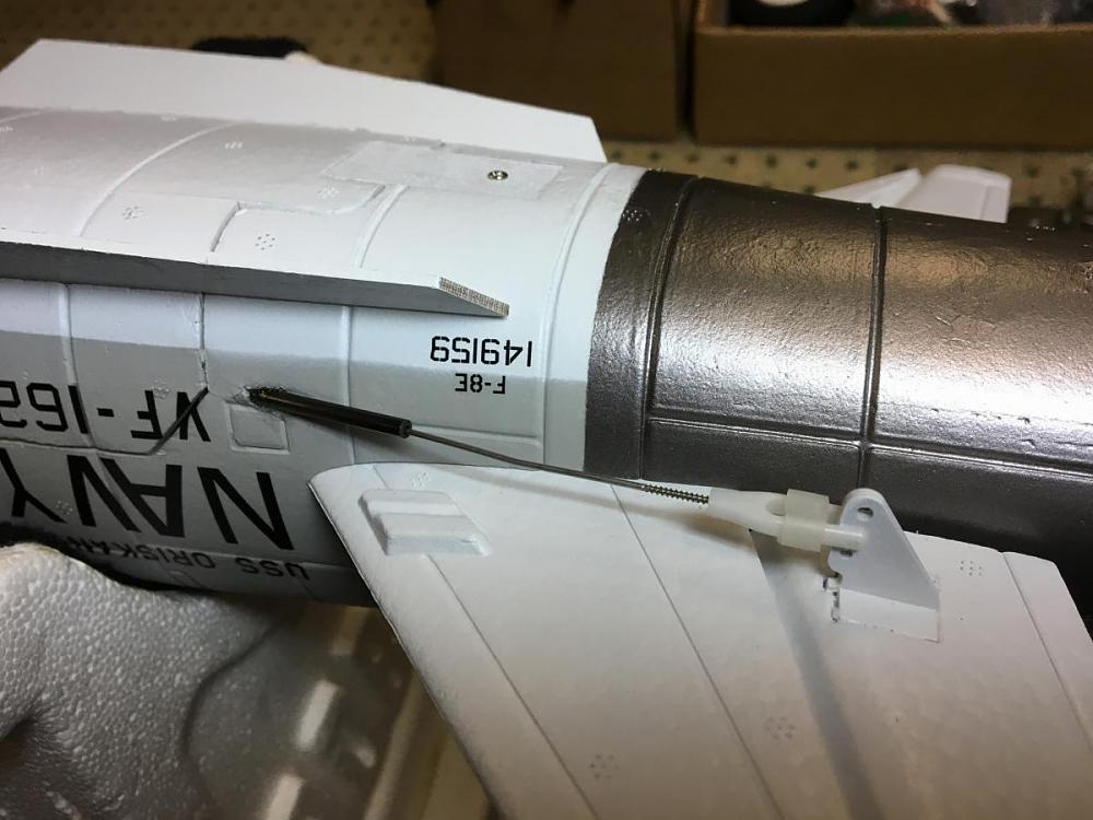

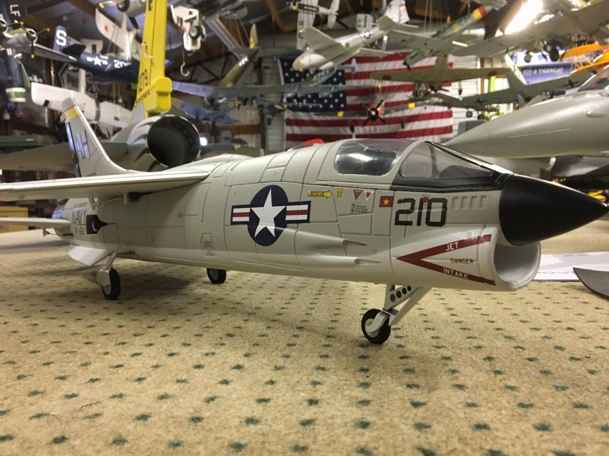

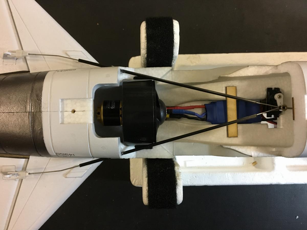

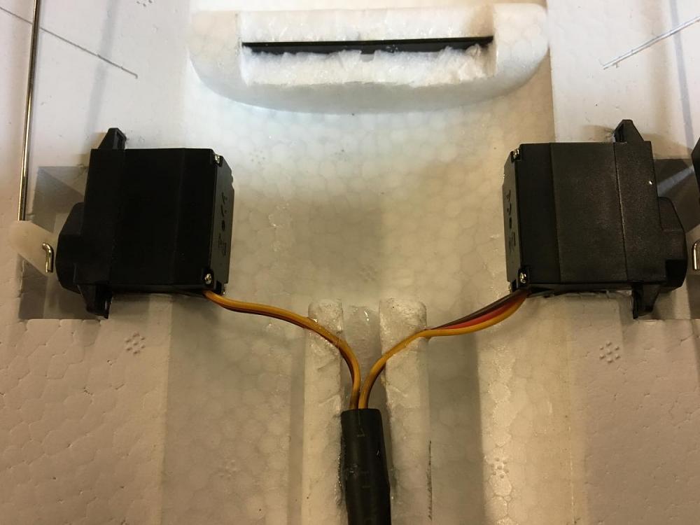

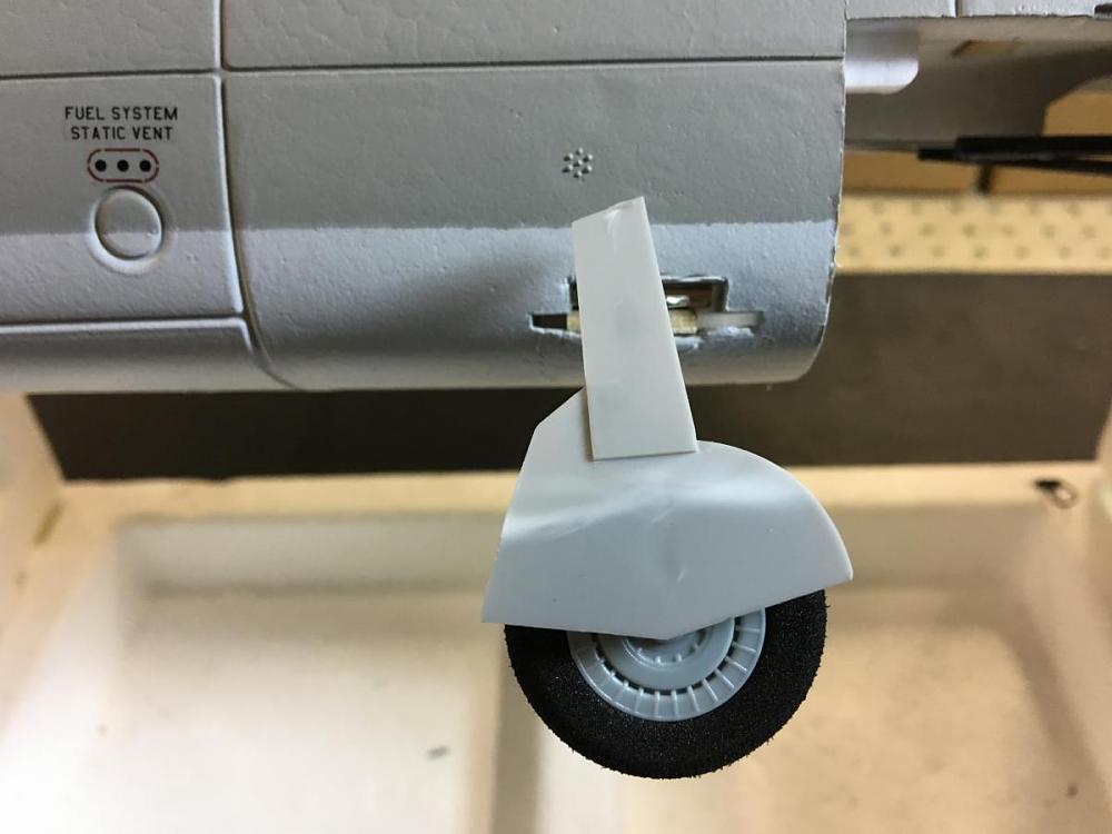

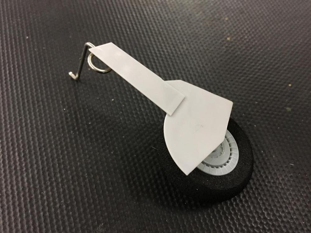

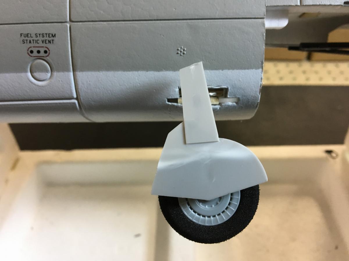

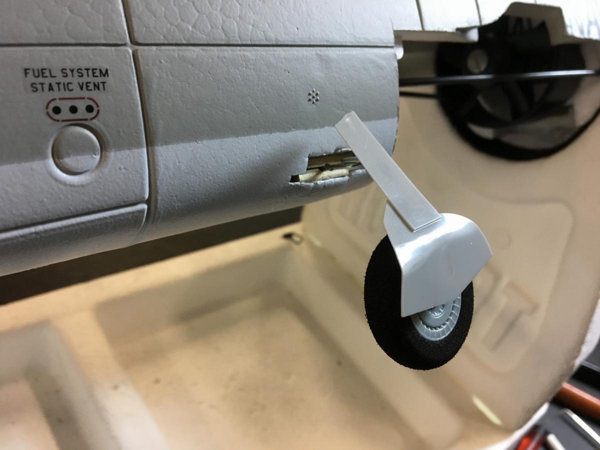

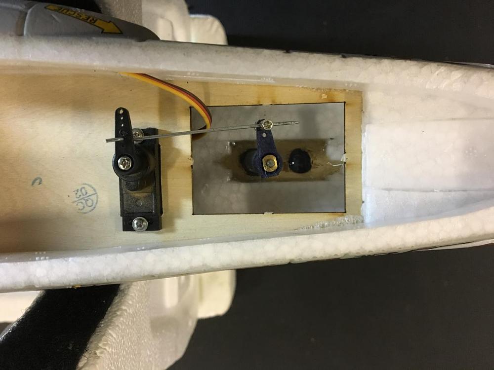

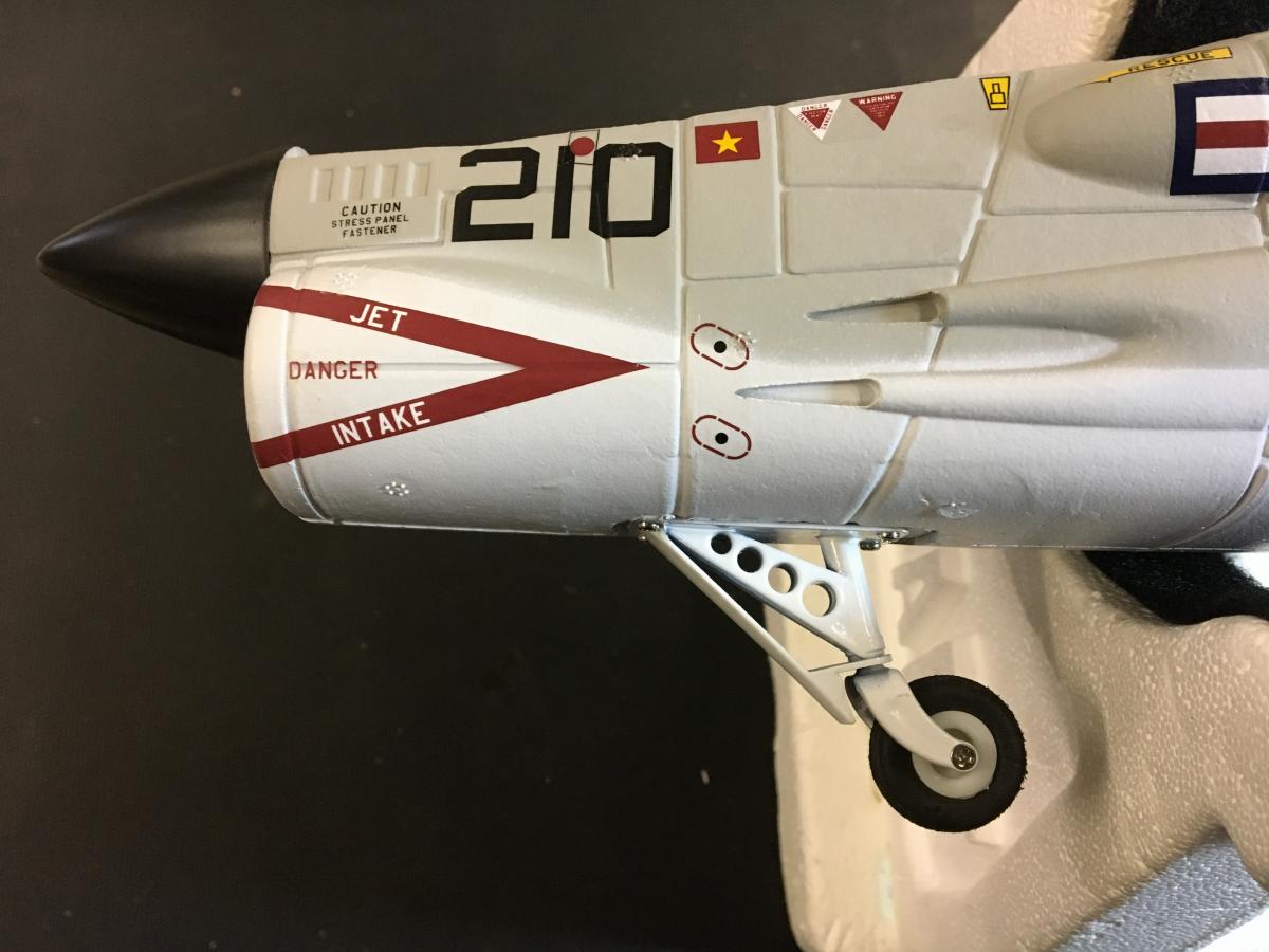

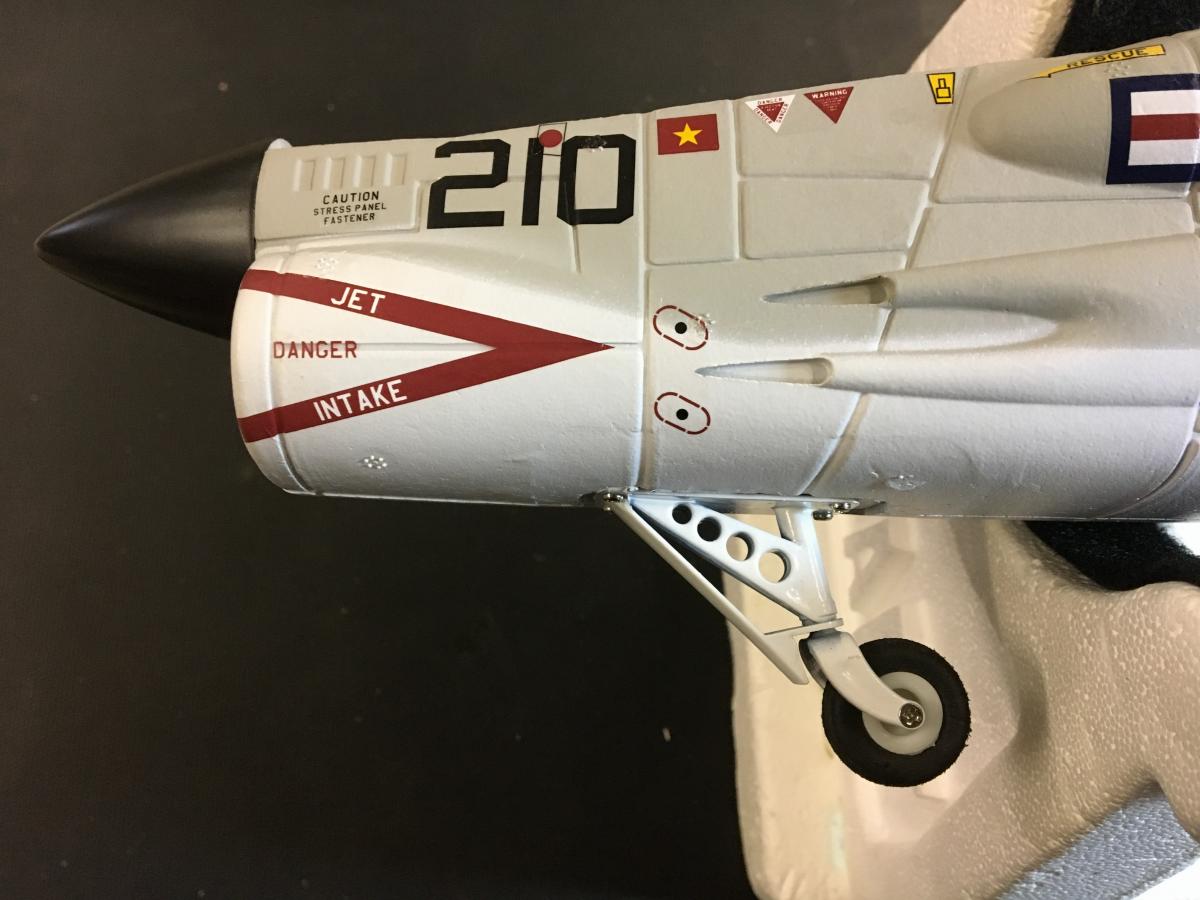

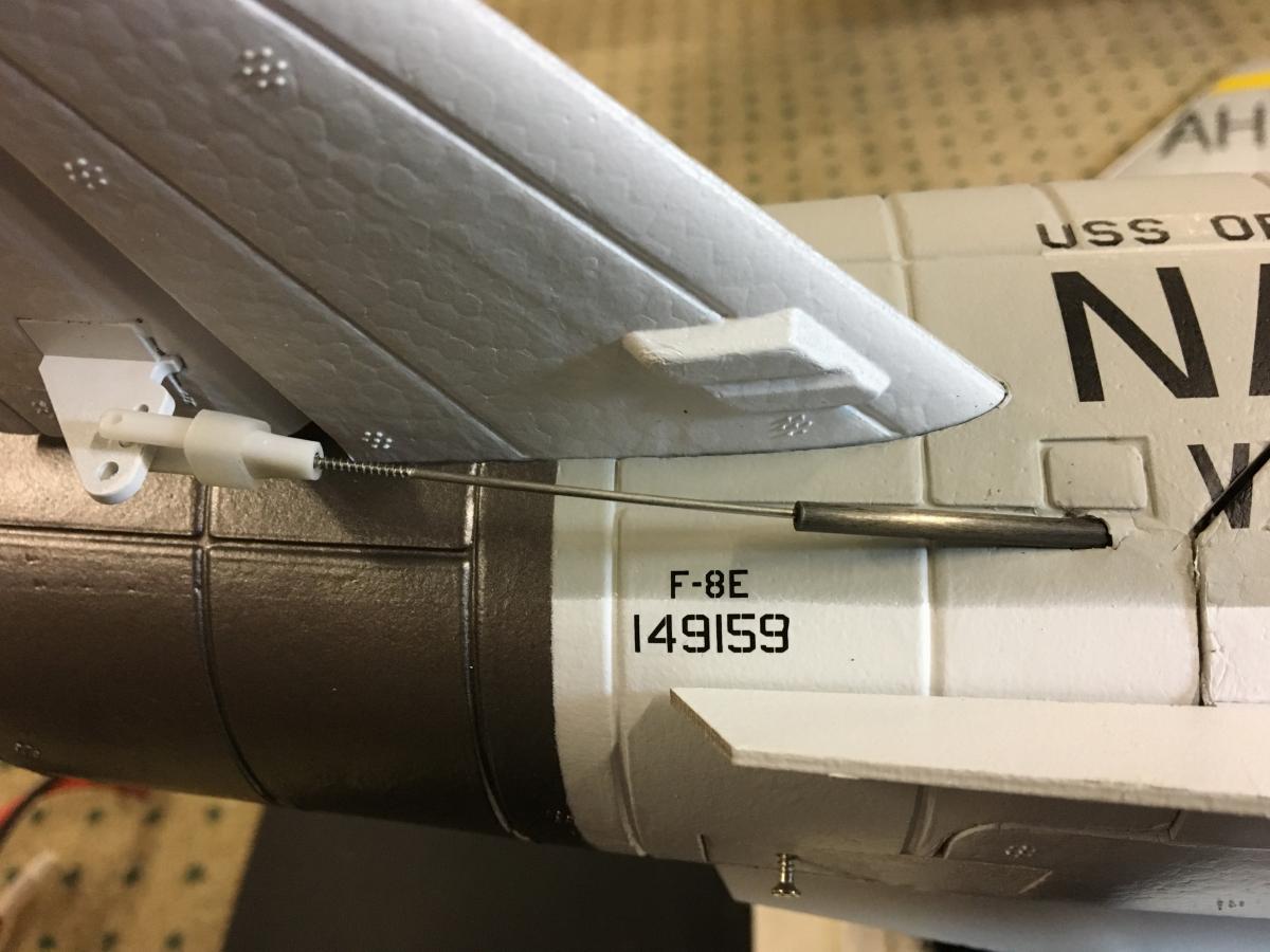

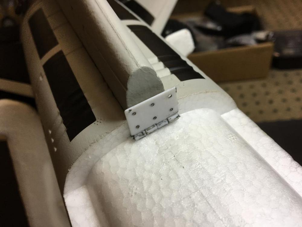

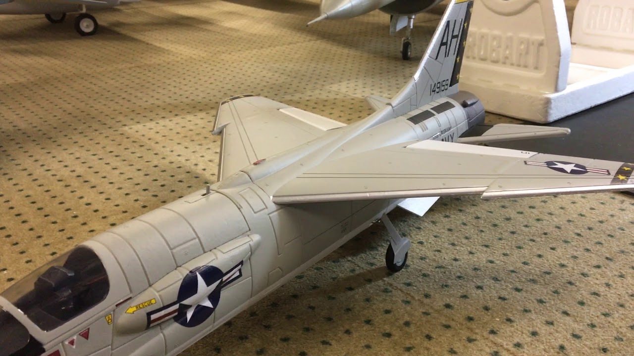

                                  I've been hacking up the F-8...I used a tail wheel assembly from a Eleven Hobby Bearcat for the nose wheel and a set of mains from a UMX P-47. I separated the elevators from the ailerons using another servo accessible through the fan cover, also added wing incidence modification.

                                      Very cool! Did you fly it in the stock configuration before you did the mods? I'd be curious to hear how it flies before and after. The whole connected aileron and elevator thing seems odd to me, but I've never tried it, so it may be fine. I still think I'd prefer a traditional setup, like your mod...
                                      I hate that motorcycle they make me ride. I'm here to tell you, there ain't nothing in the world I hate more than that elephant under my ass.
                                      -Officer John Wintergreen-
                                      ElectraGlide in Blue, 1973
                                        #79
                                        No, I only got it yesterday evening.

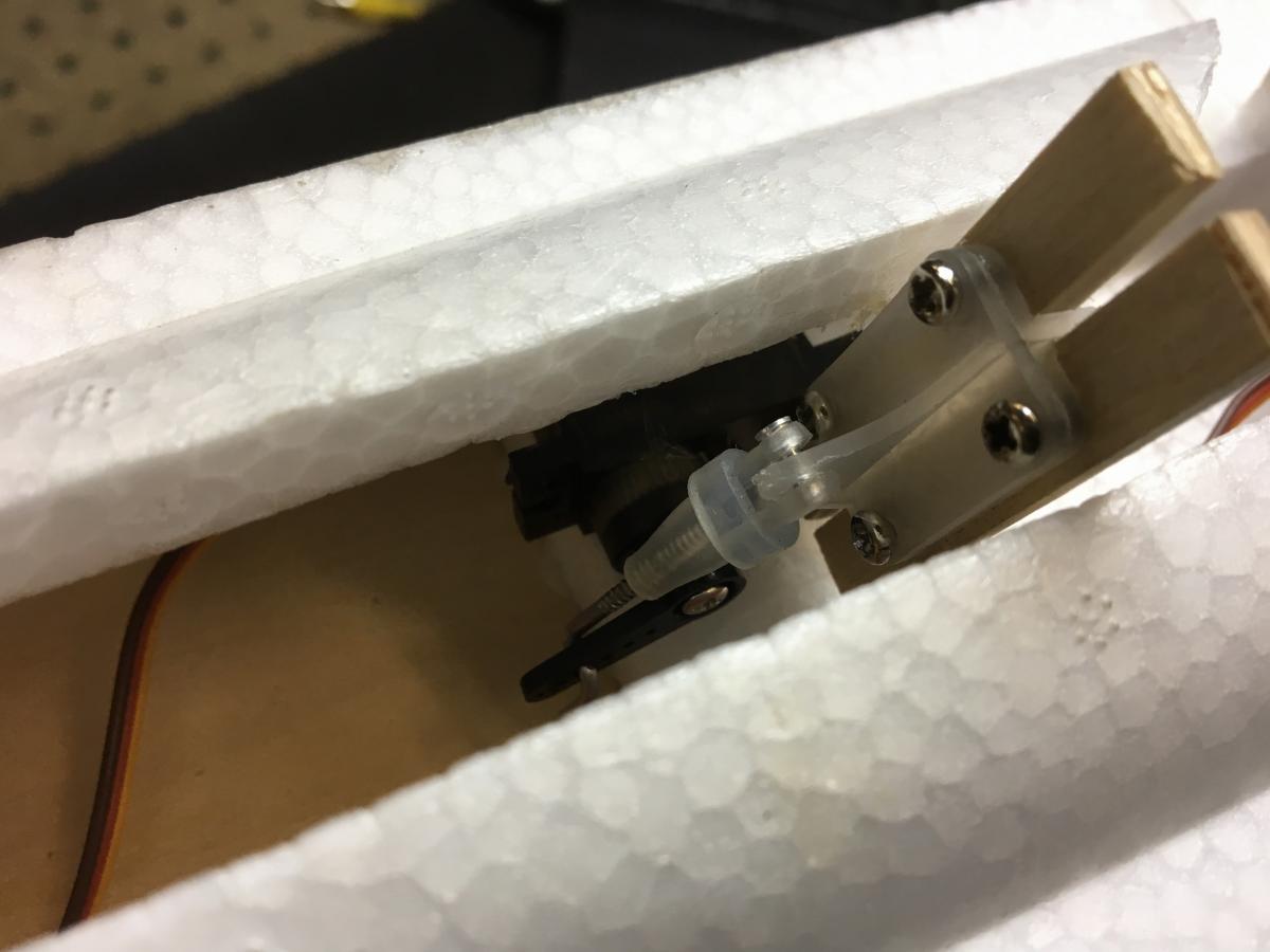

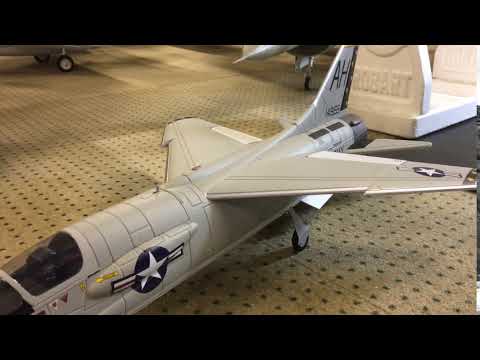

                                          #80
                                          Here's a short clip on the wing incidence mod.
