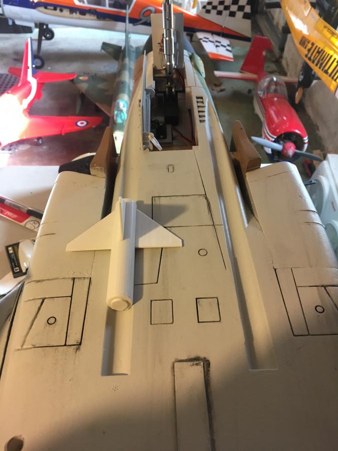

    Well, I've run into my first problem regarding scale and this is the sort of thing you need to keep in mind when working with semi scale models. It turns out the controlling factor that I didnt take into consideration was the center to center of the rails molded into the fuselage of the F4. Even though I scaled the missile close to the models scale ( about 11.5) , its "wingspan" goes past the centerline of the model significantly.
    So now I have to decide whether to scale down the entire missile ( to about 1:12.5 to make it work) or cheat something with the geometry on the fins.
    Even at 1/13 scale, my fins overlap some as well. These are from the Freewing F-14 ordnance set. I can live with it though.

    Maybe keep the current scale lengthwise and just scale down the width to just affect the fins? The missile body seems to be a perfect fit in the voids.
    I noticed I get 2 different scale numbers when using the planes length vs it's wingspan. 12.38 in one direction, 11.35 in the other. Personally I'll be rounding out my parts to 1/12, but like you are experiencing, certain things will need more changes to work.
Name:
