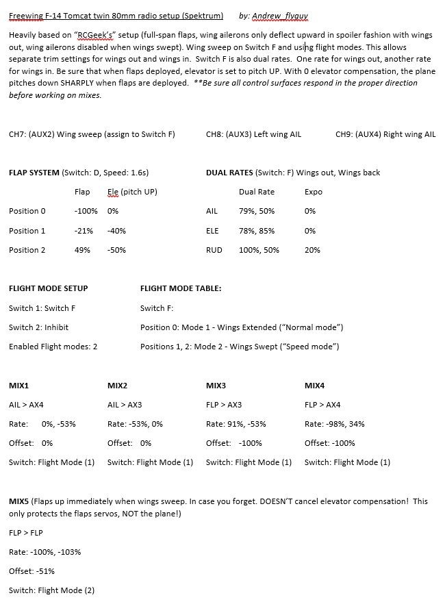

                              • Anyone know how to do a setup on Spektrum Tx that would not only cancel flaps when wings are swept but elevator compensation as well? Would like to idiot-proof my model from myself as much as I can. lol. Here's what I've got currently.
                                Click image for larger version  Name:	F-14 setup.JPG Views:	1 Size:	111.2 KB ID:	138194
                                • Just setup a dual rate to your tailerons with the same switch the wing sweep is setup for. Keep you’re pitch control the same in both wing positions. You only need a dual rate for roll with the wings swept
                                  • Still playing with my plan on the F-14 "flight modes" (Spektrum DX-18)
                                    Mode 1: Wings swept (2 sec delay to sweep), flaps/ailerons up
                                    Mode 2: Wings extend, flaps/ailerons up
                                    Mode 3: Wings extended, flaps down appx 10 deg, ailerons down appx 5 deg
                                    Mode 4: Wings extended, Flaps down appx 25 deg, ailerons down appx 15 deg
                                    Mode 5: Wings extended, Flaps down appx 40 deg, ailerons down appx 30 deg
                                    (full scale the ailerons come down about the same angle as the flaps. I drop them less for added low speed stability)
                                    I'm doing my elevator compensation for flaps with the stick. The amount needed changes significantly with airspeed.
                                    Note the delay on sweep to ensure flaps have time to be fully up if switching rapidly from 5 to 1
                                    Spektrum only put ability to have 3 rates even though there's ability to link dual rates to flight modes. So Mode 1, 2 and 3 are the 3 rates (actually I just change expos, with 100% throw always available on the tailerons)
                                    Currently I am not using the ailerons for roll. Using the taileron aircraft "type".
                                    Mode 1/2/3 on switch E, Mode 4/5 on switch F (E must be in 3 to get 4 or 5) It can go direct from 5 to 2 and very quickly to 1, but I don't recommend it without a LOT of altitude.
                                    I probably won't quit changing the programming until I'm done with the airplane.
                                    Full scale, the wing sweep is normally in automatic mode with the computer deciding when and how much to sweep based on airspeed, power setting and control deflection demanded by the pilot. The pilot can over-ride the computer but its usually a bad idea.

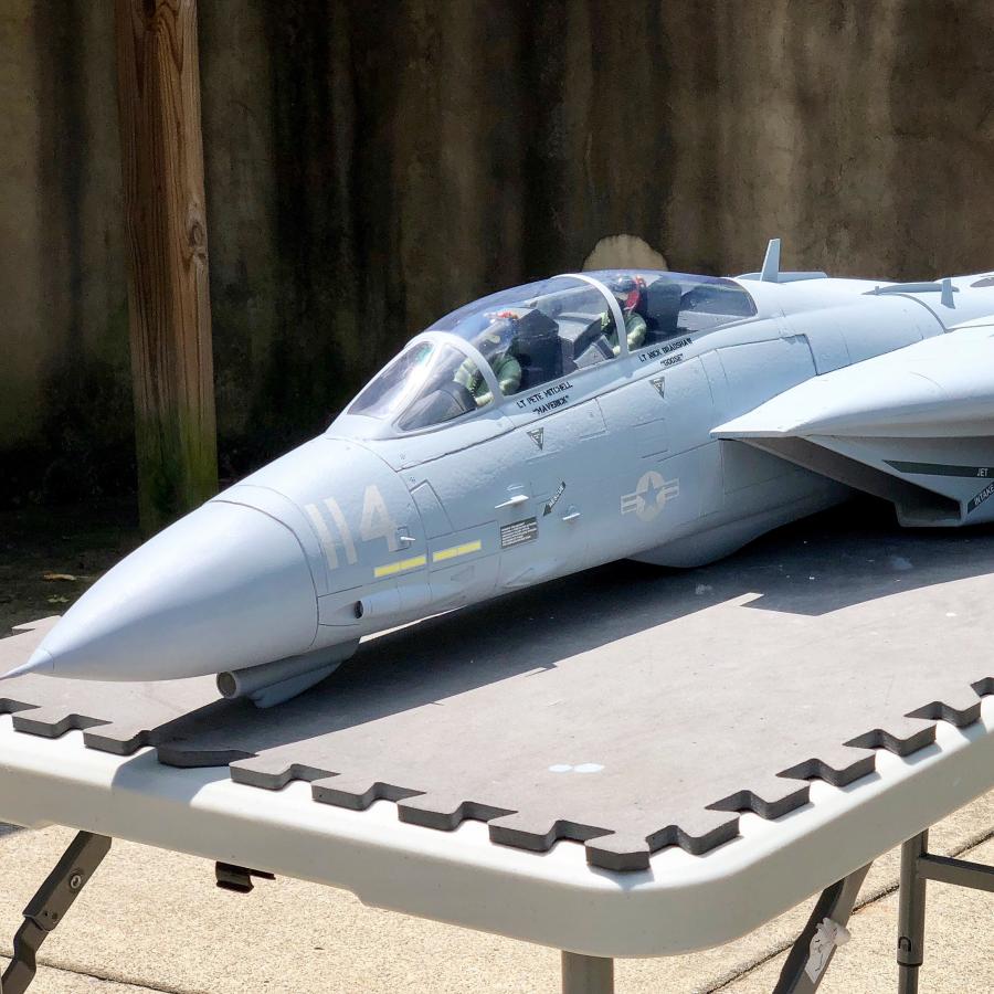

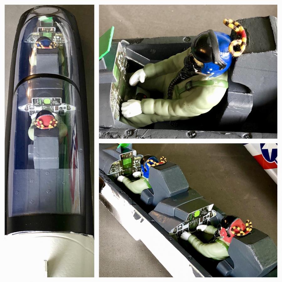

                                      Getting this Tomcat Top Gun’d up a little at a time. Painted helmets and scratch built some ejection handles from some fabric covered guitar wire. The decals from Callie Graphics JUST arrived!!
