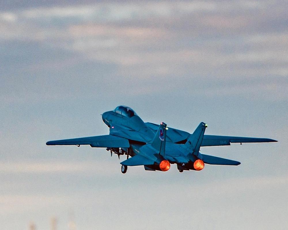

    • Michael Hines happened to have a very nice camera with him at the local flying field when I was there with my Top Gun refinished Tomcat this past weekend. I've put this pic a few places on facebook, but I feel it's definitely got a home in this thread as well.
      Click image for larger version  Name:	F-14 afterburner takeoff.jpeg Views:	2 Size:	87.8 KB ID:	171430
      • Gorgeous! If it weren't for the linkages I would think that was a full scale!
        • Yep, great shot Andrew!!
