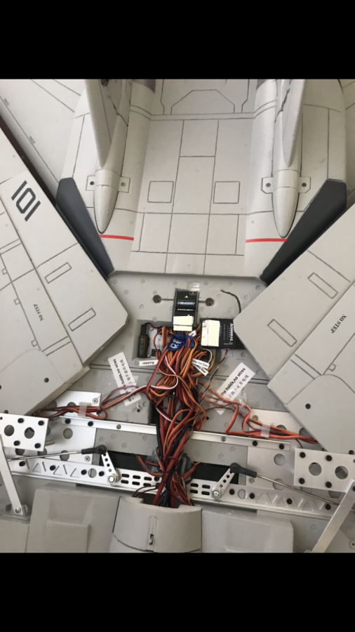

              • If you aren’t completely sold on the powersafe RX, (I think I saw your comments on RCG) I would just use a 10 channel Admiral/Lemon RX with a HobbyEagle A3S3. You want as little weight in the nose as possible.
                at least that’s the way mine is. I also use RC Geeks same setup with that combo.
                I saw on a thread that someone said the HobbyEagle gyros can’t run dual ailerons with dual elevators. That is wrong, the A3S3 has 5 ports, LA-LE-R-RA-RE. The only downside is that it requires at least one channel on your RX to change modes. If you want to adjust gains in flight, you’ll need two...

                        I also wanted to use Spektrum AS3X in my F-14 and tried using the AR9350. I couldn’t program it to function correctly at the time so I swapped with the A3S3. It would be a perfect scenario if the AS3000 was compatible with the 9030T. Then you would have everything.
                        I put the 9350 in the 90mm F-22 with a bunch of telemetry sensors. It works fine for that plane, but I wanted to be able to use tailerons when full flaps are selected and I couldn’t program it normally like I can with the HobbyEagle gyro.
                        • I too was looking to put AS3X in my Tomcat, but needing a PC to program it... hard pass. The blue HobbyEagle A3L is my go-to and continues to serve just fine :)
