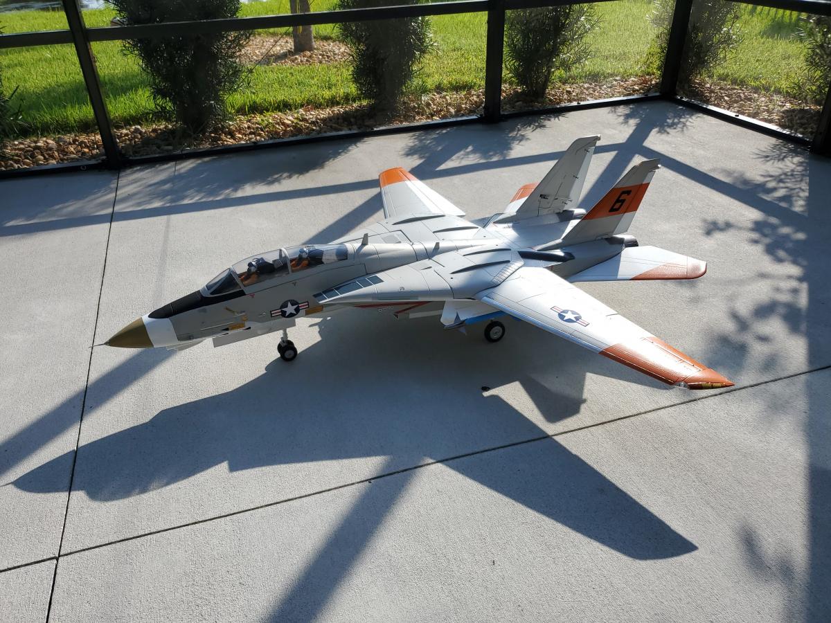

                                        • Finally got around to my second F-14 build. I still have a few details like A model nozzles and gear doors for the mains. This is Grumman F-14A prototype #6 used for test and evaluation. Click image for larger version
