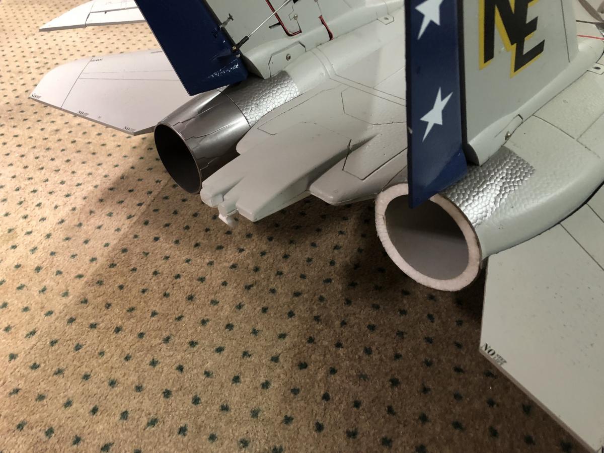

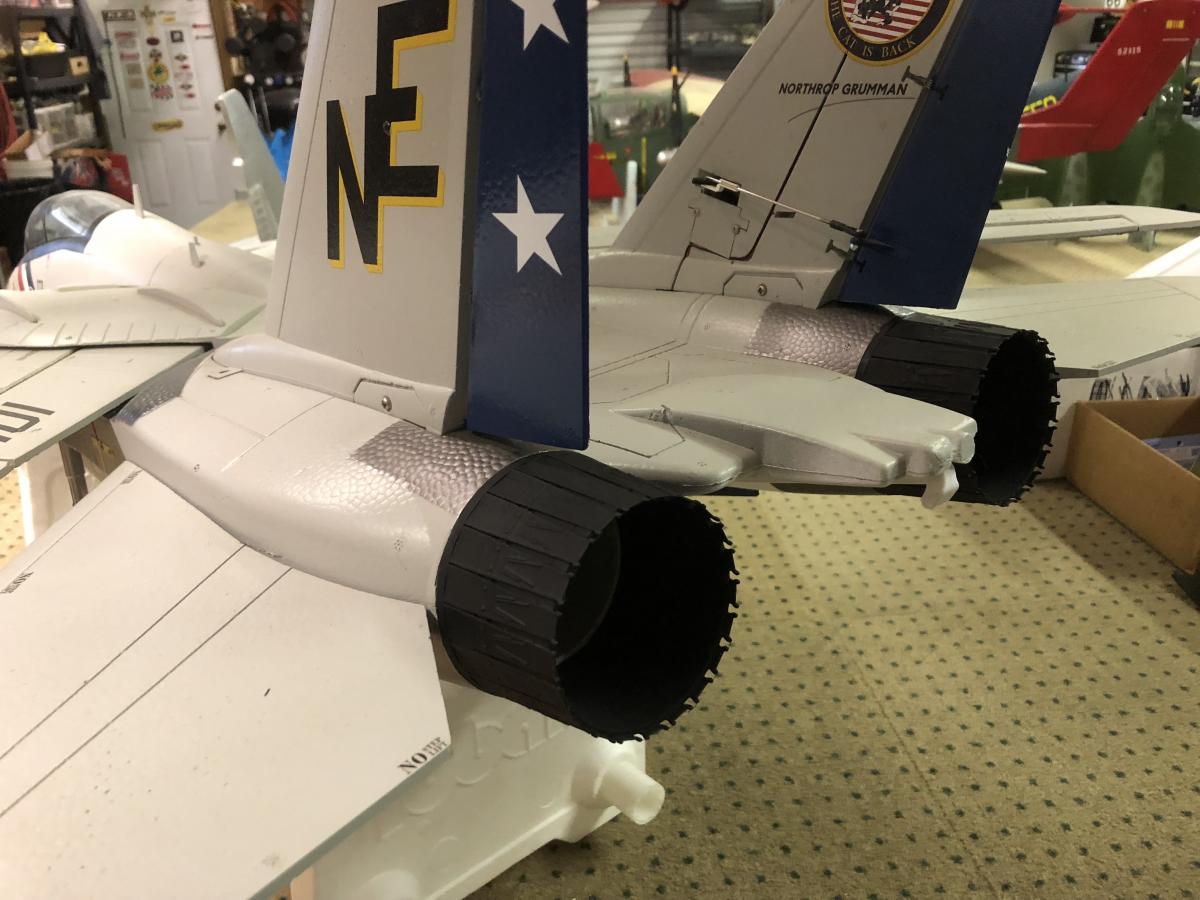

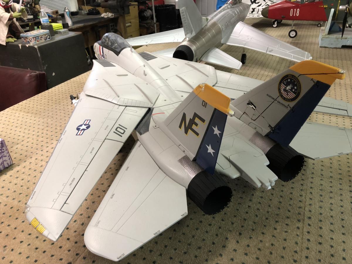

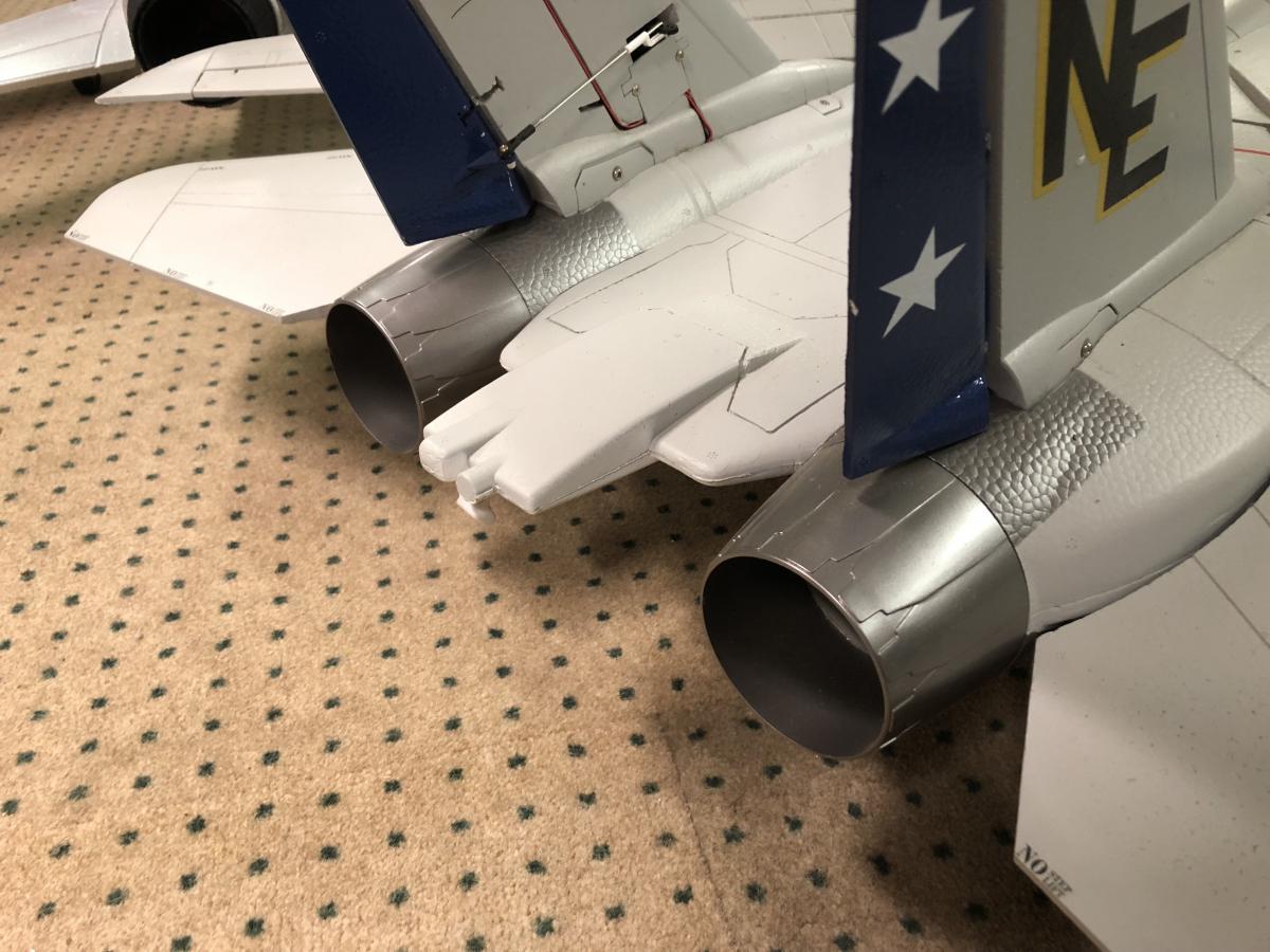

                      • Got tired of the stock nozzles and scaled these to fit it ;)
                        Credit to Rcfiddy1 on Thingiverse for the file.

                            • Originally posted by Rcfiddy1 View Post
                              Looks Awesome.....Glad you like them.
                              These are awesome, can you make a version where the end tips are thicker.
                              • Sure, Ill sit with it tonite when I get home. Your talking about the small tid bits at the end that stick out past the edge?
                                  Yes, they are half the thickness of the cone for about the last 1.5mm.
                                  • Ok done. I bumped them out 1.5mm more. Would you happen to know the diameters of the nozzles both inside and out and airframe side and outlet side? I will try and model a new nozzle based on the size you give me. Or I can rip mine off my tomcat and measure them if you don't know the measurements.
                                    • Pay attention to final outlet diameter. Its important to how the EDF functions
