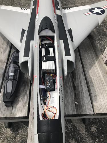

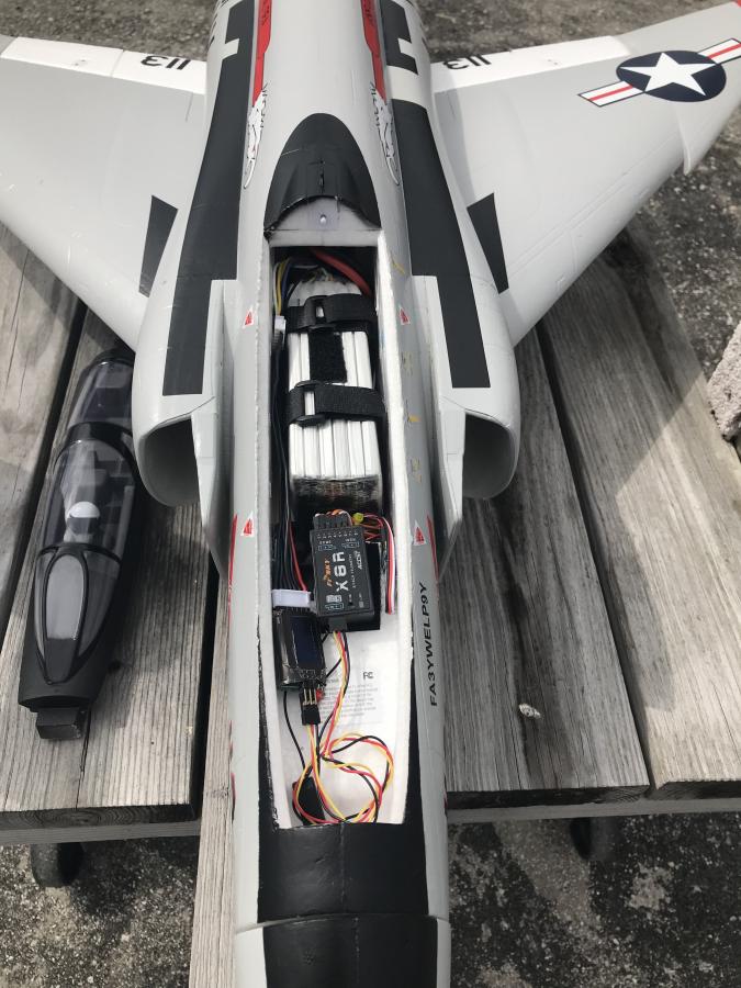

ID:	186033 Successful maiden and subsequent flight using 6S-5000 lipos pushed all the way forward. Didn’t balance it, figured no where else to put lipo so let her rip! I used my own FrSky rx with 100% elevator throws (40% expo) and 60% aileron expo. I had to give about three clicks of down elevator and two clicks of left aileron and she was cruising around nicely at half throttle. Very forgiving and tracks straight and lands like a *****cat! Take off was about 3/4 throttle and no flaps due to wind down the runway and it took off in about 75 feet but I was conservative, it will get up in 50 easily. This jet was everything I hoped it would be. The wing attachments need some work but my wings won’t be coming off unless something tragic happens. I flew 1/2 throttle the whole time for 3.5 minutes and came down with 3.8 per cell. The second flight I pushed it up to several full throttle passes and it sounds great, quiet and SMOOTHHHH! A high alpha landing just bleeds off speed well with half flap landing. Love it! Maiden pic attached.

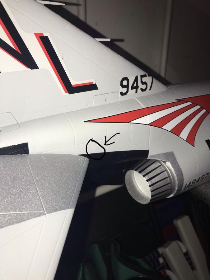

                                          P.S. see the mark on the fuselage that is a good reference for proper elevator alignment. The line for the middle of elevator should match up with line on the mark on fuselage. Note: my elevator in pic is NOT in the right position.
