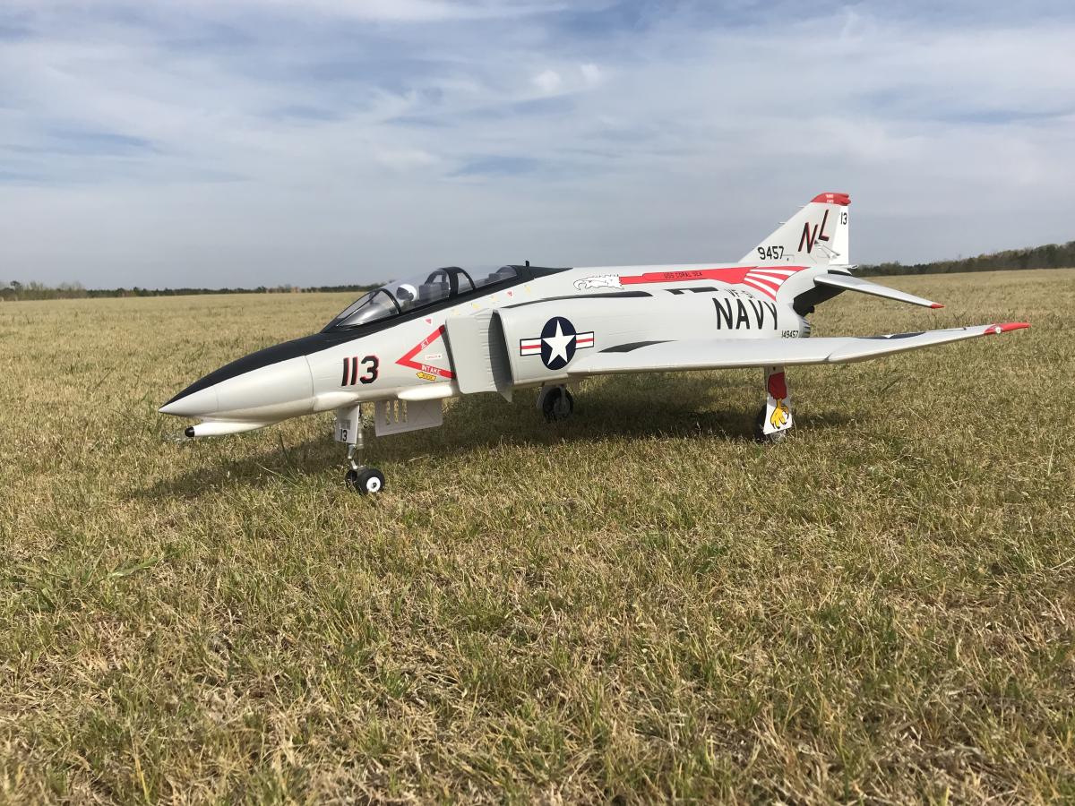

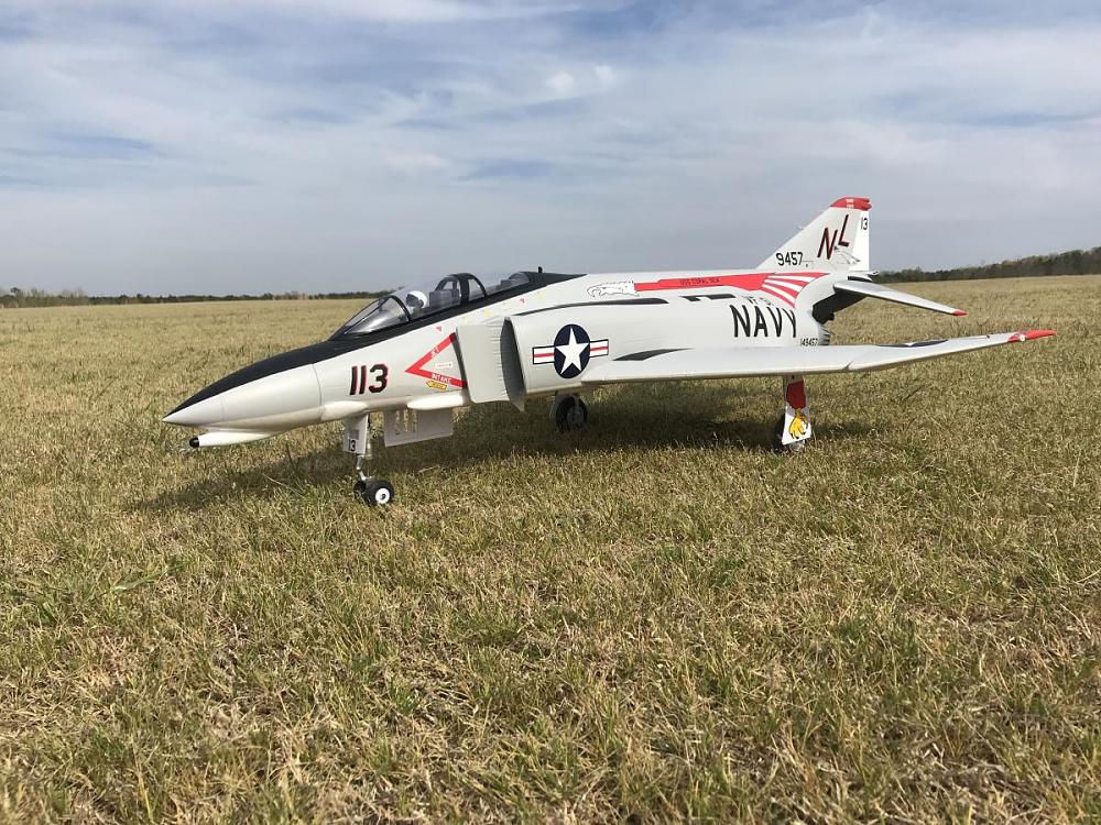

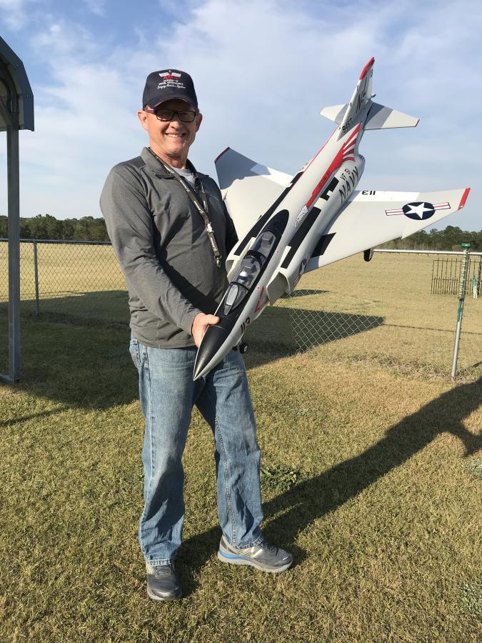

            Maidened mine today. A bit more wind and a little gusty but it was right down the runway so gave it a shot. I talked about changing the stab to align it with the wing but ended up putting in a bunch of nose up trim, so will likely be 80% back towards the original setup. The field is manicured grass and was fine.
            As it was gusty and a bit turbulent I left the gear down. Took off at half flaps. Flew around for a while and dropped the rest and the nose up bias I'd ball-parked was perfect. Landed great. If the wind had been lower and I'd had a couple more batteries I'd have tried it again. Click image for larger version

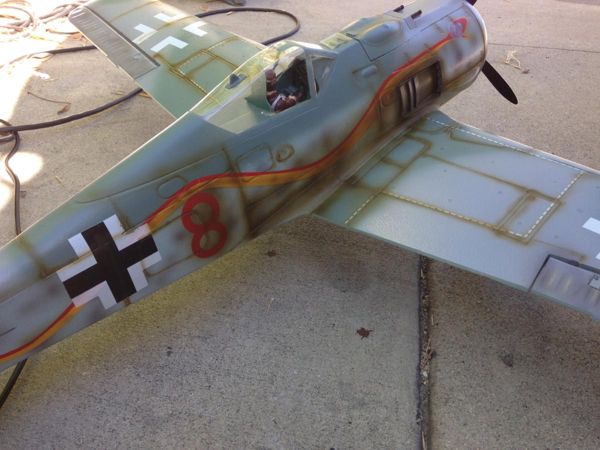

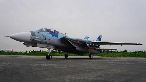

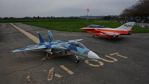

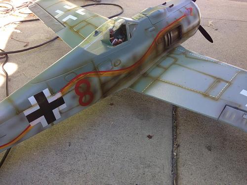

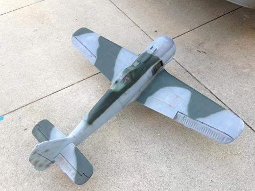

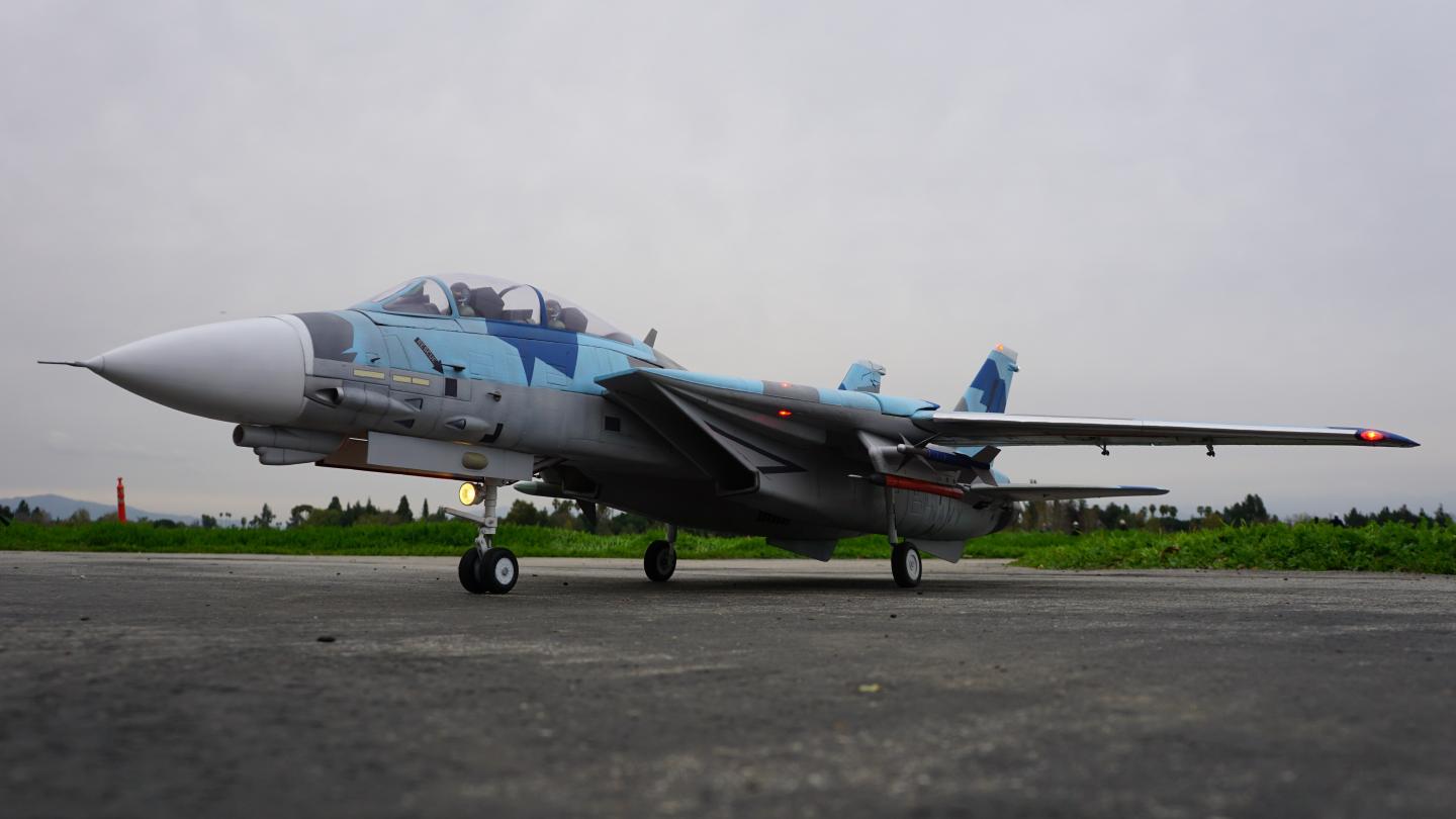

                      I paint right over the stock decals on all of my foamies, from all brands. Eflite's waterslide decals are thin like many others, which is very convenient when it comes to painting over them. In my experience, removing decals can be tedious, and oftentimes can mar the underlying foam, creating an uneven surface if the foam cells become shorn. At that point, you'll need filler or WBPU and sanding to return the surface to a uniform level. As an example, I painted directly over this FlightLine FW-190 with its prominent serpent decal and this Freewing F-14 with its approximately sixty decals. Painting directly over all of them was quick and easy, and the end result is convincing. I'd recommend trying this approach to see if it fits your needs.
                      If you did want to go the route of removing the decals and refinishing the surface, I recommend checking out Chris Wolfe's excellent guide on TheRCGeek.com. He made an excellent tutorial to refinishing foamies using an FMS Mustang.

                        curly looks like you have a ton of down elevator in it in the pic is that the way it flew or just not adjusted for flight (like u moved it picking it up etc)

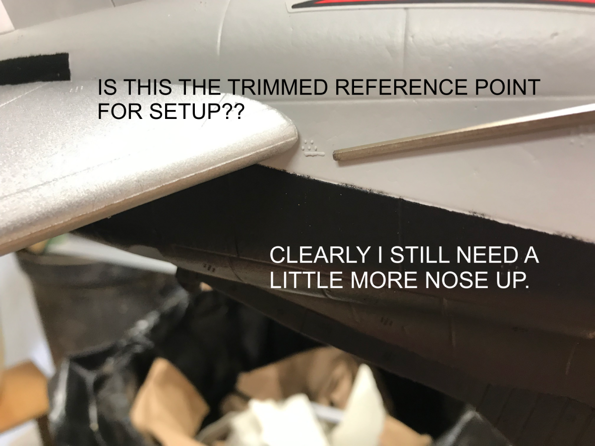

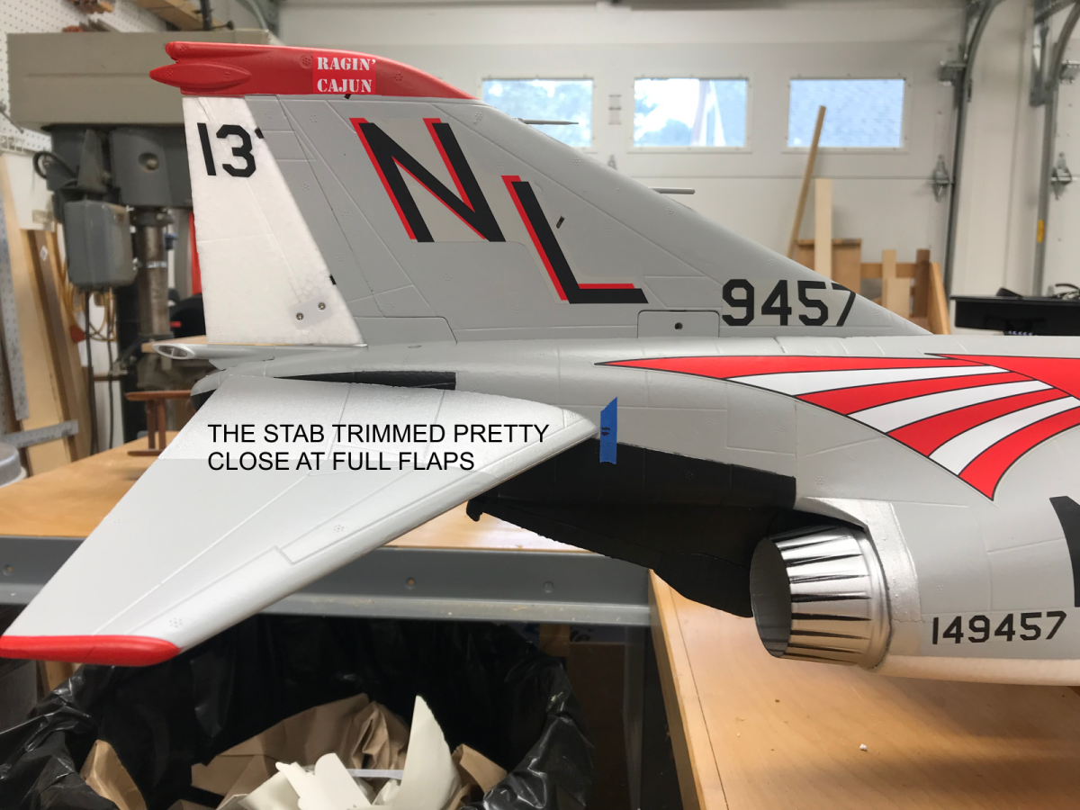

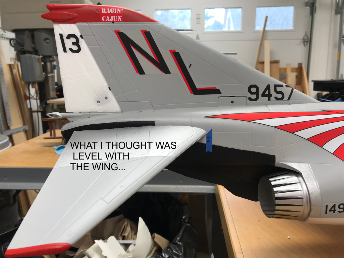

                              So... playing with the stab. The attached pics who what I THOUGHT it should be, what worked at full flaps, and what I think is intended to be a reference mark....

                                        • Curly...yes that mark on fuselage is reference point for the mid-line of the elevator...I maidened with mine a bit below that mark and had to click in about 4 clicks of down to bring her perfectly level.
