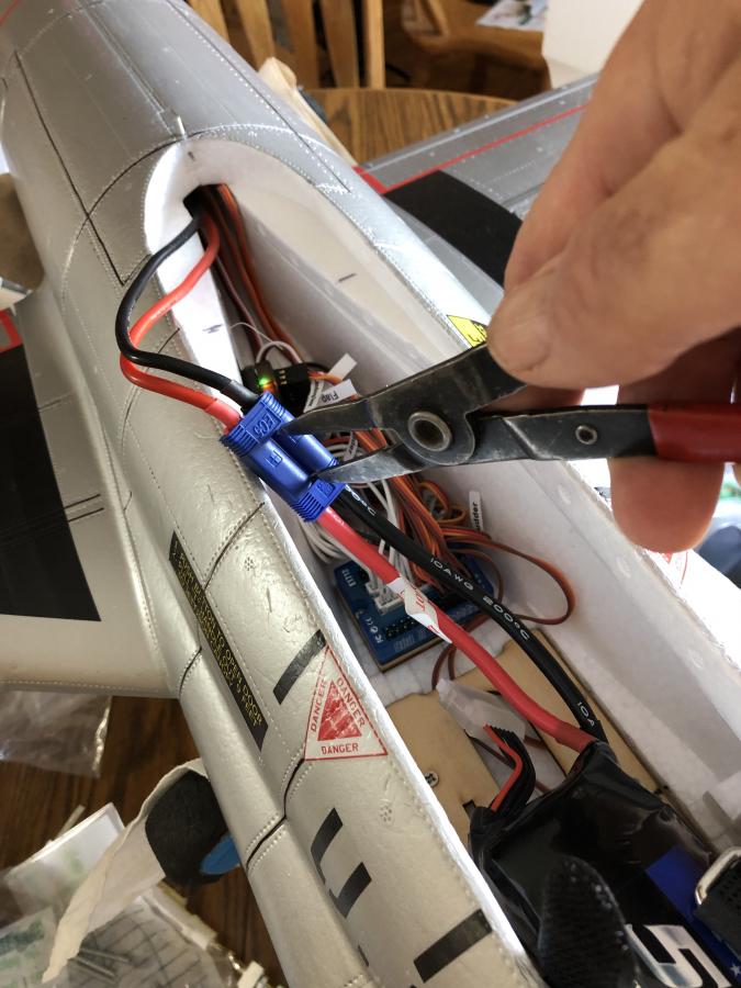

    .................................................. here is an easy way to disconnect EC3's and EC5's
    Good idea! Why didn't I think of snap ring pliers. Always afraid of damaging something trying to pull them apart.

    steering wheel 1"7/8 and the mains are 2"3/4 here is an easy way to disconnect EC3's and EC5's

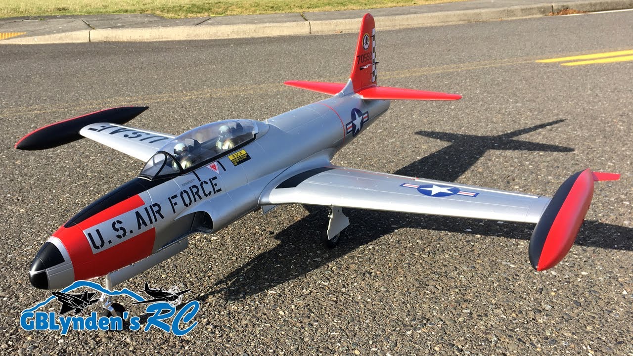

  • GBLynden
    This is me ripping with it on my second flight
