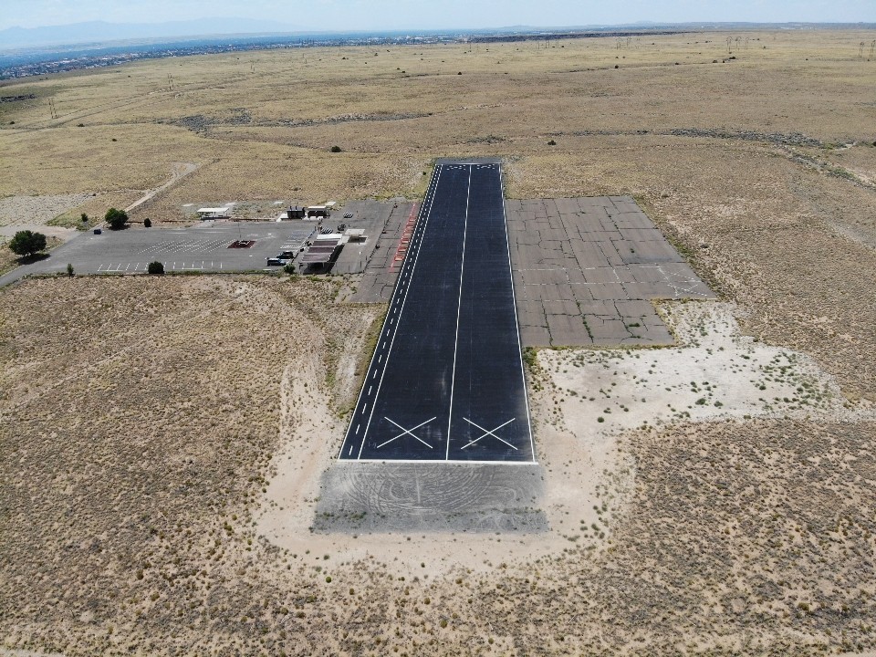

                        Maloof from above. One of the oldest airparks in the country. 800ft long just resurfaced by the city. Plenty of room for turbines and any other model.

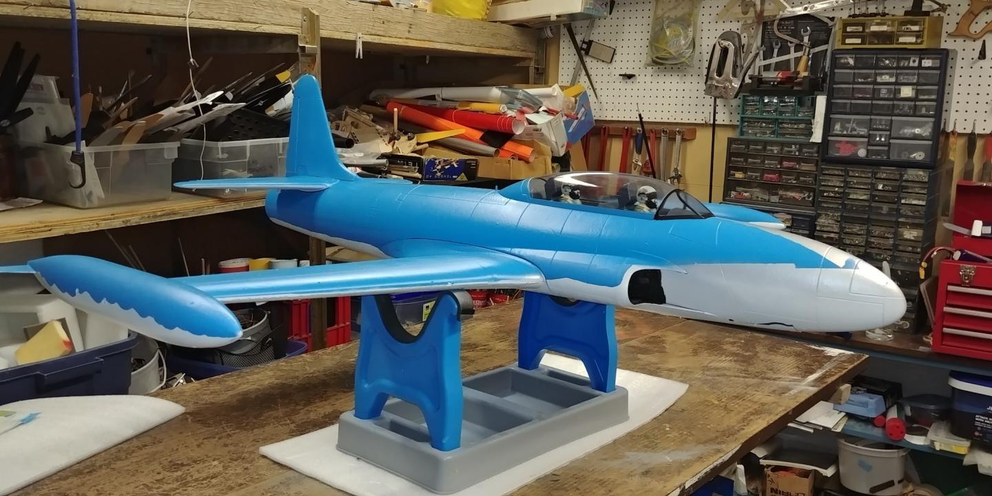

                              #834
                              Still have to finish painting the nose and apply the graphics, but I am very pleased at the way it is coming along. The colour is off because of the fluorescent lights. Still amonth before the field is free of snow so no rush.

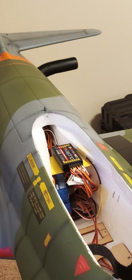

                                  Has anyone installed an Admiral RX600SP Gyro receiver in their T-33? Interested to see where and how you placed it. Pics would be greatly appreciated if possible.
                                  Thanks,
                                  Tony
                                    • 2137
                                    • On planet earth....right
                                    #837
                                    Thanks,
                                    Tony
                                    Although mine is not an Admiral RX600SP, it is still a gyro receiver. I made a small solid shelf out of thick styrene to ensure no flexing and movement during flight, and any wires down below it are also now secured (especially the ESC power leads) so they do not knock into the shelf when inverted, etc. I hope this helps. Some people had room to place their gyro where the blue MFCB was, but I couldn't due to how far I had to move my heavy LiPo back.

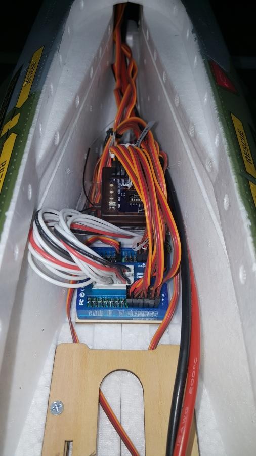

                                          #840
                                          Thanks,
                                          Tony
                                          I'm using that admiral gyro receiver in my T-33. I also added a wooden shelf behind the bluebox and placed the admiral on it. I did place the shelf a little bit too far aft and the servo cables from the bb coudn't reach my receiver, so I rotated the bb 180 degrees to solve my problem.
                                          This is not my picture but my installation looks very similar:
