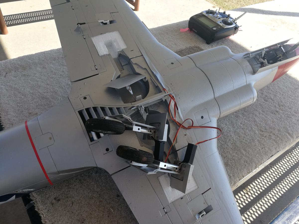

        Check those landing gears. Had a successful maiden today. Very enjoyable jet to fly, but please check the two rear landing gears. Both came off due to lack of glue. In fact the left gear hardly has any glue at all, which makes me wonder whether the worker at the assembly line just completely forget to put glue on them or not. Anyways, there is nothing a little CA can't fix.
          #864
          Not cool.....,
            • 2137
            • On planet earth....right
            #865
            The lack of glue issue on any plane is always obnoxious, regardless of manufacturer.
            Flanker, instead of CA glue, I'd use expanding Gorilla Glue as it fills voids of space and adheres well.
              Yep, good point. Gorilla Glue is the permanent solution. CA was all I had at the field. If it comes off again it'll be Gorilla Glue.

                      It’s unfortunate that so many are having to re glue the mains back in. I got lucky on mine. After twenty or so flights mine are still secure. Seems to be like a box of chocolates with what you get.

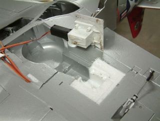

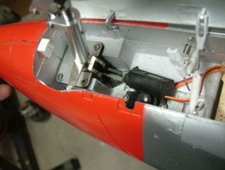

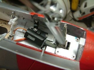

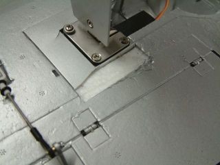

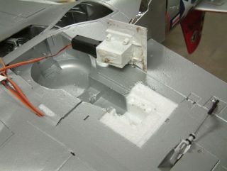

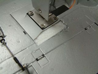

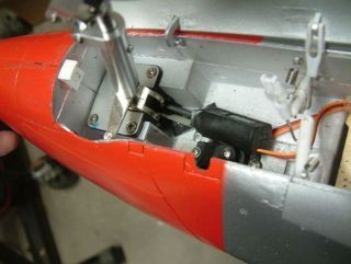

                        Maiden:
                        Good news ...........
                        Hoping that we’d be getting a break in the weather so I can get a maiden and not have to wait til spring happened.
                        As many have already described the characteristics of the plane, I also would confirm that. It was the easiest maiden of any EDF I’ve flown to date. With the CG to spec. it took a little more elevator to lift off which indicated to me that it’s a little more nose heavy than I like and the 9 clicks up elevator at half throttle for level flight kind of confirmed that, and that’s with all the surfaces “0”’d out. So I’ll be move the Batt. back to my liking in the next series of flights. Did a series of loops, rolls, and inverted flight, needing very little down elev. to maintain level flight. The were absolutely no surprises with this plane .... absolutely love this plane.
                        Now the Bad news ..........
                        Because with the snow and run combo. the dirt shoulder was very soft. Not muddy but enough to where you couldn’t have taxed on it. So with gear dn and full flaps it was settling down nicely as I made my approach. I was making about a 30 degree cross field landing to compensate for a 30 degree cross wind from the left. The right main touched first then the nose gear. The gear dug in the soft shoulder, ripped out the main (no surprise there) which then broke the NACA cheater grid, then collapsed the nose gear and broke the retract servo. Had the dirt shoulder been dry, it would have it would have just skipped and popped on the runway. Alas, it wasn't........... I figured that if the runway was 2 feet lower I would have greased it on ................. LOL!............ So it was pilot error. I could have saved it had I’d added a little power.
                        So it could have been worse, no damage to the foam structure, not even the tip tanks were scuffed. So I’m only left with some plastic replacement parts, since ordered. I now have a chance to do all the mods I’d had planed and a repaint, just a little ahead a schedule.
                        Previous posts references to the glue issue: 770,789,849,863.
                        Here’s some pics .....
                          I had what I felt was a great maiden today. The German livery version. Flew great. Love the plane. But then the landing. It was a normal landing. Not hard by any means and my starboard main LG popped out. Broke the wire at the base. Gear doors also broke. I'll have to take apart and solder the wires. A real PITA.
                          Mine is the 4th T-33 at our field in recent weeks to experience retracts popping out due to a crappy glue job. I knew about this potential problem but there's no way to check if they are glued in solidly. I wiggled them and they seemed okay.
                          Motion should know about this known defect.

                                  #876
                                  XV,
                                  As you can see in the above pics, The nose gear mount held up fine but the retract servo broke. Probably the mount has so much surface area and appropriate amount of glue, it wasn't an issue. At least in my case.
