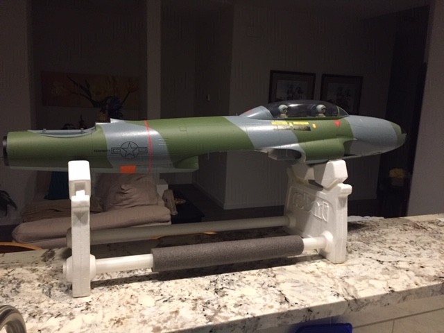

      Click image for larger version  Name:	 Views:	0 Size:	56.3 KB ID:	239282 Finally completed my USAF conversion! Maiden was flawless.

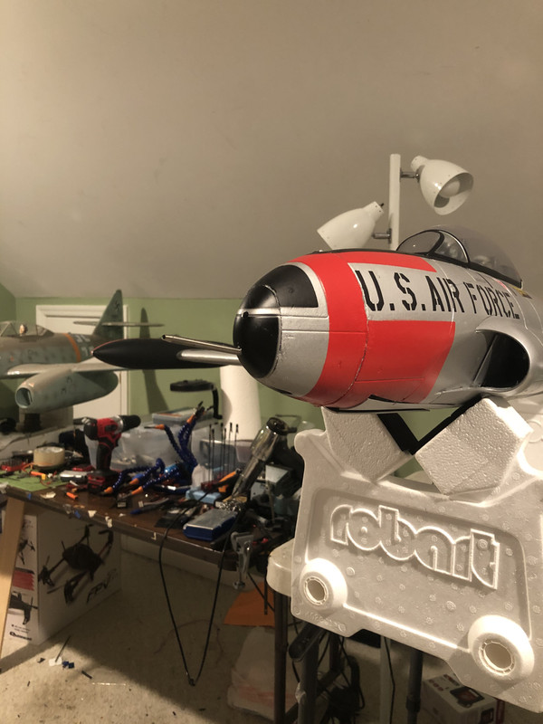

          It’s not much of a mod, but I’ve added a FrSky pitot tube to my T-33, to get real-time airspeed telemetered down. I also installed a FrSky GPS sensor, to get ground speed, altitude, and distance. The GPS data probably won’t be very accurate, but I’m looking forward to getting the airspeed and ground data during flight.

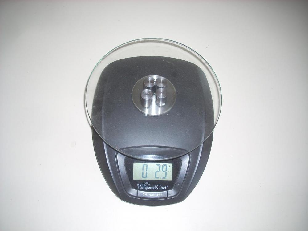

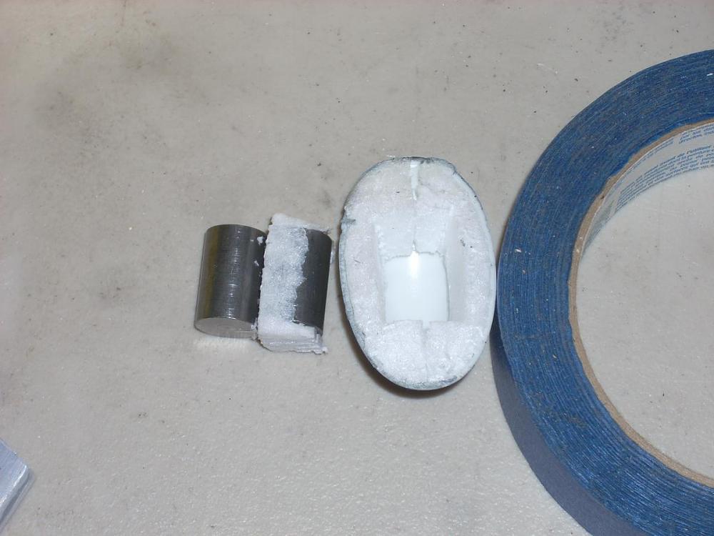

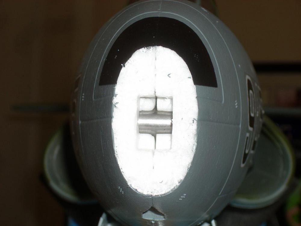

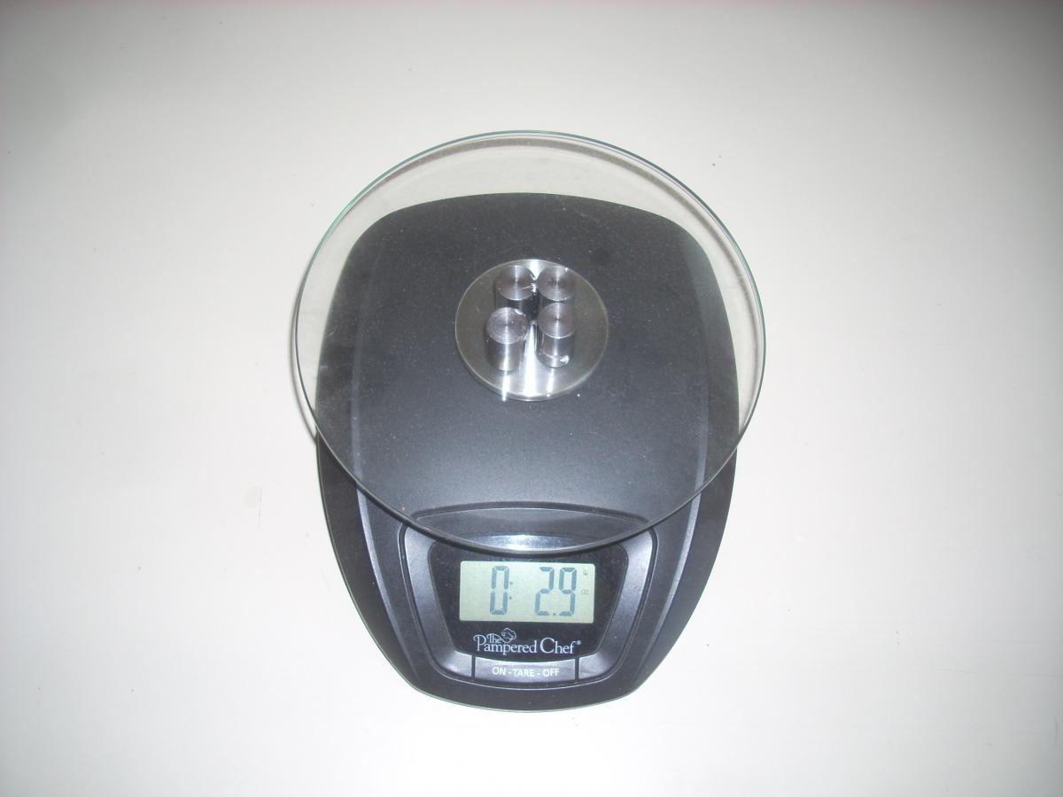

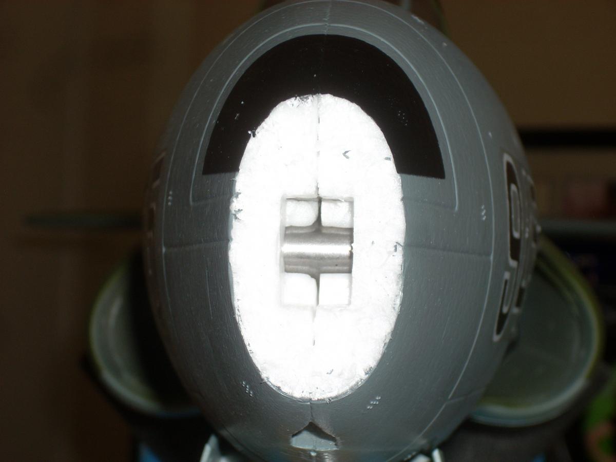

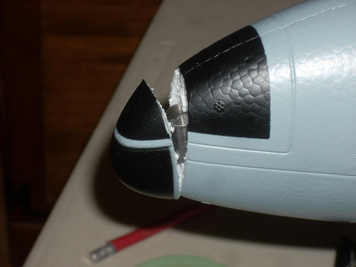

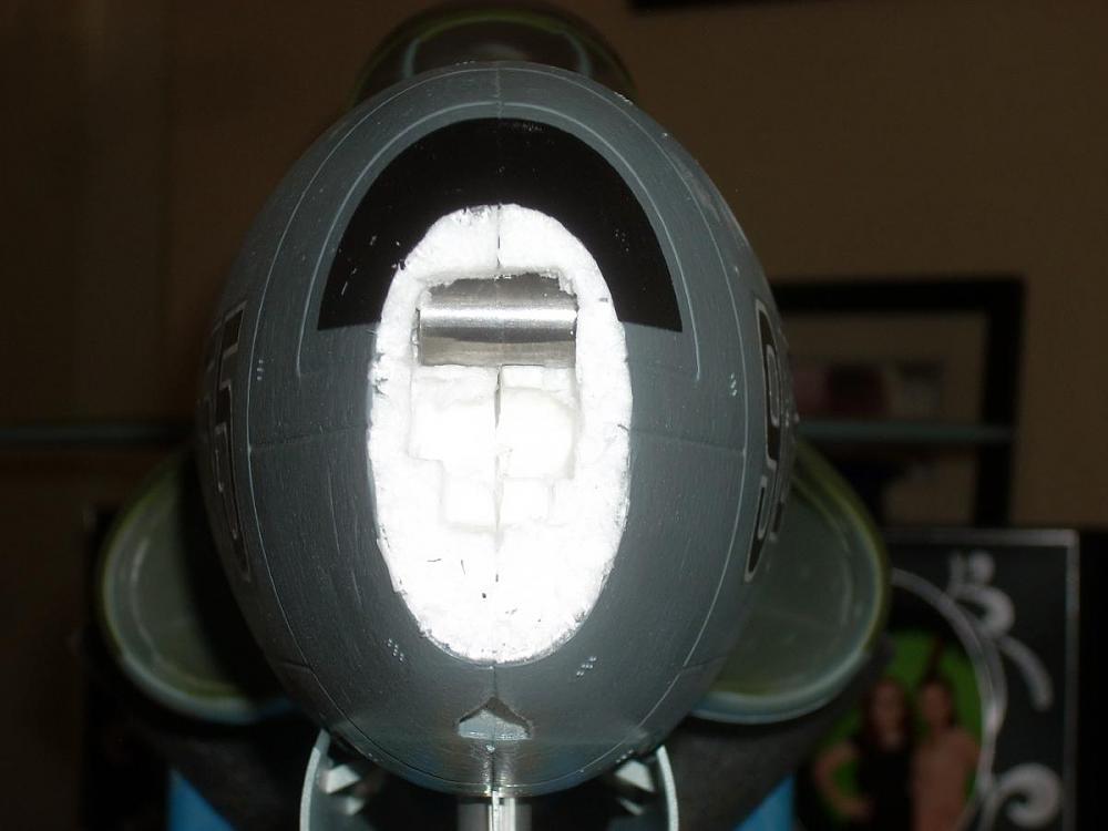

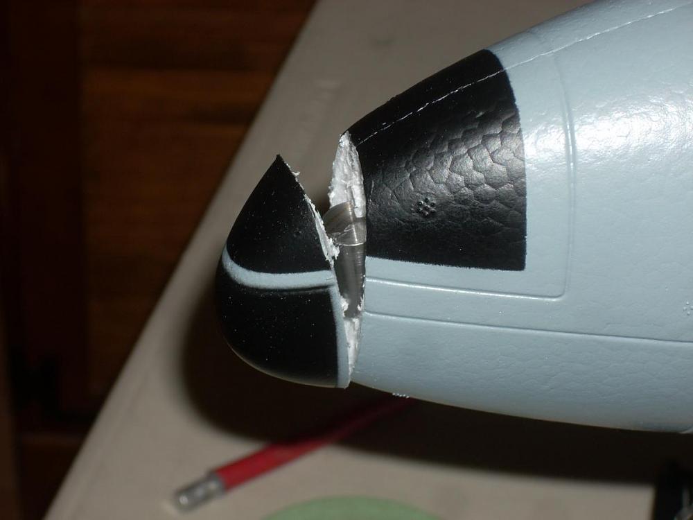

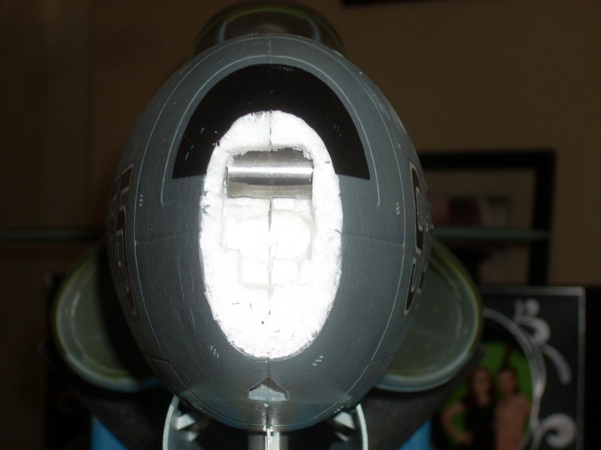

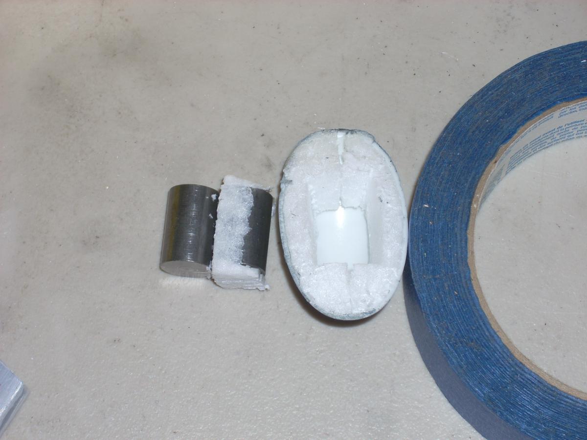

              So when Ox was putting in the airspeed sensor tube, he said there are weights in the nose. Dug into mine today and found 4 of them. So, for those that want to remove your nose weights, it's a quick 20 minute procedure. Take a sharp knife and cut the nose cone away from the fuse. There is a weight on the cut line, just make sure you cut the foam all the way to it. The nose will then pull off along with two of the weights. Trim the foam around the front weight to remove them from the nose cone. They should come out as a pair as they are glued together.
              Looking into the fuse you will see one of the two remaining weights. Trim the foam around the visible one, then use needle nose pliers to carefully remove it (these two should not be glued together, so remove one at a time). You'll then see the final weight above the one you removed. Trim the foam around that one and pull it out as well.
              Finally, glue the nose cone back on and you're done! Total weight removed is 3 ounces. I'm using a RoaringTop 6250 in mine pushed all the way back to the blue box. I don't need the extra weight .

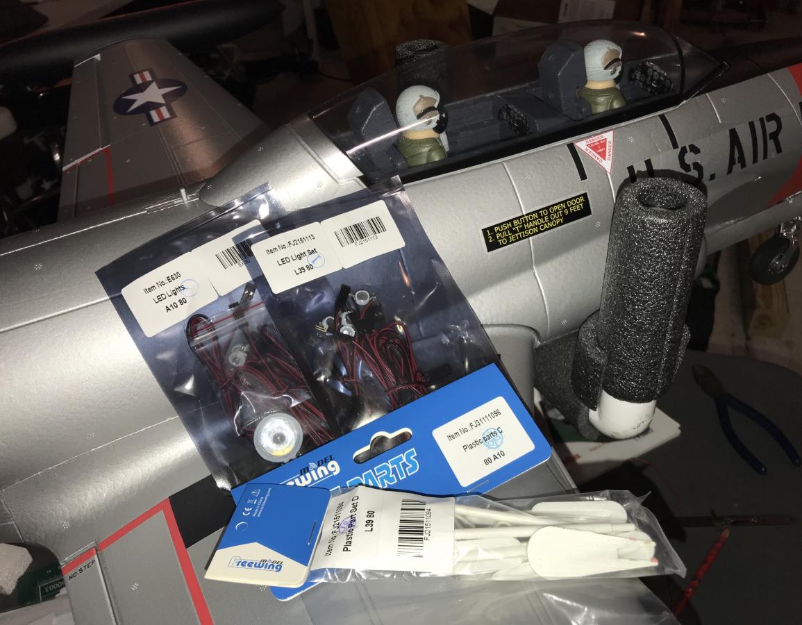

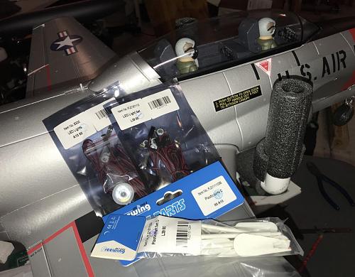

ID:	240112 Thanks ELBEE, appreciate the BZ. You are correct, I used the LED Light kits from the Freewing L39 and A10 and the A10 plastic lens kit. Didn’t end up using the L39 lens kit on this one
                                  I never would have guessed there was weight in this one, let alone 3 oz. -- I'm using the same lipo as you, pushed all the way back. Surgery may be in order...
                                    #957
                                    Flew my T-33 today with the nose weight removed. I was able to push my 6250 pack all the way to the front to move the CG to about 5mm behind the book setting (I was flying it in the same spot previously, so I knew this CG would work). Got 3 flights in and no issues at all. Didn't really seem to make a difference in flight performance, but good to loose the dead weight regardless.
