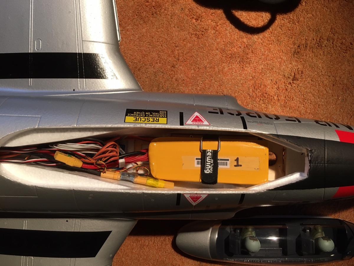

                        • Received my USA T33 today.
                          Easy build, and I had to remove dead weight in nose, mine is 68 grams.
                          I have 6S5000-50C Rhino LIPO, weight is 900 gram.
                          Had to move blue box, I checked soldering and I thought one ore 2 where not good, so I re soldered board just to be save, will see?
                          Also I checked main LG pulled on it and it seems to be tight! Hoop so?
                          grts Hans Click image for larger version  Name:	IMG_4873.JPG Views:	0 Size:	145.5 KB ID:	259361
                          ps I contacted MotionRC EU about bluebox and landing gear glue issues, answer is
                          We are in constant contact with the Freewing factory to make them aware of any quality issues that are highlighted by our customers, including the ones you mentioned. Freewing have assured us that any problems mentioned have been investigated and corrected.

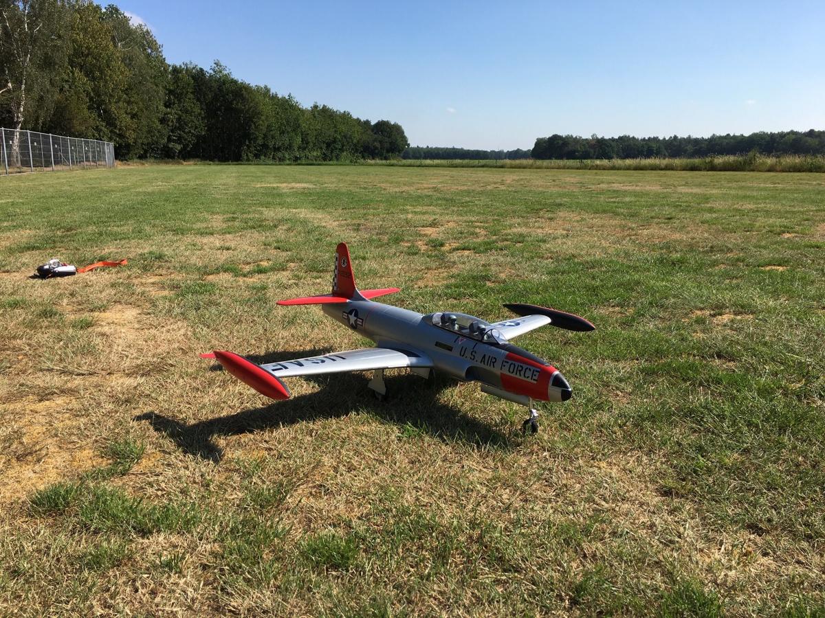

                            this morning flew my new T33, well nothing strange to report.
                            Flew right out of the box, no trimming.
                            Fly form grass field and moved CG 10-15mm back, no problem rotating from grass.
                            Was a bit windy and due to CG a bit more aft plane was sensitive to gusty wind condition.(gyro will be helpful)
                            Normally I fly my planes in windy condition CG more forward, but for this plane no option rotating from grass during take off.
                            Also one advantage is when CG is more aft amp draw is less, I did read 30Amps at half throttle.

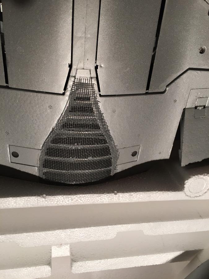

                            Because I fly from grass I use protection on my cheater air intake to prevent dirt damage.
                            grts Hans

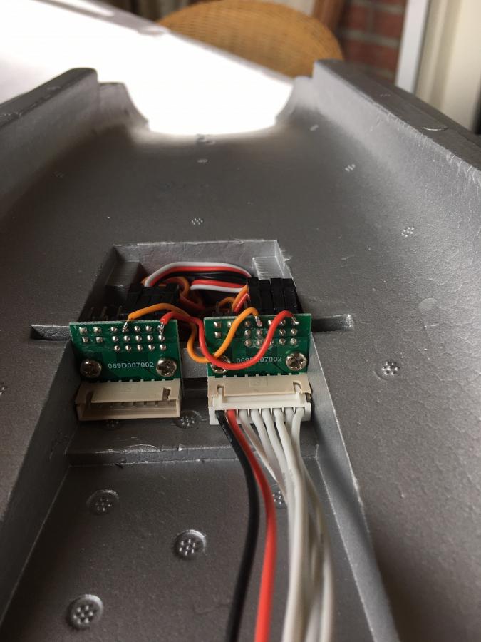

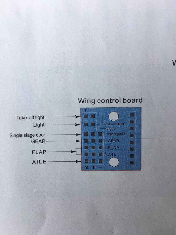

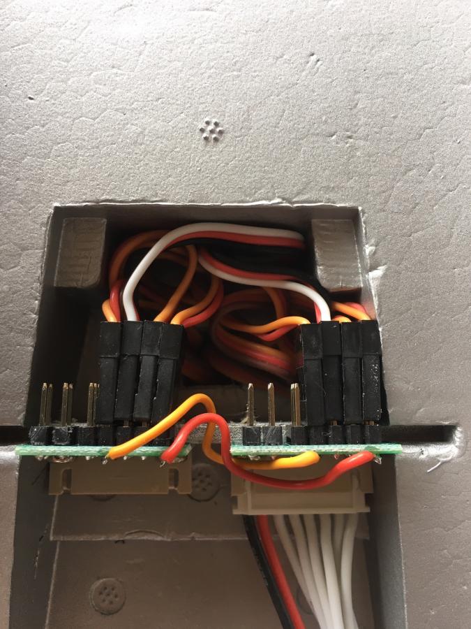

                              • Modification to wiring to wing.
                                I have to remove wing in order to transport my plane to the field.
                                Those 2 wires are to much , there must be a way to eliminate one.
                                Easy fix, flap has 2 point on circuit board, so I took a servo female to female cable and connect one board to the other for flap.
                                And solder jumper from one board to the other for aileron and gear.
                                Plus and Minus are fed through cable from flap to flap.
                                Also I use the box from shipping for transport to the field.
                                Tested and is working great.
                                Click image for larger version  Name:	IMG_4886.JPG Views:	0 Size:	64.5 KB ID:	259803Click image for larger version  Name:	IMG_4888.JPG Views:	0 Size:	219.7 KB ID:	259804Click image for larger version  Name:	IMG_4887.JPG Views:	0 Size:	96.5 KB ID:	259801 I Click image for larger version

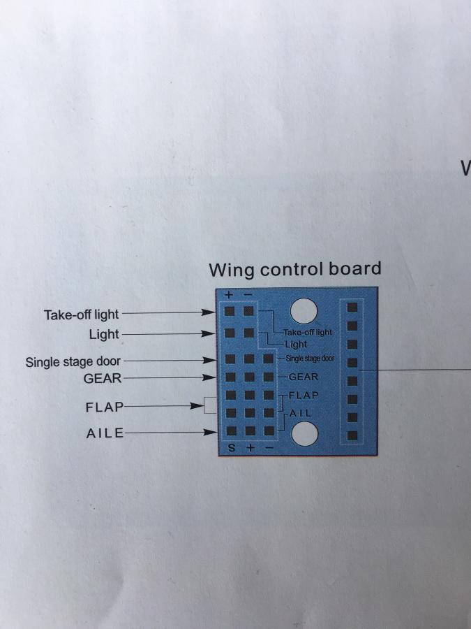

                                      • Well I found in manual on page 2 I think this
                                        Click image for larger version  Name:	t33 scale led lights.jpg Views:	0 Size:	97.9 KB ID:	260005
                                        and here is written....Scale LED lights....well I can find them ha ha....
                                        and where is LIPO........
                                        So freewing, and MotionRC, you can send them to me so I can install them????
                                        grts Hans
