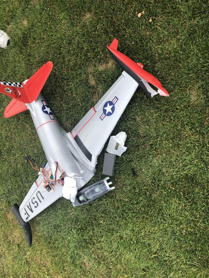

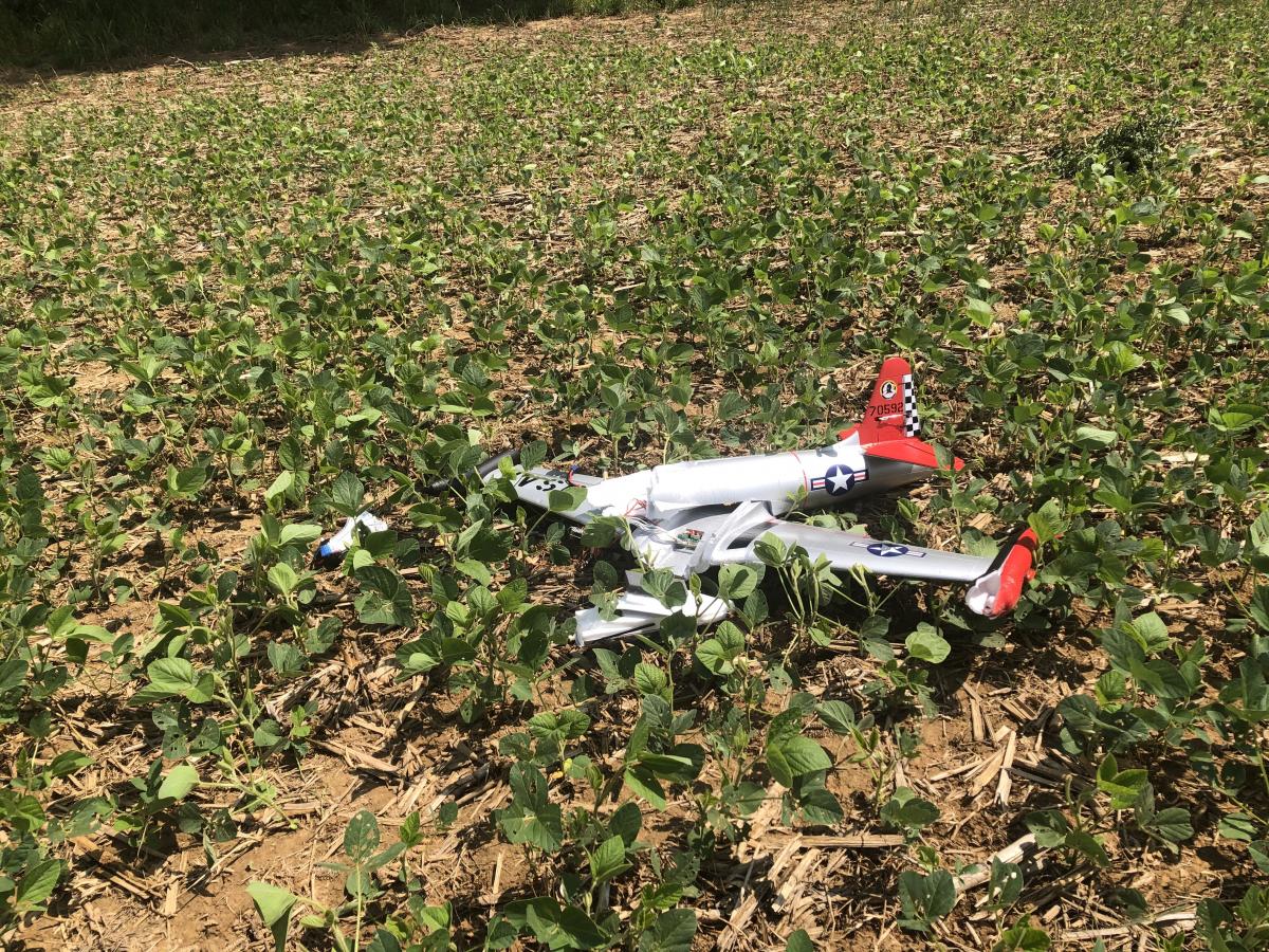

                Well..... I loved my T-33 and so did all the guys at the field but she was lost last week :( After 10 great flights I lost everything and that was it. No issues prior, but for some reason I lost all control. After picking up the wreckage and bringing it home I could not get it to bind to three different receivers. The ESC and EDF were untouched from the crash. I could of sold a hundred of those little jets at my field before that happened lol. I guess I’ll stick with my turbines but she was fun while it lasted.
                  • 8825

                    I’m sorry Warpug, just lost mine the exact same way a couple days ago. 2nd flight, I loved it. I’ll be getting another one, I loved it so much. Which type of rx were you using?

                      Yes, it’s a great flying jet. The RXs I tried after the crash are fine. It’s not the receivers I was using for testing. I might consider another one but at $400 a pop it’s a little hard to swallow.
