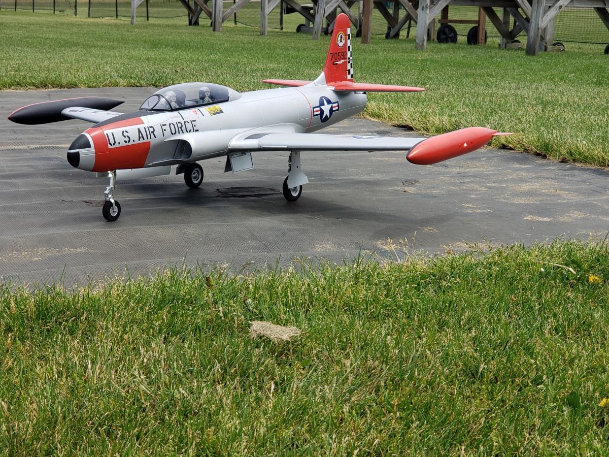

        I flew my new T-33 four flights today with great success. I had made some very minor mods to help the plane get off the ground better....shortened the main gear struts about 3mm and changed to a smaller diameter main gear wheel. Only other mod was removing the nose weight. I started with the flight timer set to 4:00 and the 6000mah battery was at 50% after landing. I increased the flight time each flight and finally landed with the batt at 30% after 6:40 of throttle operation. No issues with the blue box or anything else. CG is on the tape just in front of the main gear doors; a little aft of what the manual calls for. The 850g battery is pushed all the way forward as far as possible....seems perfect.
        The plane flys as well as everyone says it does! Fast, rolls on a string, big impressive vertical maneuvers, etc. Take off from grass was so easy....30 degrees of flap and off in ~150 feet of roll. Landings were baby bottom smooth...just lowered flaps to 45 degrees and kept the nose flat until touchdown.

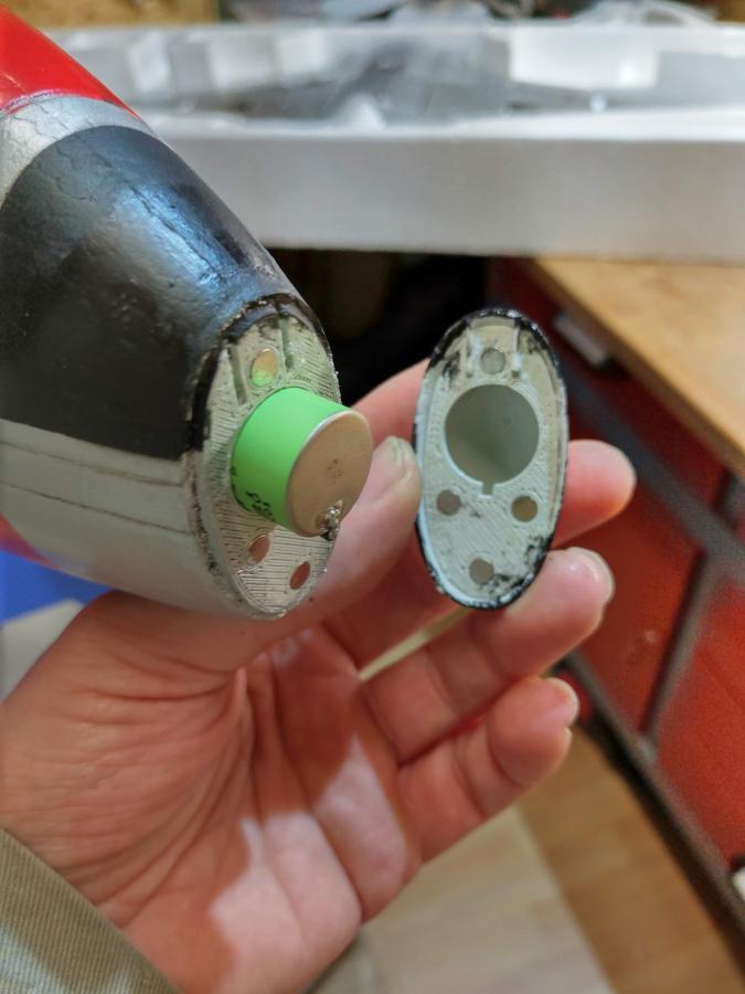

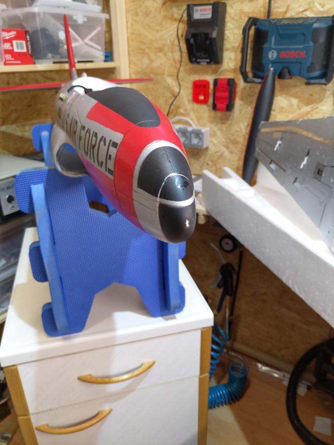

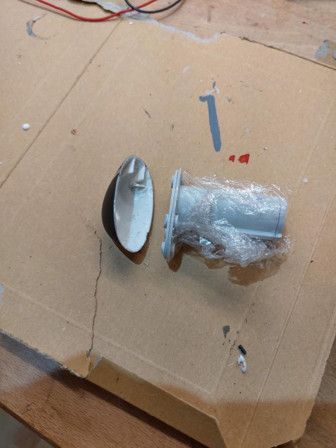

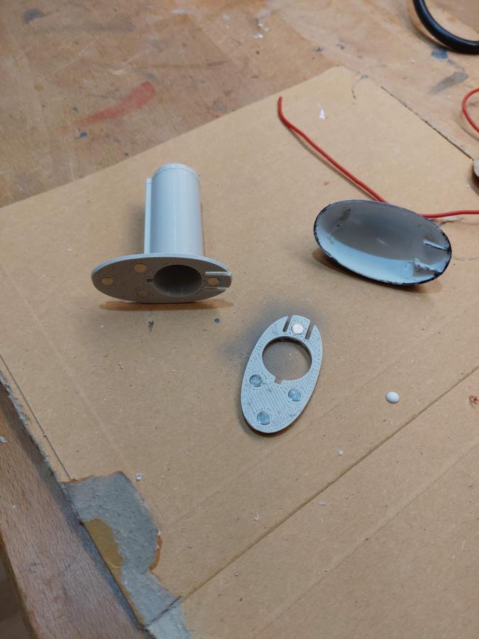

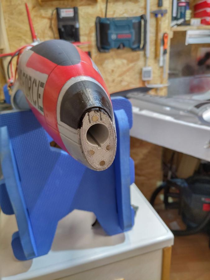

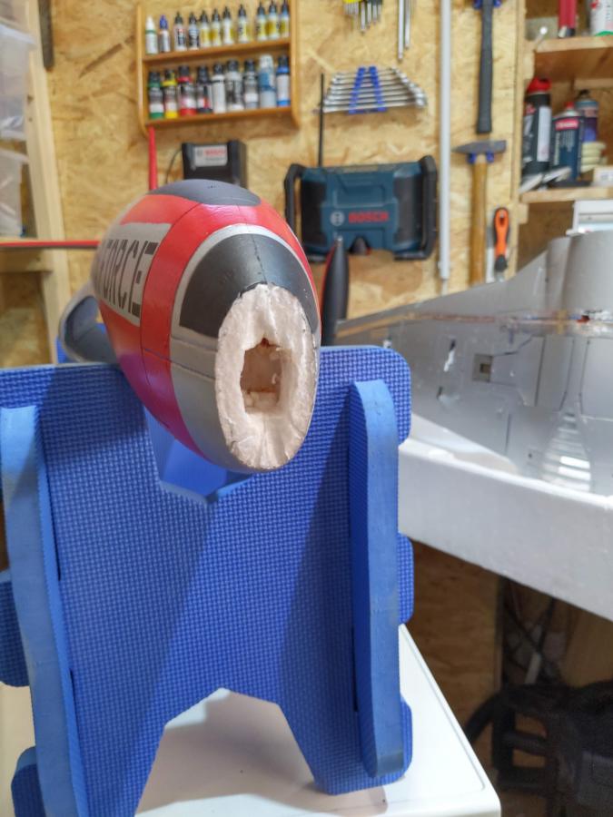

                            Hello, this is how I used the saved weight.
                            Since I use the Optotronix Aurora LCU EVO2 LED control system for my lighting, I took the opportunity to replace the weights in the nose of the Freewing T-33 with a LiIo battery. For this I have created the possibility of replacing the battery and changing it from the front. The nose holds magnetically and you need eight magnets with 5 x 2 mm.
                            The files for the 3DPUP can be found here https://cults3d.com/en/3d-model/game...0-battery-slot

                              Nice work, but you still have the problem of too much weight in the nose of the plane! A small LiFe battery slipped in behind the flight battery would be so much better.

                                Hello, with my used RED Power 6S 5500 25C, which has 672gr, I unfortunately still need the weight in my nose.
