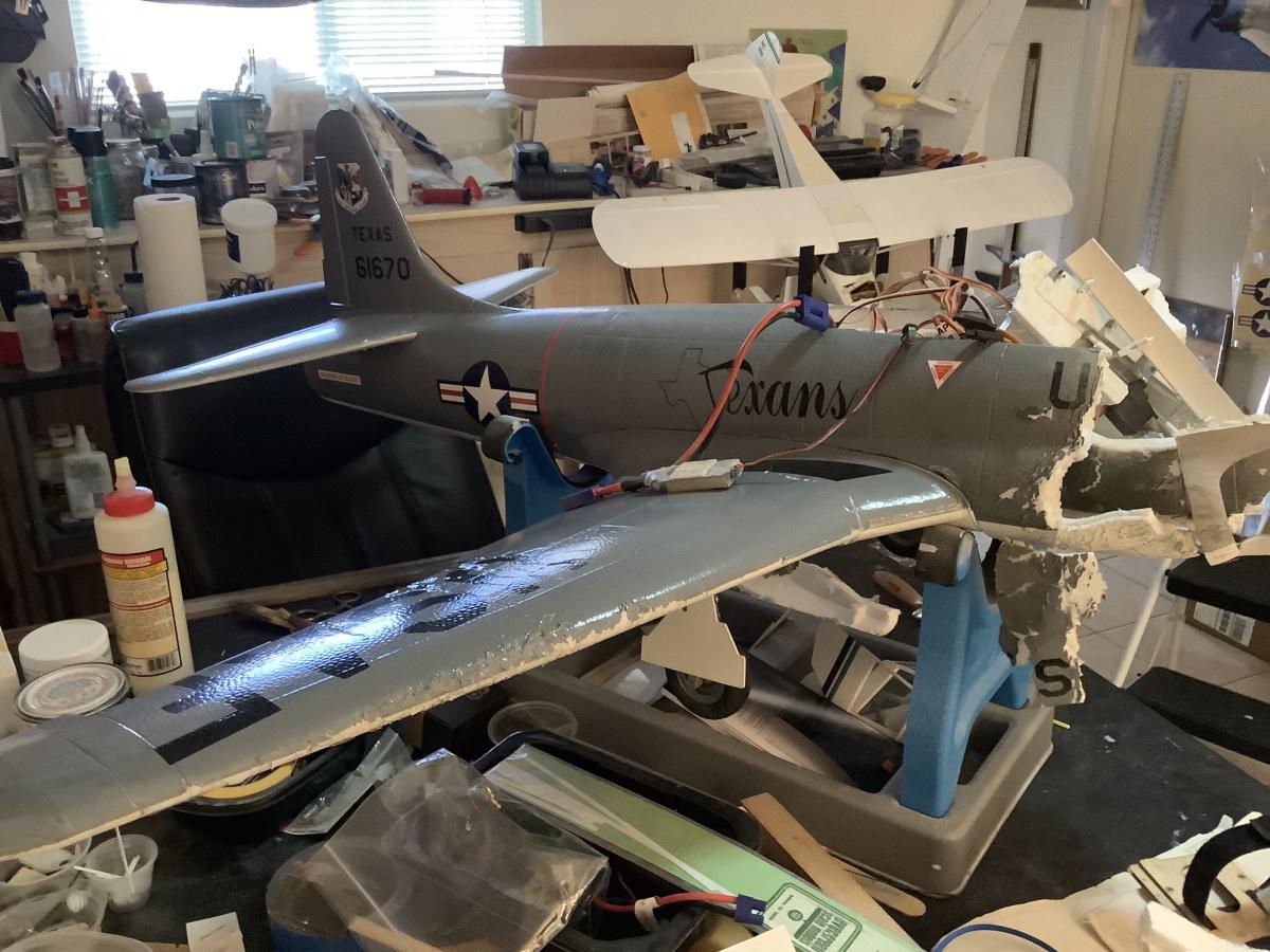

      #1522
      Same. I have the 64mm Lippisch and MiG-15 and can't kill the darn things!
      My experience with these 80mm 6S size EDFs has been nothing but a disaster. I'm continuing to wonder what in the world is going wrong...
        • 8825
        #1523
        Earlier in this thread and all along the way in the thread, there's been talk about issues with the "blue boxes" (control boards) using ground paths that come from many different components. On some of the boxes, some ground paths (circuits) are very close to another ground paths and coupled with sloppy soldering, a ground for one component can jump to an adjacent circuit. Some people have had failures that can be presumed to be linked to this phenomenon. Those who are concerned about it have removed critical components such as AIL and ELE and even retracts from the blue box and wired them directly to the RX. It has been said that removing the retracts from the box may not be a good idea since powered components such as lights take their feed from the retracts.
        I've had two of these T-33s. First one on maiden took off and immediately inverted and crashed. I fixed it and sold it. Second did the same thing but I was somewhat prepared for it so when it inverted, I cut all power and didn't touch any of the sticks and just let it come down (fairly gently on its back). Fixed the minor damage and removed the AIL and ELE from the box and hooked up directly to the RX. It has flown many, many times since without incident.
        So in retrospect, no, I doubt very much yours had anything to with a faulty ESC or BEC. (Did you even check them afterwards to see if they still functioned properly?) It's more like they had poorly made blue boxes. Many owners of certain Freewing planes (jets in particular) immediately remove critical control surfaces from the blue boxes even before the first flight.
        I refrained from responding when you made that statement about not wanting to hear any "schtick". At the time, that indicated to me that you only wanted to hear what might conform to your ideas of what should be wrong. However, in truth, these cross contaminating ground paths in the blue boxes are few (although significant) and the vast majority of owners have never had such problems, BUT THEN, you didn't want to hear that did you?
        • RobWetterholtJr
          • Jan 2022
          • 23

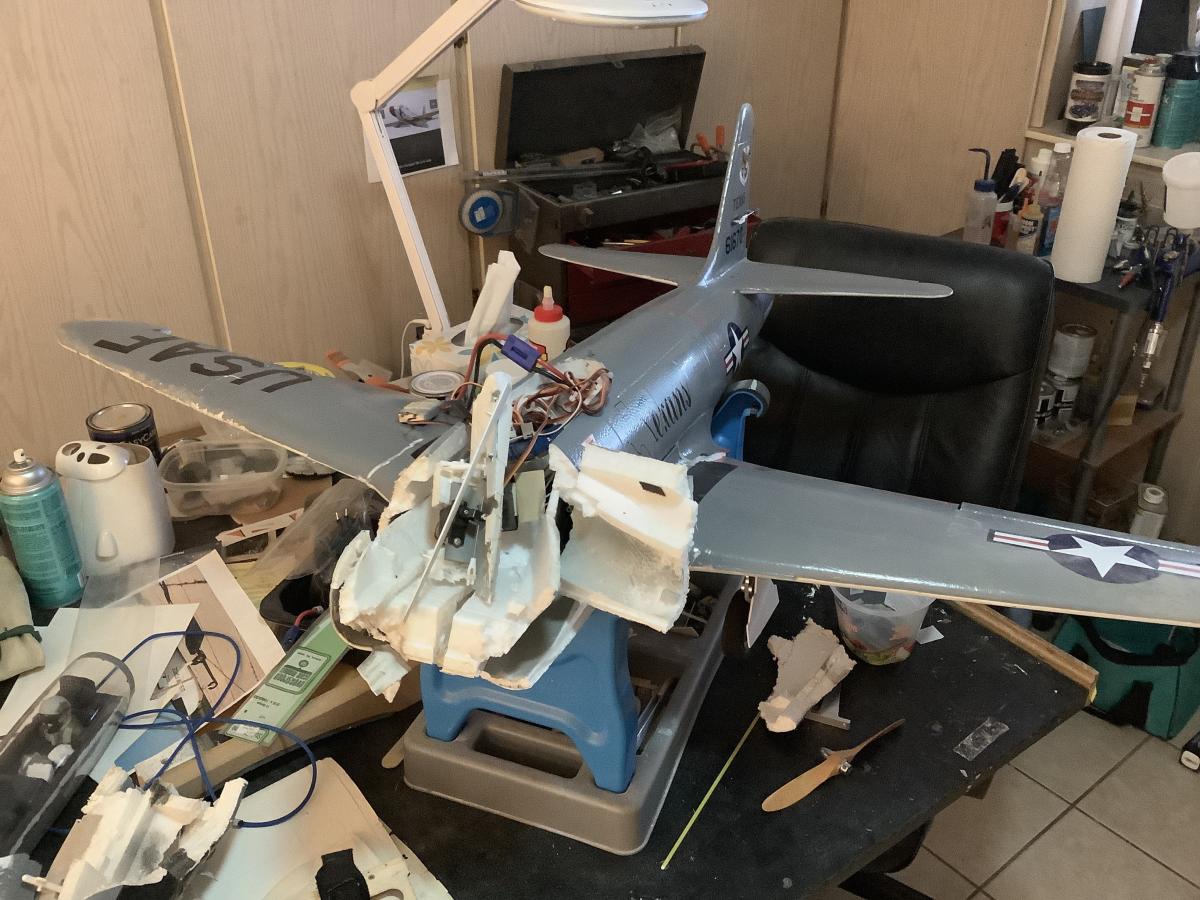

          #1524
          xviper,
          Before you throw any more shade my way about whatever box you think I'm trying to put these crashes in, I'll let you know I removed the blue box in both of my T-33s and routed everything to the receiver directly as follows:
          Channel 1: Ailerons (both servos Y-harnessed)
          Channel 2: Elevator servo #1
          Channel 3: Throttle
          Channel 4: Rudder
          Channel 5: Flaps (both servos Y-harnessed)
          Channel 6: Gear (all three retracts triple-harnessed)
          Channel 7: Nose gear Steering servo
          Channel 8: Elevator servo #2
          So where do we go from here?
          As far as your comment about "did I even test them afterward"...yes. Everything checked out 4.0 on deck post crash.
          I did notice a weaker than normal left aileron servo in my second A-4 post-crash during a bench test and so in both T-33s I used brand-new HiTec HS-65HBs. All servos exhibitied normal characteristics post-crash.

              #1526
              xviper,
              If my frustration wasn't readily apparent from the get-go I don't know what to tell you. Furthermore, your lecture about how me only wanting to hear what conformed to my ideas was akin to rubbing salt in an open wound, I did not appreciate that.
              I provided what info I thought would be relevant and provided info after reading your response in hopes that that would hopefully shed light on what's going on...only to get another response about how releasing bits and pieces of info can only lead to more guessing.
              I guess if that's where we're at here with problem-solving the gremlins that run around in these EDFs from time to time then stepping away from this segment of the hobby might be the right thing for me to do.
              I am still bummed.

                  #1528
                  HangarQueen,
                  Thanks for the response.
                  I know the BlueBoxes have come under scrutiny in different FreeWing aircraft threads and so I decided to bypass it in both my T-33s. I've read numerous reports of people having no problems either way.
                  Of particular interest is the fact that the BlueBoxes don't seem to serve to reduce voltage (the voltage reduction down to 5.5 Volts occurs in the ESC/BEC unit) but instead acts as a sort of fancy Y-harness so these models can be flown on a six-channel radio, if desired. With that in mind I decided to go straight in to the receiver and not risk faulty trace lines...and in more than 20 years of flying I've never done anything but wire everything directly in to the receiver, with no problems.
                  I'm confident the servos, receiver, transmitter and battery were not the cause here. The transmitter was declared fully functional by Futaba. The battery, receiver and servos were brand-spankin' new. In post-crash analysis on the batteries I haven't been able to produce any sort of cell imbalance after putting them through charge/discharge cycles.
                  Color me STUMPED!
                  The only thing that remains suspect to me would be the ESC/BEC unit. I don't know how to test these units on the bench and since I don't run telemetry receivers I'm not well-versed enough on how to detect any sort of irregular operation.
