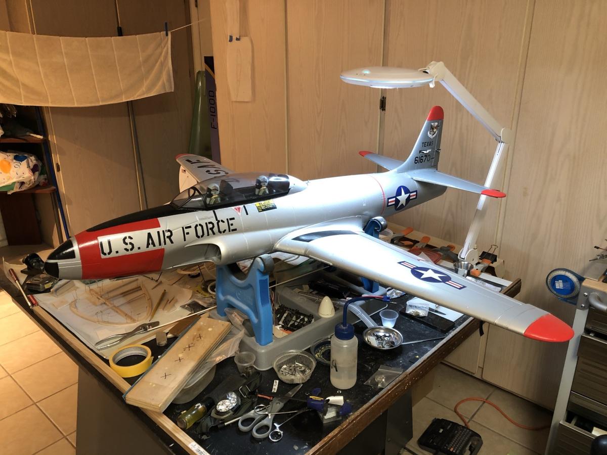

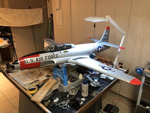

                    Flew the P-80 wings on the Shooting Star for the Jet Jam in Phoenix this weekend. Always a few inquiries as to who makes the P-80?

                      Flew the P-80 wings on the Shooting Star for the Jet Jam in Phoenix this weekend..
                      F22, she's gorgeous. Best, LB
                      thanks LB. Always a good day hearing from you!
