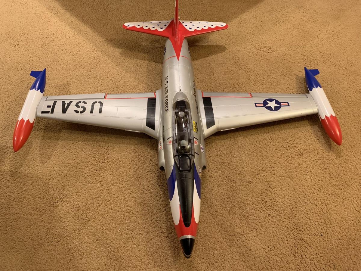

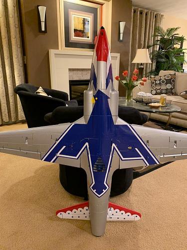

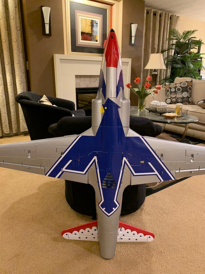

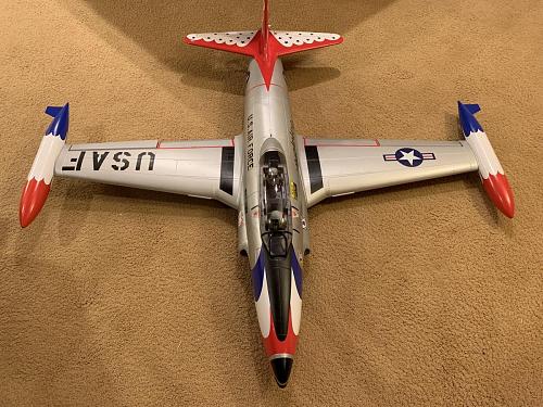

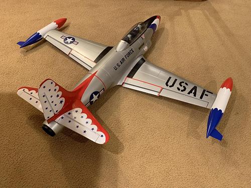

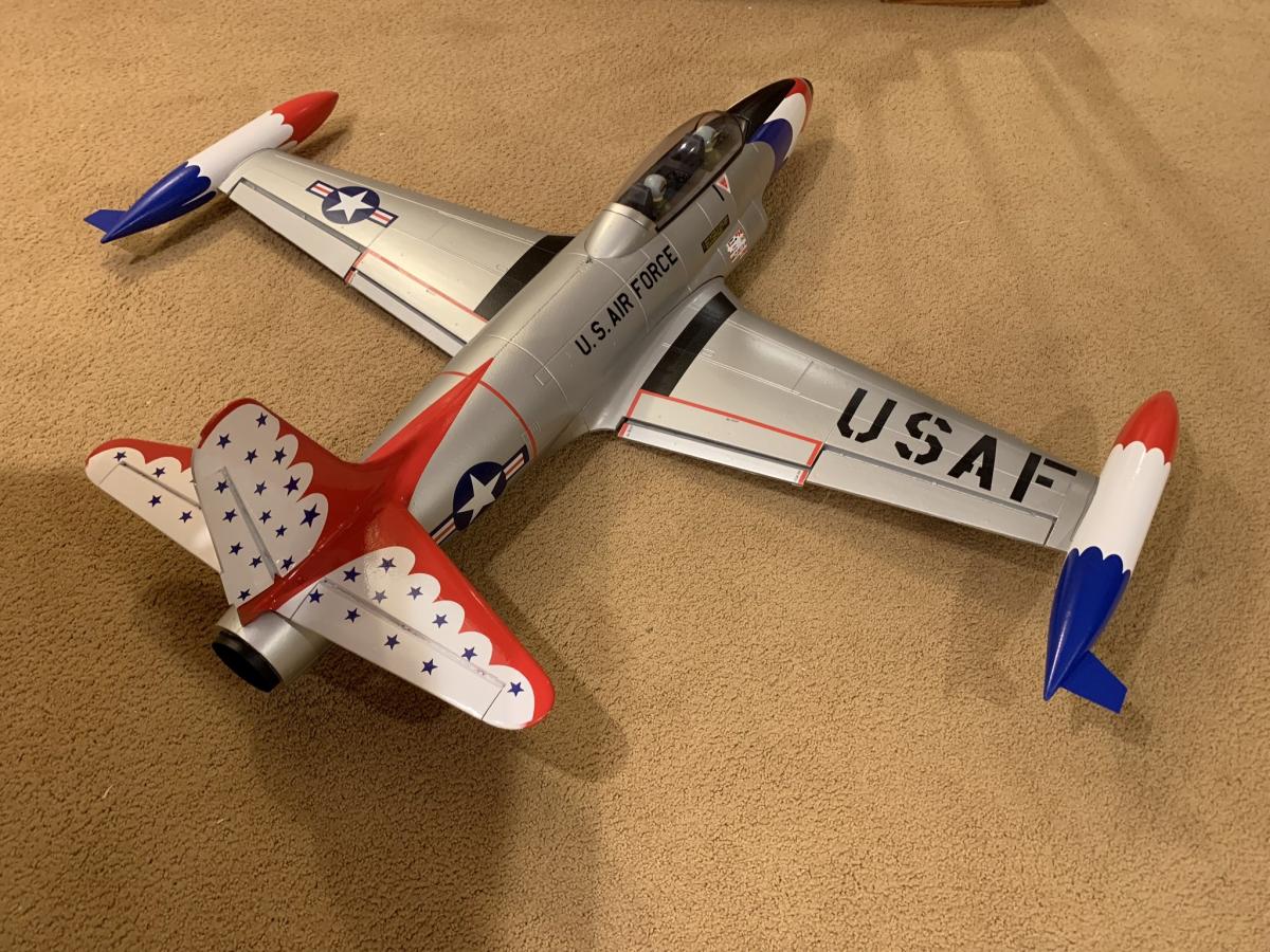

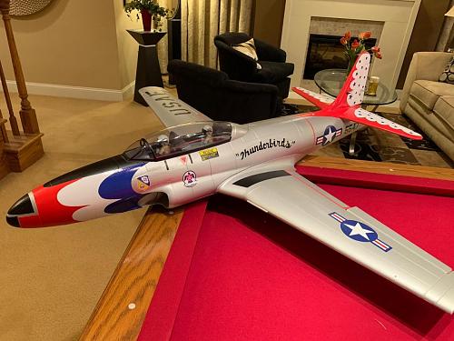

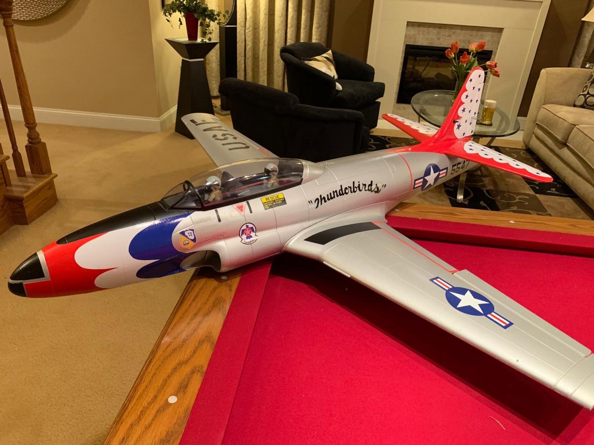

ID:	232159 Not very original, and the Thunderbirds scheme has been used everywhere, but I still felt compelled to do it.
      Don
      Wow! Amazingly done! How did you get the curves on the nose/tip tanks? Did you mask them? or just draw with a paint pen and fill in the rest with an airbrush?

        For the nose I made a paper template for each color and used an X-Acto knife to cut the vinyl for each of the three colors. For the tip tanks I painted the red and blue and then used white vinyl for the center with X-Acto cutting on a template for the curves.

                        The Decals were just painted over on my Thunderbird where original U. S. Air Force decal location needed to be solid silver.
                          Don
                          No apologies required whatsoever. Very few T-33 EDFs around to begin with and just not many with that color scheme. RC Lander did offer that scheme, but I have seen it in the "wild" exactly once.
                          Looks awesome and one of the best looking T-33 schemes ever.

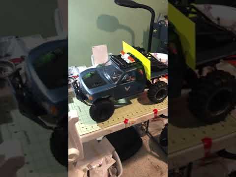

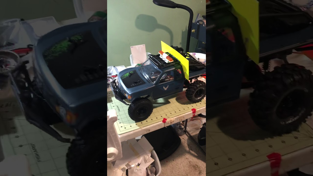

                            Speaking of the time delay on the blue box gear channel....
                            I've made a 1/10 scale Follow Me truck, using the Blue Boxes that I'd pulled from the T-33 and a couple other Freewing aircraft. The Blue Boxes control three different lights and they all have a different delay. I figure that the Follow Me truck will be a big hit at the RC Field. :-)
                            It's a short, crappy iphone video that I quickly made to show my truck to a couple friends. Anyway, I figured that some of you all may appreciate the truck.
                            In addition to using the Blue Boxes to allow me to switch lights ON/OFF, I switched the 3-channel ground receiver to a 6-channel Lemon DSM receiver so that I'd have channels available to turn lights on and off. Throttle and Turn are on the Right Stick (Elevator and Aileron, respectively).
