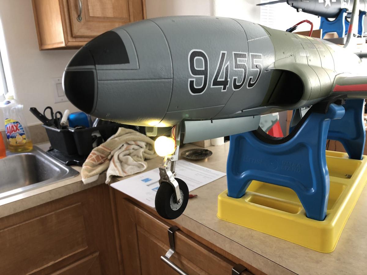

I wanted to share a quick landing light mod that takes about 10min and costs $5 to add to your T-33. All you need is 1X Freewing 5W White LED Light with 800mm Lead (SKU: E613) and some E6000 or Shoe-Goo. I trimmed off the eyelet ear, roughed up the aluminium backing with sand paper, roughed up the strut as well, and glued it to the strut. Clean, easy, and the light does not conflict when retracted. It plugs right into the MCB-E 'take-off' light port so that it is sequenced with the gear coming on when it comes down. For dusk flying this helped a lot on approach!
