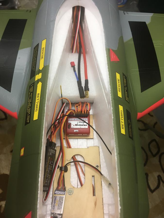

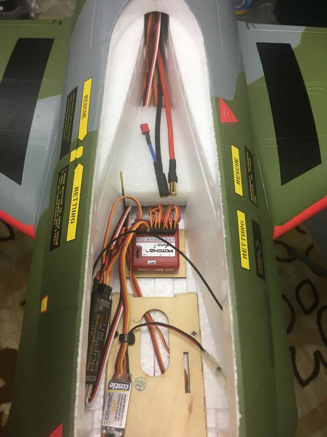

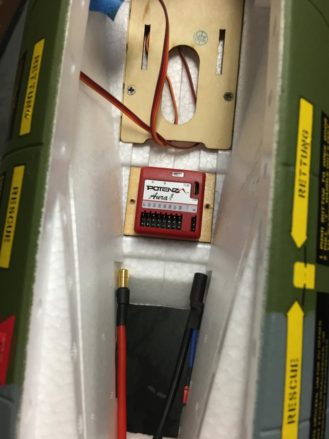

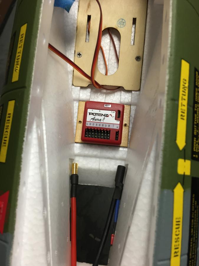

ID:	232872 I'm running a separate BEC set to 5.5 volts, so far the flaps have been perfect. I will say the nose retract is noisy when it cycles. A small drop of silicone oil eliminated the squeaky wheels.
    I also removed the Blubox and put an Aura 8 in its spot, gave me independent control of each and every servo

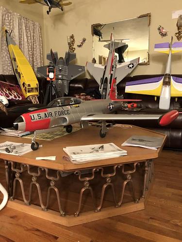

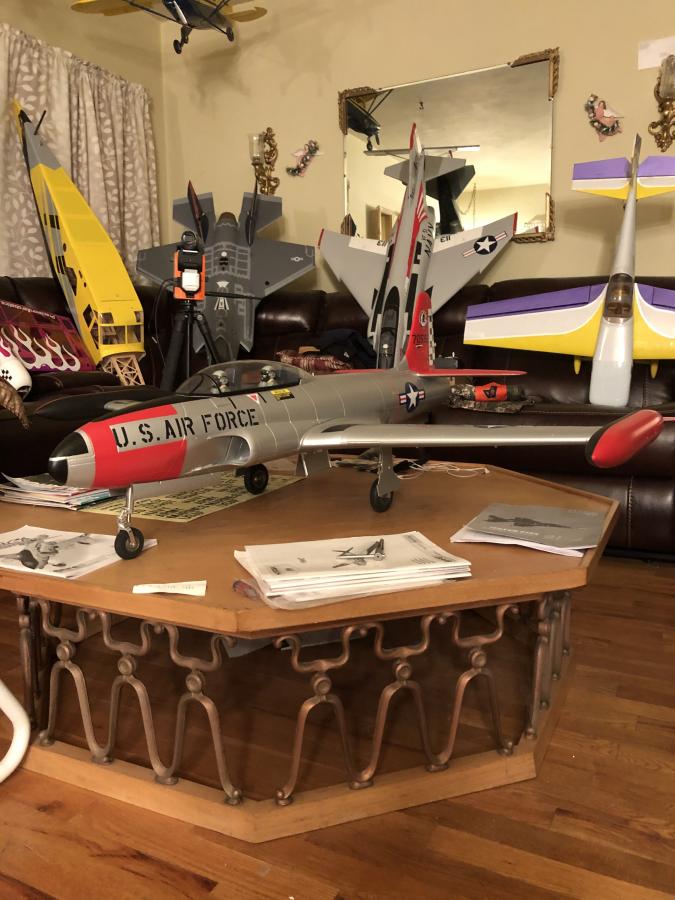

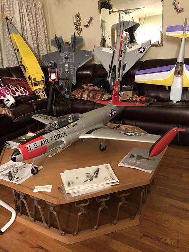

            I just can not say enough about MRC love their EDF's. Just got in 2 more. One T33, and the new AL37. I also ordered the new reverse thrust ESC's for the AL 37 I can not wait for some warmer weather here in SD so I can go fly these jets. I have the F-35 ready too. keep them coming MRC, you get two thumbs up from me. I am almost done setting up the new T-33. now all I need is some nicer weather here in SD to go fly this one and the F-35.
            Click image for larger version  Name:	T331.jpg Views:	0 Size:	90.7 KB ID:	233087Click image for larger version  Name:	T332.jpg Views:	0 Size:	86.5 KB ID:	233088
