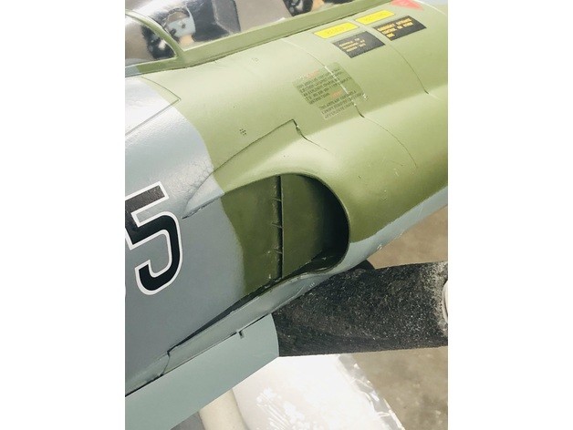

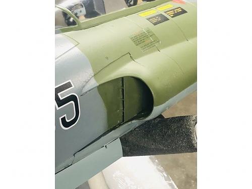

I created a 3d printed version of my T-33 intake detail. I think it looks much better than the balsa one I did originally. I put it on Thingiverse for anyone who might want it.
This is a detail part for the jet intakes on the Freewing T-33. Freewing over simplified the design in this area and this part just adds a little detail. To install you need to remove the plastic tab that is glued in this area they trim the foam under it flat. Paint the foam and the printed part and glue it in with CA. You may need to trim the part or the foam inside the inlet slightly to get it to fit with out binding. Make two, one for each side.
here is a picture on the new one installed on my German T-33. You may have to trim the sides of the printed piece to get it to fit, The foam was slightly different on each side of mine and also trim the foam shelf that the stock part sat on flush so air will flow under the printed part. even with trimming the plastic part its a tight fit so slide it in at a angle and they rotate it flat when you get it in place.

Tim, Looks stunning. Love the extra details,as always. Best, LBI created a 3d printed version of my T-33 intake detail. I think it looks much better than the balsa one I did originally. I put it on Thingiverse for anyone who might want it.
