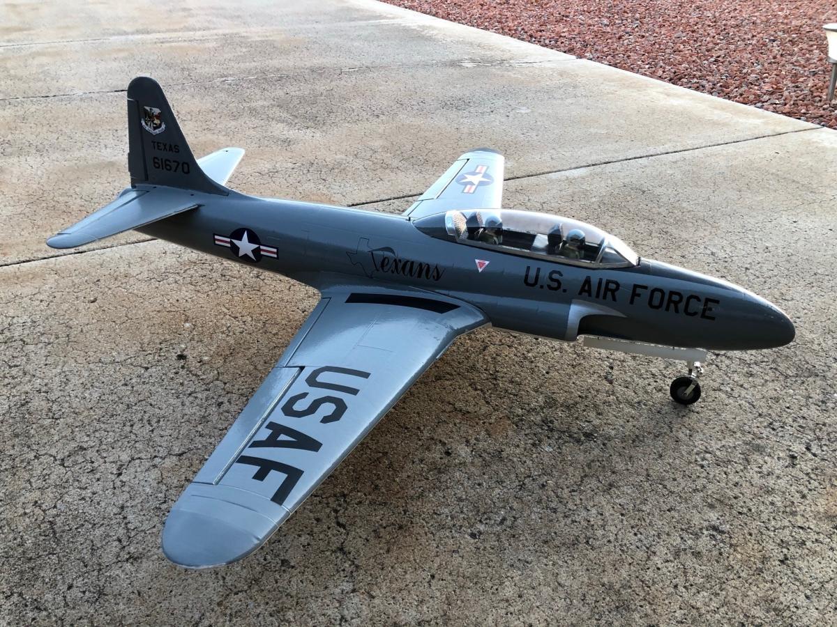

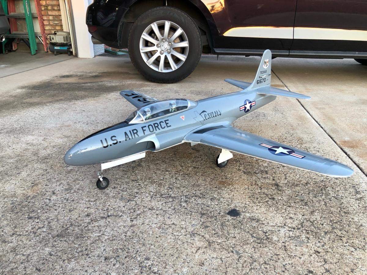

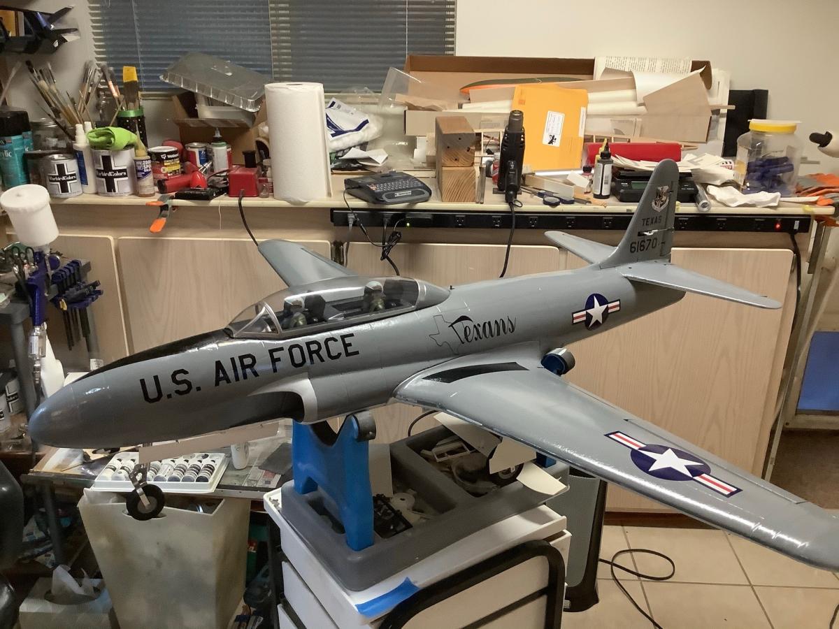

    Graphics arrived and clear is ready to go on when I get my next days off. Now to learn this new iX12.

      Excellent
        • 4812
        #1503
        F22, yes, most excellent indeed. Best, LB

          Heading to Winter Warbirds tomorrow morning. Possibly a maiden video also.
            #1505
            Look forward to some video!
              • 4812
              #1506
              Heading to Winter Warbirds tomorrow morning...
              F22, gorgeous repaint my friend. Bravo Zulu. Best, Steve
