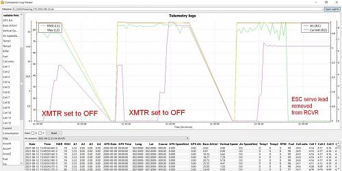

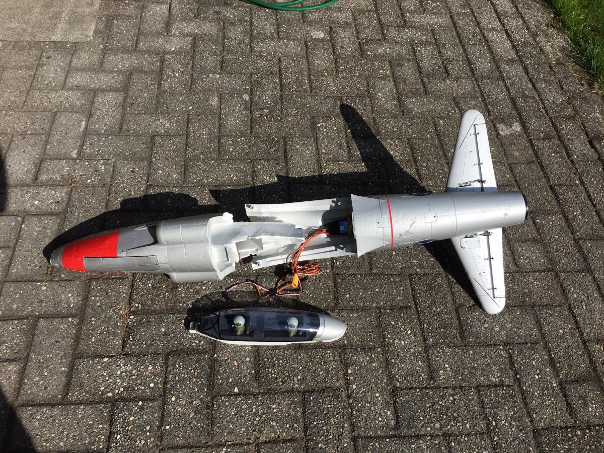

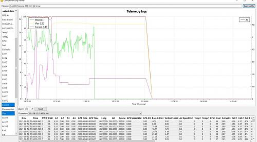

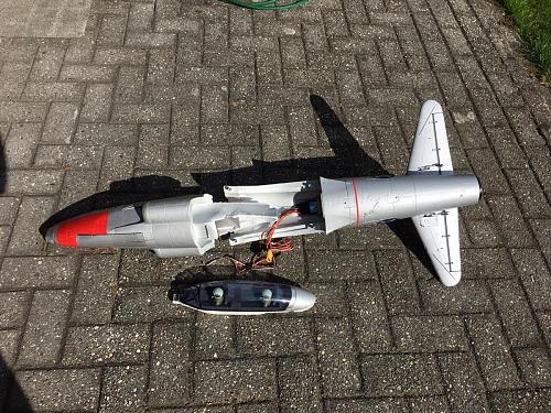

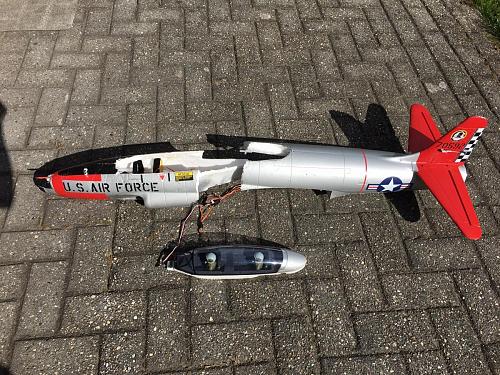

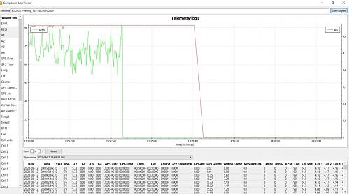

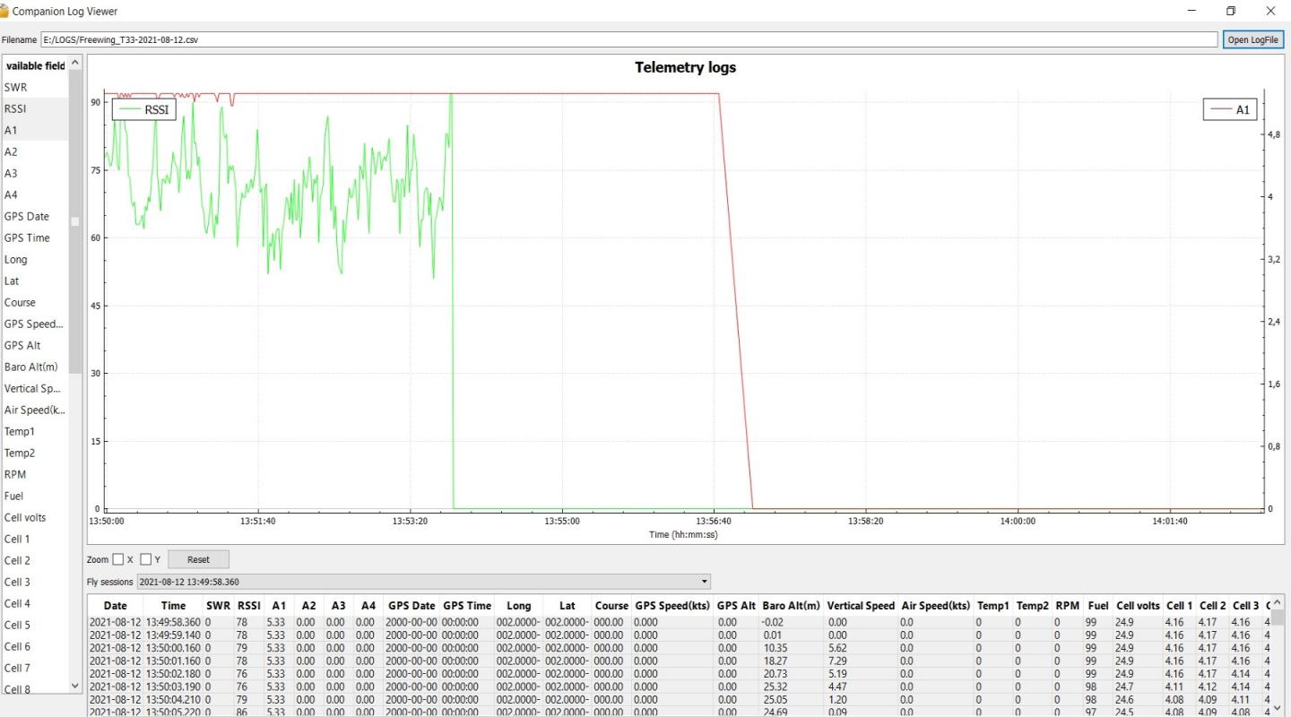

    Sadly today my plane had a crash in a tree due to no control and power in flight.
    Picture is of my telemetry data of crash.
Name:	t33 crash brown out.jpg

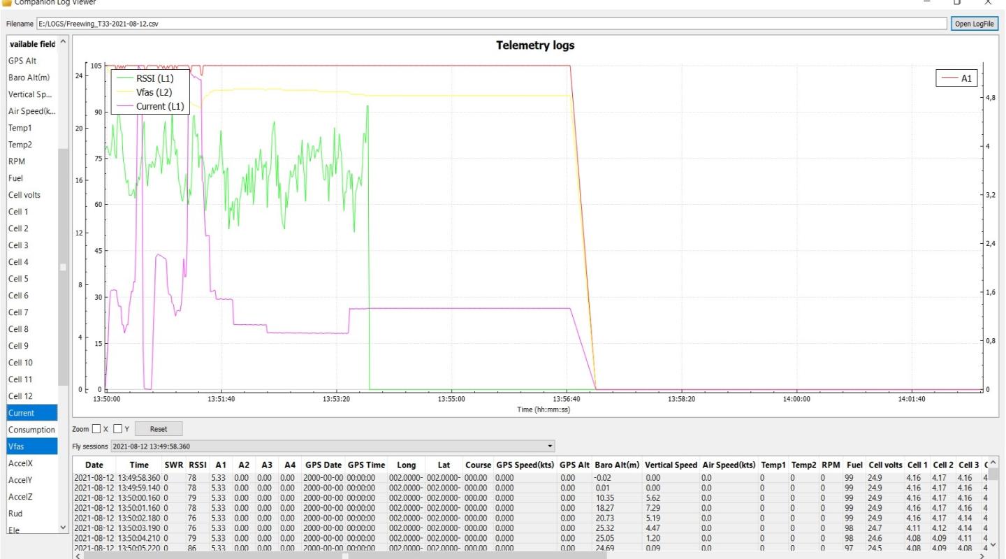

    Picture below is with current and Vfas
Name:	t33 crash brown out current and Vfas.jpg
    At home I tested ESC and RCVR and they worked.

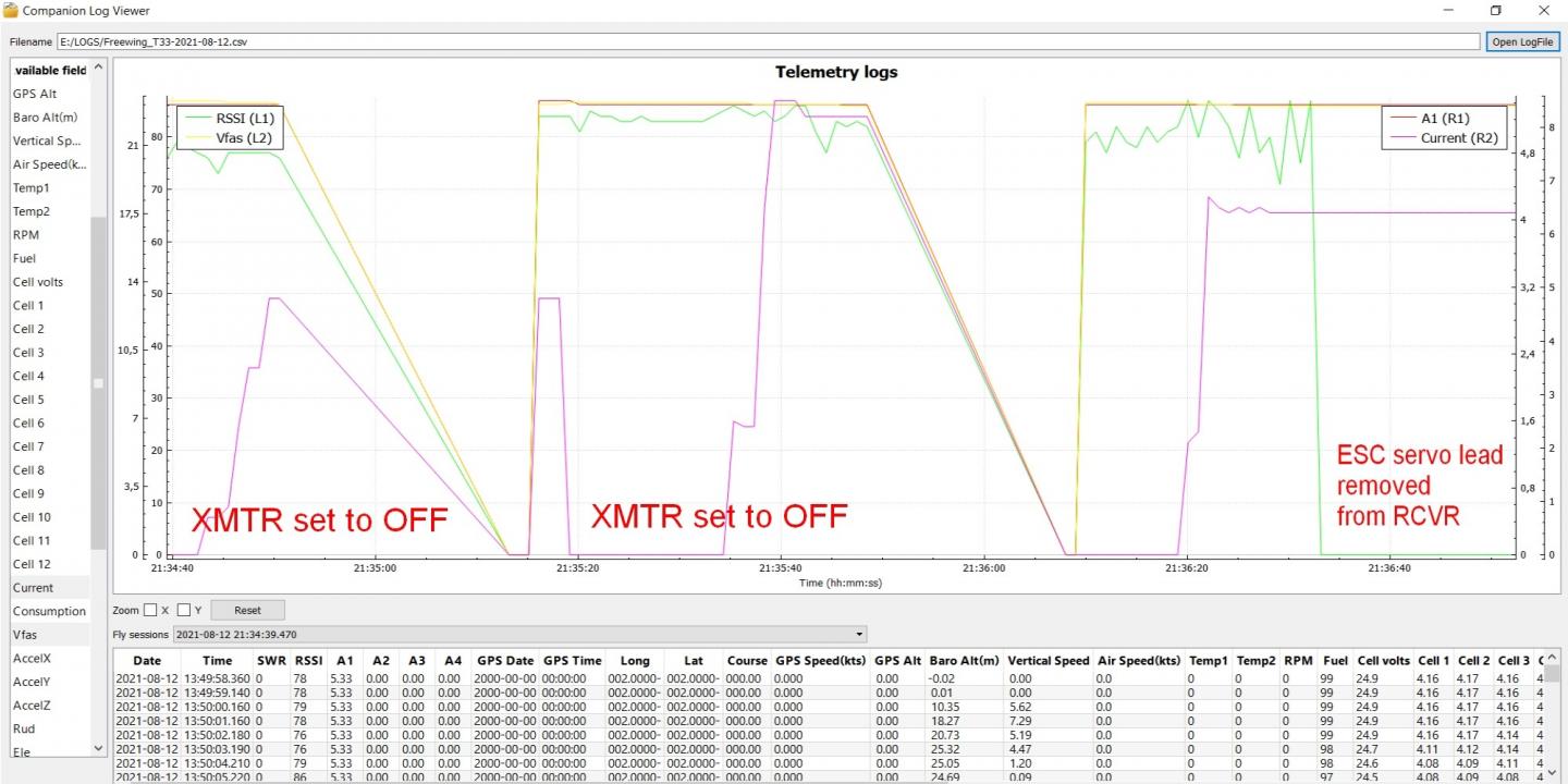

    I have to mention I have a Frsky X8r as RCVR and also I used an Hobby Eagle A3Pro Gyro in my plane.
    Picture below is my test with 2 times put my XMTR to OFF and last time I removed servo lead from RCVR to simulate no BEC power from ESC.
Name:	t33 crash xmtr to OFF and ESC servo cable out current and Fvas with text.jpg

    My findings regarding crash and seeing my telemetry data is that I lost my BEC voltage in flight.

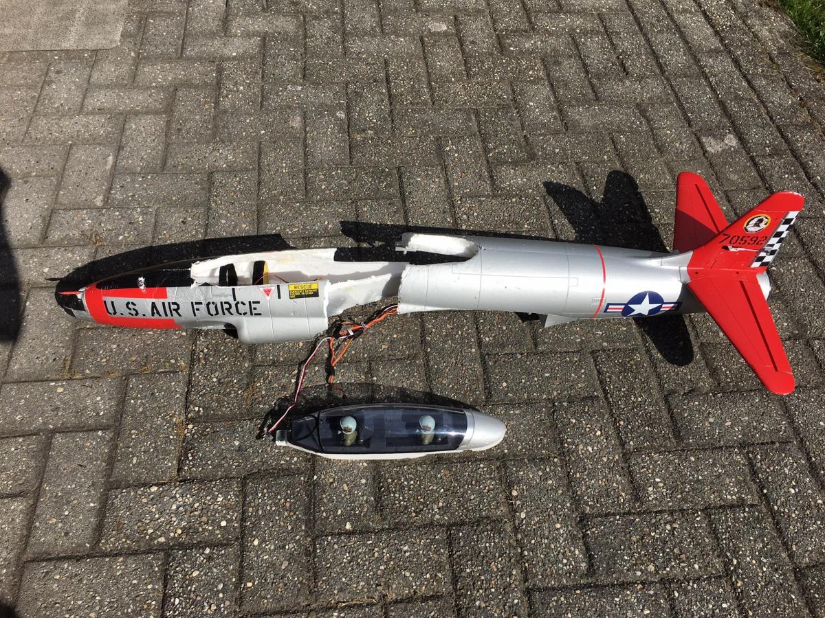

    Plane is removed from tree and it is reparable luckily, but it will have some battle scars.
    I thought that I have read somewhere issues with this gyro and loosing control.
    I have many flight with this setup but sadly today I have this mishap.

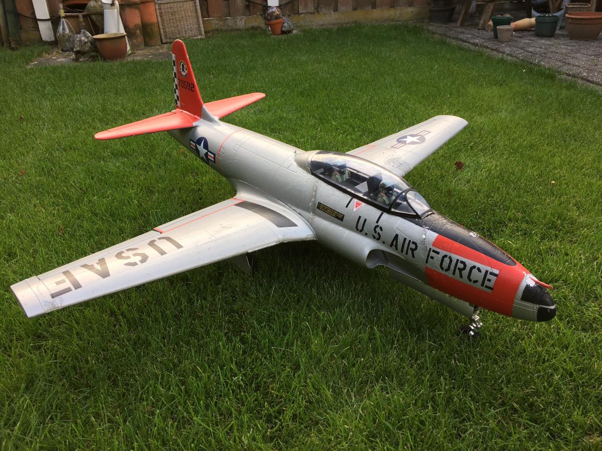

                Test Update RCVR X8R and Gyro Hobby Eagle A3Pro
                Today I flew a couple of flights with my Tundra to test X8R RVCR first, no issues, also before first flight did range test and everything was OK.
                Than I installed Gyro and flew also a couple of times, switching between auto level mode and stabilized mode, also no issues at all during my flights.

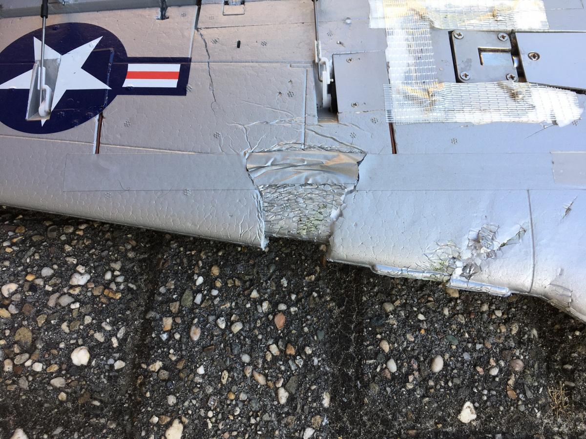

                So tonight I start repairing my T33 and it went quick, I first will fly it and after it will be fine I will start touching it up.
                I was able to test my ESC and motor at home in my garden, no problems so far.
                So next thing I will do is flying my plane but I will install a backup BEC in it , and at home check my telemetry data to see if I had an BEC voltage drop.
                Not I nice feeling to fly it again with this issue.
                Grts Hans

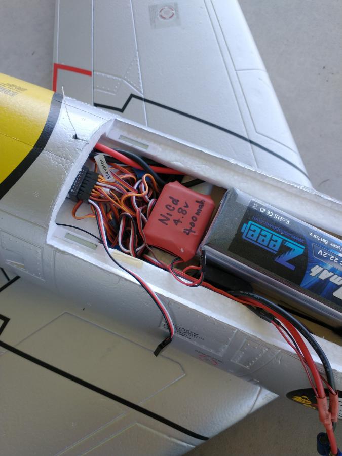

                  Hans, I do something different and I believe better. In parallel with the stock BEC I add a small 400mah 4.8v NiCd battery. As long as the BEC is putting out 5v the NiCd provides no current to the system. If the BEC fails then the NiCd battery provides power to continue the flight. I just plug the NiCd into an empty port on the Rx before each flight and unplug afterward. If no empty port is available use a Y cable to any servo. This simple system is nearly 100% foolproof.

                      • radfordc
                        • 375
                        • Lansing, KS
                        #1451
                        Looks like this

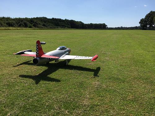

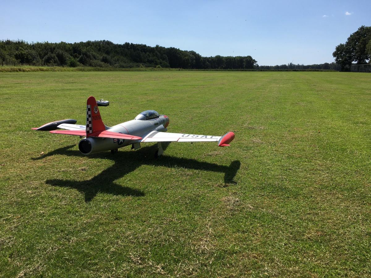

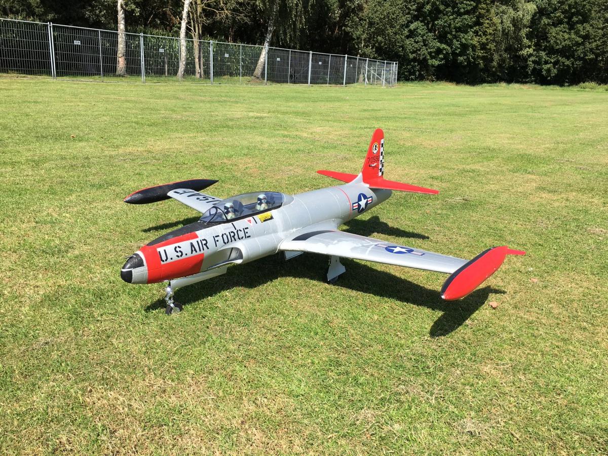

                          Flight report
                          Today flew 4 lipos with my repaired T33.
                          No issues at all, I checked my telemetry data for RCVR voltage A1 and saw no strange behavior today.
                          Plane flew as great as always.
                          My solution for the moment with a second BEC installed gives me a save feeling for the moment flying my T33.
                          Grts Hans
                          Ready for take off
                          grts Hans

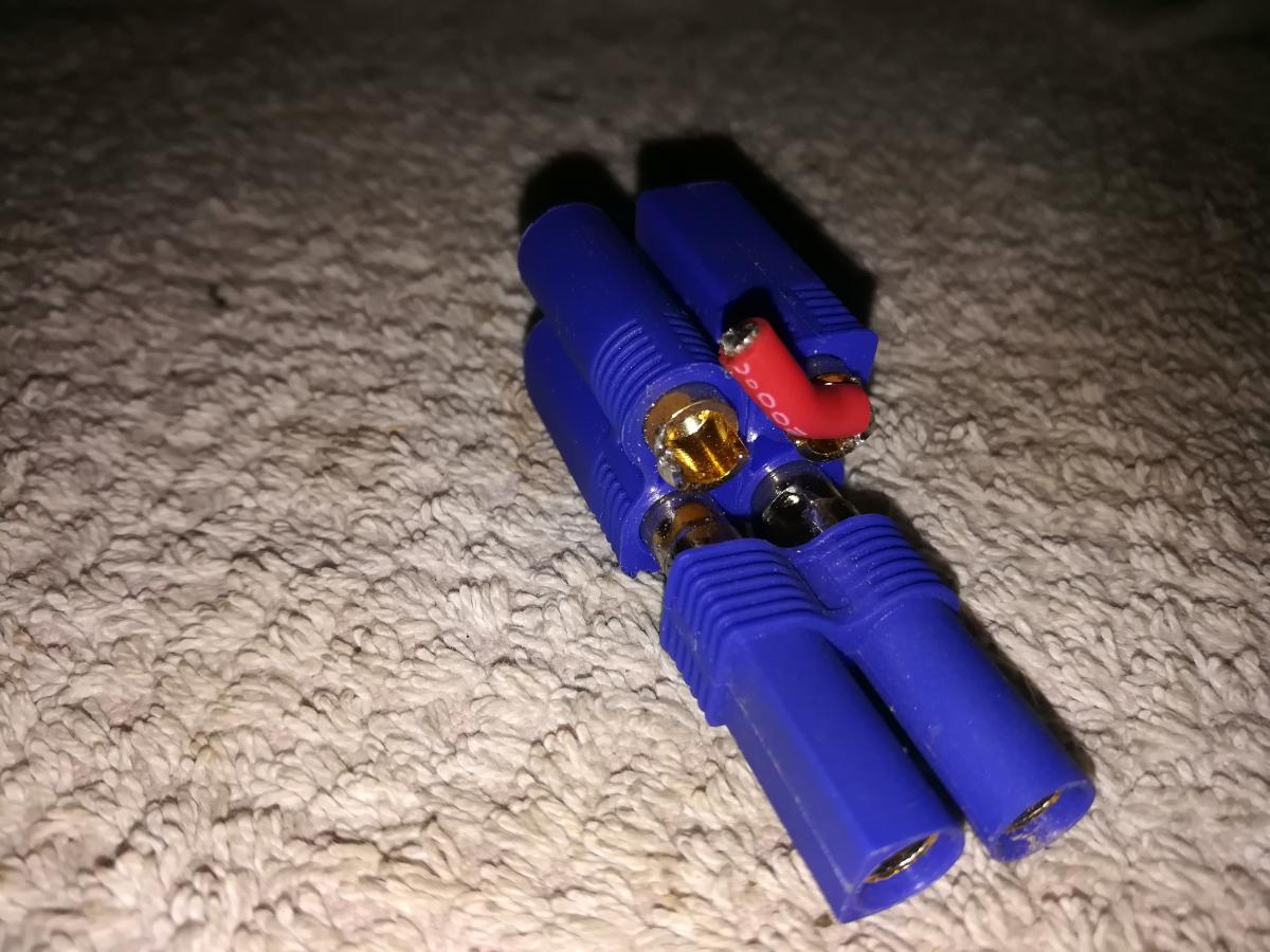

                                Update signal loss in flight with my T33
                                Yesterday evening flew again with my T33.
                                Using same LIPO as with problem flight, and again I was loosing signal.
                                In flight after a couple of minutes I want to do a low run over the landing strip and giving full power to go up.
                                Suddenly my motor went out but luckily after a second I gained control and was able to fly further motor responding again, and make a save landing.
                                On the ground I gave a couple of full power but it still worked🤥
                                Flew my other LIPO's and had no issues at all.
                                At home I inspected LIPO XT90 connector for soldering , and there I think I found my problem.
                                See quote above.
                                My solution to put another BEC in my plane connected to XT90 connector from ECS is not the solution when you have a connector problem on yours LIPO.
                                I made for now a 1S lipo 750mah with a diode in the plus line, waiting for my 400mah nicd battery packs to arrive.
                                Greetings Hans
