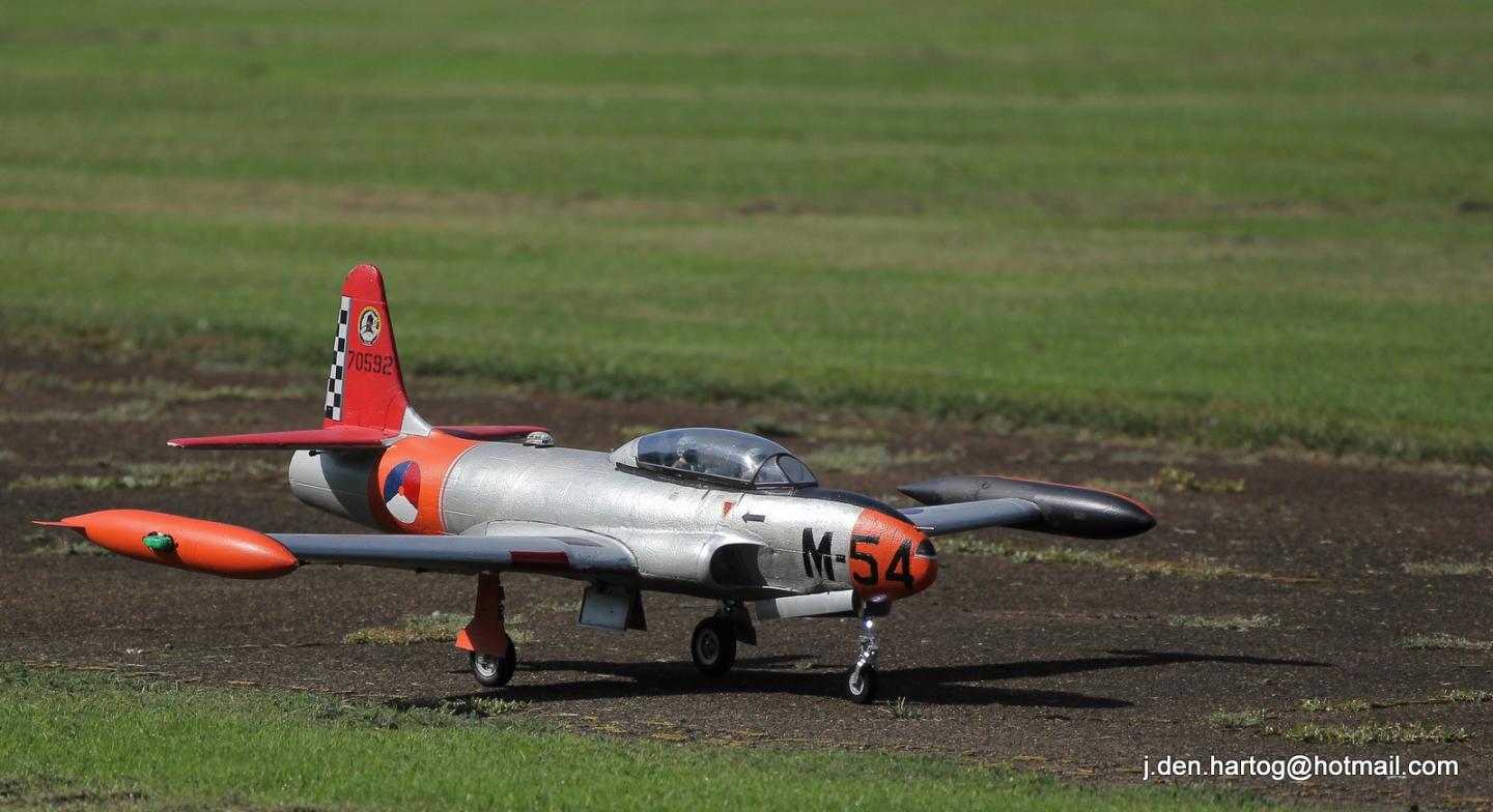

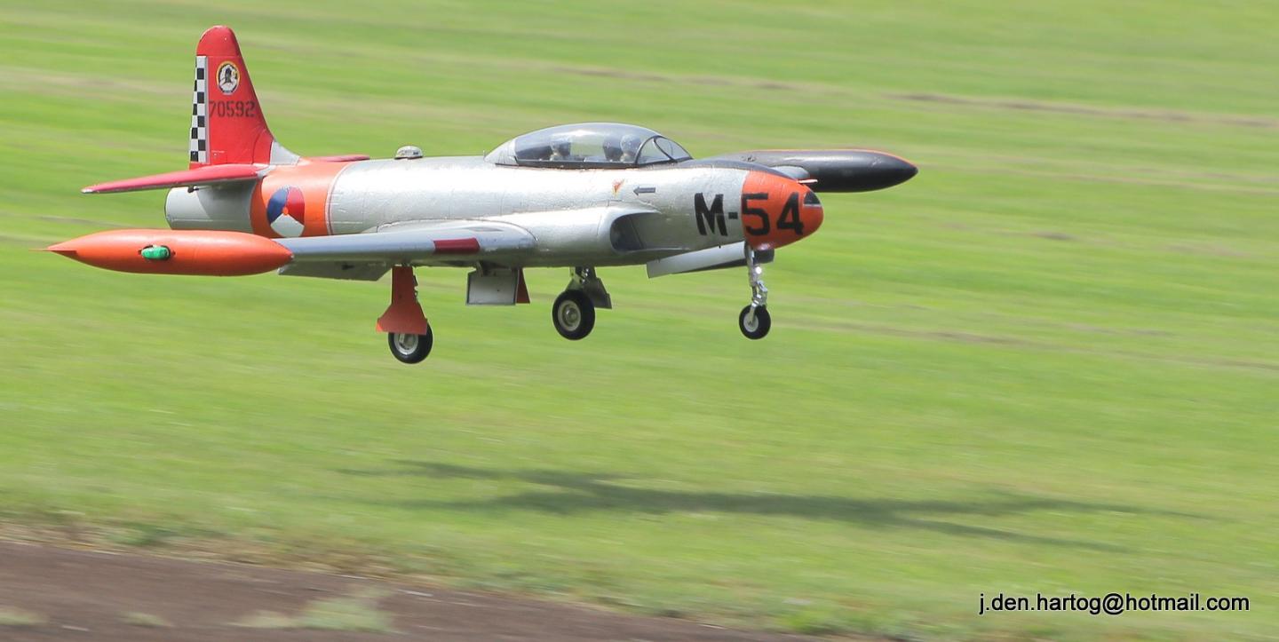

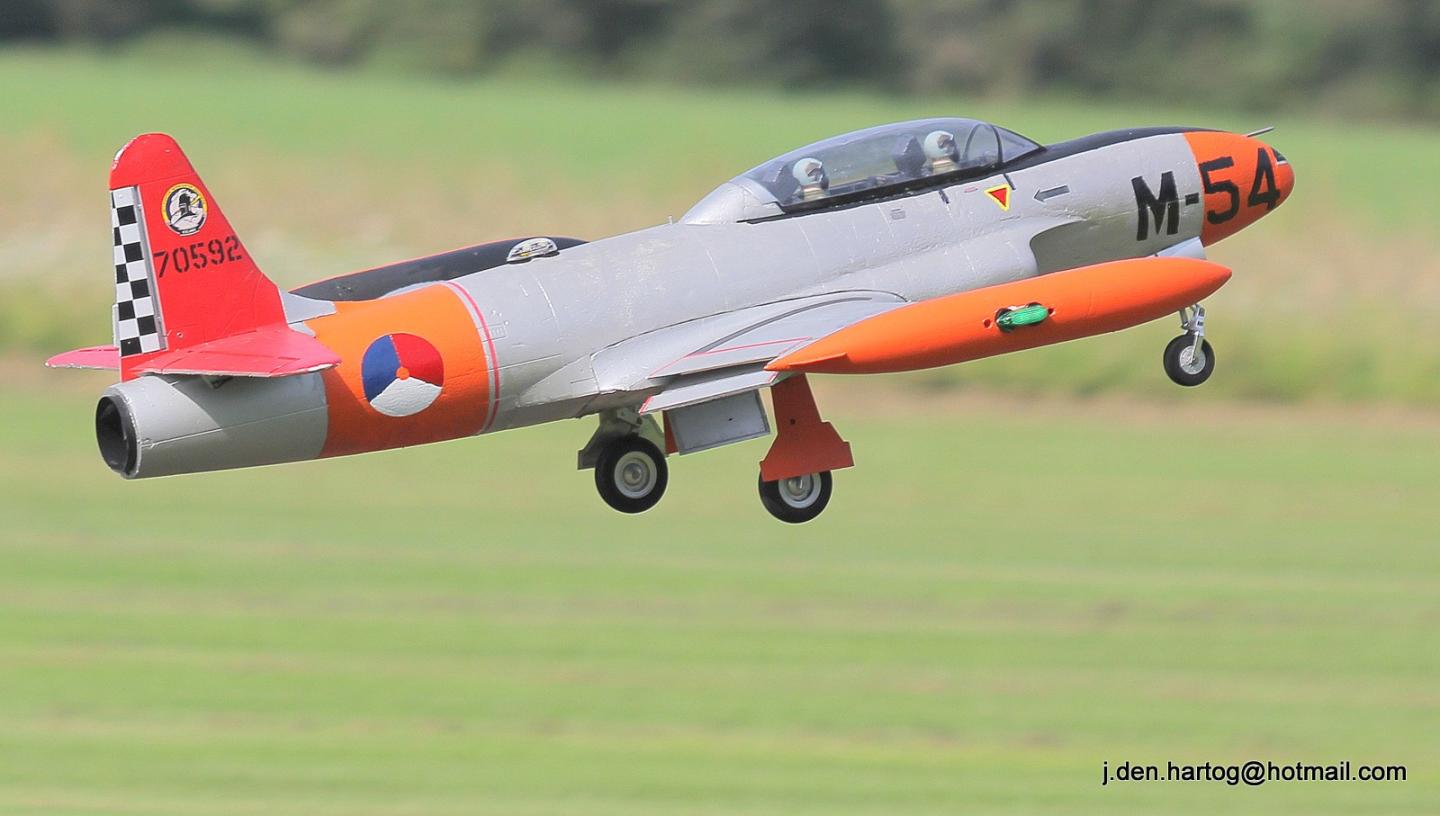

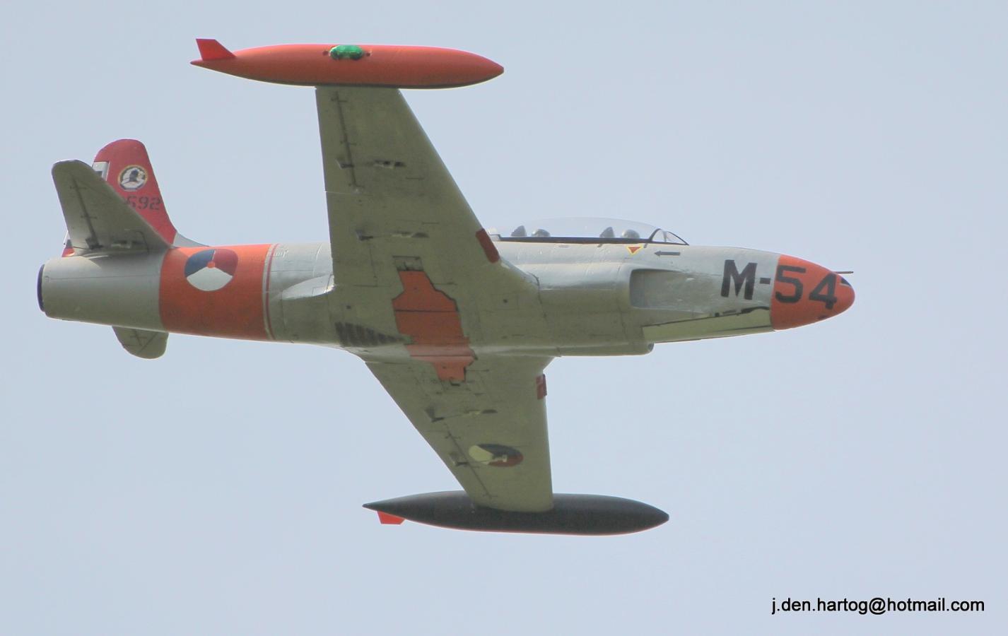

              Yesterday I flew as a guest pilot, some nice pics from show.
              Grts Hans

                #1587
                Grts Hans
                Nice pics and it looks great in the air, I haven't flown this one yet, going to have to give it a try one day, I had the HSD T-33 and flew it several flights, what a great flyer it is so I bet this one flies great as well.

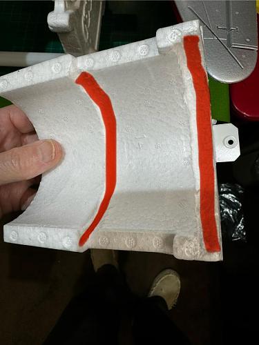

                          #1592

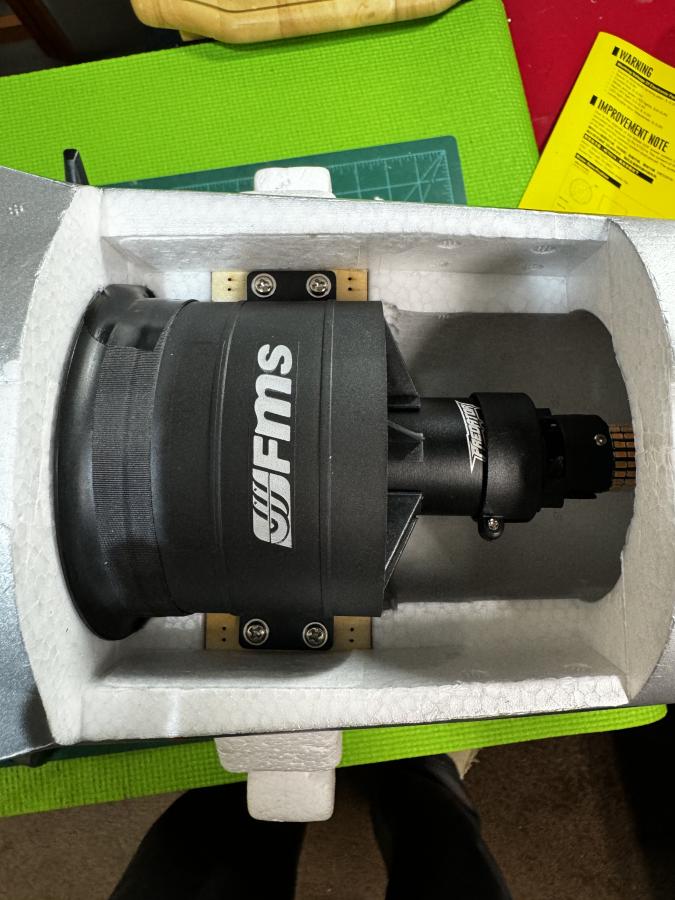

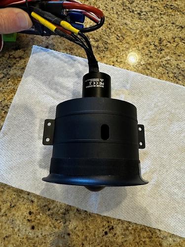

                          I am considering the T-33 ARF, and putting my FMS 80mm 12 blade 3280-KV2100 EDF and 100 AMP ESC in the plane. The motor came from the FMS BAE Hawk, same motor is used in the 80mm FMS Rafale. Has anyone used this as the replacement for the Freewing 80mm?? Also, can anyone tell me the diameter of the Freewing 80mm lip to lip? Mine is 96mm. It has the same 4 mounting holes as the freewing. If the answer is yes, how much foam needed to be modified to fit?? Thanks. Click image for larger version
ID:	392733 Click image for larger version
ID:	392734 Click image for larger version

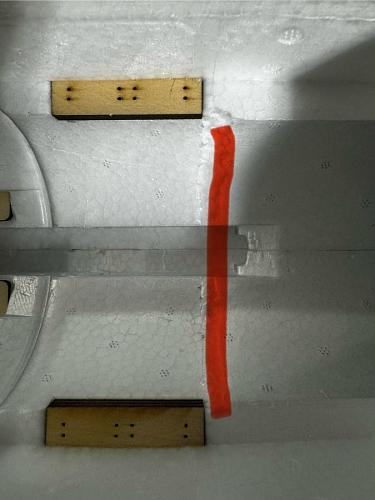

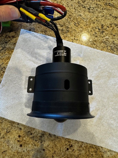

                            #1593

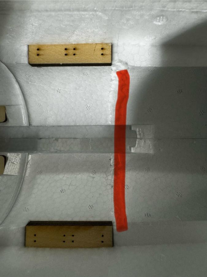

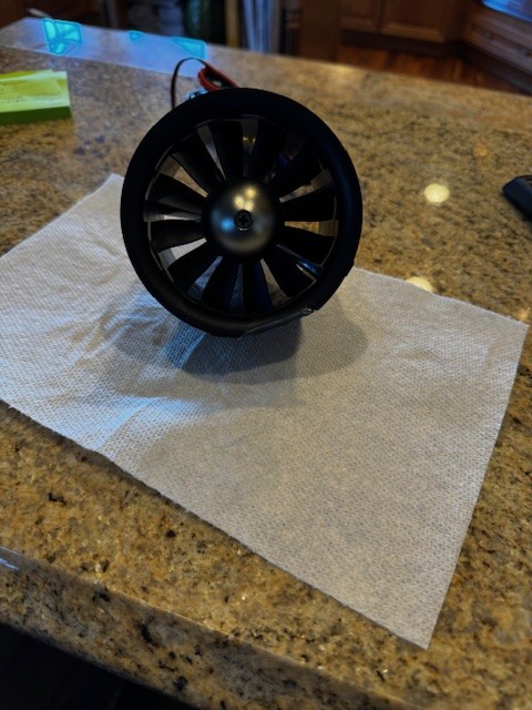

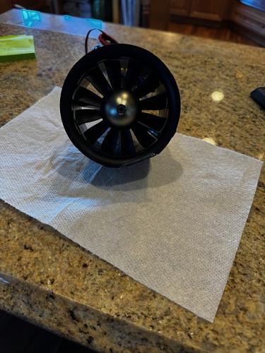

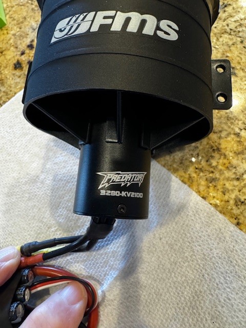

                            OK...........I bought the T-33 ARF and Installed my FMS 80 mm EDF. It fit almost perfectly. Some minor foam trimming on the bottom, because the FMS case is 3mm longer. Same for the top cover, it requires minor foam trimming for the EDF rim and the case length at the back. In the photos. red indicates where the trimming was required.
ID:	392820 Click image for larger version
ID:	392821 Click image for larger version
ID:	392822 Click image for larger version

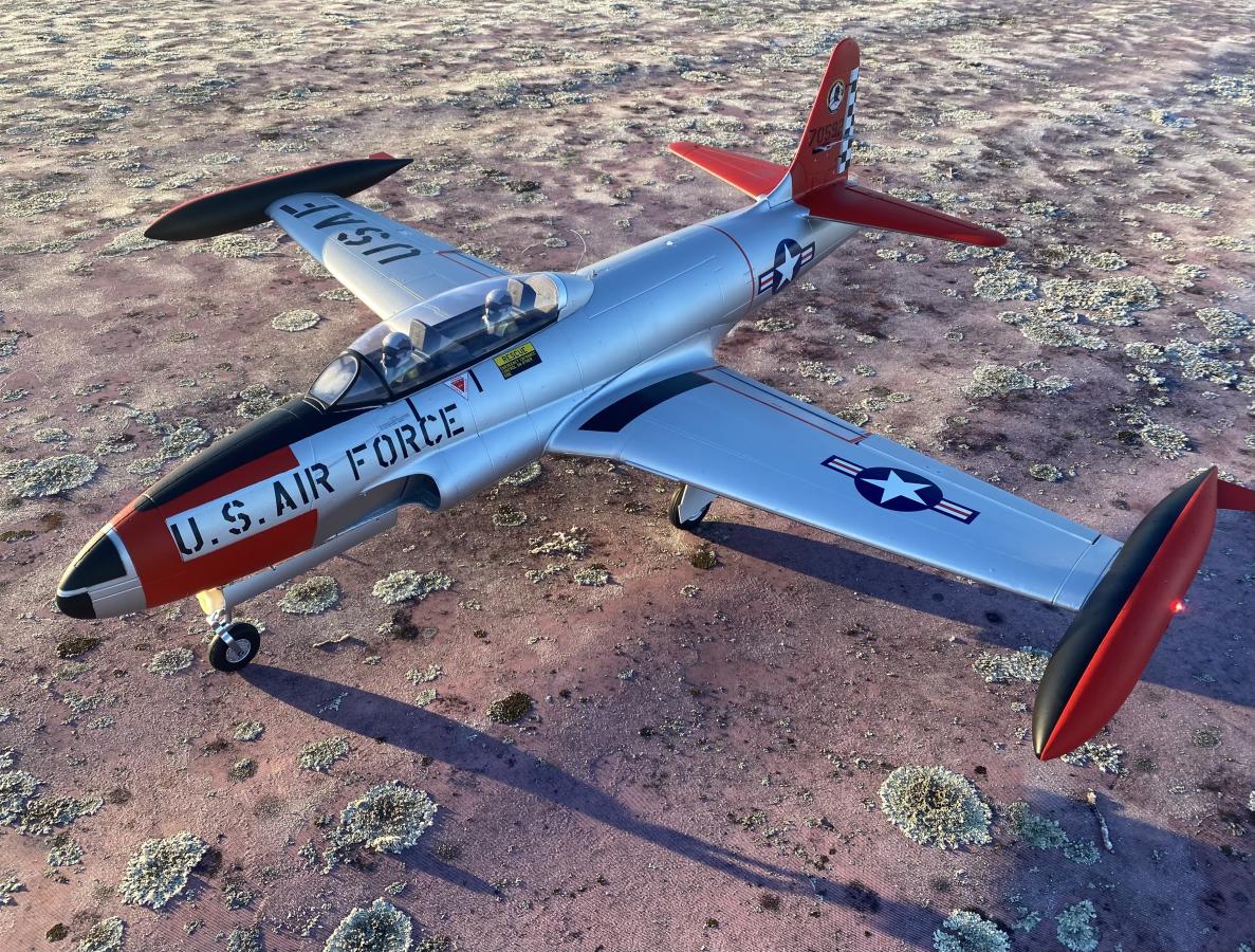

                                    #1597

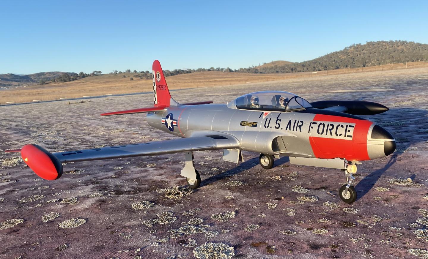

                                    Had a great maiden with the 33 on a very frosty morning.. I added lights from an F14 lightning kit I had lying around. So mine now has nav lights, red anti-col and a landing light on the nose gear.
                                    What an awesome plane in every respect!
                                    She’s a keeper.​
                                    cheers, HTClick image for larger version

                                      #1598
                                      She’s a keeper.​
                                      Looks great, nice pics and I have been trying not to buy this one but after seeing your pics I may just have to get me one, Thanks..

                                        HairyTacco, great mods, beautiful T-33. Best, LB

                                          #1600
                                          Haha. More than happy to be the facilitator of more RC planes in peoples hangar.
