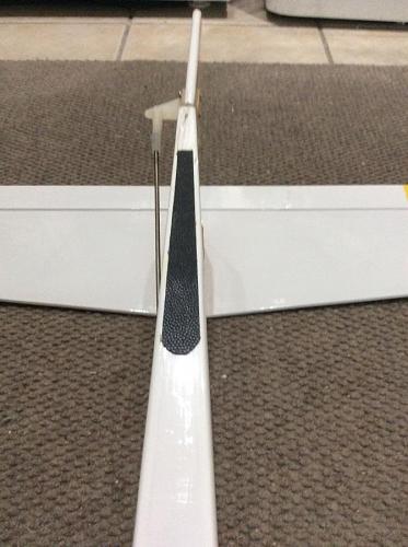

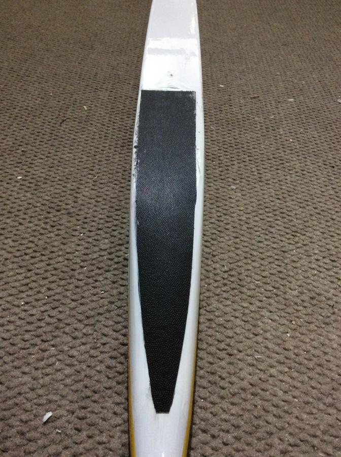

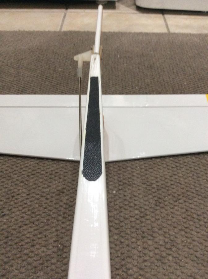

                      Originally posted by davegee
                      Does anyone have an idea or technique they use to prevent scuffing or damage to the bottoms of the tip tanks without pulling the paint off, like tape often does?
                      Thanks for any ideas.
                      Cheers
                      davegee
                      The $1 store has these polypropylene mats which are sold as counter-top savers, usually 3 -6 in a pkg. they a quite thin and flexible when cut into strips, and they have different colors! I use contact cement and have put them on several different planes including 3 of my gliders in place of skids and even on the Ryan STA on the wingtips.
                        Nice Idea! Any chance you could post a pic of one installed on your plane to give me a better idea exactly how you do yours?? Thanks for your input.

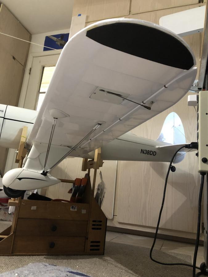

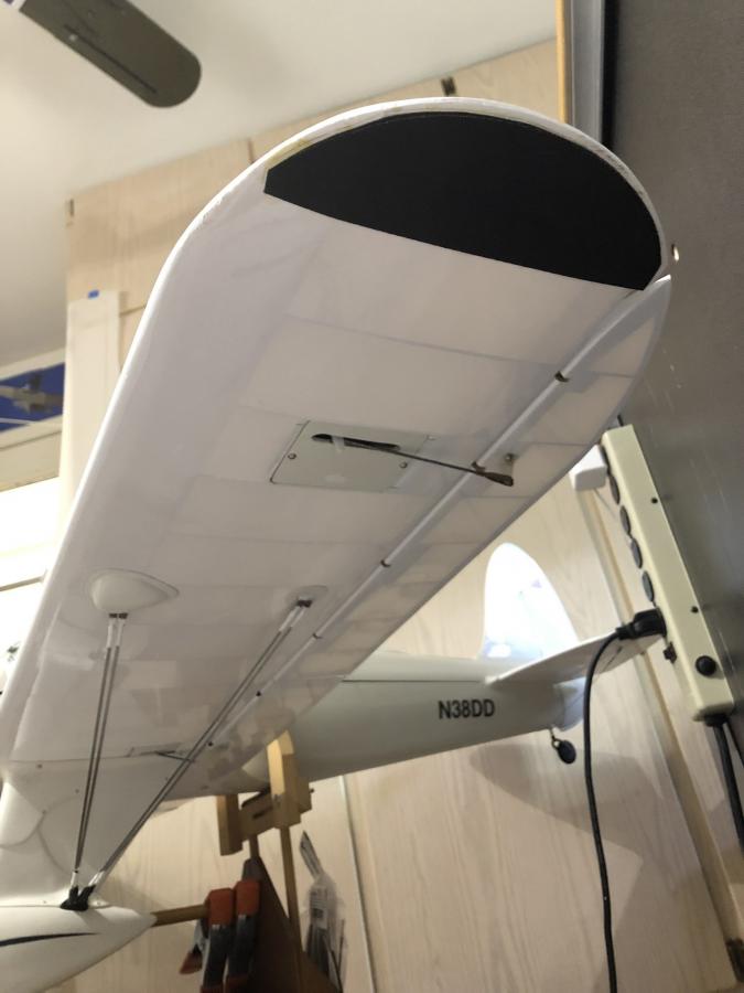

ID:	317809Click image for larger version
ID:	317810Click image for larger version
                          Cheers
                          davegee
                          use the Weldwood or similar solvent based (not water based) Contact Cement. Apply to both surfaces and let dry fully (30 minute) then just carefully position and stick it down - there is no repositioning, so get it in the right place. A bunch of toothpicks can be a nice bridge. Just lay them across the dry cement align your piece and start pulling them out one at a time.
                                Click image for larger version Name:	78F9BAC3-FB6F-4C2D-A9B2-87504E5B3E7C.jpeg Views:	0 Size:	62.7 KB ID:	317806Click image for larger version Name:	4DC63C29-31F5-450F-8F30-500EC6DFAB6B.jpeg Views:	0 Size:	115.3 KB ID:	317807Click image for larger version Name:	04D74C09-1351-4C87-BAB4-C57E7FAD6F29.jpeg Views:	0 Size:	45.6 KB ID:	317808
                                Thanks very much, F22trainer! That looks like tough material that would keep scuffs limited to the protective layer itself and not penetrate to the model structure. I can definitely see some applications for these protective pads on some of my airplanes.
                                Thanks!
                                Davegee
