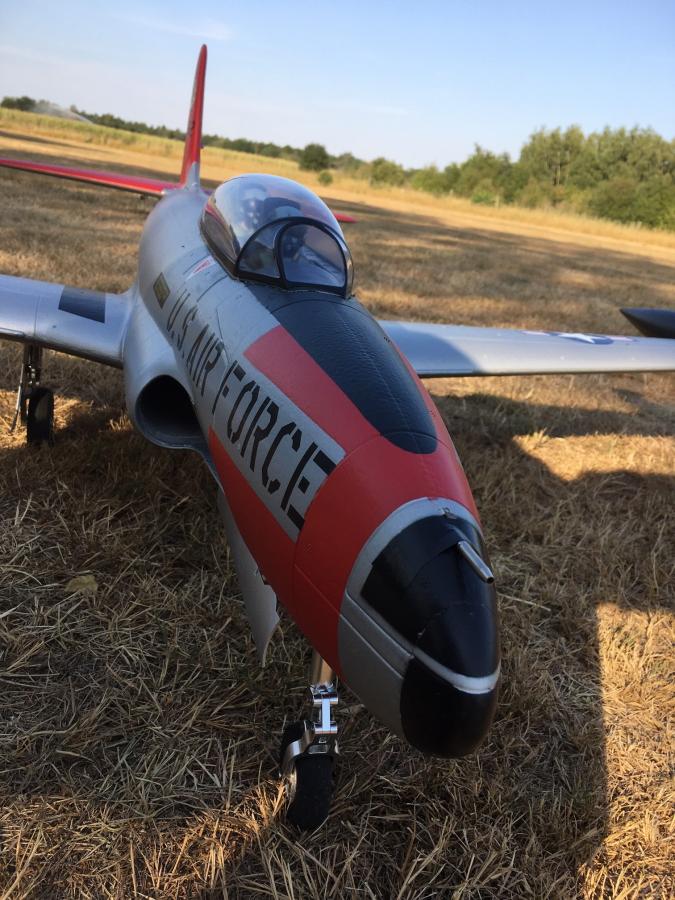

  • I received my German version colour scheme yesterday. I must say that i am impressed with the quality of Freewing products. I have the mirage 2000 V2 as well and yet to maiden both.

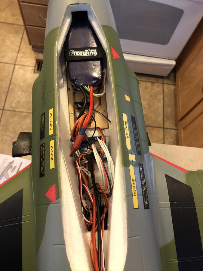

        In the manual they give you a measurement for the wood tray for where to put the end of your battery. I stuck my 4000 6S pack right on the mark, did a quick and dirty CG check using my fingers and the X on the bottom of the fuse, and sent it! There will be no CG drama/controversy on this one!

        Hi Bro, did you put your 6 S 4000mah on the 70mm mark as per the manual and James's online buliding video?

          Now that you have this plane in your hands, it's simple enough to see if you can accommodate those 2 - 3300mah, 3s batteries in the space provided. Next is to see if those batteries will allow the plane to be balanced at the desired and recommended CG. Using 2 - 3s batteries in series to make a 6s battery is not unusual. You must simply make sure that the two batteries are the same brand/size/"C" rating. Since EDFs generally have more draw than a prop plane, the "C" rating is important. Most EDFs do better with a "C" rating of 40C to 50C and higher. Keep in mind that even a brand name LiPo will put out only about 1/2 the "C" that's stamped on the label, so if you have an "economy" brand of battery, you may require much higher than 50C.
          Each plane is slightly different in the way they are built, as are different battery brands, sizes and ratings. Using someone else's "mark" is not always a good idea. You put your batteries wherever they need to be to achieve the CG you want or that is recommended.
          • Originally posted by Shauncat View Post
            ...is it possible to use two 3 cell 5000mah batteries in series?
            Sure! There's plenty of room in the battery bay for the series connector and two 5000's.
            I normally run a 5800 and I know guys run 6200's up there. If you've got some heavier or bigger capacity packs remember that you can remove the weights hidden up in the nose cone and enjoy the extra run time.
            • I removed the nose weights and fly routinely with the HS 8000mah 6s 100C, and she balances fine with the lipo an inch a half back from full foward.
              Remove those nose weights and you can still CG this this bird loaded up with as much of a battery load as her wings can handle.
              • Yep, when I took the nose weights out of mine I was able to move my RT 6250 from right back at the blue box to all the way forward in the bay. Lots of room for a big battery in this beast.

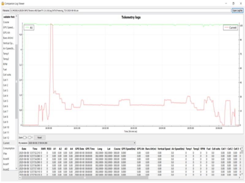

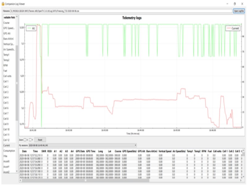

                  • Strange dip in my RCVR voltage from BEC.
                    See telemetry screens below with same LIPO?????
                    It seems to me that BEC of my ESC has an random issue only whit my CNHL blacklabel 6S5000 65C no1 ????????
                    With other LIPO's i didn't sse this issue very strange........
                    I got an reply from a Dutch college on fromum in The Netherlands and he said that voltage measurement is done digital in RCVR,
                    it seems to be done in steps of 0,11 volts...he said to me seeing my data.
                    i was a bit blinded during this, never saw it before ore didn't check it before will look into my old data.
                    Click image for larger version  Name:	RCVR BEC voltage dip with CNHL BLlabel 6S5000 65C faulty 1.jpg Views:	0 Size:	69.8 KB ID:	267360Click image for larger version  Name:	RCVR BEC voltage dip with CNHL BLlabel 6S5000 65C good 1.jpg Views:	0 Size:	63.8 KB ID:	267361

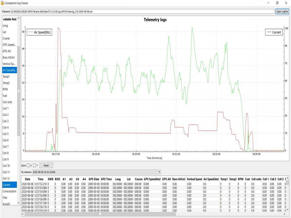

                    Also I received today my Airspeed sensor and tested that also this afternoon.
                    Click image for larger version  Name:	IMG_5111.JPG Views:	0 Size:	108.5 KB ID:	267362
                    Airspeed with Rhino LIPO downwind in a dive is 79 KTS= 146 KmH.
                    I checked also stall speed without flaps and with flaps 25 KTS=46.30 KmH
                    My airspeed warning is set to 52 Kmh ore 28 KTS.
                    Just a nice future to have.

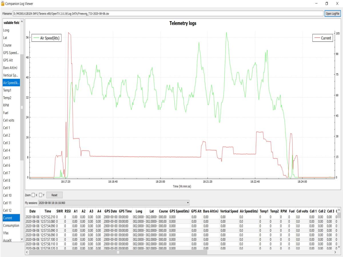

                    • Flight speed and amp draw.
                      at my last flight today I was testing how slow I could fly with my T33.
                      I knew I could fly easily at 20-22 amps, but today I managed to fly at 15 amps, see below
Name:	airspeed amp draw telemtry screen.jpg
                      Grts Hans

                                        • Originally posted by timmybeetle View Post
                                          Grts Hans
                                          Nice chart and stall speed test. Very useful info indeed. I flew FPV on my buddy's rig which has ASI. We were approaching at 40kts and touching down around 30. Good to know we have some safety margin left. Thanks a bunch.
