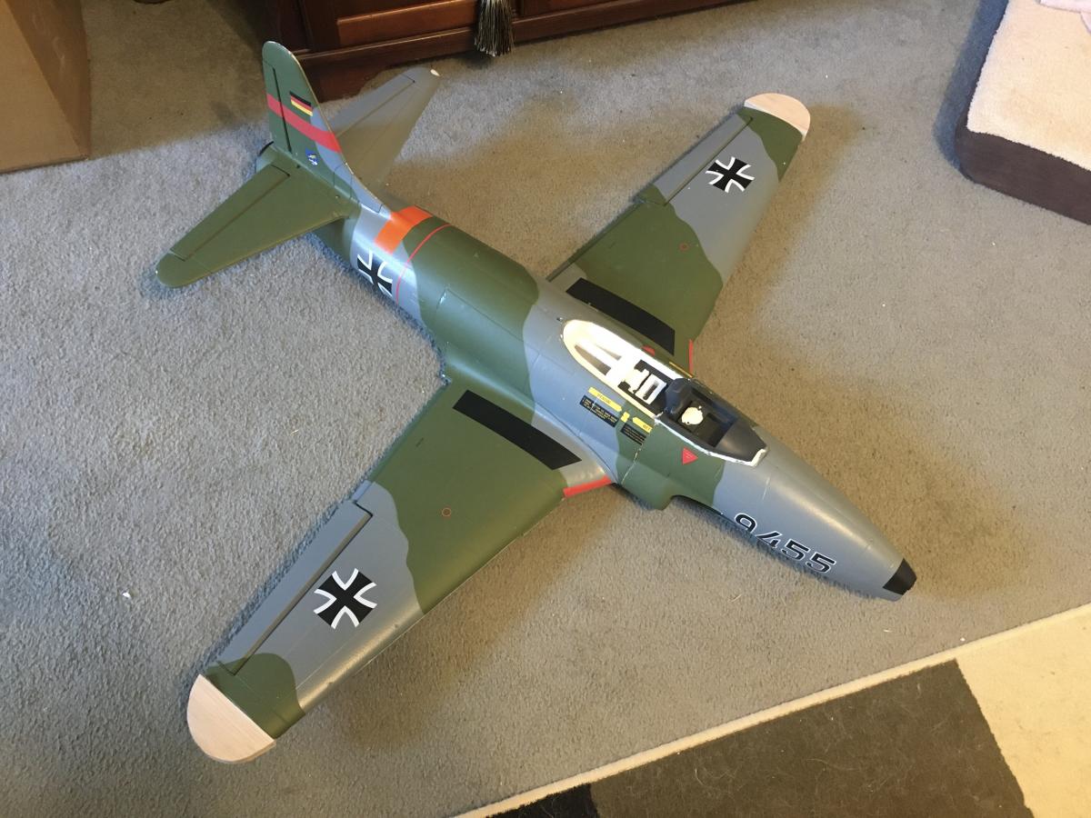

          I am still doing a little work when I can on my P-80 conversion. This is the latest pic I have, before the latest work that has been done. The P-80 is now paint stripped, with wingtips fully shaped. The fuse joints are spackled and blended in and the rear of the hatch now has a foam block blended to match the fuse. More pics soon.

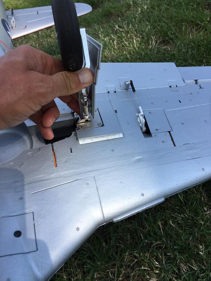

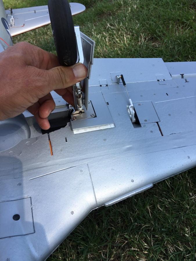

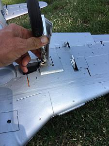

                          Retract issue,glue....
                          Hi
                          Today after i guess about 10 flight with my T33 from grass on my last landing it was a bit bouncy but not too heavy.
                          Return to base and I inspected my LG to make sure everything is ok.
                          Sadly my right LG was a bit loose and my door was not at his place....
                          I received mine June 11.
                          See also https://www.hobbysquawk.com/forum/rc...360#post259360
                          I repaired my door with acetone, and re glued my LG, other side still holding strong......
                          Hoop it will be ok for the next couple of flights.
                          Greetings Hans
                          Click image for larger version  Name:	IMG_4922.JPG Views:	0 Size:	87.7 KB ID:	260747Click image for larger version  Name:	IMG_4923.JPG Views:	0 Size:	65.5 KB ID:	260748Click image for larger version  Name:	IMG_4924.JPG Views:	0 Size:	87.7 KB ID:	260746

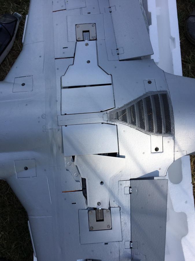

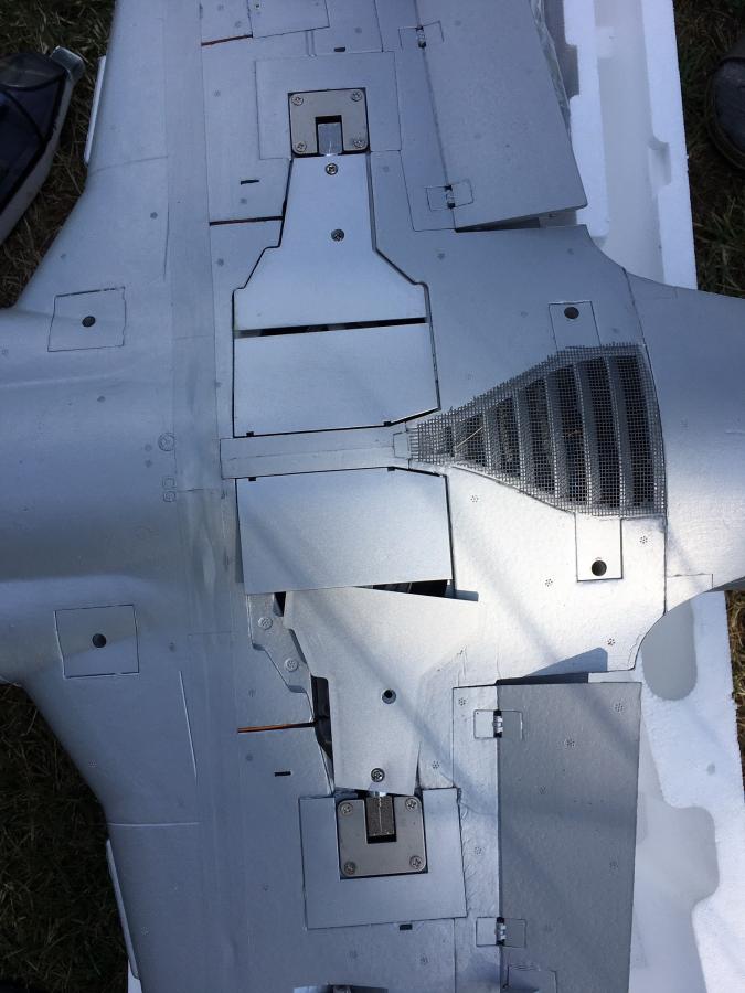

                              Mine were still strong after 28 flights but this afternoon I decided to take out the retract boxes and glue them in again ... I don't want to mess up my scheme with a bad landing or ripped out retracts!
                              I hope your's are fine now so you can continue flying without issues!

                                  I have had very very few Freewing landing gear mounts pull out. The only time was during a very poor landing of the Ta-152H, when both let go, at about Flight 40 or so.
                                  If I ever have another one pull loose from the foam, I am going to improve it a bit by adding a couple of number 8 drywall screws to the box. Drill the plastic box for the screw and countersink. Drill an oversized hole into the foam for a 1/2” deep or a little more. When you reglue the box, with whatever glue you like, fill your the oversized screw hole with some epoxy. This will increase the torsional and tension strength of the gear mounting box joint to the foam.
                                  The key here is to not overdo it to the point that a bad landing rips the wing apart at the gear box mount. Add a little more strength where it takes more to pop it out, but not so much that it does wing damage.

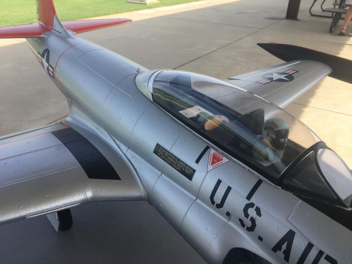

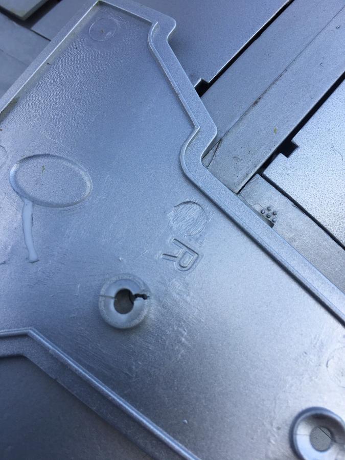

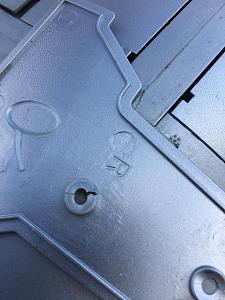

                                    At the field today, my T-33 pilots were trying to escape the cockpit. Looks like the screws Freewing used to retain my pilots were a little on the short side. The front pilot is barely hanging on.
