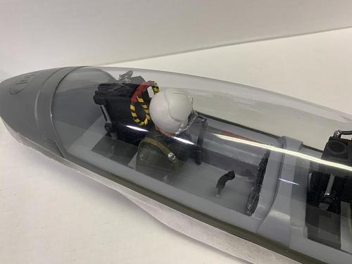

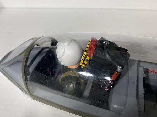

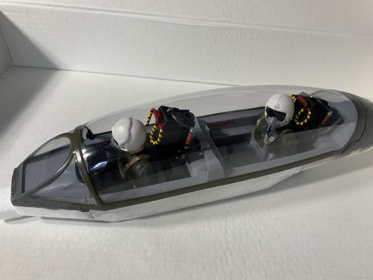

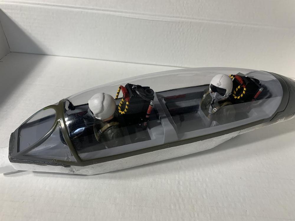

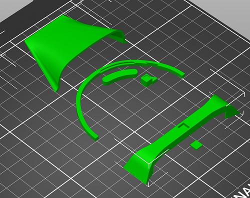

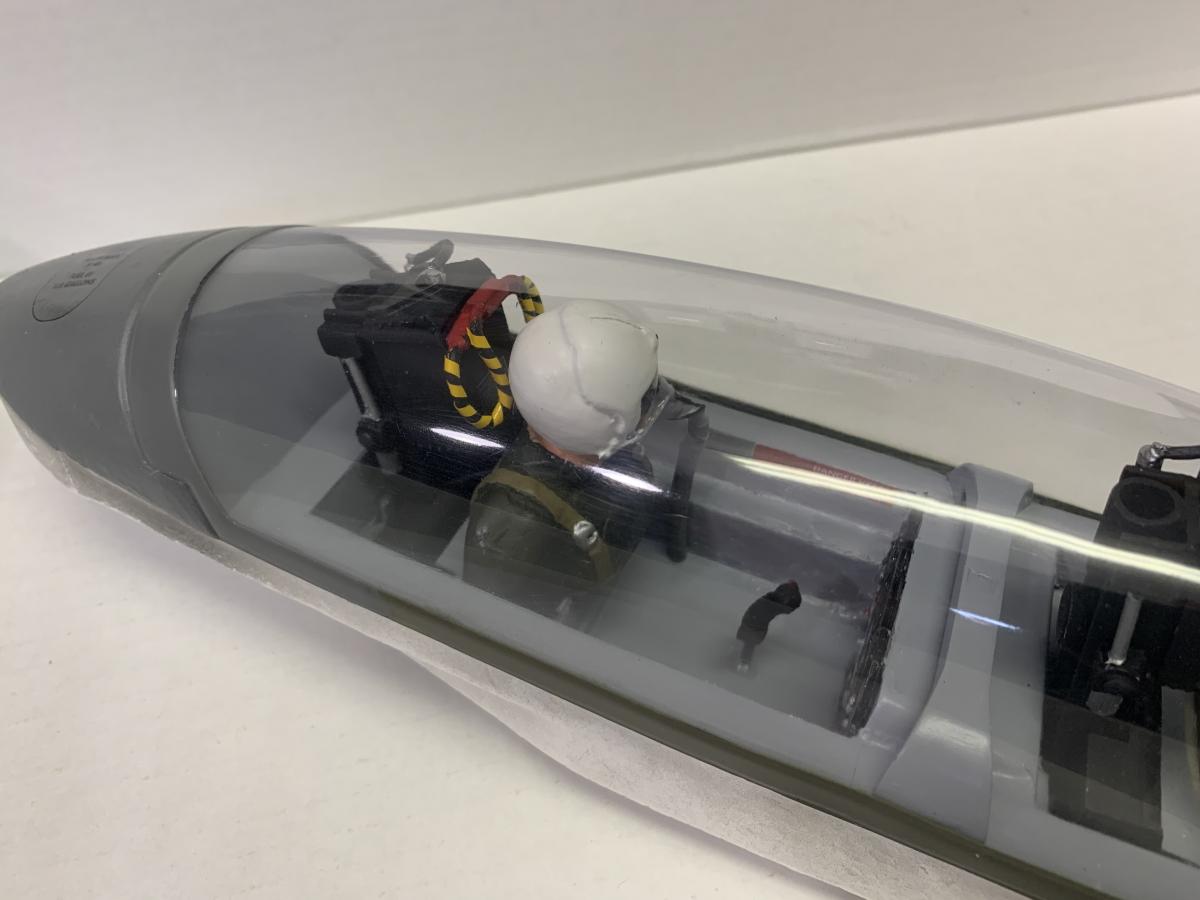

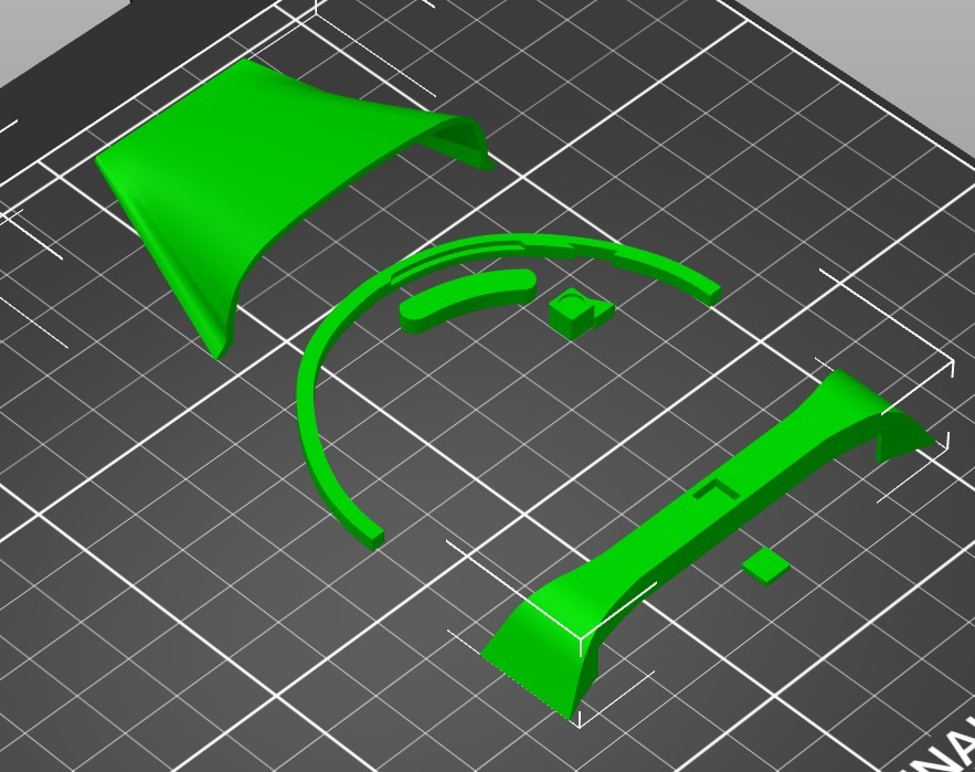

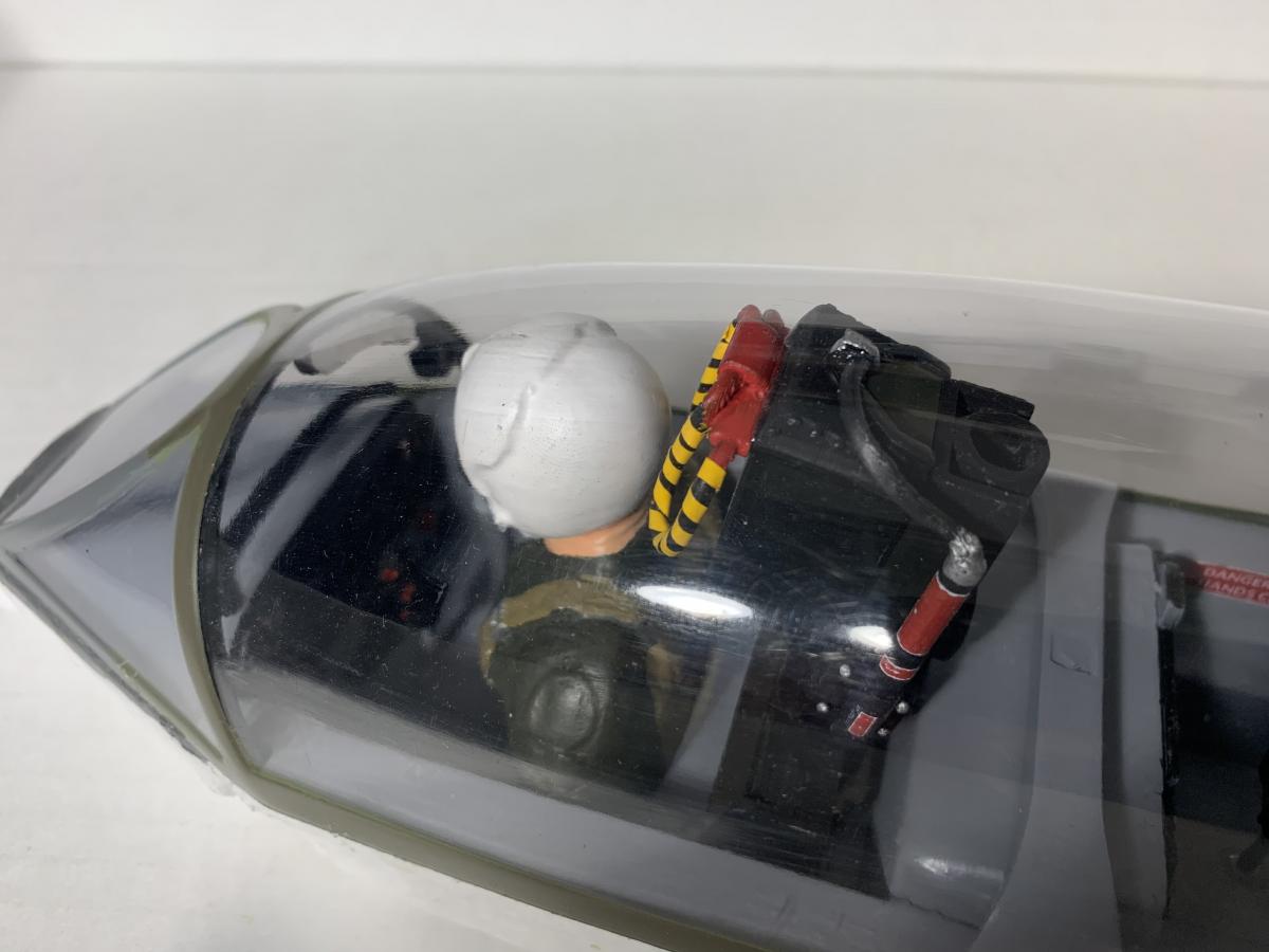

        Here are the final 3DP parts for the cockpit.
        - Front panel coaming. I trimmed mine by 4mm in height.
        - Canopy arch plus mirror and compass housing
        - Canopy frame cross brace (located above rear coaming).
        I found a nice file for a control stick and scaled it down:
        This is a replica of a B8 Flight Stick used in many helicopters and fighter jets. The model has holes cut out to place m10x1.25 nuts which is the thread size used for many shift knobs. I did my best to recreate the shape of the knob based on many photographs.
        Click image for larger version  Name:	Final cockpit parts.jpg Views:	0 Size:	134.7 KB ID:	241316Click image for larger version  Name:	IMG_3581.jpg Views:	0 Size:	64.2 KB ID:	241323Click image for larger version  Name:	IMG_3584.jpg Views:	0 Size:	70.2 KB ID:	241324Click image for larger version  Name:	IMG_3585.jpg Views:	0 Size:	78.4 KB ID:	241325

          Top work, Radar-Guy!
          Many thanks!

            WOW.............. thank you so much RG, super work!!
              #966
              Really, really nice, Radar-Guy!

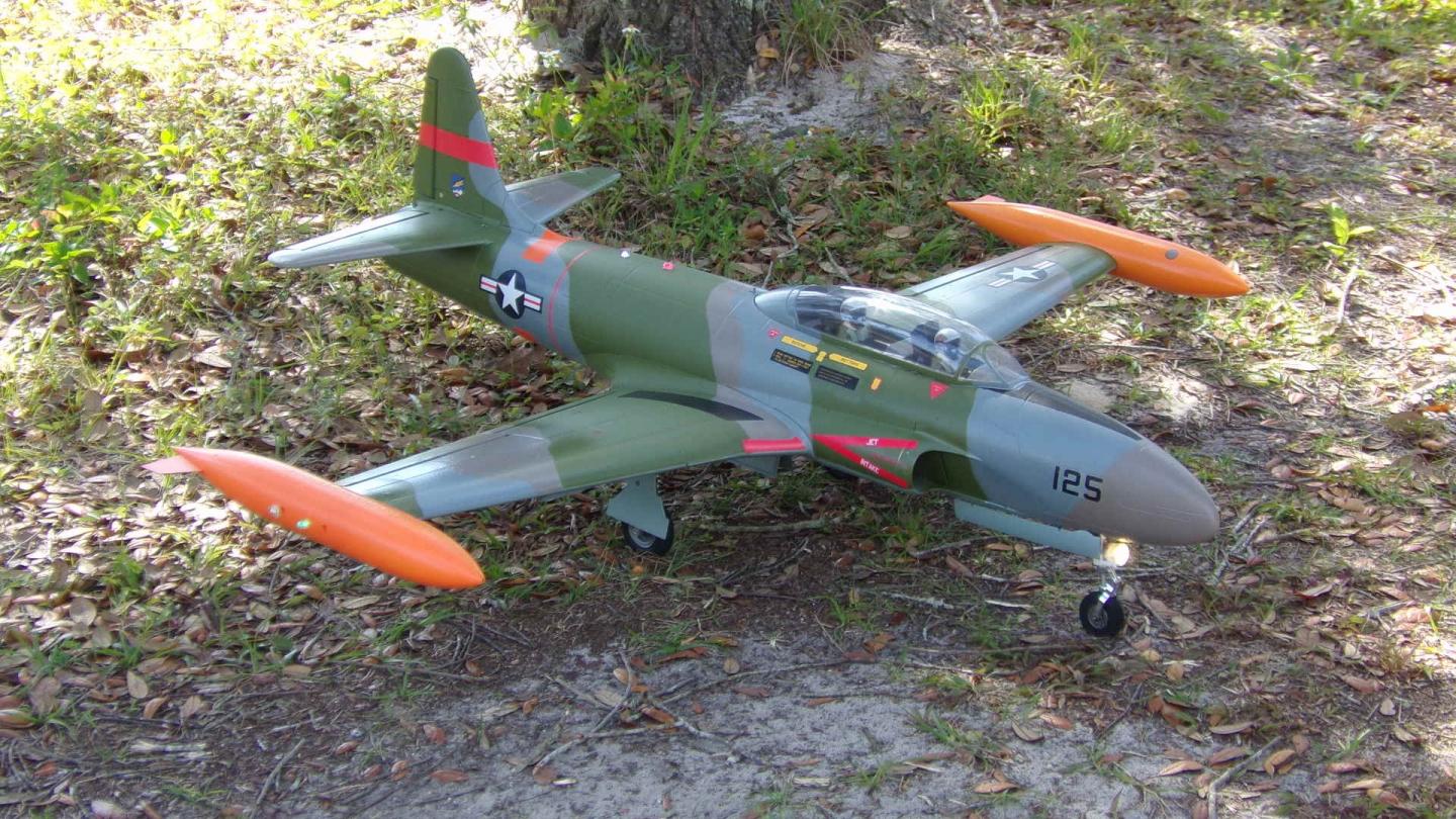

                  Just wanted a before and after shot of the mods I made to my T-33 ; Did a little repaint to the green and gray then added tan to the fuselage and wings and full orange tip tanks.
                  Added 8 lights to the plane 3 static 5 flashing; one nose wheel landing light; 2 wing tip static nav lights; 2 wing tip double flash strobe lights ; 2 single flash RED beacon lights, one top one bottom of fuselage and one triple flash strobe light top rear of fuselage. finished off with the USA decal sheet from the Freewing 90mm T-45.
                  Nose wheel light from Freewing 90mm F-22
                  Static RED, GREEN Nav lights top triple flash strobe light and both RED single flash beacon lights FMS 1400mm T-28
                  Both wing tip double flash strobe light from top of Freewing 80mm Avanti S
                  Paint from Lowes Valspar water base sample paint
                  Decals from Freewing 90mm T-45
                  youtube lights https://youtu.be/1meNw82EIKk

                                That's one fantastic cockpit Radar-Guy!!!
