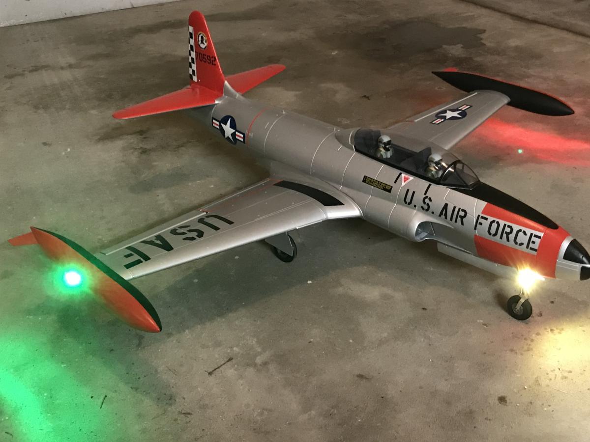

        • Originally posted by flazz View Post
          #913
          Yesterday, 11:33 AM
          "I added some leds to my T-33. A solid green & red on the wingtips, a white beacon on top and a red beacon below.
          I used some clear lenses/mounts where these high power 1w leds fit in perfectly, as you can see it gave good results and I could install them without showing or damaging the foam."
          IT2:
          Very cool, I'm planing on do something similar. Can you give us a source for the LEDS and the lens covers? Also, what flashing unit are you using?
          thanks for any info.
          Thanks flazz
          I bought my lens covers here https://www.aliexpress.com/item/32820431045.html but you should be able to find similar ones on Amazon or eBay.
          I didn't use a flashing unit, all leds are connected to the various light ports on the bluebox (steady lights for the wingtips, double flash for the white beacon on top and triple flash for the red beacon below).
          Good thing that Freewing includes these blueboxes in their planes, but I always suggest to open them and check the soldering on the bottom.

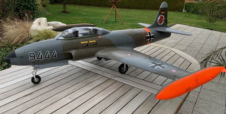

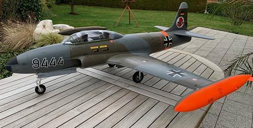

          • Originally posted by Corsair nut View Post
            Exit is about 60mm
            Thanks! Here is the file for a 3DP nozzle. Slow progress with my make over, but the weather over here is still too bad for maiden flight.
            Click image for larger version  Name:	IMG_3549.jpg Views:	0 Size:	114.9 KB ID:	238066

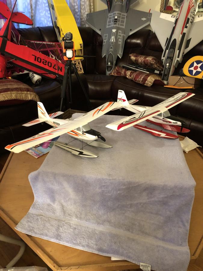

            • To bad the T-33 doesn't have enough power to put ski's or floats on it, I would be out flying mine off the Snow.We just got 8 to 12 " here in Rapid City SD OH well I just finished painting the floats for my new E-Flite Air Tractor and painted and put floats on the new UMX Turbo Timber to fly off the Snow

              • Originally posted by Wild Man View Post
                How do you know it doesn't? You don't know till you try. Personally, I fly all winter in the snow/ice but it's primarily with my VTOL's and water planes, "skidders", hand launchers and planes with giant balloon tires.
                    So do I. I have 5 or 6 planes with floats, Ski's and Tundra tires, but I prefer All of them with the floats on them. Come Spring and the Lakes melt then I fly off the water while out fishing. Love my Two Mini Timbers. Fly them from my front deck.

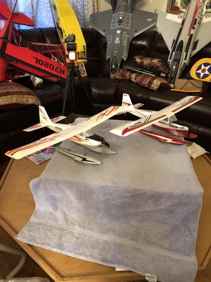

                    • I think, if you really wanted to, some smaller floats would work on this T-33. You don't need them to be large enough to "float" the plane since it's not off water, just enough for it to slide along the snow/ice. I'll bet this plane has plenty of power to do that - less friction sliding on snow than wheels rolling on grass. Personally, it's just not worth the effort to do it with my other "winter" planes available. I even had a Lippy P.15 that can be thrown in winter.

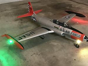

                                  • Landing lights in, dorsal strobe in, Ejection seats in.
                                    I'm not going to do the wing lights or I'll never finish. It's almost time to fly
                                    • Originally posted by Gilatrout View Post
                                      dont be a so lazy Gilatrout , you will bite yourself into your own ass later if you dont install the wing lights now, while you are at it. To wait a few days longer will hurt nobody, just think about how cool it will look and go for it .

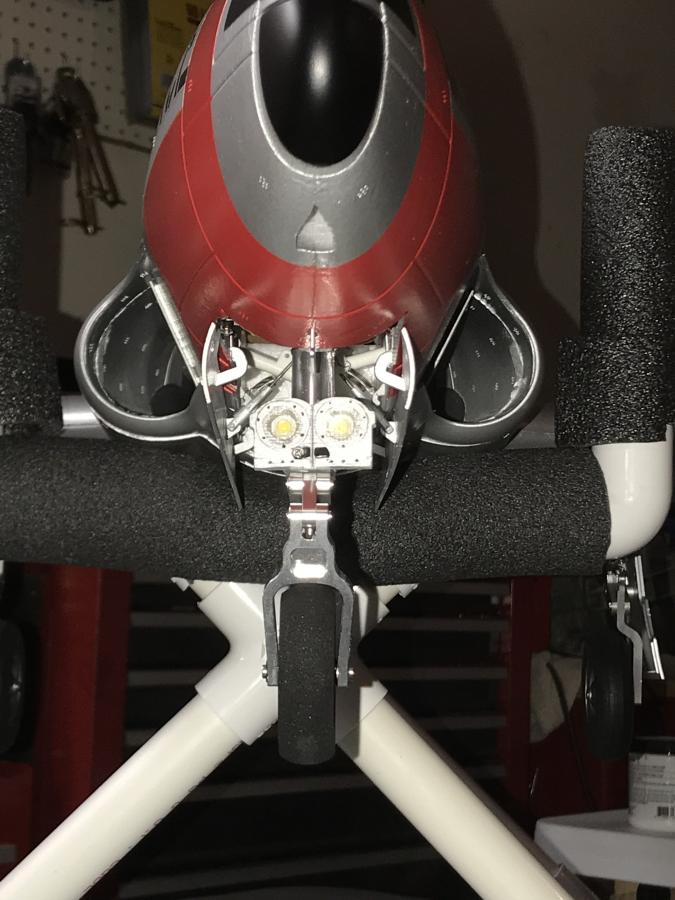

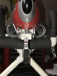

ID:	239054 Added LEDs to mine. NAVs, Strobes, flashing beacon, and dual nose gear lights. I’ve got posts on my YouTube Channel. “Race 22 Crew” on how I did the install if interested. Click image for larger version
                                        • What type of LED and Strobe?
                                            Elbee commented
                                            Editing a comment
                                            QB, In "Race Crew 22's" utoob videos, he mentions that he bought the L-39 LEDs and Lenses and an A-10 LED set from MotionRC There are 3 vids on his install on his channel. Check those out. Best, LB
