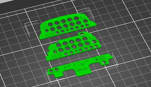

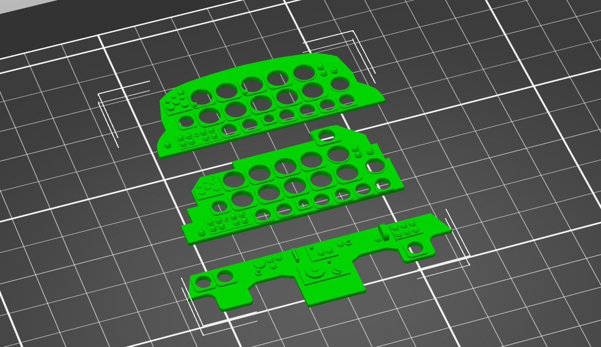

      Originally posted by Radar-Guy

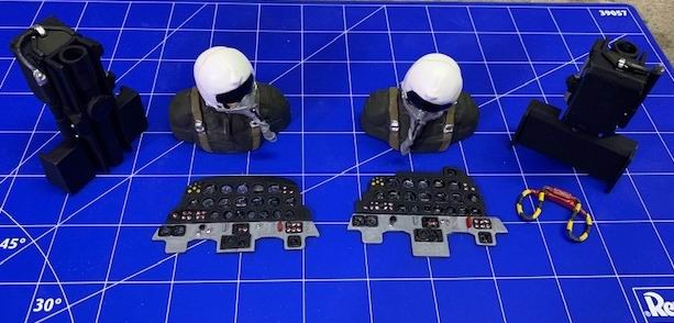

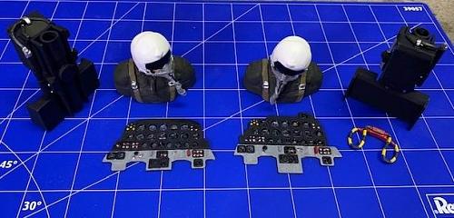

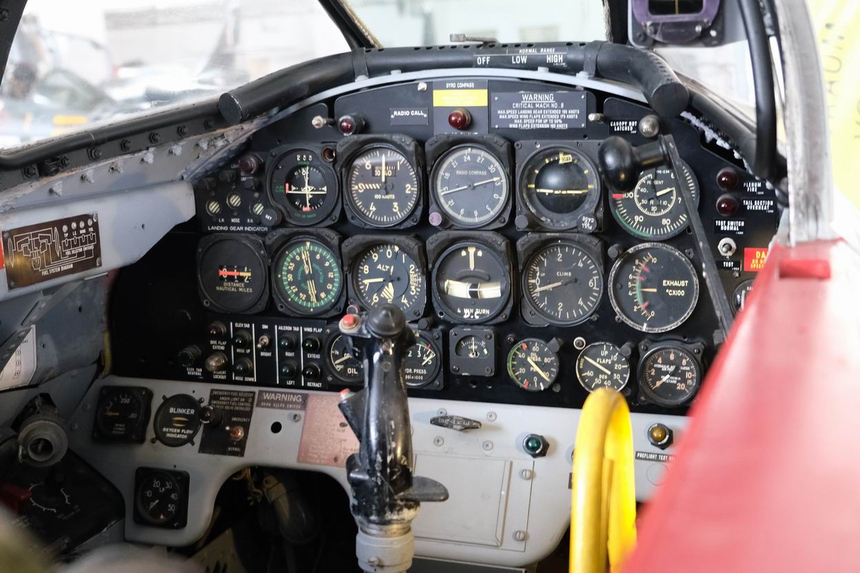

      Cockpit work in progress...

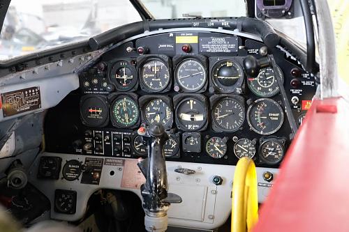

      Click image for larger version Name:	Größenänderung DSCF0657.JPG Views:	9 Size:	209.9 KB ID:	236241
      Awesome work Frank, can't wait to see the final result....

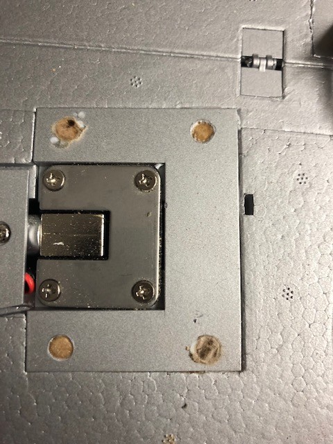

        I had what I felt was a great maiden today. The German livery version. Flew great. Love the plane. But then the landing. It was a normal landing. Not hard by any means and my starboard main LG popped out. Broke the wire at the base. Gear doors also broke. I'll have to take apart and solder the wires. A real PITA.
        Mine is the 4th T-33 at our field in recent weeks to experience retracts popping out due to a crappy glue job. I knew about this potential problem but there's no way to check if they are glued in solidly. I wiggled them and they seemed okay.
        Motion should know about this known defect.
        Hawk
        If I were to start over, I'd just rip out the two rear landing gears and re-glue them with gorilla glue. When they popped off during landing, it also snapped the hinges on both inner landing gear doors. I was lucky that the wires were not snapped, otherwise it would have been a real PITA.
        The nose gear seems to hold solid.

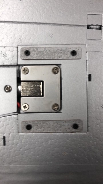

          I worked on one of my T33s and it did not take much to remove the entire plastic gear mount. The contact area was very dry with only a few places bonding the foam to the plastic.
          While Gorilla glue will work well, if you dont want to ruin the foam around the mount you can do the following.
          Drill 4 1/4 " holes about 1/2" deep through the plastic flange and into the foam.
          Glue in 4 1/4" dowels.
          Make a retaining strap out of metal, polyply or good quality plywood.
          Apply a little ShoeGoo or similar to the strap and screw into place.
          The gear will now rip out before the mount does.
          Dw

            That's clever, Thx !

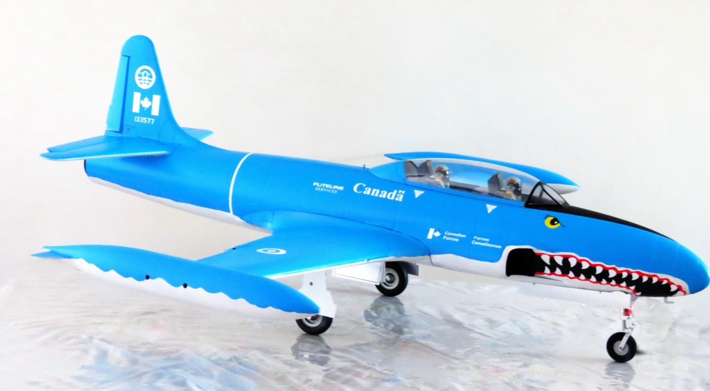

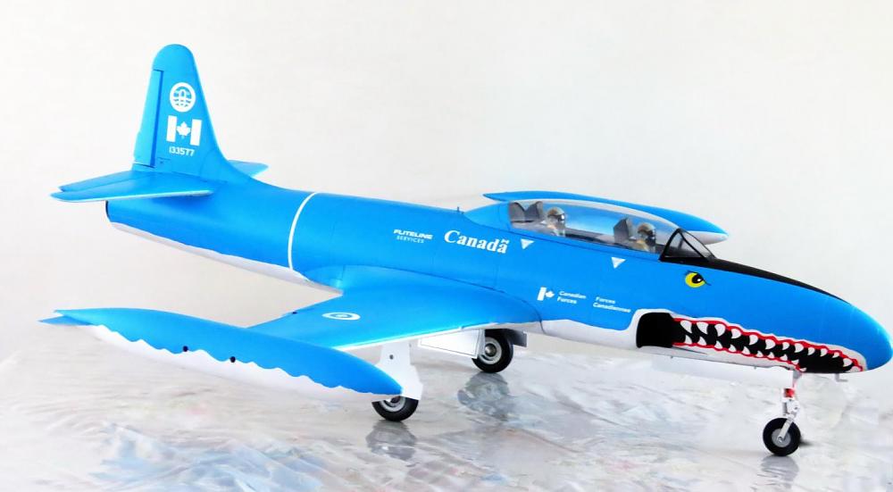

              It is finally done (livery as Waterloo Warbirds "Mako Shark). I will install lights and possibly air brakes before maiden next month.
              Waterloo Warbird’s Silver Star was built in 1957 by Canadair and entered RCAF service with tail number 133577. She served with 414 Squadron, based on Vancouver Island at CFB Comox in British Columbia and later with 417 Squadron, based at Cold Lake, Alta. Our aircraft was used for training, electronic warfare and target towing roles while in RCAF service. As with all other RCAF T-Birds, our plane received an extensive avionics upgrade and overhaul performed by Kelowna Flightcraft in 1996 (known as the “AUP” upgrade). She was placed into flyable preservation in 2002 and sold off in 2003 to Red Star Aviation, based in the U.S. She was then acquired in 2007 by an ownership group that eventually became Waterloo Warbirds. Her unique “Mako Shark” paint scheme is based on a similar commemorative livery that flew for one season in 1992 with VU32 Squadron, based at CFB Shearwater in Nova Scotia. The Mako Shark is very popular wherever she flies! Click image for larger version

                Very nice work Daiglo, should look beautiful in the air ......

                  Thanks for the fix. Looks to be simple but effective.Wish I thought of it

                    Daiglo , really well done. Saw this on Facebook as well. With what and how did you do the masking for the blue to white edges on the tanks and above the mouth?

                      DG, I love it, big time. Thank you for the background history. I researched more pictures and this is quite the popular aircraft. Bravo Zulu. Best, LB

                        The Mako Shark was painted with Rustoleum Spray can and the edges were done with a paint brush using computer colour matched water based paint . All was sprayed with clear satin Rustoleum to match the sheen.

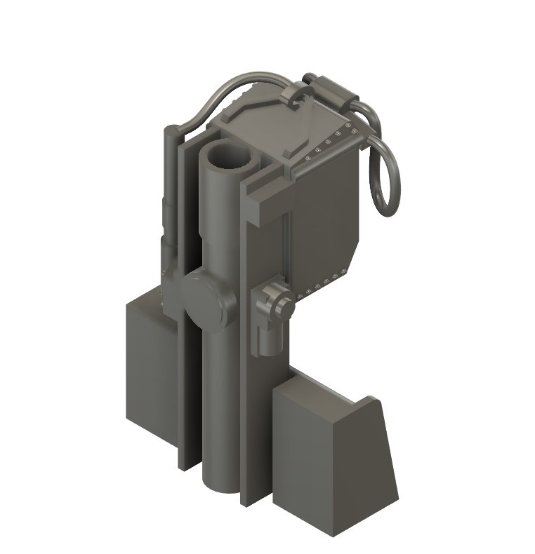

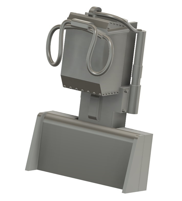

                          Here are 3DP files for better looking seats, based on the Martin Baker MK GU5 as used in later Luftwaffen T-33s. Parts printed with ASA Filament. Warning: This is a kit Please refer to the pictures for assembly.
                          Click image for larger version  Name:	Seat 2.jpg Views:	0 Size:	42.0 KB ID:	237360Click image for larger version  Name:	Seat 1.jpg Views:	0 Size:	36.9 KB ID:	237361Click image for larger version  Name:	Cockpit Parts.jpg Views:	0 Size:	56.3 KB ID:	237362

                                Radar-Guy Again great work Frank, thanks for sharing!

                                    Radar guy, for those of us that don’t have access to 3D printers, would you consider selling parts already made?

                                      Wow! amazing work once again! Thank you for what you're doing!

                                        Radar-Guy, you're taking it to another level with that cockpit set.

                                          These look great; thanks for your work Radar-Guy!
                                          I see you added also a lower rear cockpit panel?👌
                                          Could you please point us into the direction of that file?
