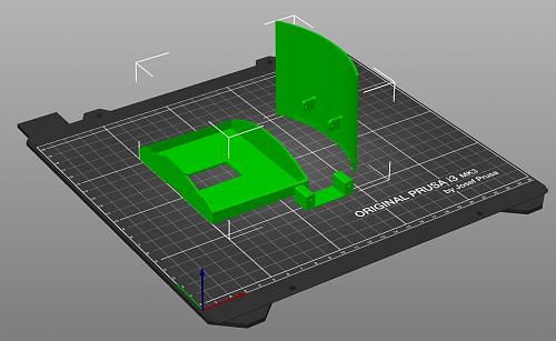

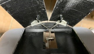

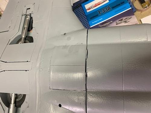

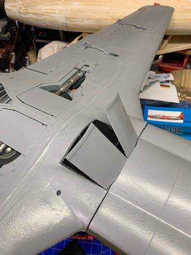

                    More 3DP stuff...

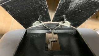

                    Here are parts for the speed brake, loosely based on Brent's design. The servo mount is designed for a Corona (!) DS-939 MG servo. I had to remove a bit of foam from the fuselage to give room for the servo. It should be easy to move the servo closer to the "brake boards", if desired. You may notice a "step" at the aft end of the boards. That's caused by an issue with my printer, it's not in the model.
                    Frank

                    Many thanks.
                    Can you describe how the pushrod is made?
                    I would also be indebted to you if a certain high res decal document were posted😁
                    In all seriousness, truly thank you for sharing this work
                    • Radar-Guy
                      AirBorn Jetworkx
                      • 364
                      #911

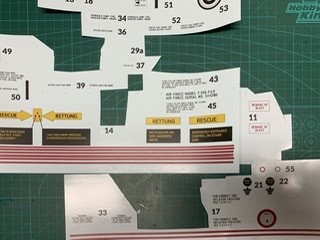

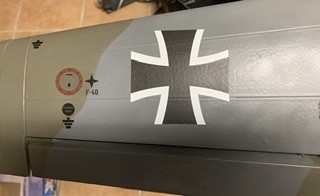

                      Two pushrods, made from the „servo wire catcher“ that comes with kit. Z-bend on one end, quick link connector on servo.

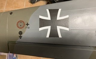

                      It‘s still in my mind! I‘ve started applying my DIY decals yesterday, making further mods to the sheets during the process. You‘ll get it soon!
                      Click image for larger version  Name:	D28D3766-0E6B-4FF1-8C18-1EDC9B069E0E.jpeg Views:	0 Size:	17.4 KB ID:	237811Click image for larger version  Name:	1D896A0F-310A-4AC6-8129-D870BE7A6ACC.jpeg Views:	0 Size:	13.9 KB ID:	237812Click image for larger version  Name:	E6635EFD-042B-4C75-8D5F-767E9A920E52.jpeg Views:	0 Size:	23.5 KB ID:	237813

                        very nice! your 'real' german T-33 is a true work of art! can't wait to see the final result

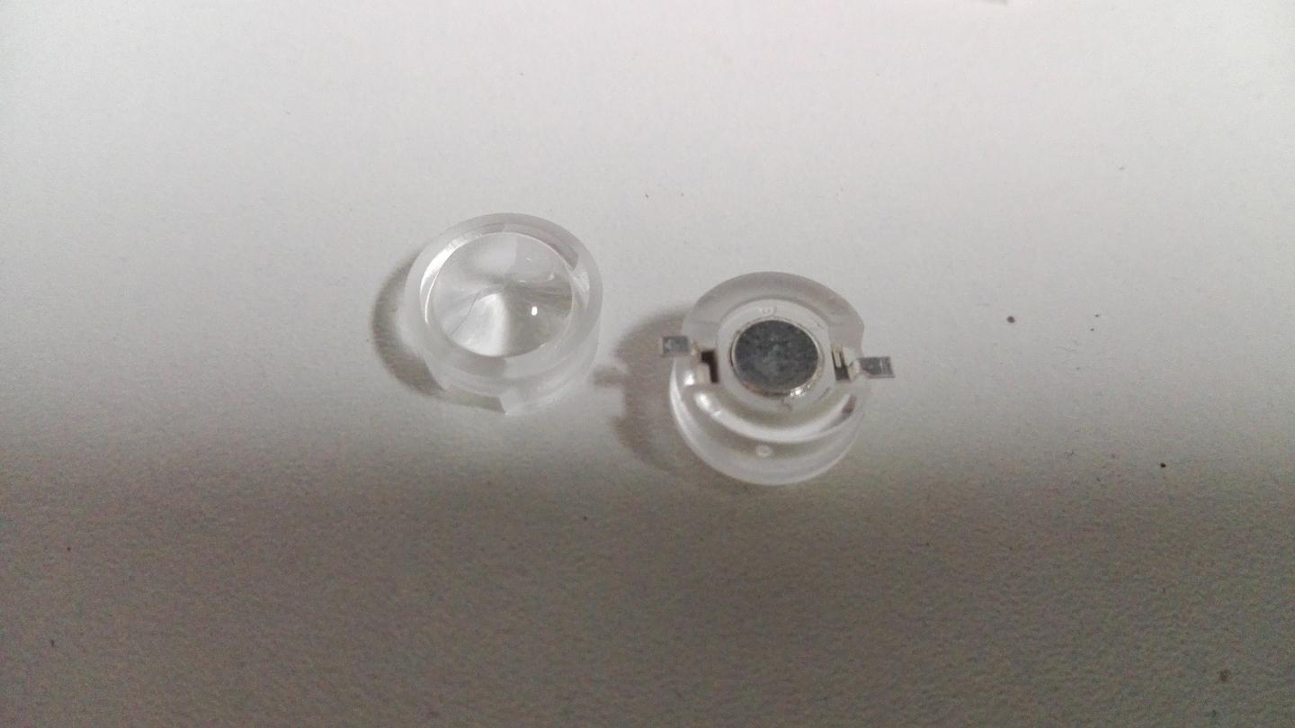

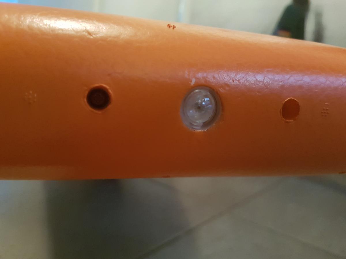

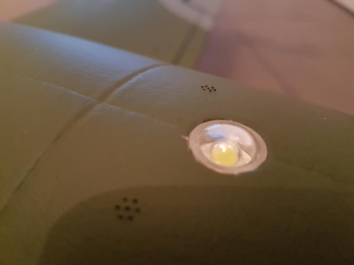

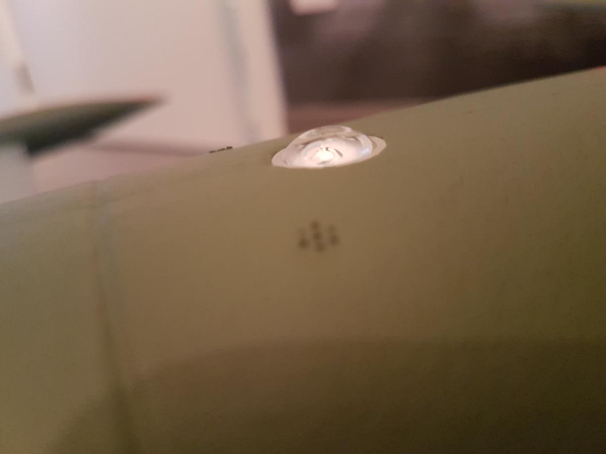

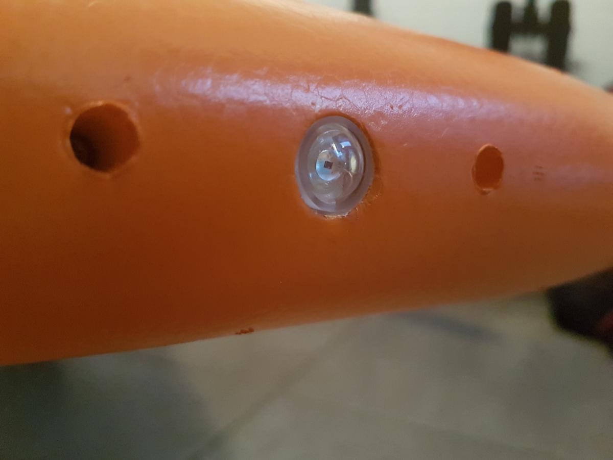

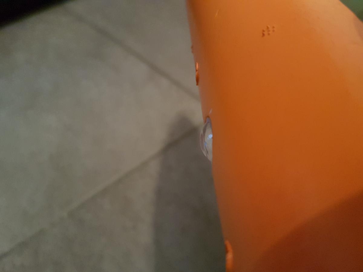

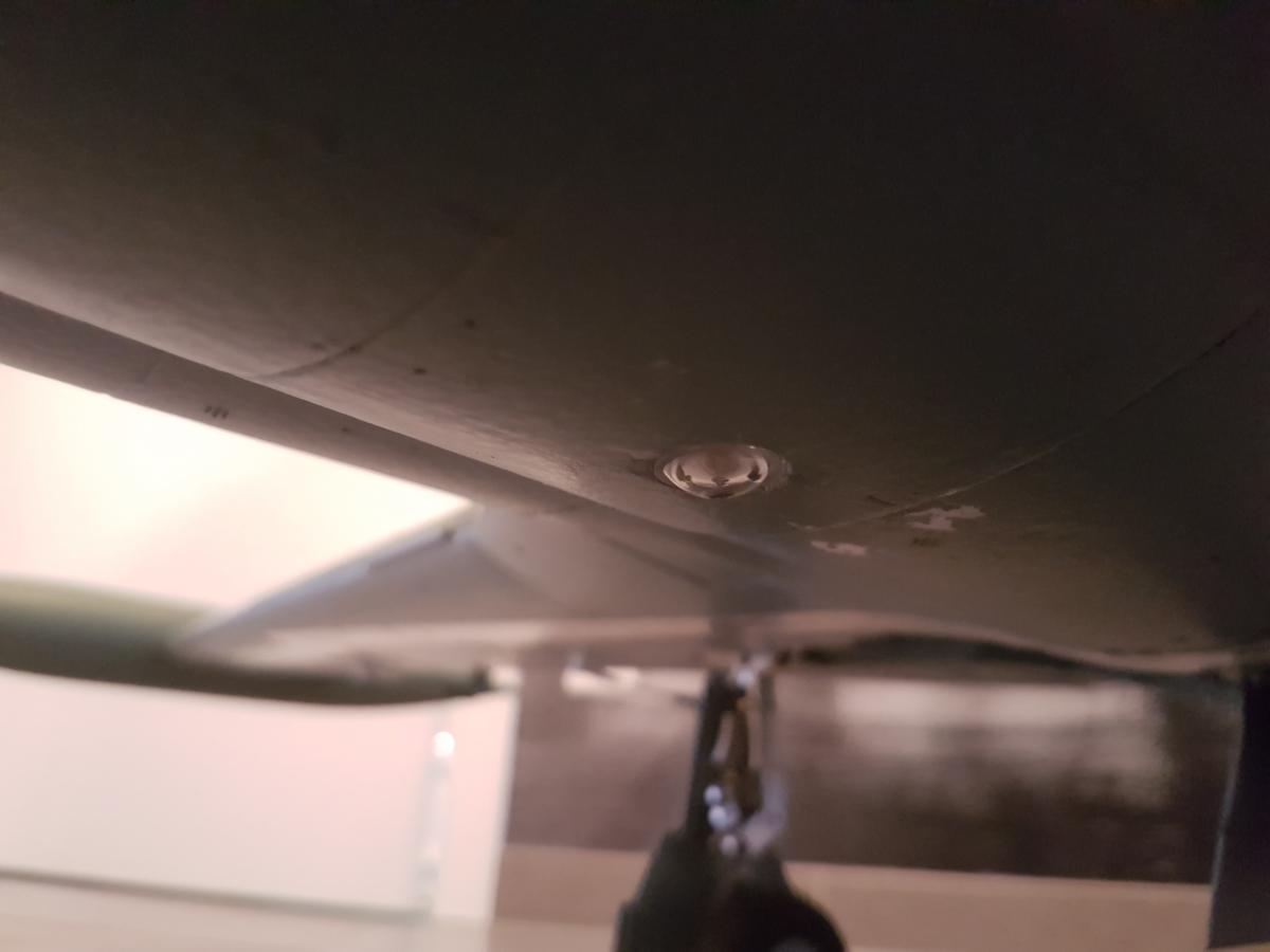

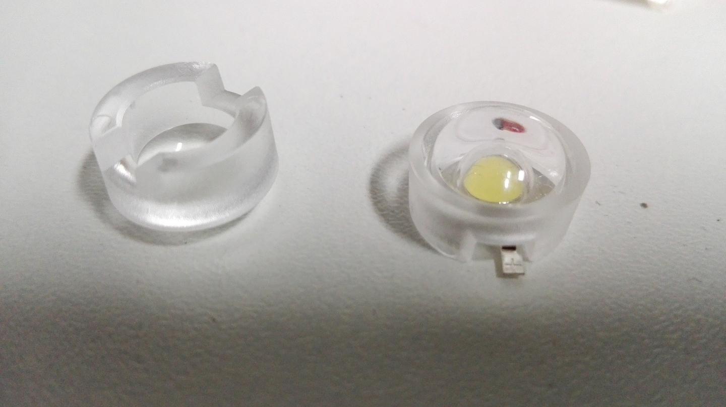

                          I added some leds to my T-33. A solid green & red on the wingtips, a white beacon on top and a red beacon below.
                          I used some clear lenses/mounts where these high power 1w leds fit in perfectly, as you can see it gave good results and I could install them without showing or damaging the foam.

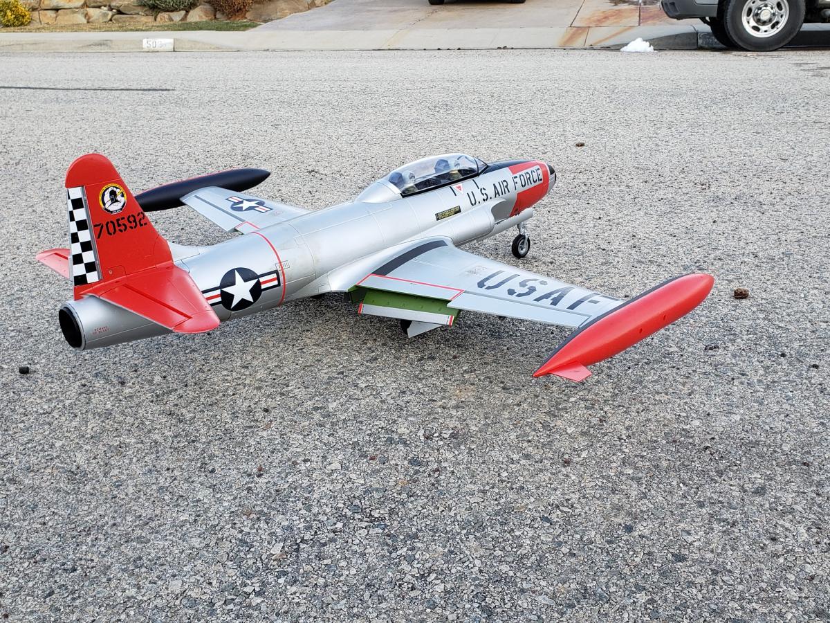

                              Those speed brakes are awesome!!! Well done!
                              I had my t33 out on friday in some 15 to 20mph winds amd it took it like a champ. Reeallly enjoying the t33. I like it so much.id buy another for sure if this crashed. (And i dont say that about many models!)

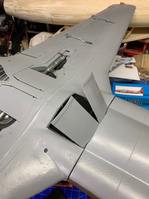

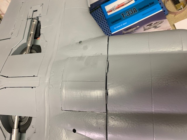

                                Also...for anybody that's curious about the aft fuse/tail pipe reduction I did...Justin La and I did a fly off head to head test of 100% stock vs mine with reduced tail pipe...mine took off faster...had a faster cruize and faster top speed. Not by a ton...but the conclusion is that for a 15 minute mod...it certainly didnt hurt performance. 0 loss in vertical perdormance over stock. In fact it might have been sightly better. And I was using a 5 year old zippy 5800 30c pack. Basically Justins reaction was... "I guess I know what I'm doing to my T-33 tonight.."

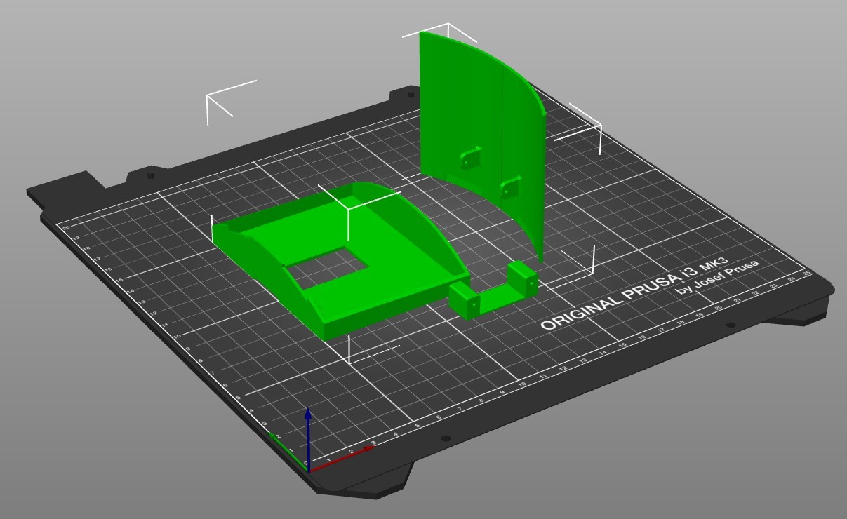

                                  Here are 3DP files for better looking seats, based on the Martin Baker MK GU5 as used in later Luftwaffen T-33s. Parts printed with ASA Filament. Warning: This is a kit Please refer to the pictures for assembly.
                                  Click image for larger version Name:	Seat 2.jpg Views:	0 Size:	42.0 KB ID:	237360Click image for larger version Name:	Seat 1.jpg Views:	0 Size:	36.9 KB ID:	237361Click image for larger version Name:	Cockpit Parts.jpg Views:	0 Size:	56.3 KB ID:	237362
                                  I've been printing happily and I have a few questions.
                                  In the above pic, you show a lower portion for each cockpit panel. The supplied files only includes one. The only difference appears to be that the center portion is longer on one than the other. If so, then no problem I'll just print a second and trim the part.
                                  Second, do you have or can you recommend a background image for the instruments?
                                  Finally, the pilot busts look awesome. Where did you get them? Are they also of your own design? Are you using a PLA printer?
                                  Many thanks
                                    I‘m very interested in this mod, but don‘t like to cut my freshly painted fuselage. What is the outlet diameter on your model? I would like to model a 3DP reduction piece for the tail pipe.

                                      1. In the above pic, you show a lower portion for each cockpit panel. The supplied files only includes one. The only difference appears to be that the center portion is longer on one than the other. If so, then no problem I'll just print a second and trim the part.
                                      2. do you have or can you recommend a background image for the instruments?
                                      3. Finally, the pilot busts look awesome. Where did you get them? Are they also of your own design?
                                      4. Are you using a PLA printer?
                                      1. Both are printed from the same file. I started fitting the panels to the foam cockpit (front panel first) and trimmed that part in question. Doing this, I realised that the front cockpit needs a new coaming. I will work on that today.
                                      2. I used an image from this site: http://aviation.watergeek.eu/t33-panel.html
                                      3. The pilot bust are really awesome, not my design. Here is the source: https://www.thingiverse.com/thing:3806310
                                      Scaled to size
                                      4. All parts were printed using ASA. According to the specs, it‘s getting soft at around 110 deg C.

                                        #913
                                        Yesterday, 11:33 AM
                                        "I added some leds to my T-33. A solid green & red on the wingtips, a white beacon on top and a red beacon below.
                                        I used some clear lenses/mounts where these high power 1w leds fit in perfectly, as you can see it gave good results and I could install them without showing or damaging the foam."
                                        IT2:
                                        Very cool, I'm planing on do something similar. Can you give us a source for the LEDS and the lens covers? Also, what flashing unit are you using?
                                        thanks for any info.
